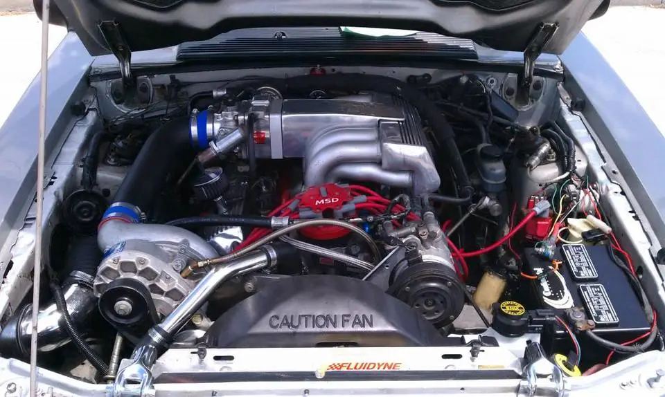

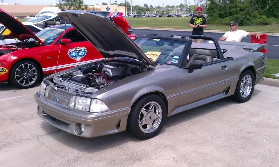

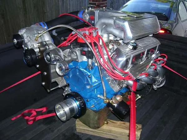

Why not do a forced induction 351w in a fox vert? Mine came out great! However the B303 cam is not enough remember wild roller cams are mild in a 351w I have an x303 in mine and it is pretty mild.

that's one clean, sexy car man, but I've always wanted a 4 eye and this one was a great deal so I had to grab it. Plus I'm not sure how well the body would hold up to my final plans for the engine. Yours looks amazing though, props :)
No problem man the biggest advise I will give if you keep EFI is to invest in a dyno tune, before you spend all kinds of cash on configured MAF's or other items to "trick" the computer. When running bigger injectors. 99% of my tuning issues and what I thought to be electronic or mechanical issues where solved with a tune.
