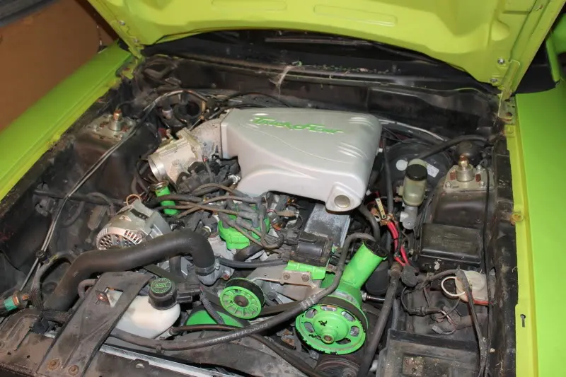

Here's a few pics

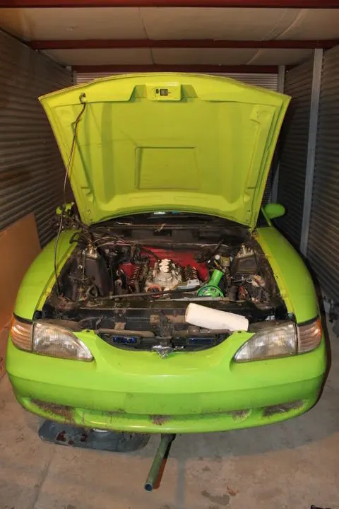

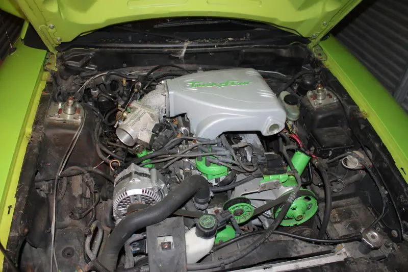

Last pics of it being a together broken 302

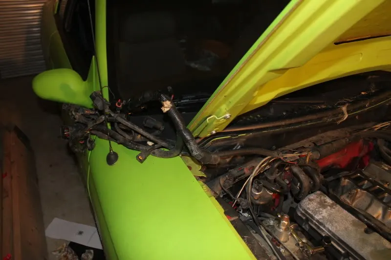

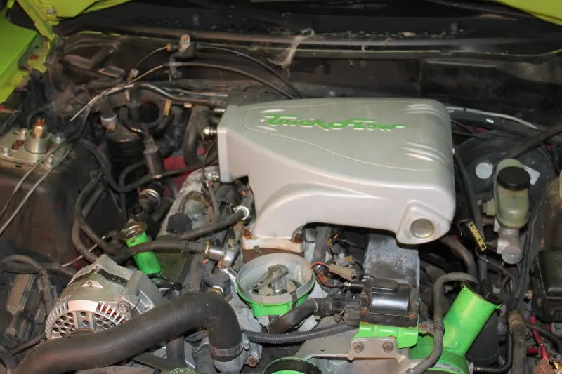

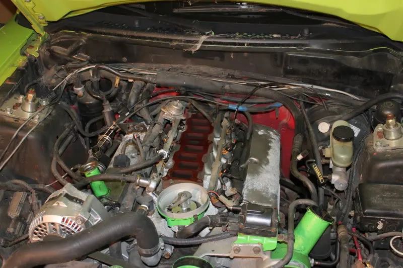

TB removed

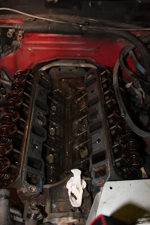

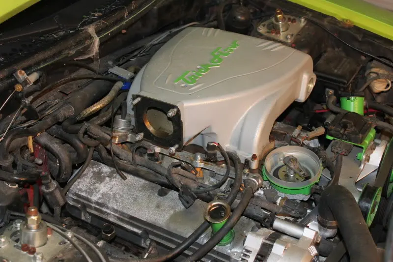

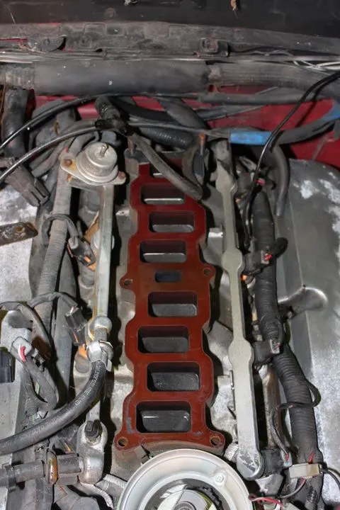

Upper intake removed

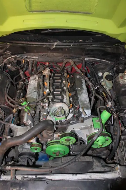

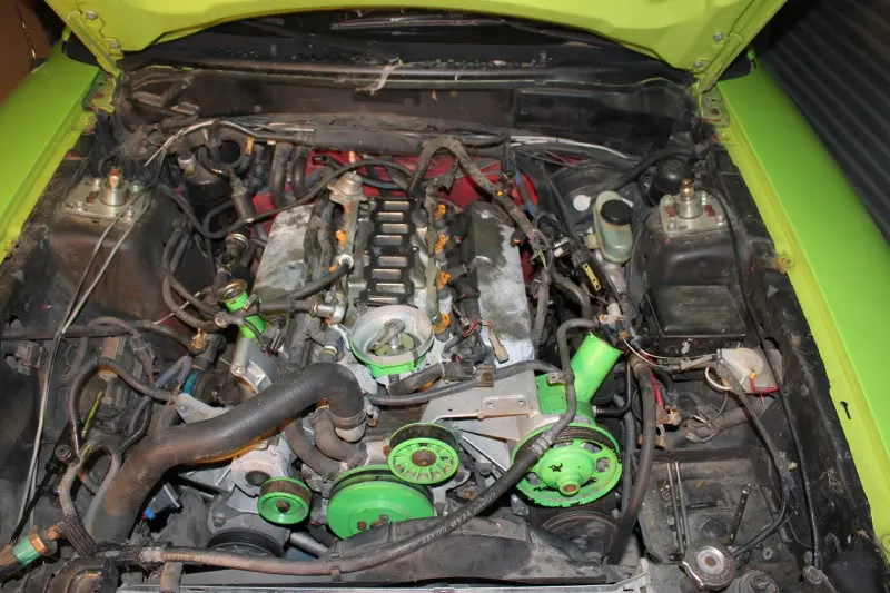

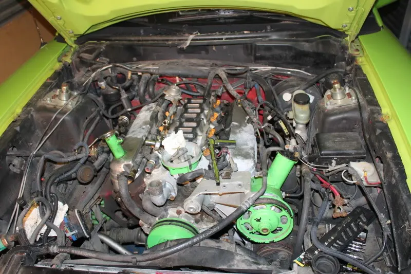

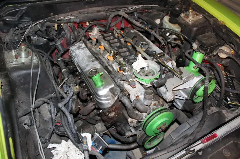

Spacer and alt removed, Injector wires disconnected. How I left it tonight. Does anybody know where the wire on that harness goes that runs down past the WP?

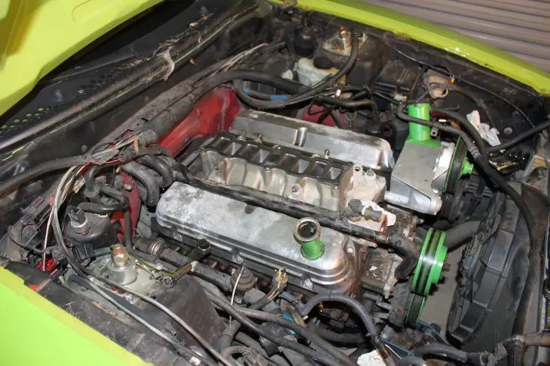

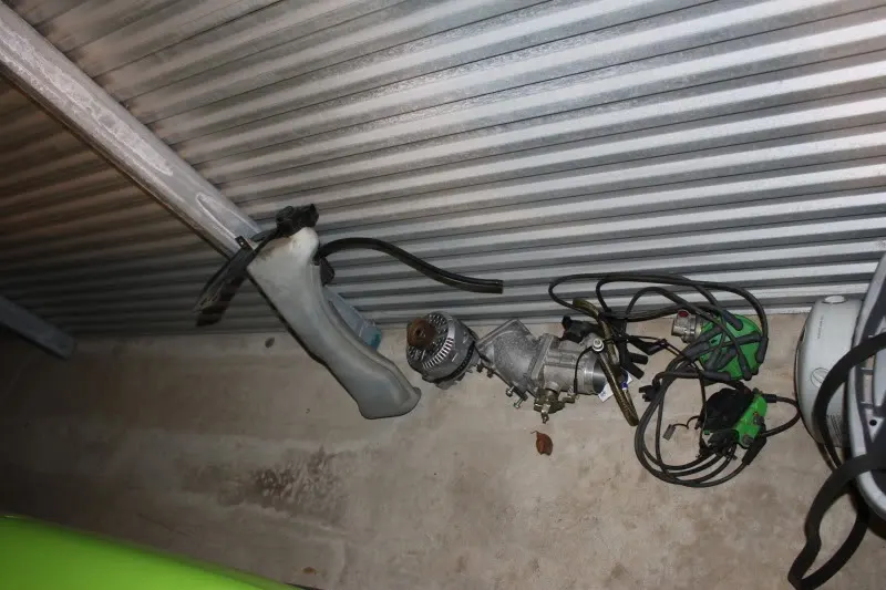

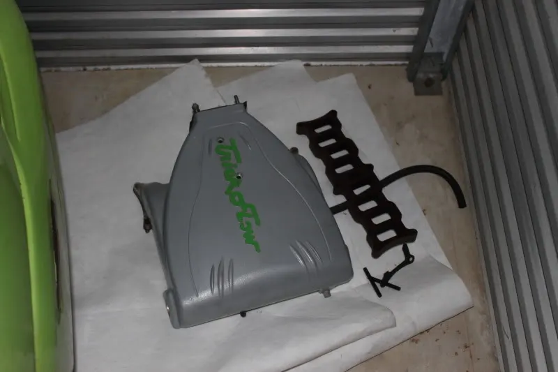

Parts pile so far and the poor intake on the floor
Nothing exciting I know. It's a start though the damn thing has only been sitting how long?
the harness that goes from the top of the engine to the bottom,that runs between the water pump and a/c-power sterering bracket?
i think thats for the O2 harness.
thanks! that can wait for now then. I'm not gonna fight getting it off. i'll wait till the bracket is out of the way
Actually it goes to the oil pressure sending unit and ends with a connector that plugs into another harness that runs to the O2 sensor and some other things. It ends at the bottom of the front of the block, so it's easy to remove.
Yep it only takes a second to remove.
Mystery machine, so whats the story on the car for those of us that don't know? What's wrong with it?
It was a pain in the ass but I got it to let go after messing with it.

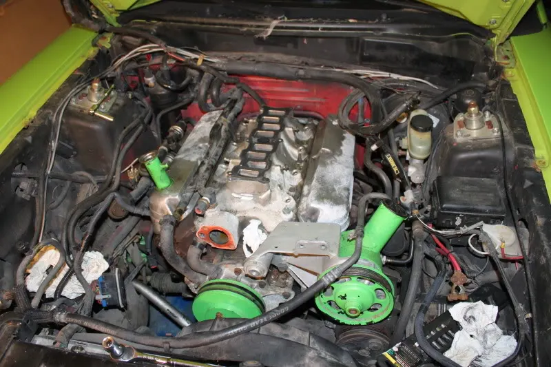

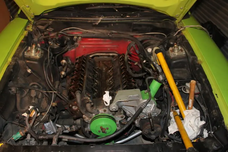

Heres the progress from tonight

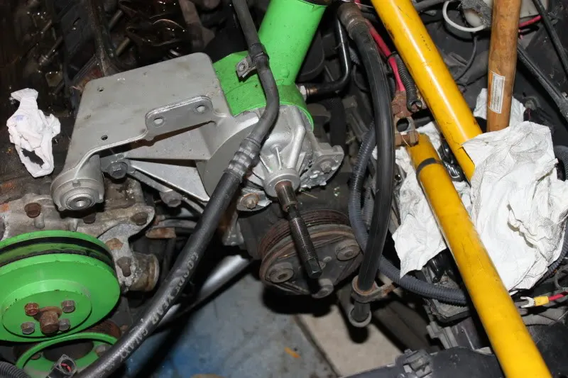

If I still had a good ps pulley puller that would have been gone. I would have taken that sides accessory bracket off. I need to get a big wrench to get the coolant pipes off the lower intake. If I would have gotten that off the intake would have came off tonight too

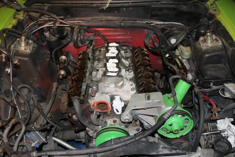

Last night didn't go so well. The PS pulley fought me. Damn thing just didn't wanna come off. After I got it off the stupid bolt won't come apart. I did get the intake off though. So far everything looks pretty normal. What I don't get is the oil in the heads look fine. When I pulled the intake the oil in the valley is kinda milky. Shouldn't it all be milky?

Here's a couple pics. The stock red is really starting to stand out :notnice:
Damn thing is stuck in there:mad:
