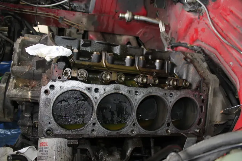

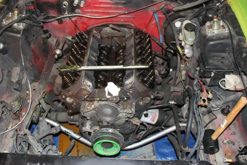

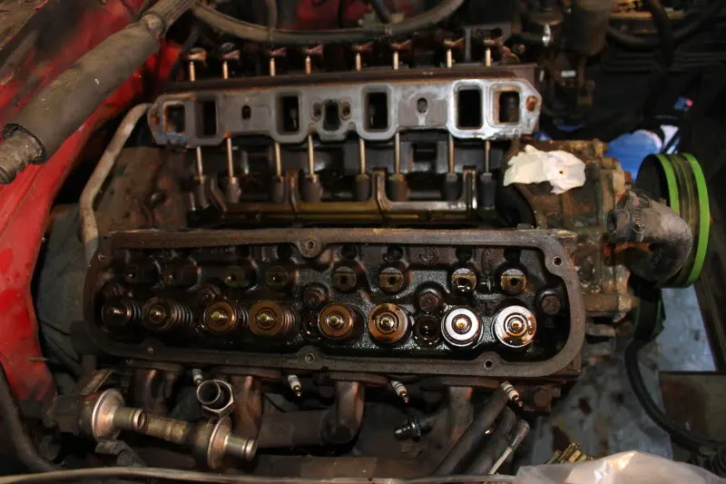

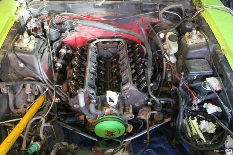

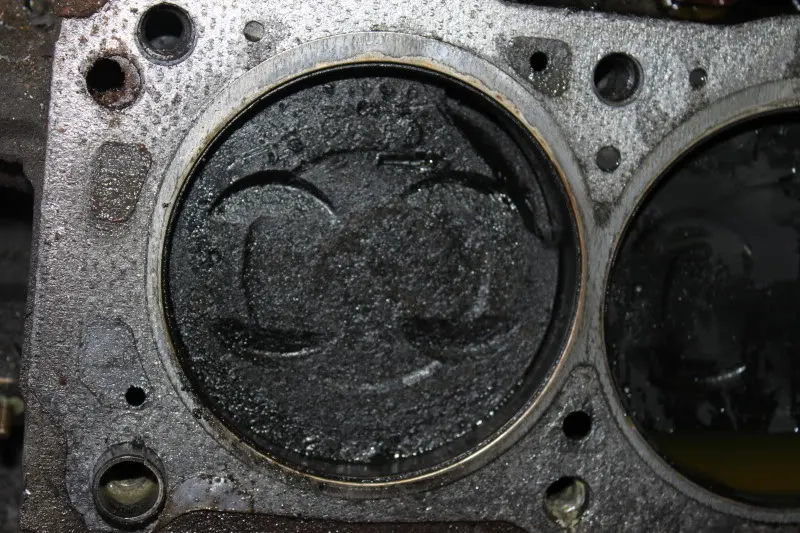

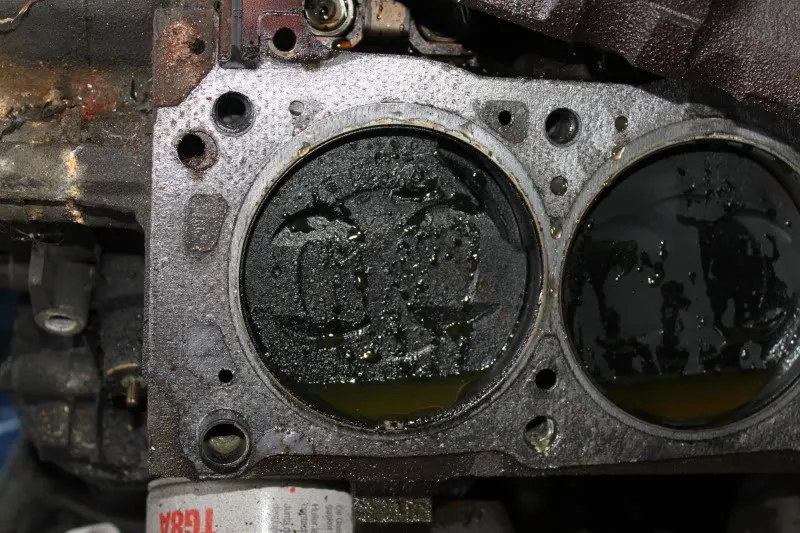

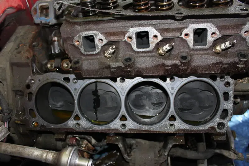

Some new pics of the progress. Found some carnage
Not sure if this is from the bad head gasket or not

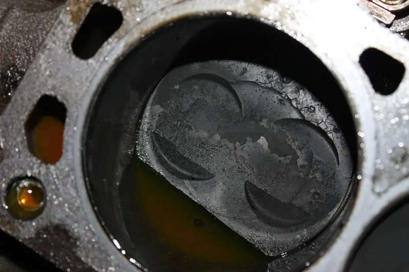

Some of the pistons had marks in just like my Ram pistons did

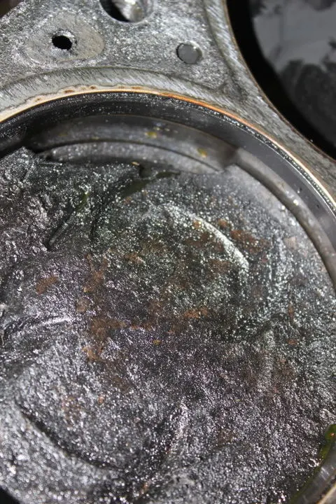

CARNAGE! Not as bad as some I've seen but it made me laugh and be proud :rlaugh:

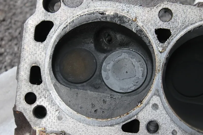

Head where the bad piston was. Valves look fine :shrug:

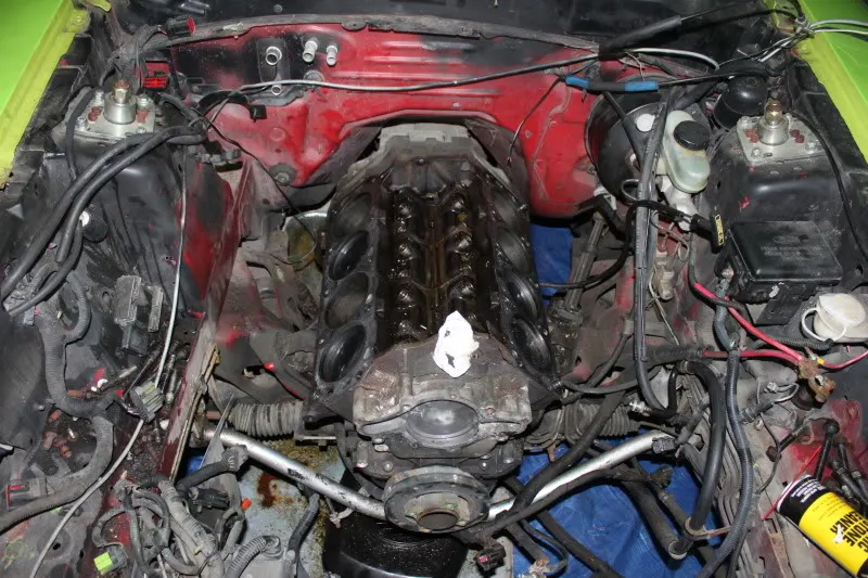

Getting it ready for some 35's LOL
At the end of the day

That's not nearly as bad as mine. I'm guessing you weren't turning 6500 rpm when it broke? lol
You should have the heads checked if you plan to reuse them. I had to have 2 valves replaced and the valve seats needed fixed.....don't know why you would reuse stock heads tho....

Mike I'm not reusing them. Even if I was keeping the stock block I would get aftermarket heads. I know compared to some pics I have seen my little chunk is like nothing. I was proud to find damage though lol
The engine is basically ready to pull out. Gotta unbolt the motor mounts and pull it on out. I'm gonna tear is all down for the hell of it see what else I can find. I'll hang on to it. Never know when another project might come along ha ha
