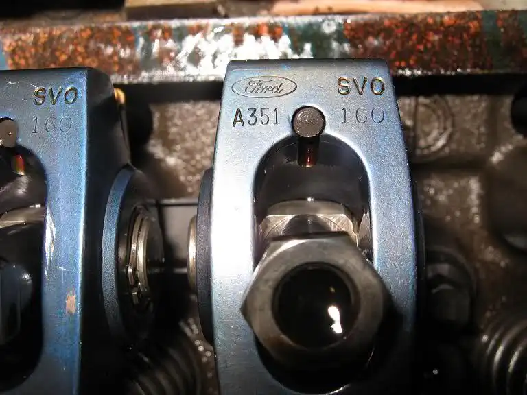

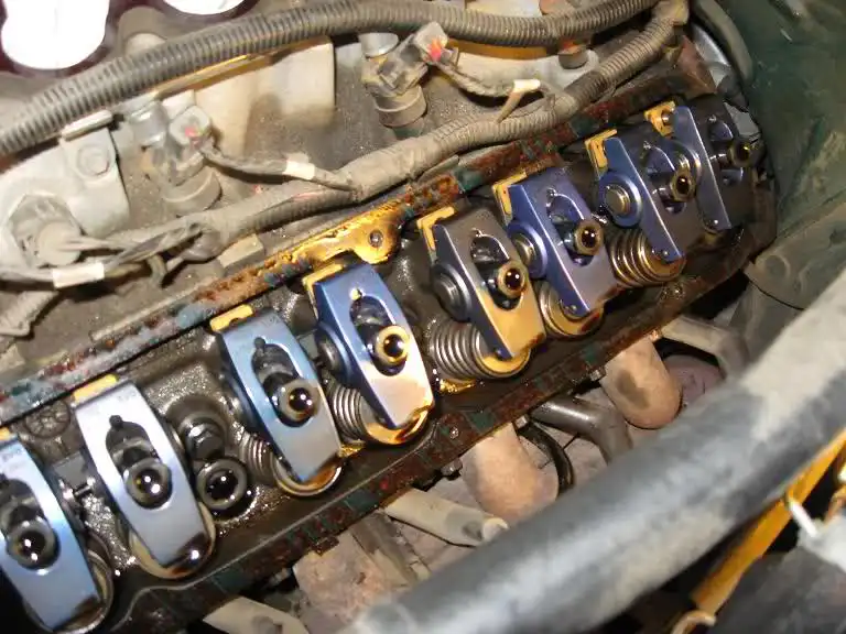

Stud mount with emissions provisions, I can't see any markings on the front. I'll need a rebuild eventually and I'm trying to decipher the top end to know what I should be pairing with it on the bottom. The only markings I've found are what looks like a "CP" and a "T"?
Where else should I be checking for markings without pulling the heads?
Thanks.

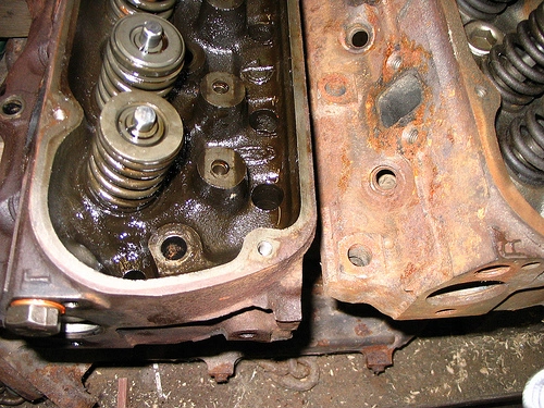

They look like E7's with a stud retrofit on them. Seems there are still pedestal channels under the rockers, so it's safe to assume. Thats what I think. GT Heads all have certain bars, and e7 should be located somewhere in there.... or even e6... depending on the year.
Based on this picture I found of E7TE heads, I think I have my answer. I guess they were pulled and machined for the studs at some point.
