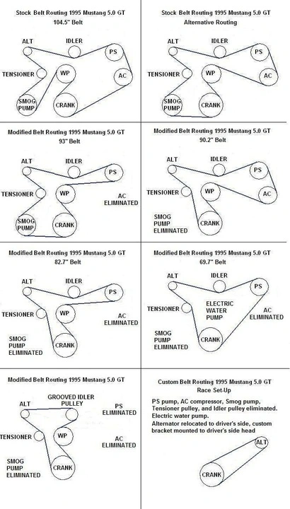

Hey it’s me again was not planing on having this much of a break from my project but life happens, anyways I have another question at the moment. Since I don’t have the longer ac lines at the moment is there a way I can get a different belt if I don’t have any ac compressor on or can I just put the compressor on with no lines and block up the lines to keep the dust out. Oh also I just remembered I a pretty sure the clutch cable is longer but the throttle and cruse control (the whole cruse control system) is the same between the v6 and the v8 right? Thanks for the help and it looks like my summer project is now a winter one.
You can run a shorter belt (See Below). I don't take any credit for the image, Its been floating around on StangNet and other forums for a long time.

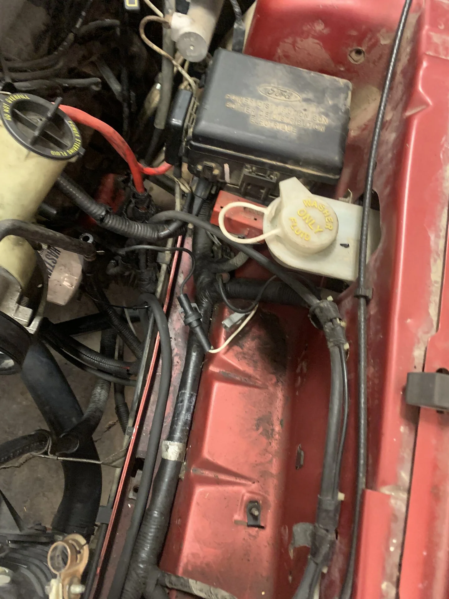

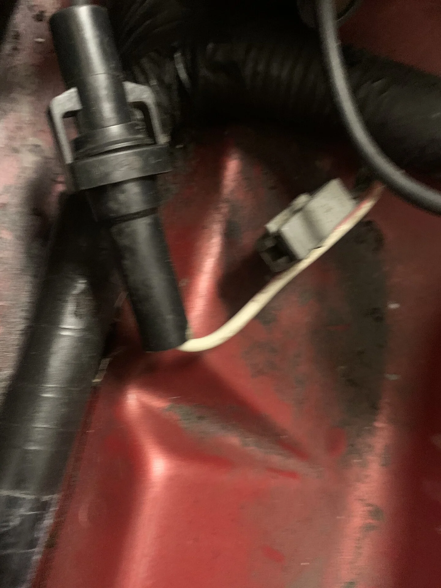

It has been a long time but got car up and running a couple months ago now just waiting to get tires and exhaust. I just have three questions now. First is I found a little gray connector by the fuse box under the hood and wondering what it is for. The ac? The car ran without it so I didn’t really worry about it at the time. Second are the up stream o2 censors the same for the gt and the v6? I know the v8 only has upstream ones. And finally could I get an explanation on the differences of 8.8 lsd rear ends? I know that the 94-98 would be the easiest to swap over but could I use just the carrier with the 27 spline (or what ever the mustang has) from some other car like and escape? I am not wanting to swap over rear ends yet as 2.73 gears will probably be nice with gas prices and I will drive the 7.5 till it breaks but would like to learn about it. Thanks if someone can help me out! (Hope the picture of the connector sent)

Responding via mobile so hope I answer all your questions
Grey/Gray connector is for testing your windshield wiper fluid pump.
