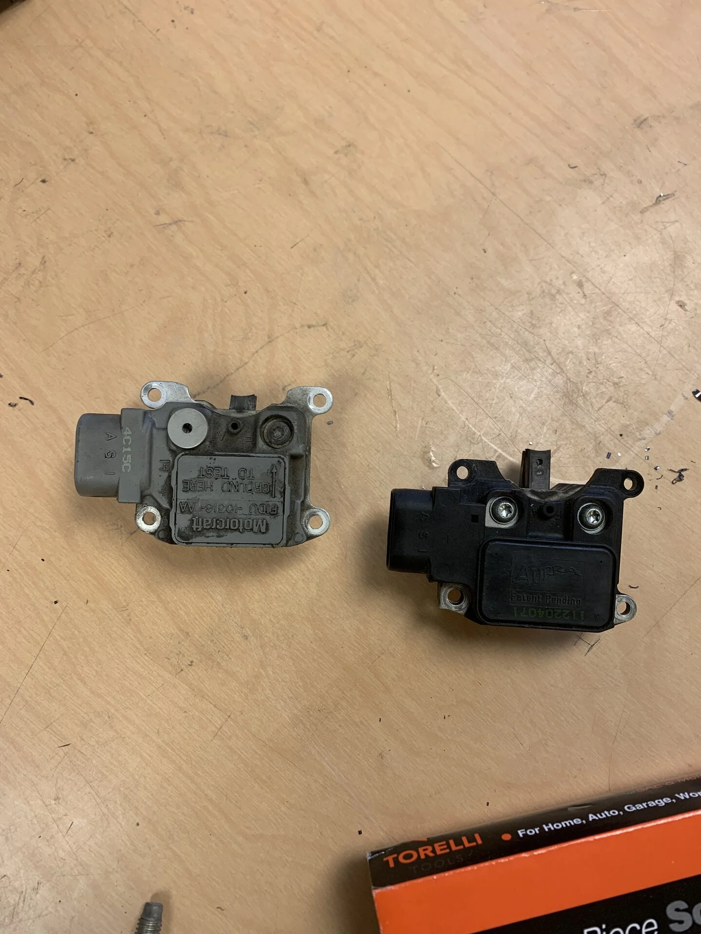

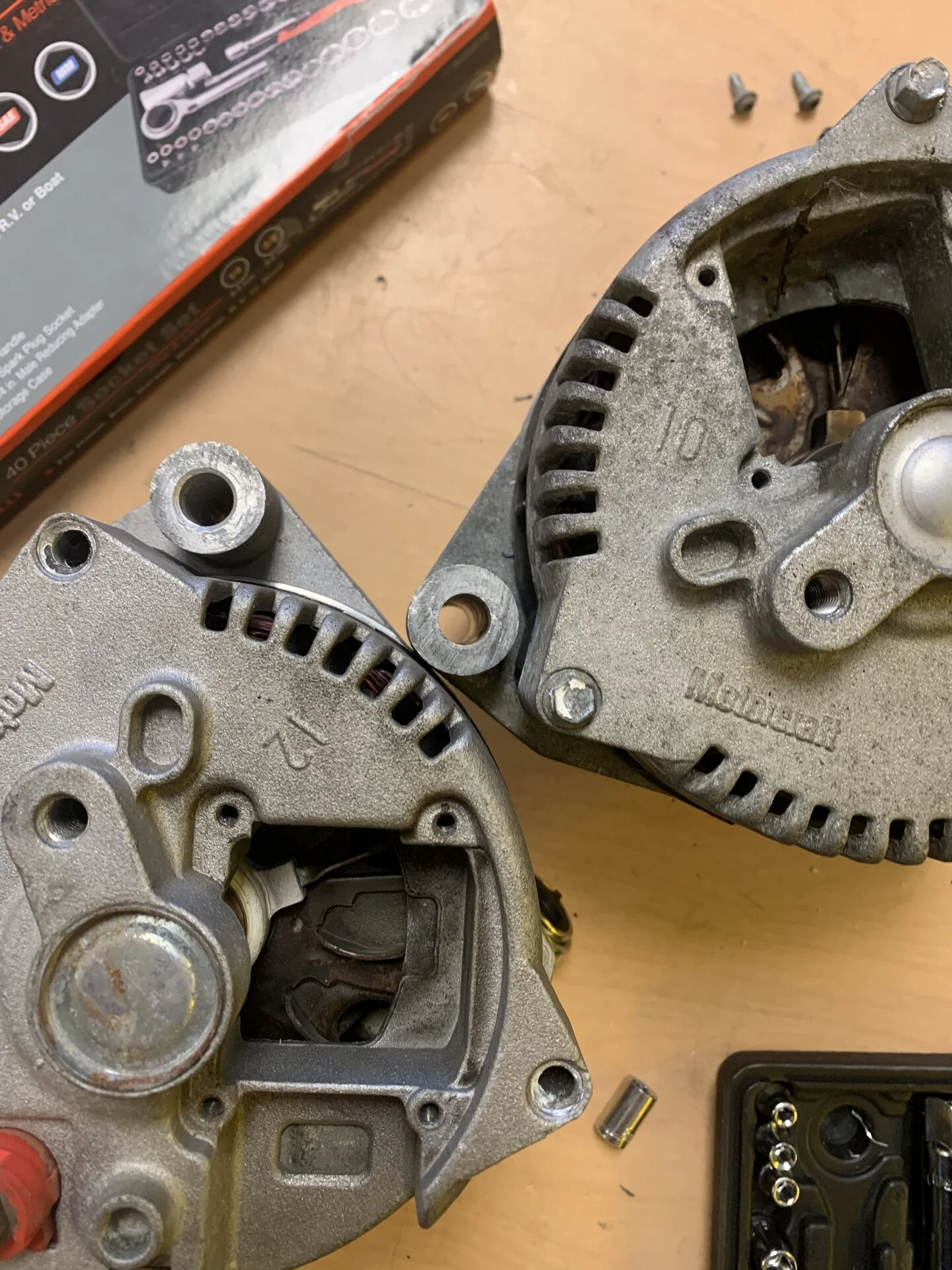

Well looks like I am back today. I have a question about the difference between alternators for the v6 and v8 I thought they were the same 12v 130 amp. But looking at the back of the v8 on it has a 10 when the v6 has an 12. The v6 one looks like it has been more recently rebuilt as the brushes are much longer than the v8. When I put both of them on the car the 8v one charges better that the v6 that I don’t even think it did anything really. I want to use one of the alternators for a school project electric motor conversion but want to know what one is better to use. Should I take the brushes from the rebuilt one and put it on the v8 10volt one?

V6 and V8 use the same alternator.
Huh wonder why the other one has a 10 and not a 12 on the back of the shell. Should I just swap the brushes over to the older one? Aren’t they the only wear item in the alternator? Just wondering why the more worn v8 one works better than the newer rebuilt v6 one.
Since it was rebuilt who knows. I’m still running the v6 one on mine. Check pulley size, I got one that hand an under drive pulley on it, replaced with a factory one and all was back to normal.
If you want to swap parts around that’s up to you.
Ok well knowing that they are the same is good. I will tear into them both tomorrow and see what one I want to use as the motor. Like you said I could alway Frankenstein one together that works. Thanks.
The shorter brushes just have more miles on them and are worn down more
