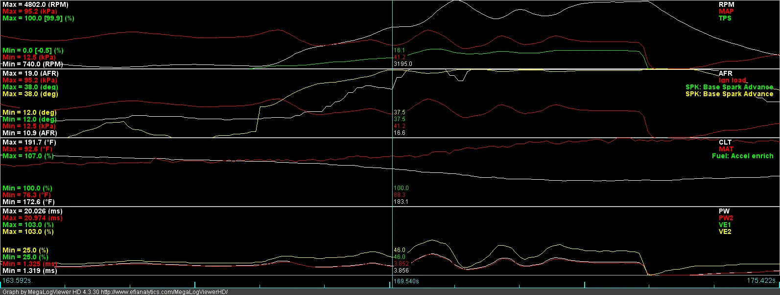

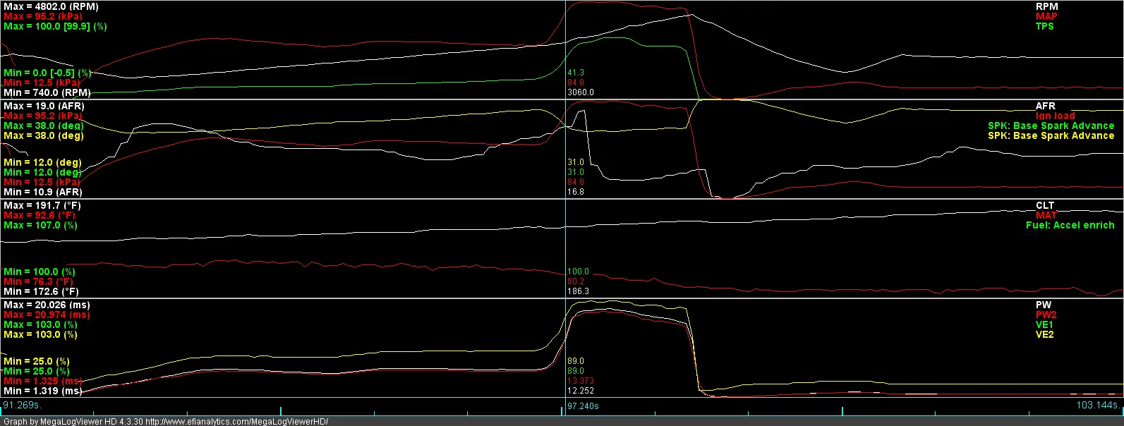

Tried the 2.0.6 tune. Its definitely getting better. I am wondering why when driving i can see the advance being pulled out and AFR going down of it vs revving in the driveway and the advance...well advancing more and the AFR going up.
Driving:
Driveway:

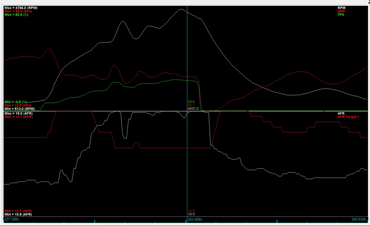

It does seem like you are getting things dialed in, but you need to focus on the rule of AFR=AFR Target. These need to match so what you are commanding (AFR Target) equals what you are producing wideband reading (AFR). I assume that you saw a miss right at the end of your log as below is a picture of you commanding 14.0, but were producing 18.9.
