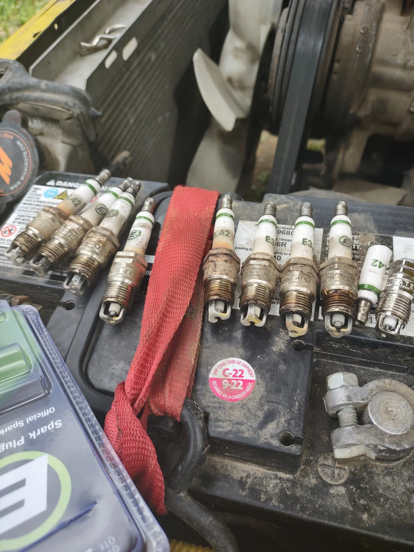

I'm new to this site. I bought this 89 Mustang two years ago and am now looking into addressing a few problems that have come up. It started to sputter at around 4500-5000rpm and also at lower rpm when under load. Also not every time but is happening more and more now. I've replaced the plugs
Wires
Filter
Fuel pump with no change. I don't have a great deal of experience with sensors and replays and it has crossed my mind to just switch to carb. I'm leaving for something advice on what to look for and what to try to change first.
Thanks Bart

First advise is not to use those plugs, platinum, or iridium. Regular Autolite or Motorcraft copper core plugs. Check the distributor pick up under the plate the rotor button sits on. To replace it the distributor has to come out and the gear has to be removed.

Welcome. I concur on not running those plugs. More of a gimmick than anything. The iginitions on these cars seem to be most happy running stock copper plugs gapped at 0.052" - 0.056".
I would pull the codes first and go from there. If it's a bad sensor, it should come up here. Keep in mind you'll need to pull the key off, and the engine running codes.
