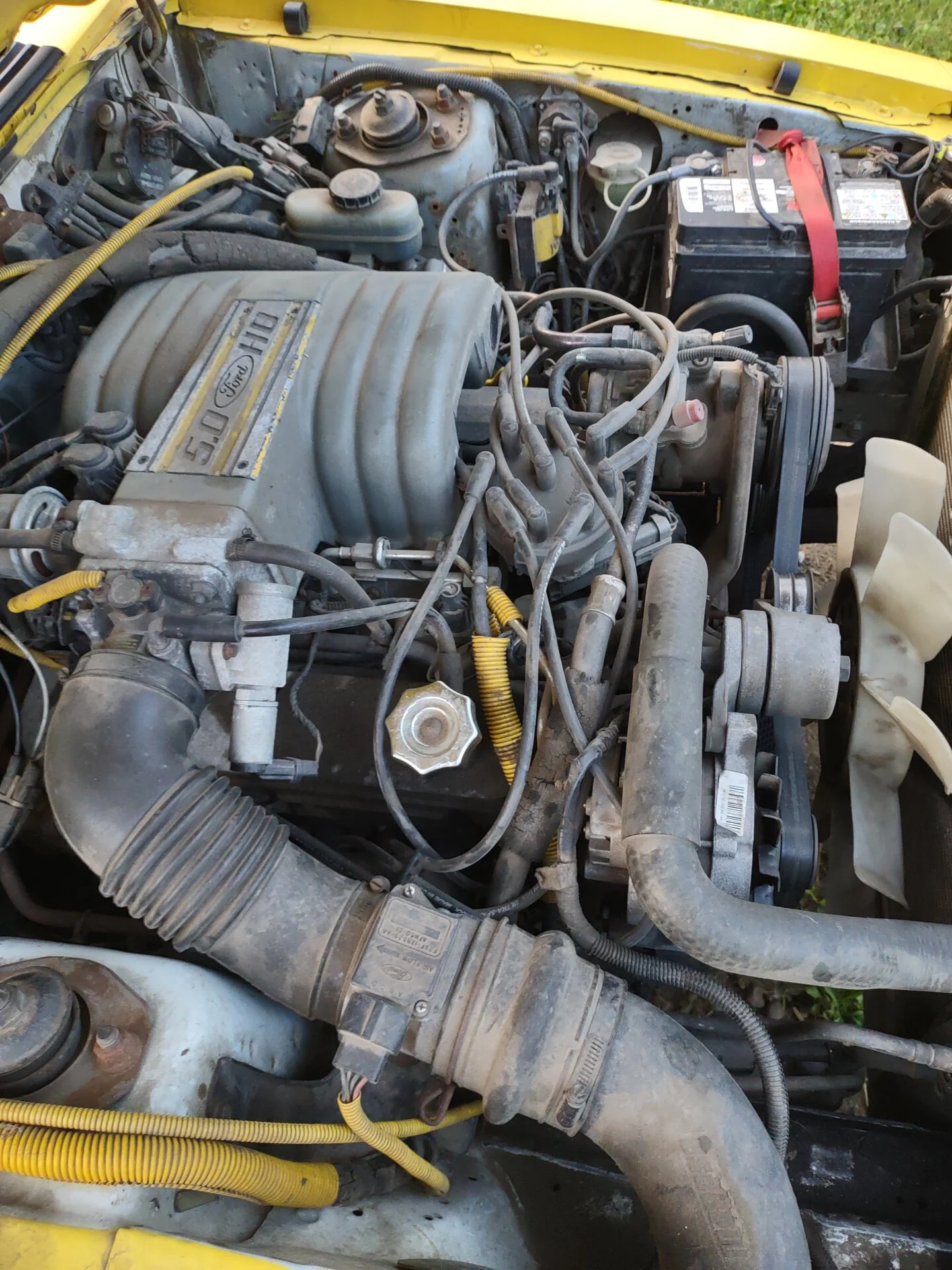

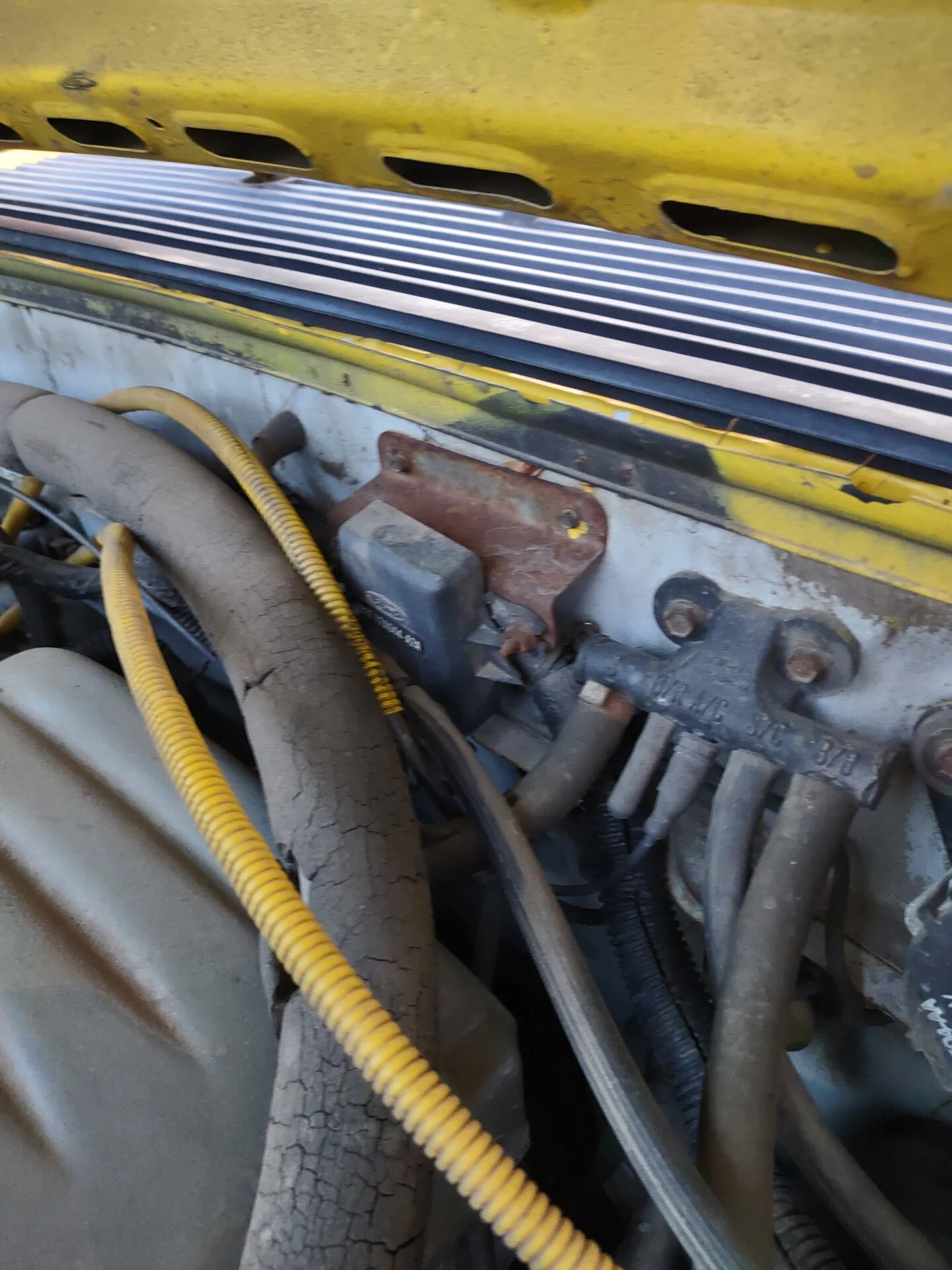

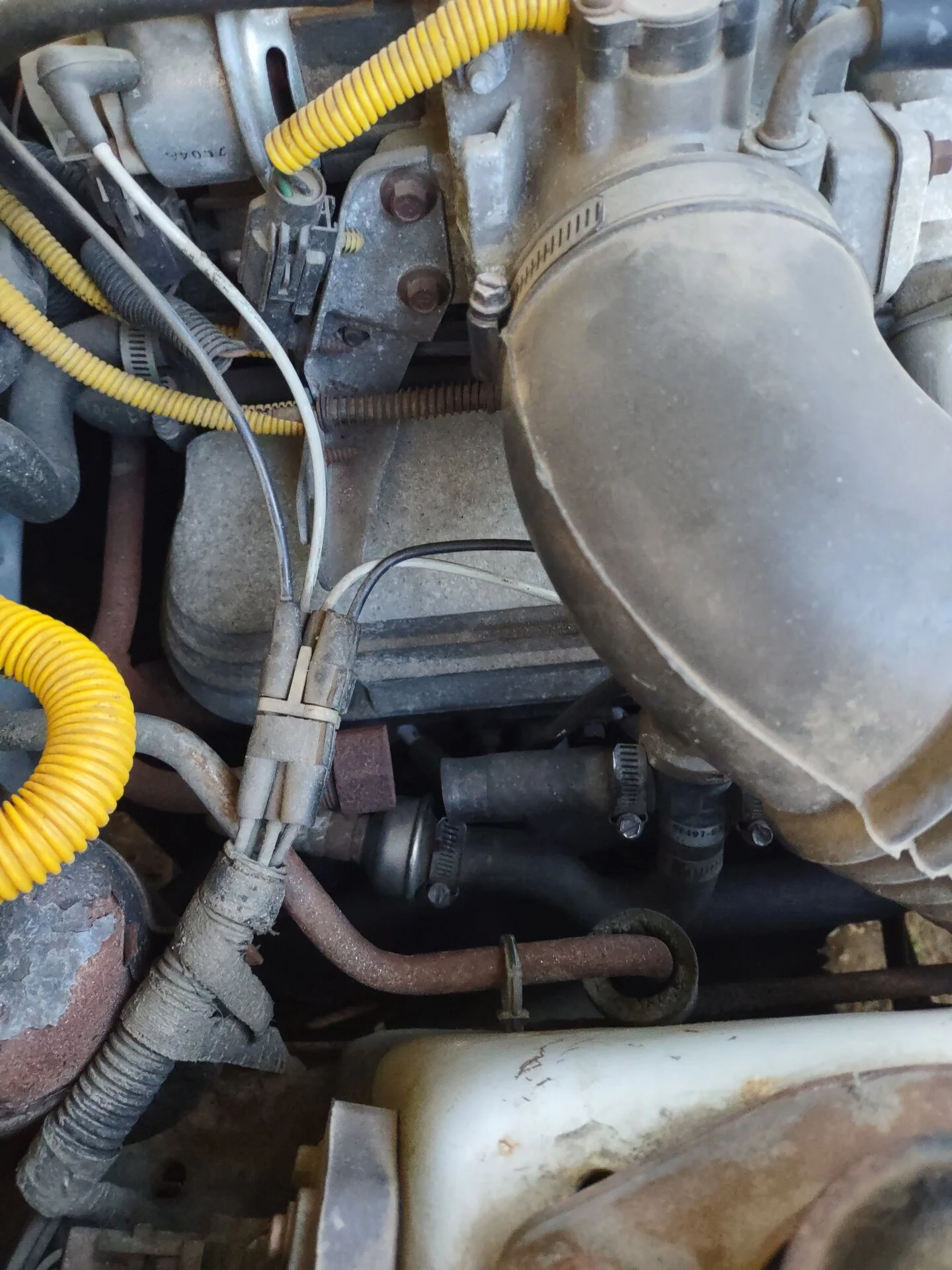

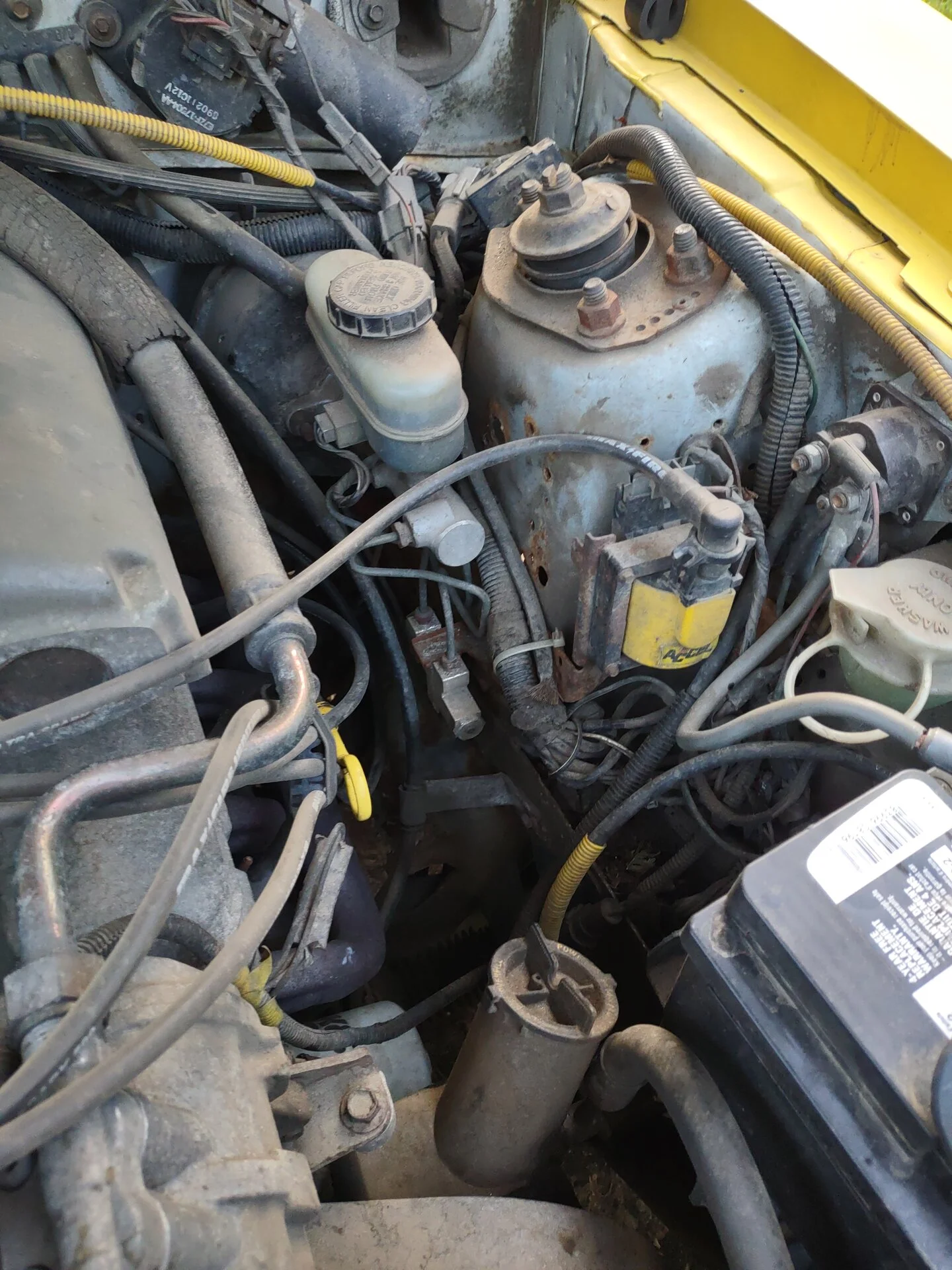

I do get the check engine light quite a bit but not steady. My wife ordered the code reader that was mentioned in the beginning of this thread from a Mustang site (not pony parts) but I'm not sure witch one it was. I'm still waiting for that to come in so I don't have any info from that yet. If it doesn't show up this week then I'll do the jumper wire and post the amount of flashes I get.... I see that line blocked off it was that way when I bought the car.....
