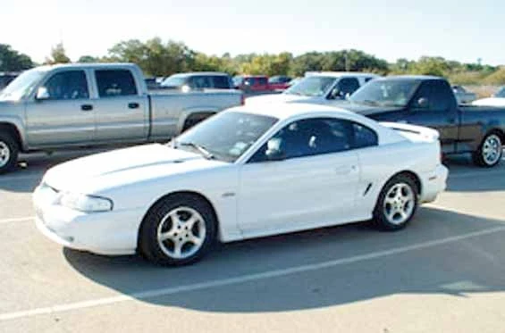

hey everybody, I have recently purchased a 96 GT and have a few questions for you.
The car runs good, has 121k on it, auto, lowered, stock shocks/struts(ride needs improvement!) and has a CAI on it.
It also has a 3" dual cat-back exhaust with shot flowmaster knockoffs. It has 16" wheels from a 99-01 stang with 215/60/16's on it brand new. Needs much wider tires!!!

I'm going to attemp to post a pic.
