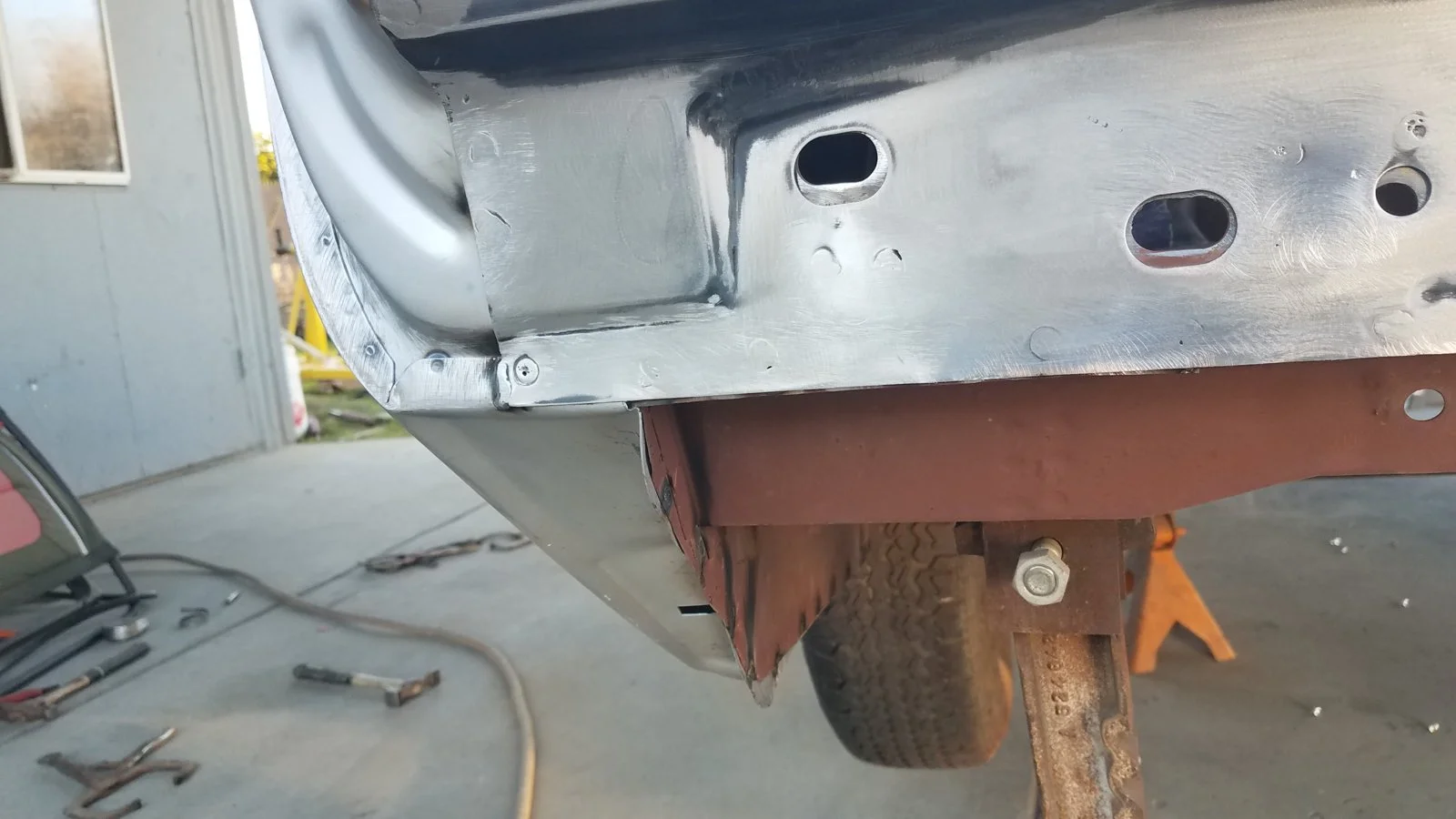

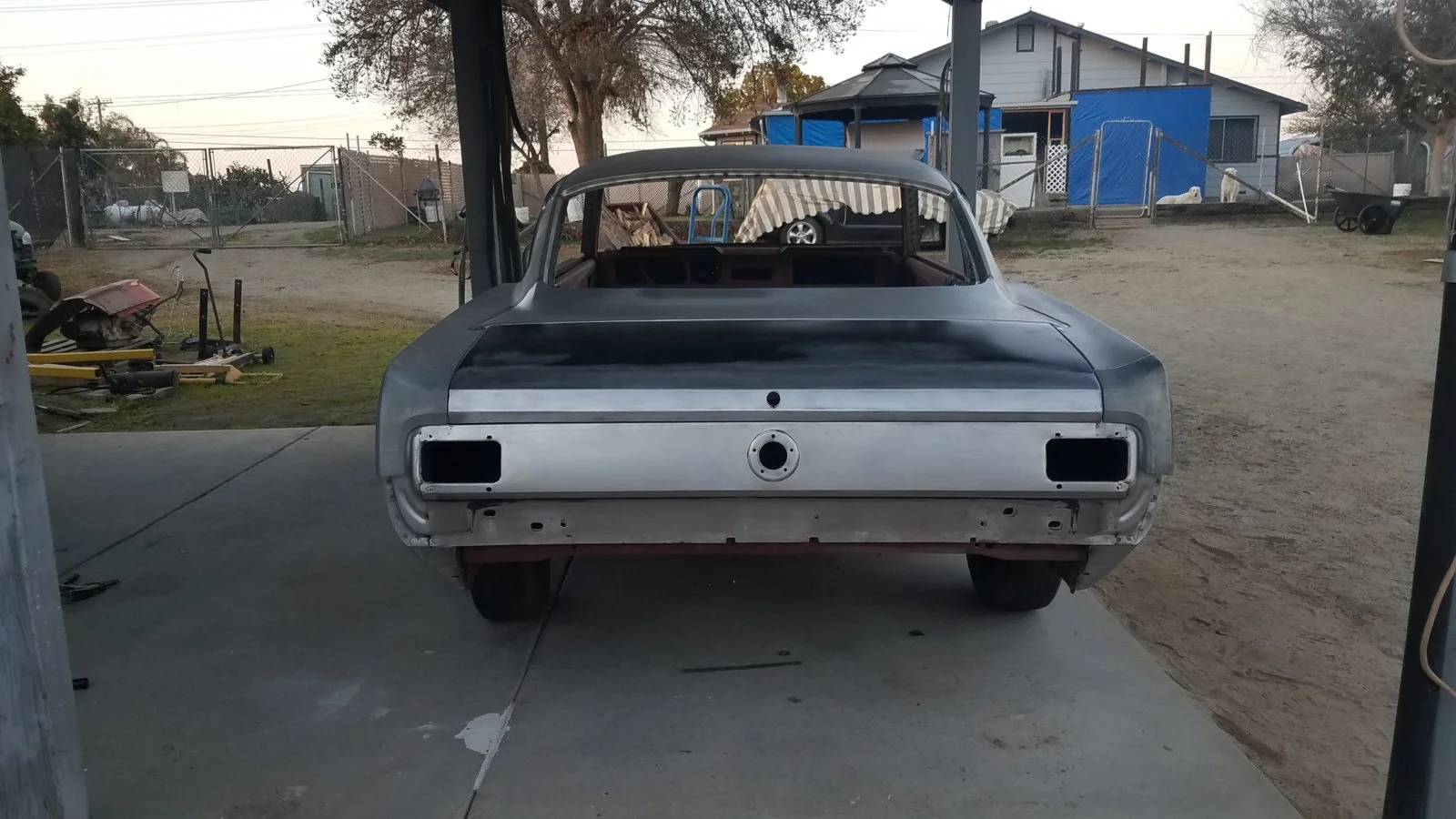

And the holes for the tail lights are not in the right place on the tail panel ,i will redrill them
I had to do the same thing on mine. The holes in the end caps weren’t in the correct spots.

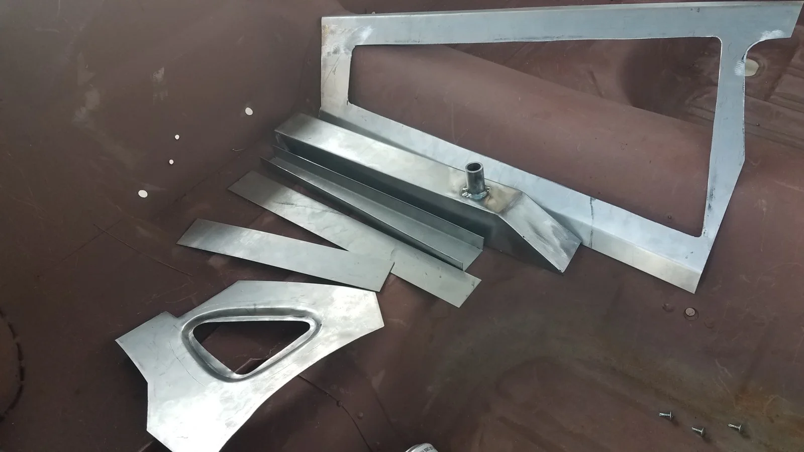

You will be better off buying the 66 door frames ,there is a lot of making parts and fitting them in in the correct place ,i have a fast back to measure from so it isnt hard for me . With the full door frame there is a lot less trouble

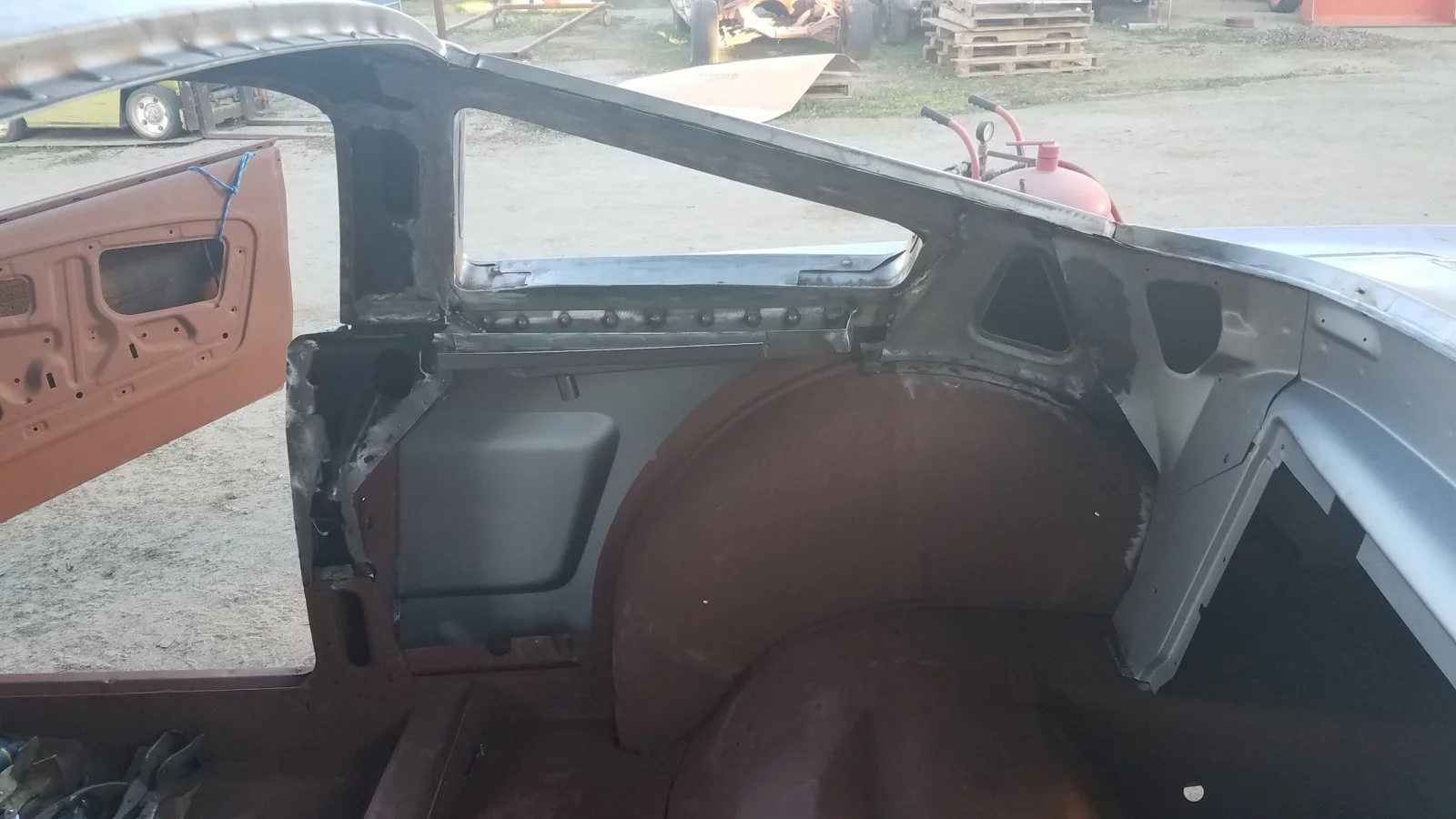

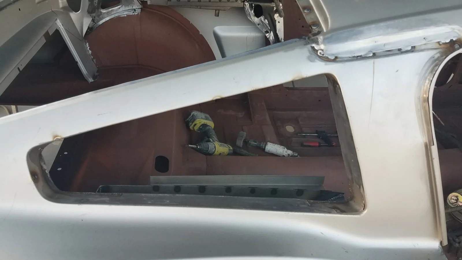

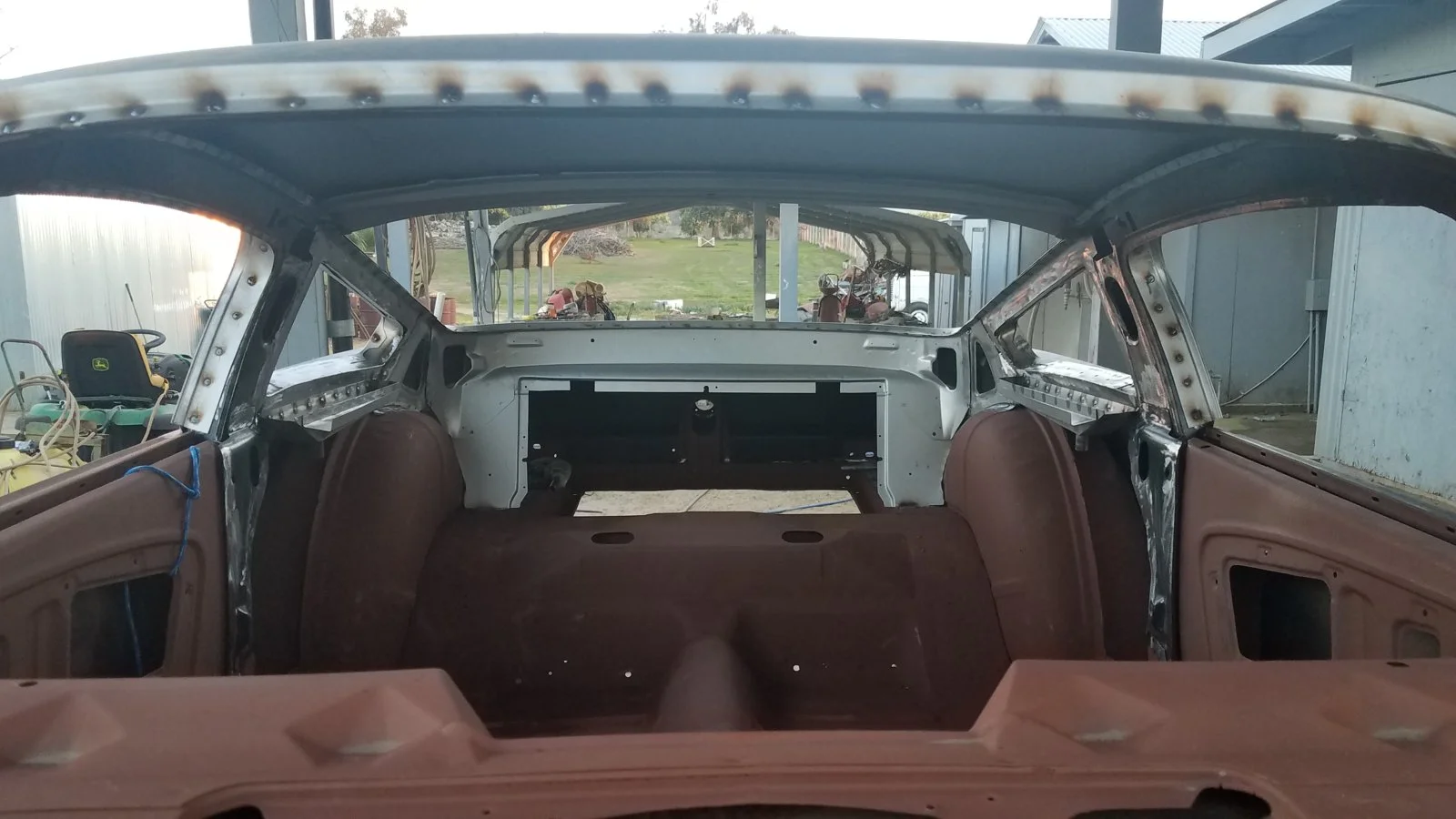

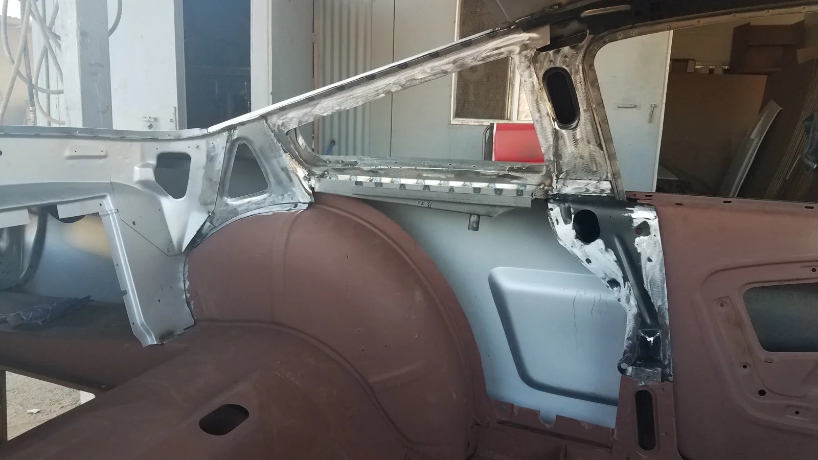

Got the driver side inner structure almost finished ,need to weld in some holes and attach the post to the roof ,passenger side is laid out and ready to start

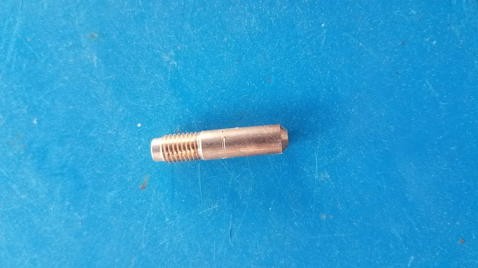

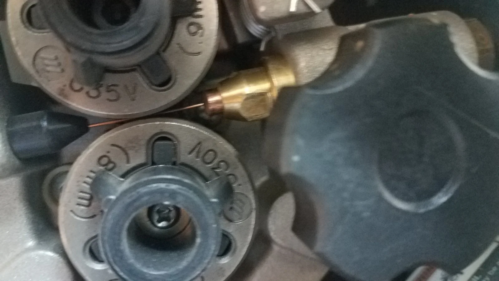

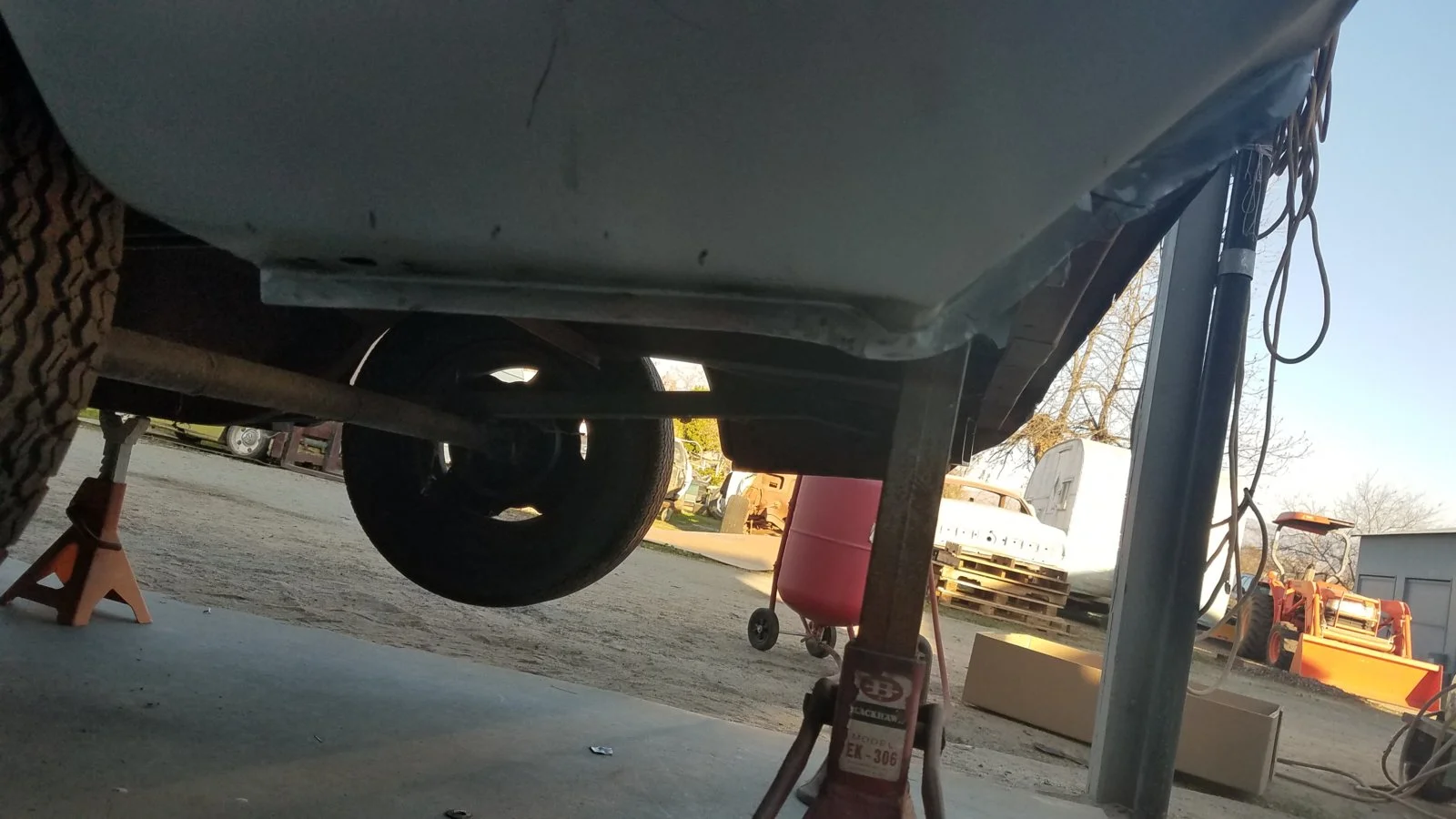

I was at the point of chucking this welder ,decided to take one last look under the hood . The tip that the wire runs through was just a short piece of liner and the opening was twice the size of the wire allowing the gas to escape before it ever made it to the gun .i took the liner out ,replaced it with a cut down welding tip the same size as the wire and the thing is like a brand new welder. I dont know why they didnt just build it that way in the first place . First thing i welded was the bottoms of the quarters with no burn through or pop and spatter

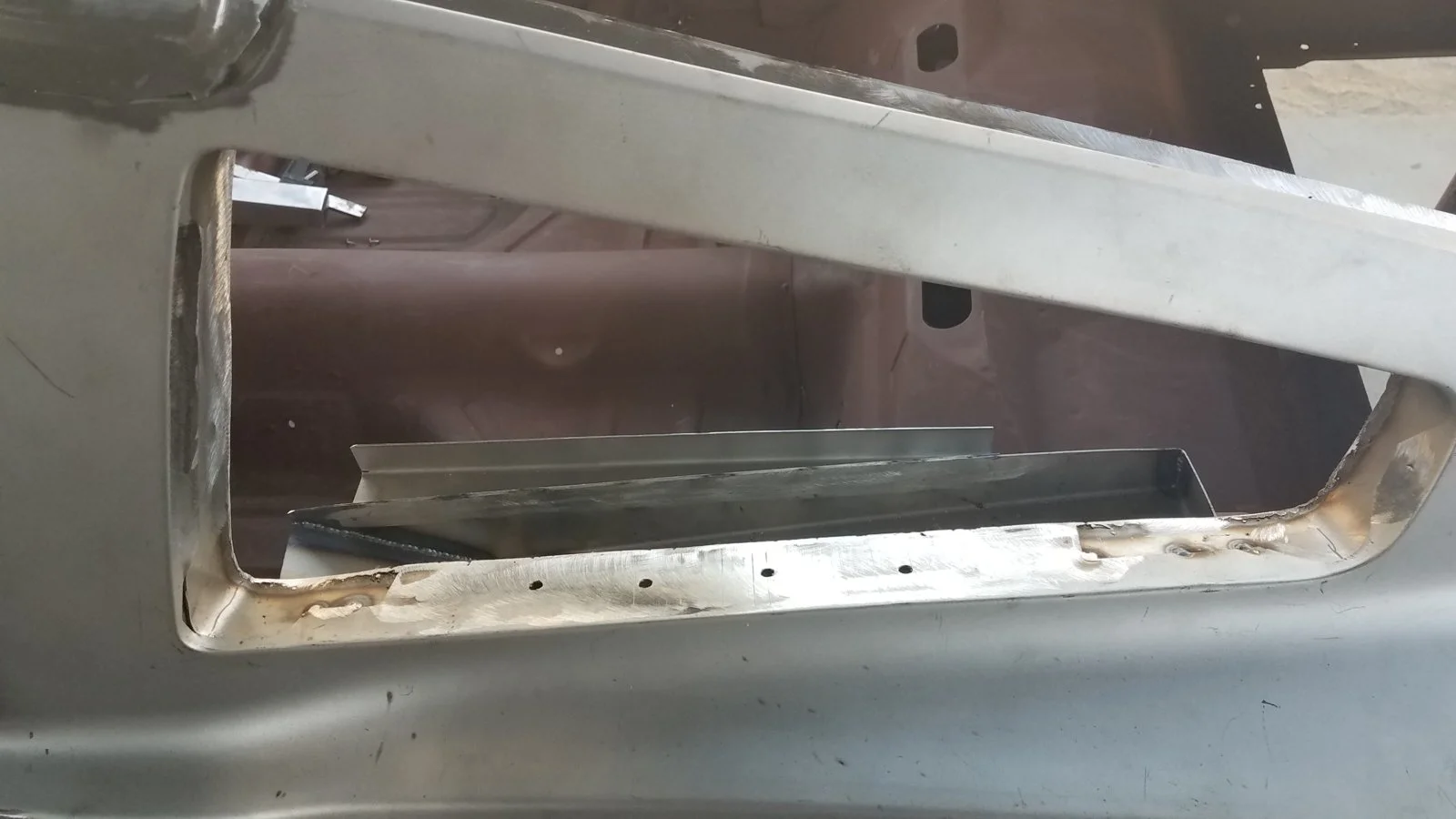

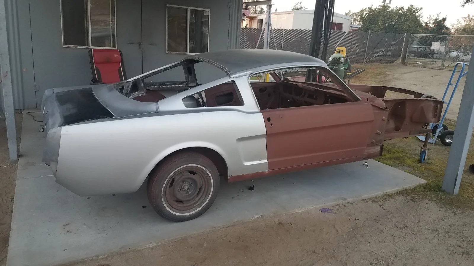

Passenger side is done ,i still have to plate off the rear post to the roof brace on both sides but it is just cosmetic ,i will do that in the next couple of days . This weekend i will have Nick sand the body panels to bare metal and i will primer in grey DTM
