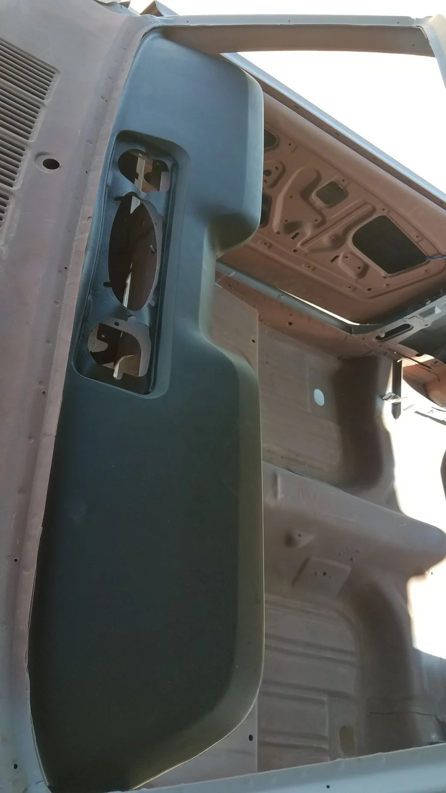

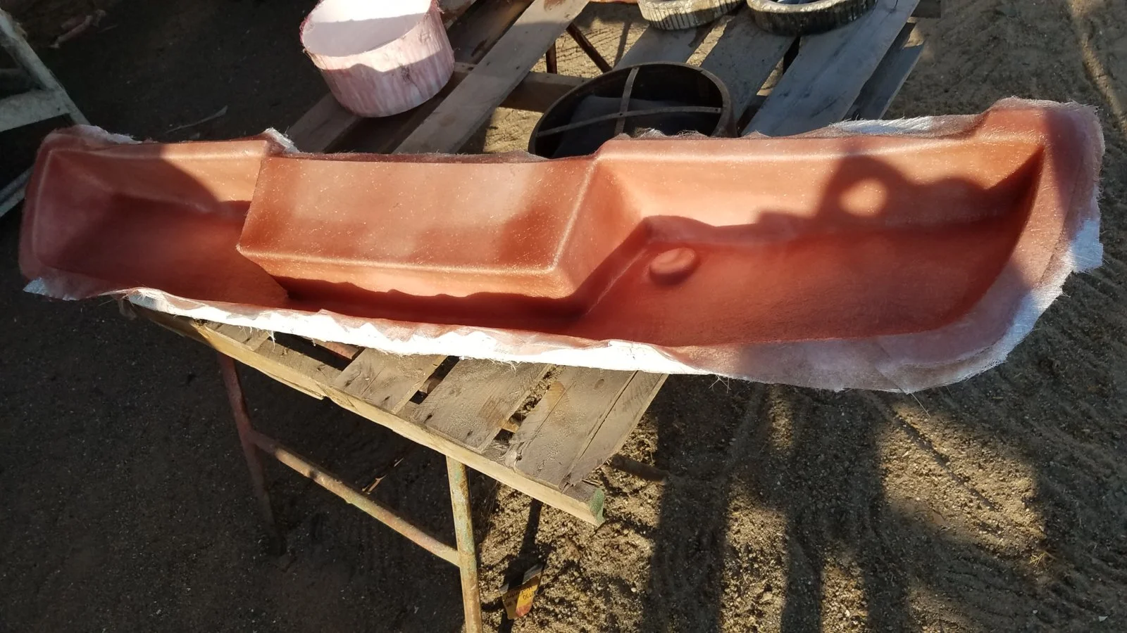

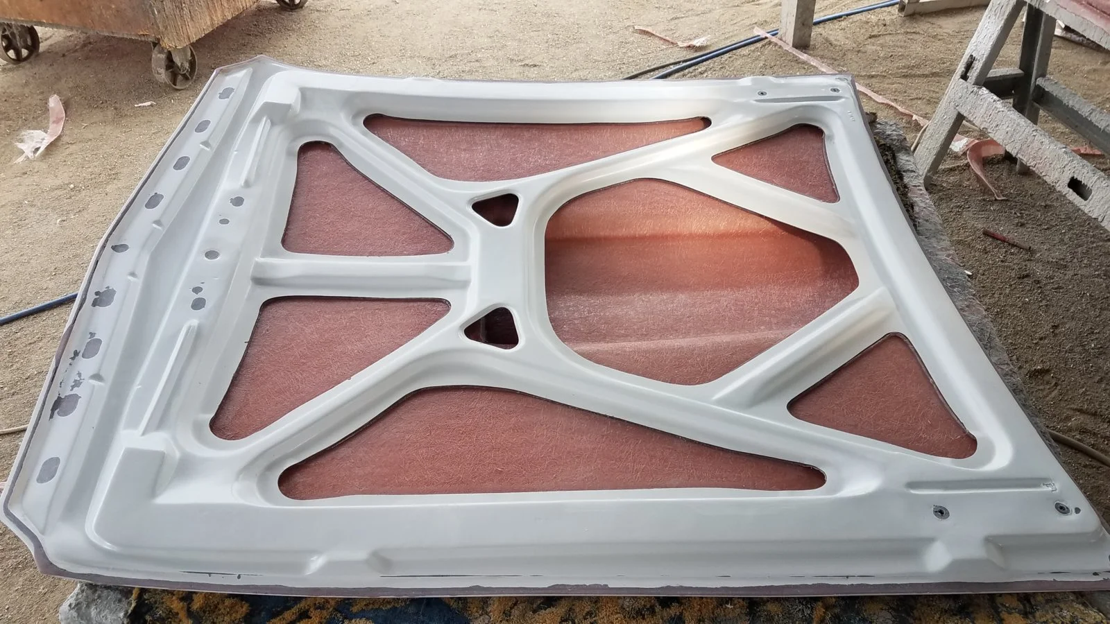

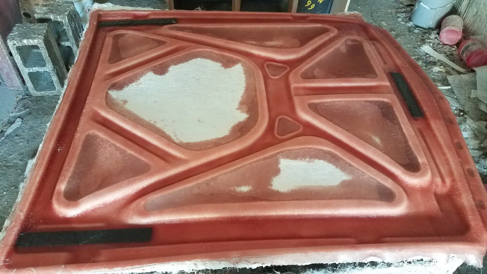

Is the metal shown above in this underbrace for the hinges and hood latch alreaded "embedded" in the frame? Are they predrilled at all or is all drilling of the frame and metal done after bonding the top on it?
IT is for the hinges and latches ,it is embedded in two layers of mat on top of two layers of mat . They are drilled an threaded soon as the part is trimmed . Most hoods they pop rivet these plates in and after a while the rivets loosen and fall out or they used aluminum rivets and they rot away or break out
