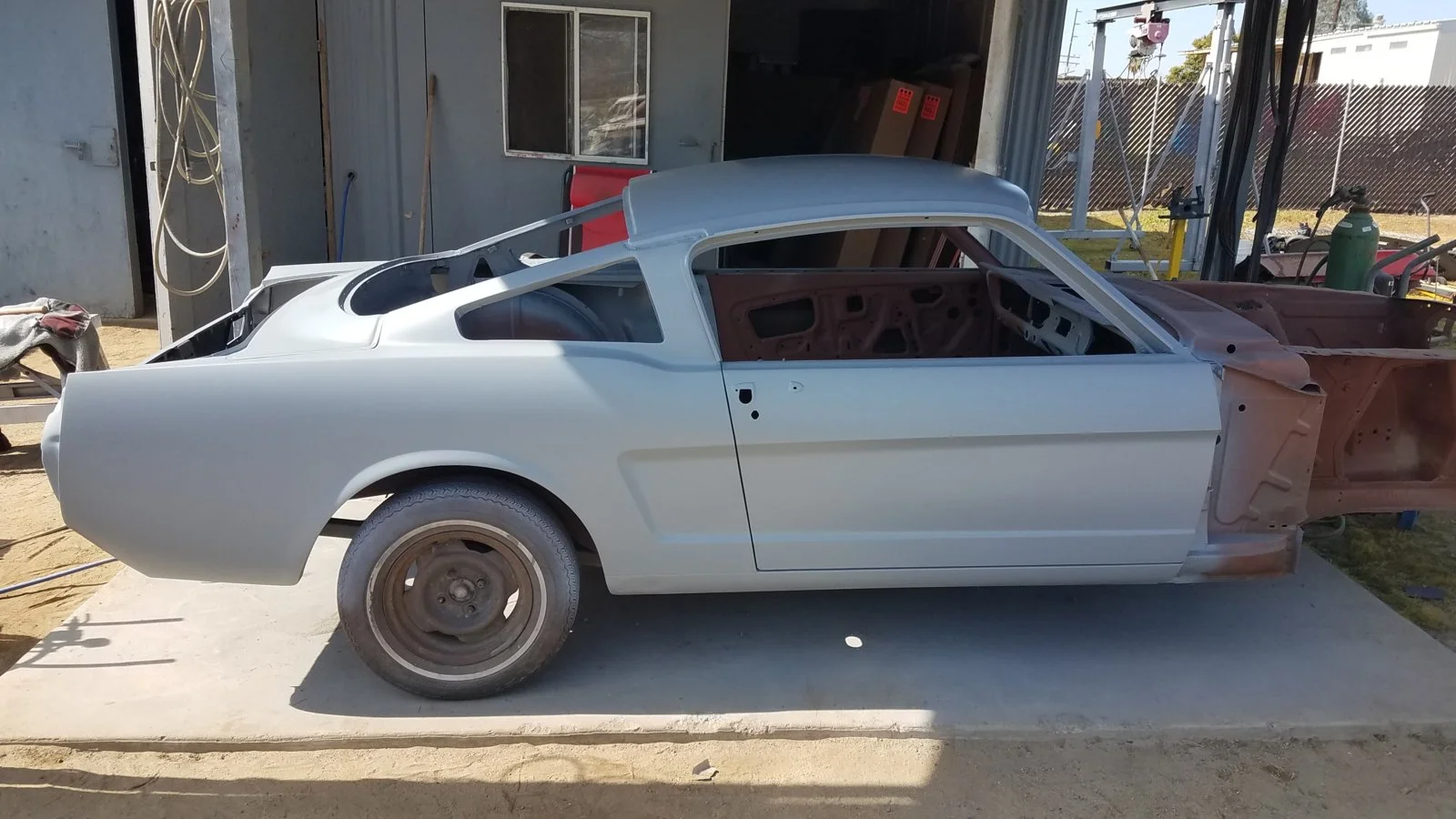

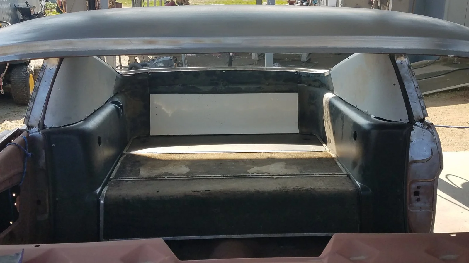

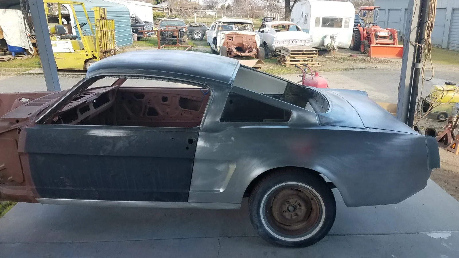

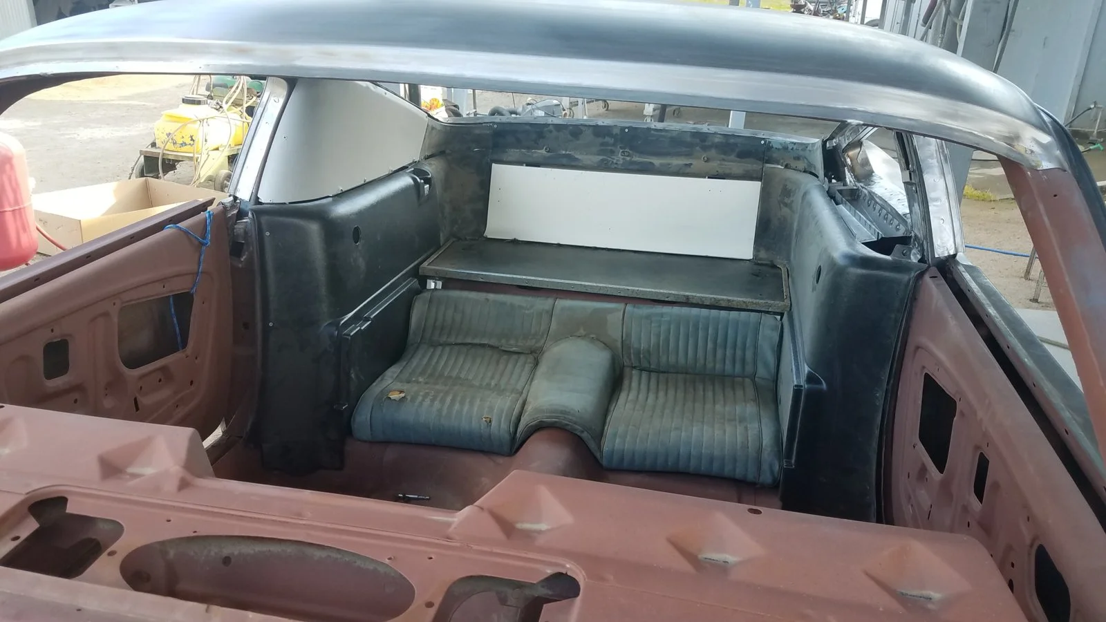

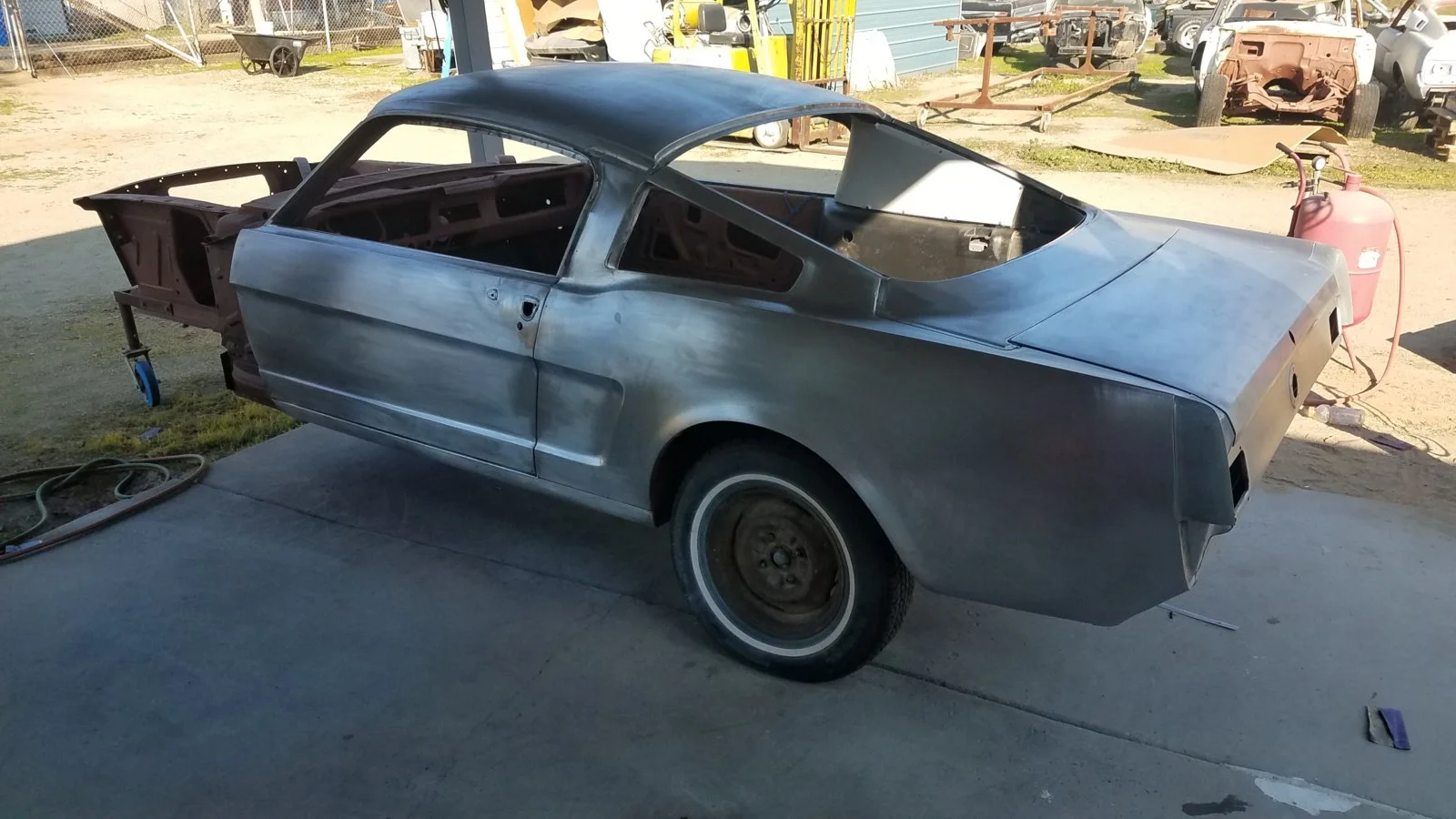

What kind of work is involved in retrofitting the vents in favor of quarter windows?
The door opening is taller for 67 68 must be cut down ,it is to long and must be shortened ,it is the same shape but i have to make several parts that are different on the 67 68 .
I have to make the complete quarter vent or quarter window opening .if you do not have somthing to measure from placement of the new pieces is very hard to do

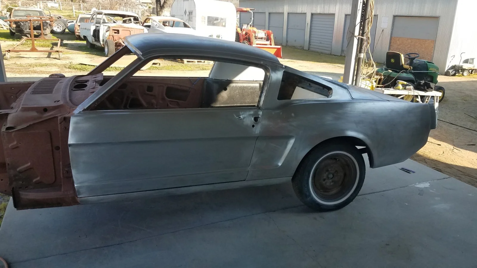

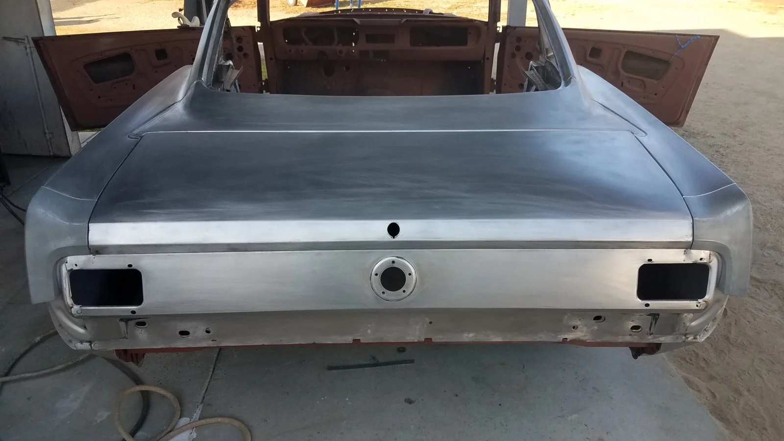

Is bare metal a color ? Cause i like it !

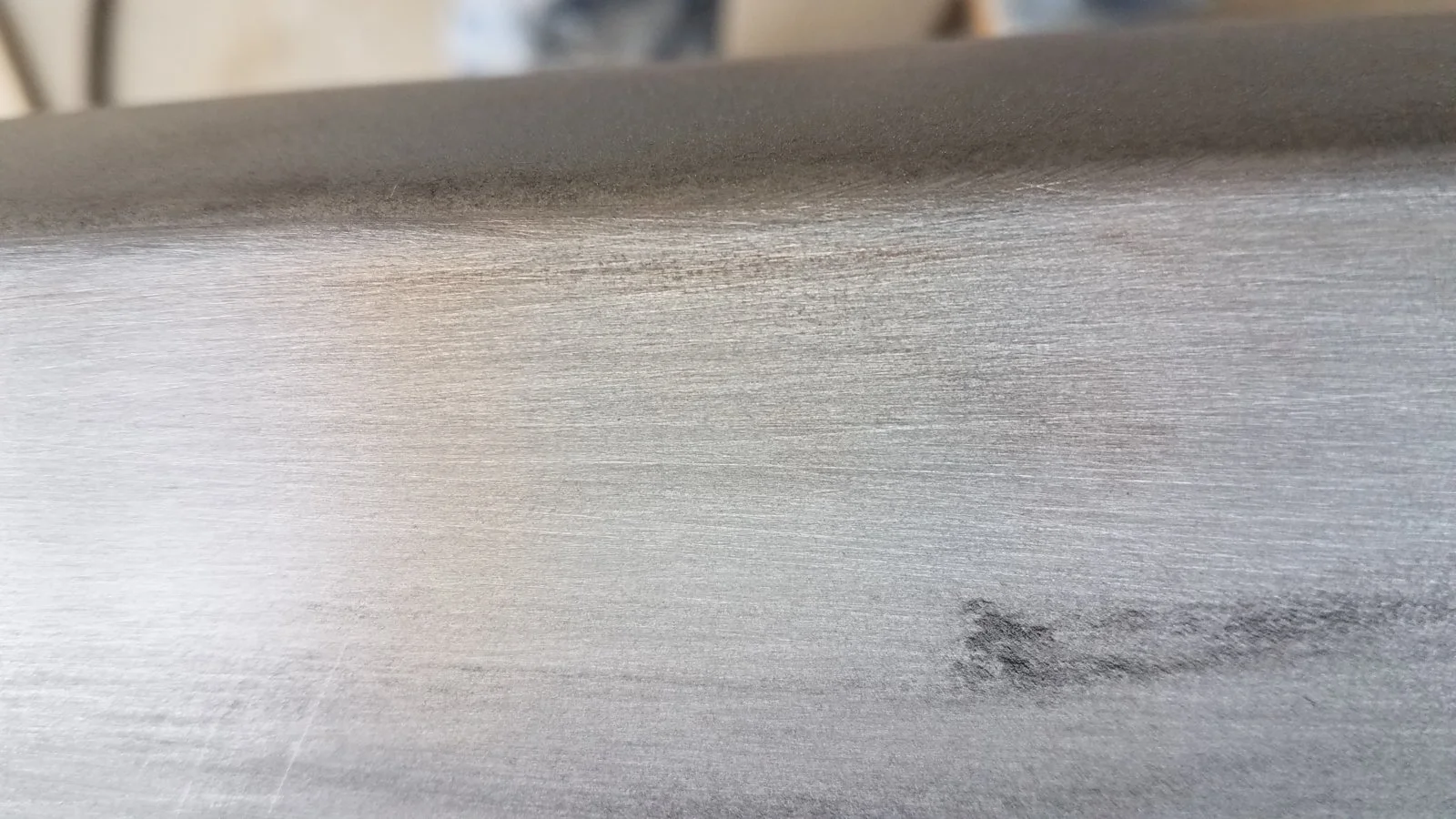

Why sand off the coating you ask ,hidden rust under it . This is nothing ,i have seen a lot worse

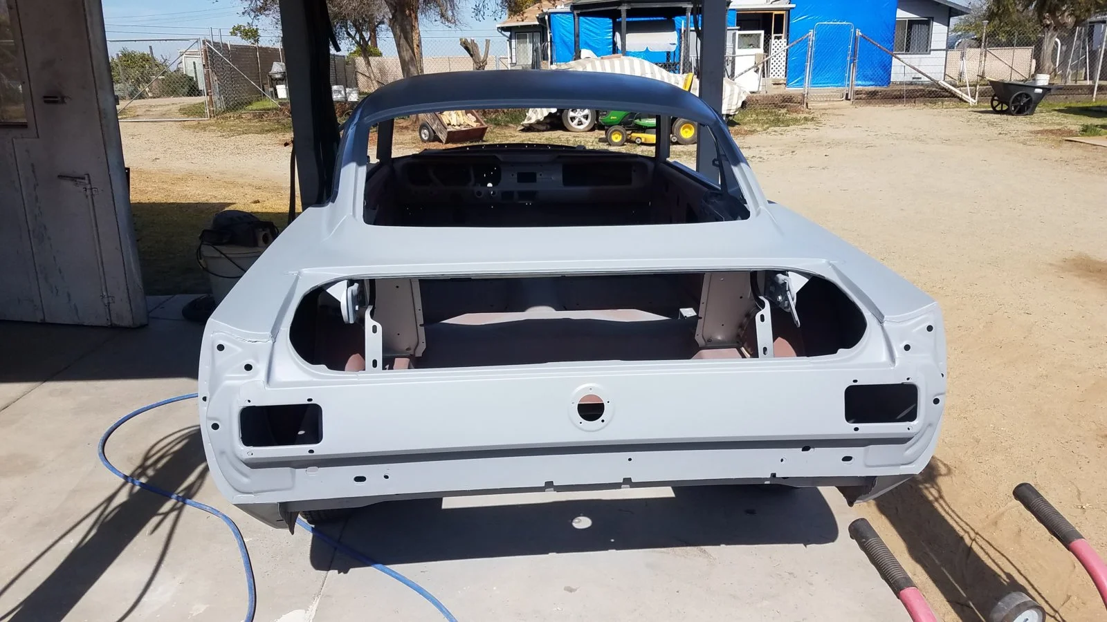

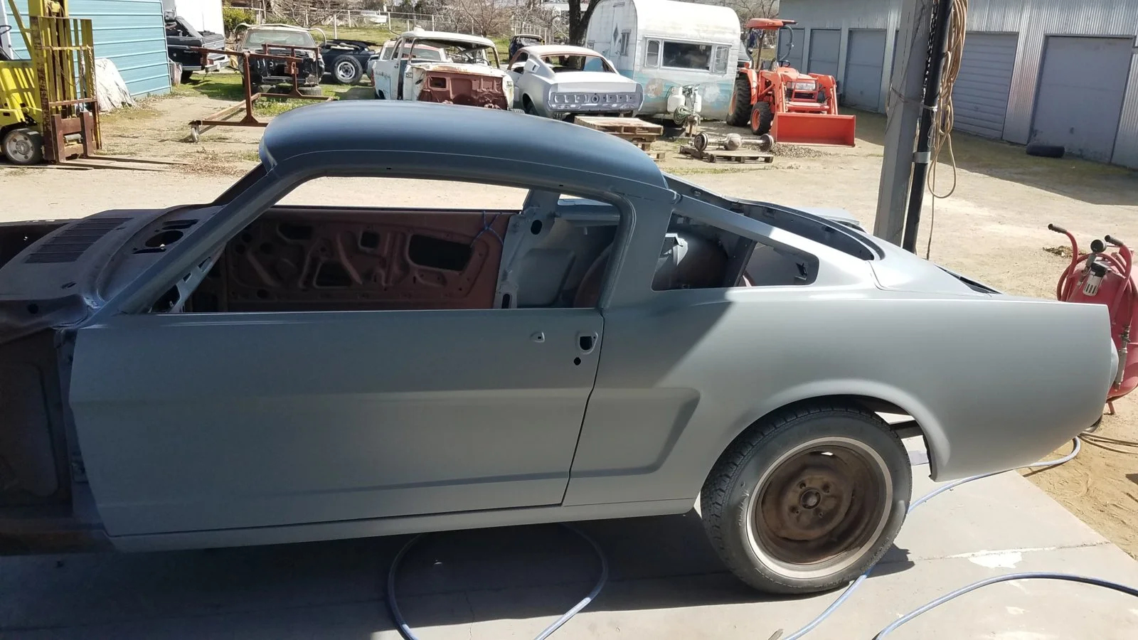

The hours are really not that much ,actually far less than a restoration . There is almost no body work ,we have been on this for only about 7 days and soon we will be ready for paint .
We have around 4,000 in new metal and the car cost me 800 so we are into it very cheap ,it is just the small amount of time we spent and all the fun
