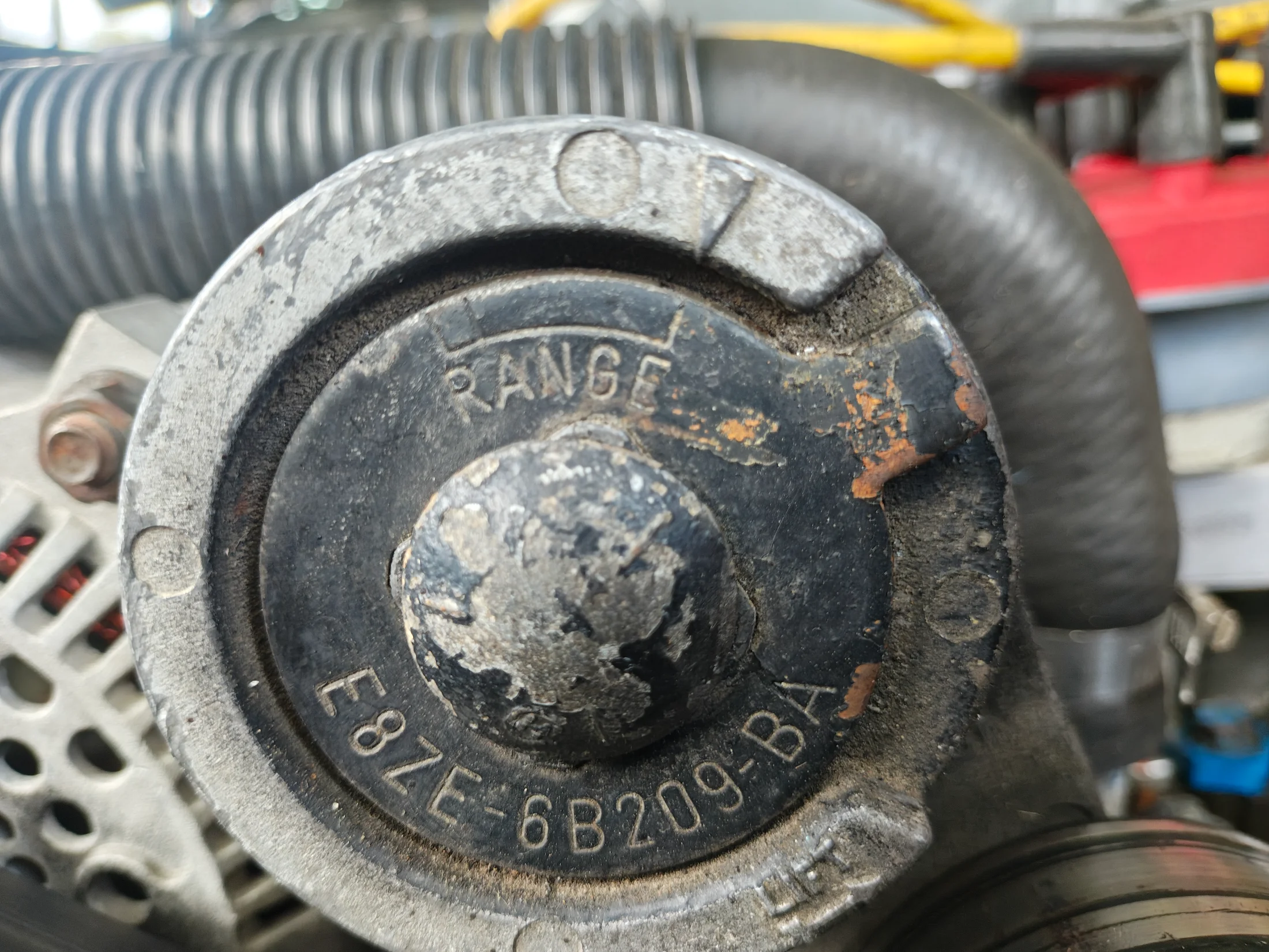

Smaller belt is on. Kinda put the tensioner back in range. It was a bear to get on. Don't think I could go any smaller than that. Could this tensioner just be on the outs? Looks to be an OG Ford part.
TB is hanging open a tiny bit again. Idles a little high and whistles while stopped. Not every time, but here and there. I can push it closed with my finger and it idles normal and stops whistling. Next step may be to remove it and clean it up. It shouldn't be that dirty. It has less than 500 miles on it.

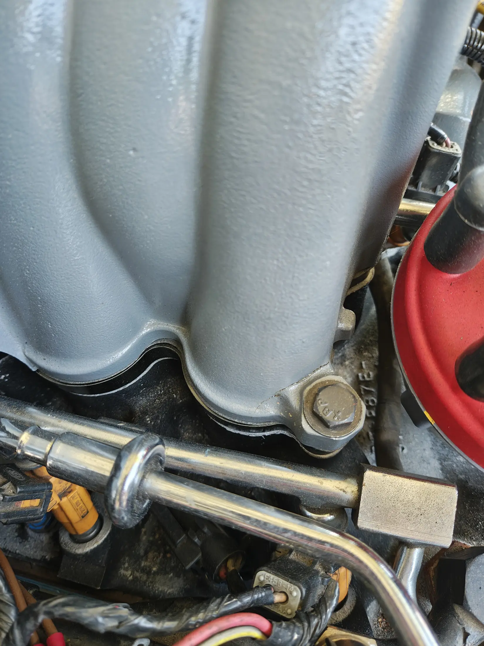

Well this is wonderful. Second plenum this summer. Torque is always set to 18 ft/lbs.
I am starting to think torque spec might be lower with the spacer in between upper and lower. Any input on that would be greatly appreciated.
Remove the spacer, I hate those damn things unless its a billet nitrous plate. I never torque the uppers, just hand tight with a 1/4" ratchet or one of those palm gimble ratchets if it's got some pita to reach bolts.. Never cracked one. As for the belt its the aftermarket ps bracket, its was designed to be use with the tension rod alt mount when march came out with them, not the stock one/ stock tensioner. It doesnt raise the pump location like the frpp a/c delete kit does.

I actually have two studs under the plaque. I will definitely replace the rest of the bolts with studs.

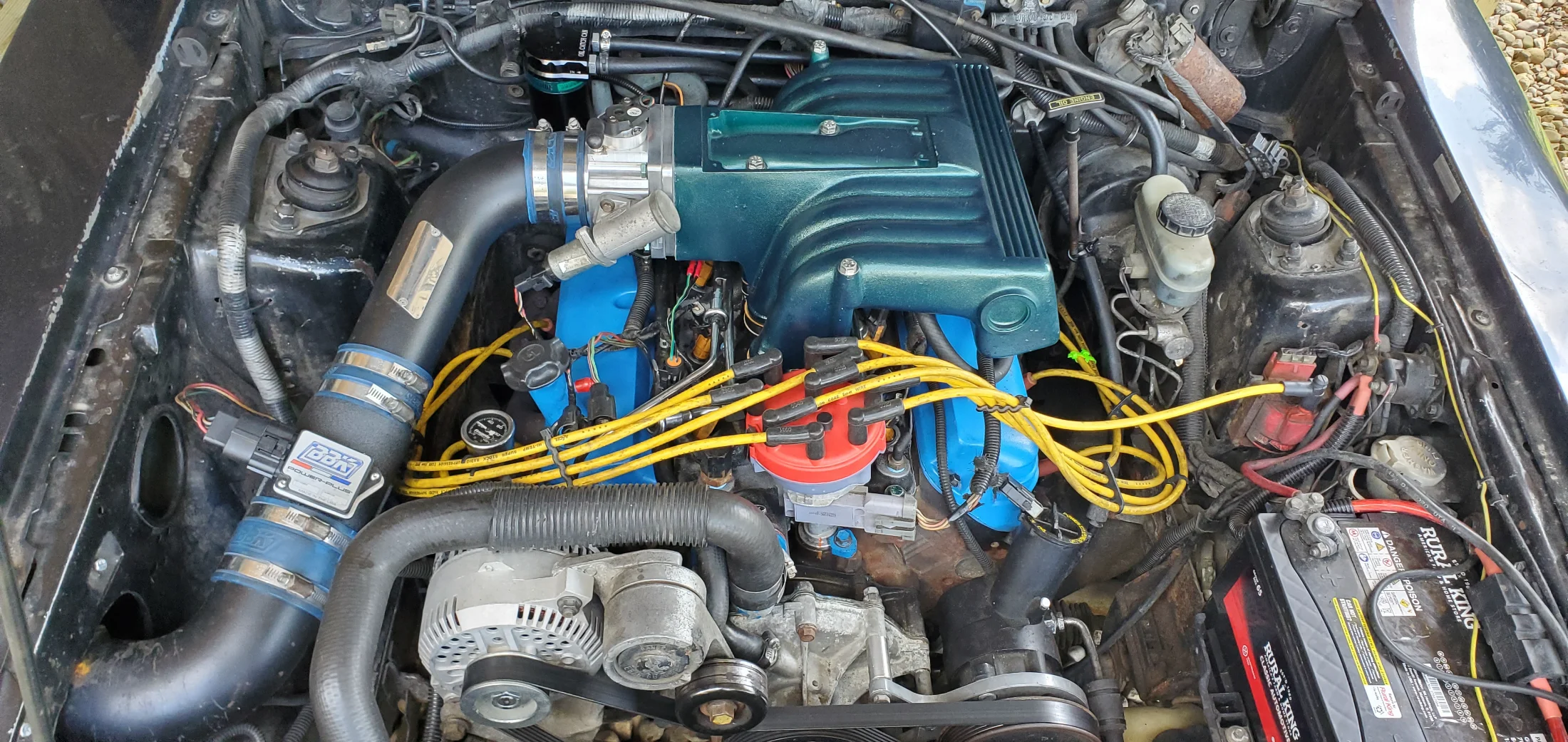

I will remove the spacer when I get the coolant tubes off. The EGR spacer was replaced with a 70mm non EGR spacer. Without the phenolic spacer my throttle cable hits the coolant tubes. Haven't gotten that far yet. Probly won't anytime soon. Sitting in ER with my oldest son tonight. Snapped leg sending it on his dirt bike. :ack:
Picture is the other cracked plenum, but you can see the non EGR spacer.

Ah yeah either need a full size one or stack 2 of those to clear. Looks like the China 75 billet t-body. clearance shouldn't be a problem once its spaced out to the the stock location, my egr hasn't been hooked for up almost 10 years in my beater gt, heads don't even have the ports for it. no vaccum to the valve, still plugged in with the valve bolted to the accufab spacer on it, it might flash the CEL once in a blue moon for it and go away once the keys cycled. No need for all those delete nonsense besides causing more headaches or removing stuff. I don't think I have any spare ones left but I'll check my parts shed next time I'm out there.

It is a 70mm chinese TB. Good eye. The spacer swap was mainly to get the bigger bore and my egr spacer was dog ass ugly... You know, the lipstick on a pig thing.

Ah..nevermind, I run a fenolic with a combo of studs and bolts, I glue (blue silicon) all the upper to lower surfaces and gaskets and a good snugg, a few heat cycles and check snuggness (is that a word?) But remember, I'm a hack.
