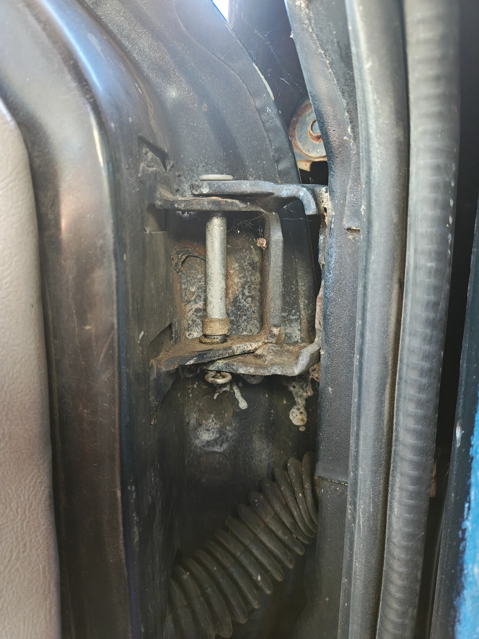

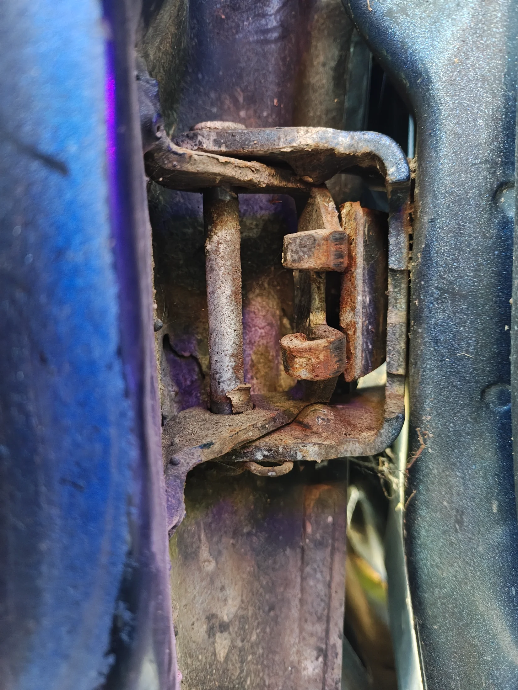

Driver door always sagged a little. Got real bad one day out of the blue. Must've exploded the last remaining bushings. All 4 of them were broken. @2000xp8 mentioned in a thread from last year about hanging a door from his garage ceiling. I park under a leanto so I just put a ratchet strap around the door and to the rafter and went up a click at a time until I could see the pins move. Tapped them out and replaced them. Pretty simple. Only issue I had was the cotter pins. I absolutely could not get them into the new hinge pins. Can the hinge pins back out without the cotters in? Im guessing the new pins weren't drilled correctly or they are a little shorter. Door closes so easily now. Very happy with the fix.
Not very good at keep track of my work with pictures. I get to working and it just slips my mind. I'll get better..... Maybe.

See of you can get a clamp on the hinges to squeeze them and then maybe the cotter pins will fit. Mine didn't fit well either. In fact from the first time I did it 20+ years ago, I have a baby pin in it.

It really wasn't that bad. Just get good support on the door so you get it in the sweet spot and they will come right out. They were definitely replaced at some point. Pins were actually in pretty good condition. Bushings were what gave up the ghost. I got a little hung up on the fender on the top pin. My fenders are all bent and creased any ways so I just pulled the pin out all willy nilly. Actually pulled my other fenders out over the weekend. Maybe I'll do that next.... And take 2 pictures at the start of work. :doh:

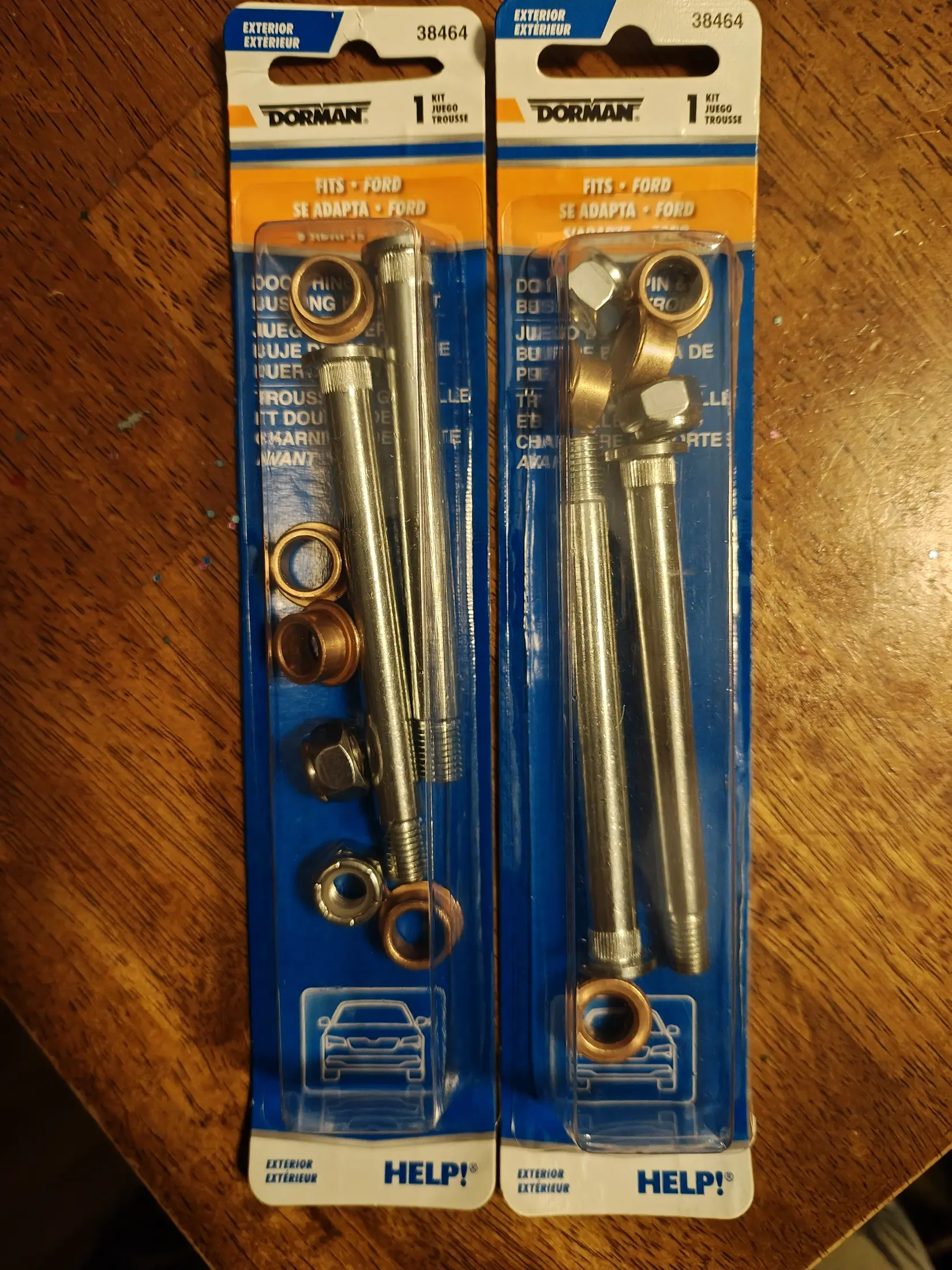

I absolutely despise the fox body replacement pins with cotter pins or e-clips, yes they can back out if the hinges egged out bad enough. I switched to the threaded style pins as they replicate the factory swedged pins and provided some what of a clamp load.
Around 17 1/2 min mark in this video, he shows exactly why there so much better.
View: https://www.youtube.com/watch?v=R_N0aje89mY
E350 hinge pins, killer idea. Props to @rednotch. Can't wait to get them on and open and close the door a bunch of times.

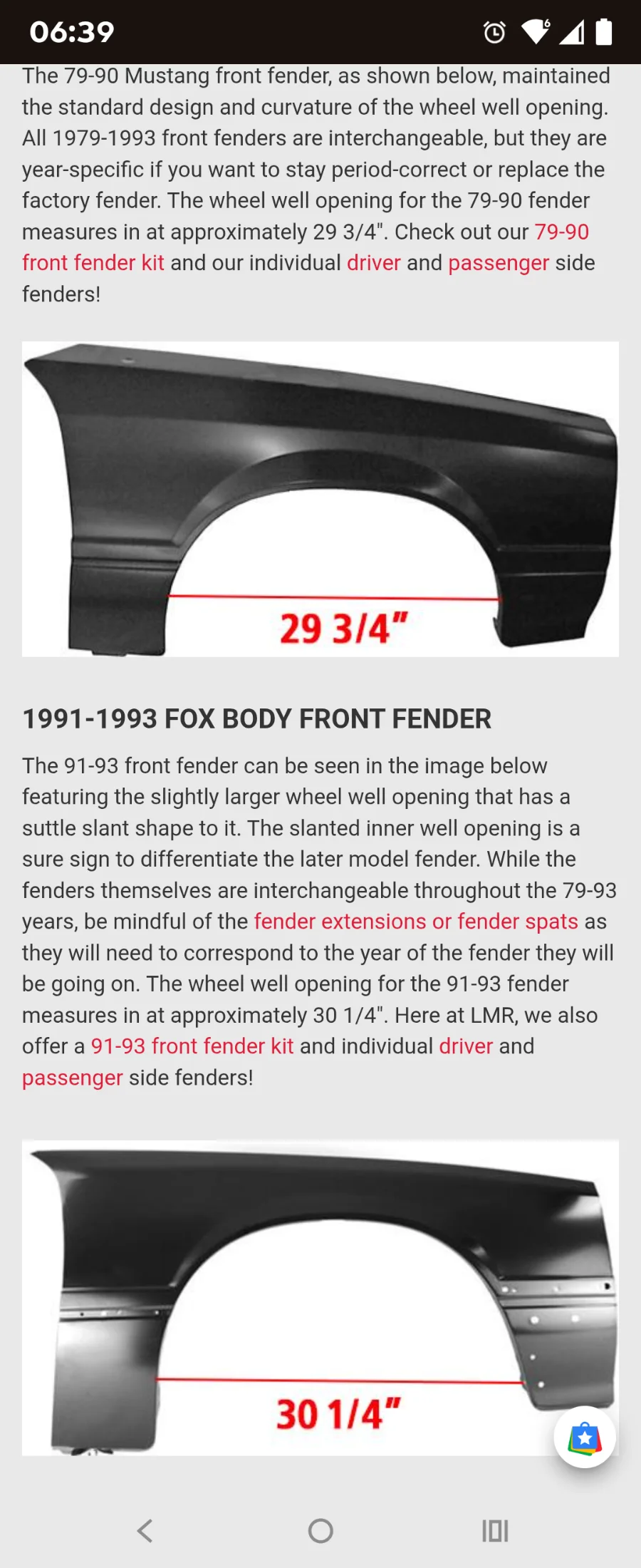

On another note, measured the forward most lower part of my fenders. Turns out, the fenders that came with car are the wrong ones. SOB!! Guess I'll be in the market for some fenders. Shouldn't be hard to find, just sucks cuz I was ready to rock with what I have.

So can you get the E350 hinge pins in so that the nut is on the bottom on both hinges? Only asking as if the nut ever came off this would at least give the pin a chance to stay put.

I would lose my mind trying to recall the fender changes between 79 and 93. LoL
Fortunately, I know where we hide stuff. :ninja:
YearsFender geometry
1979–1982Original wheel opening.
1983–1986Same basic fender geometry despite the nose changes.
1987–1990Same basic geometry carried into the aero cars.
1991–1993Enlarged wheel opening for the factory 16-inch wheel/tire package. The lower front edge of the opening angles farther forward, shortening the section ahead of the tire.
Top pin all ways goes in from the bottom side up do to the body line of the door but There nyloc nuts, they ain't backing off..

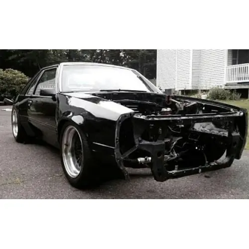

As for fenders if your not running an after market k member that pushed the wheels forward or huge rim/ tires not really a big deal. Worst part is collecting the trim to match with hodge podge stuff like that, my beater 93 gt had a 87-90 lower spat on it when I picked it but the correct 91-93 fender, other than me knowing it was wrong, being half ass glued on and it being gray vs white, wasn't really an issue with a stock k member and 17x9's with 245/45r17's..
