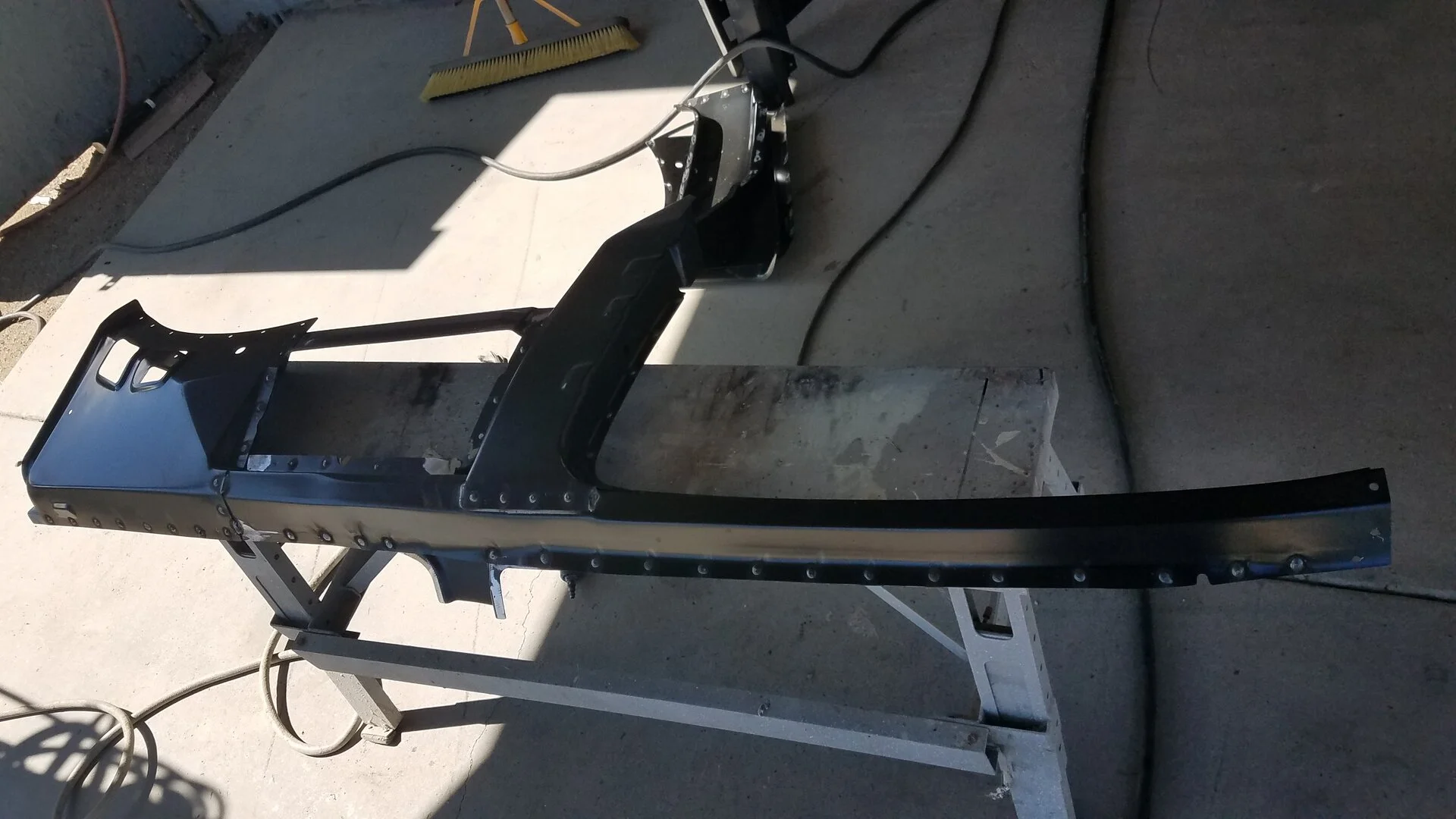

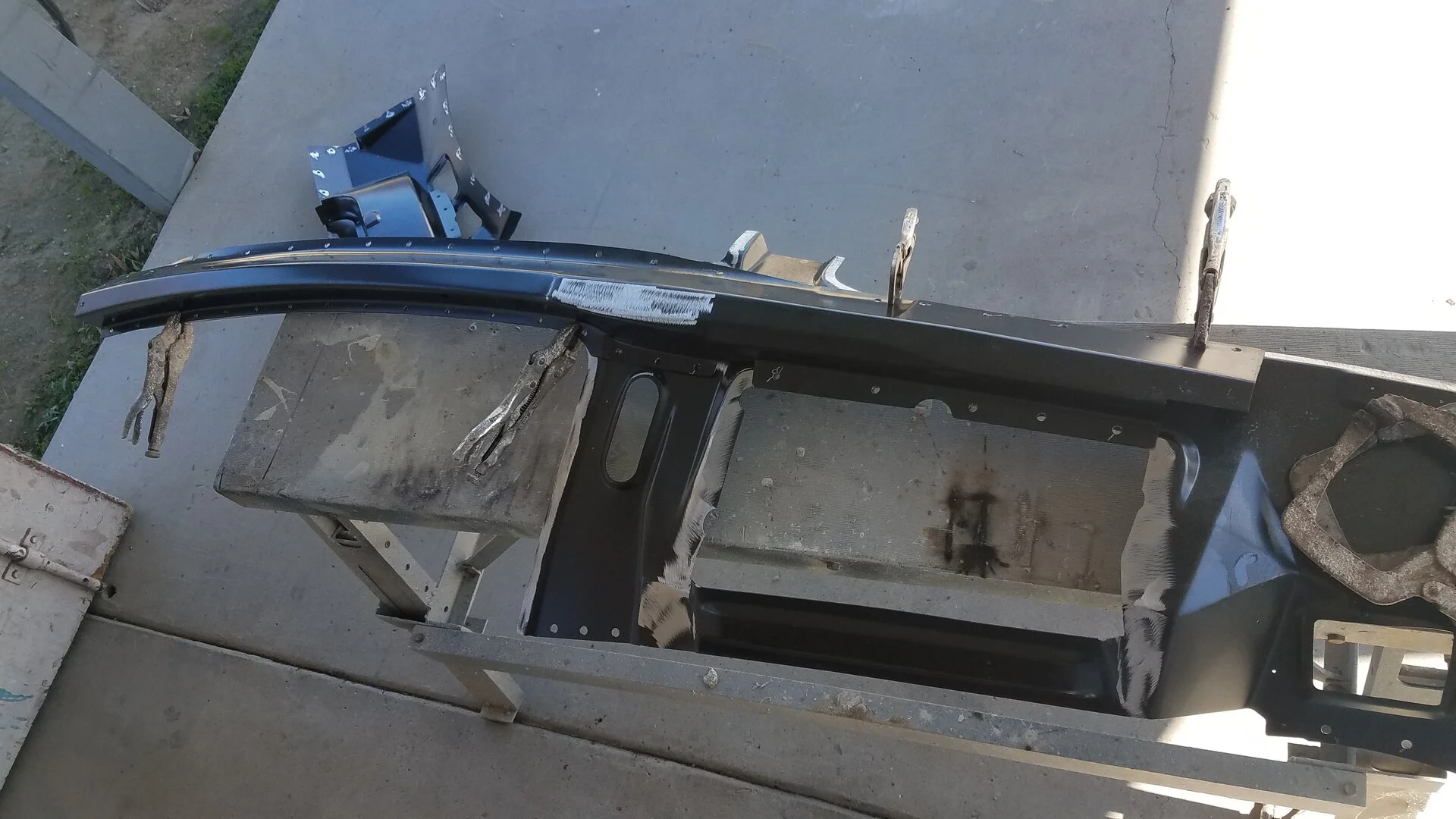

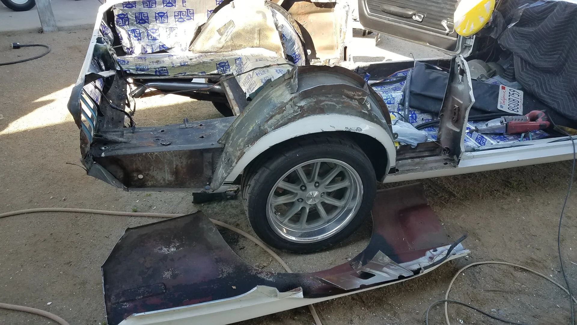

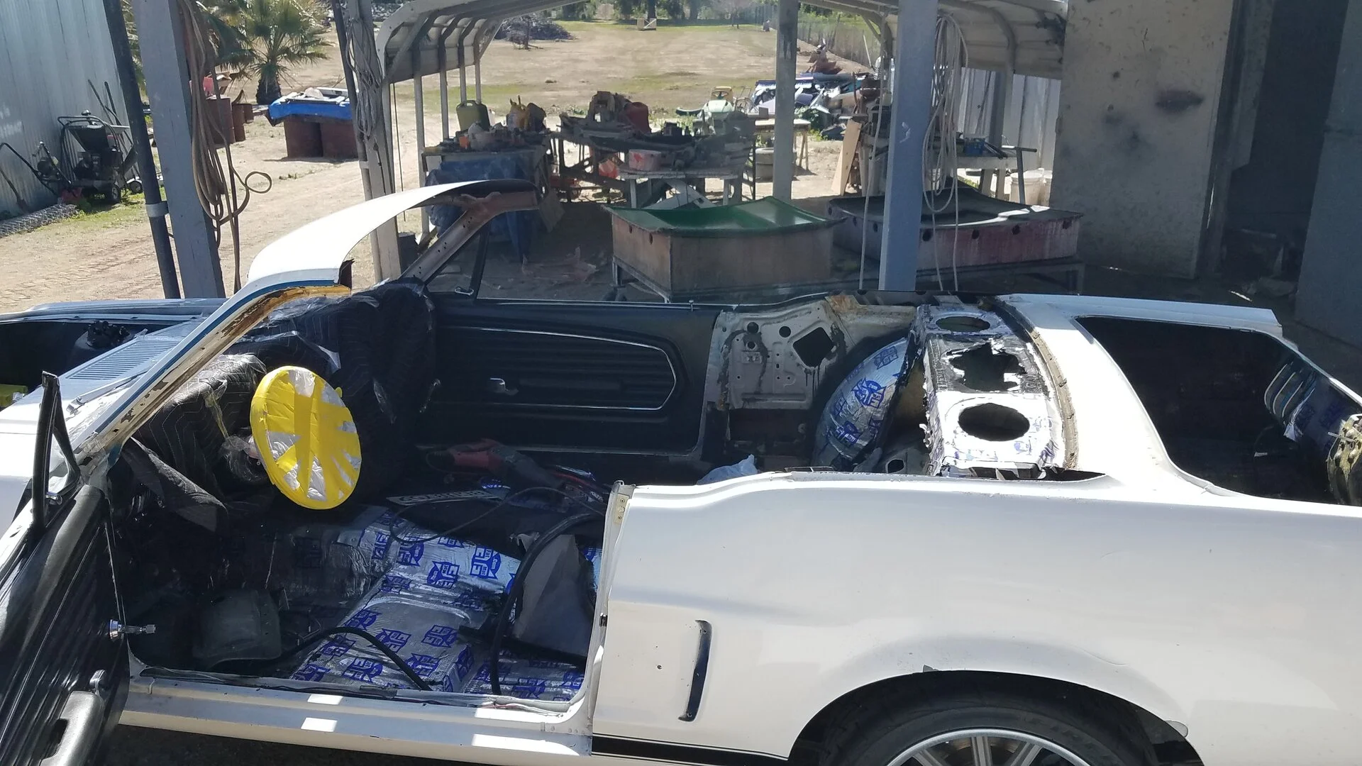

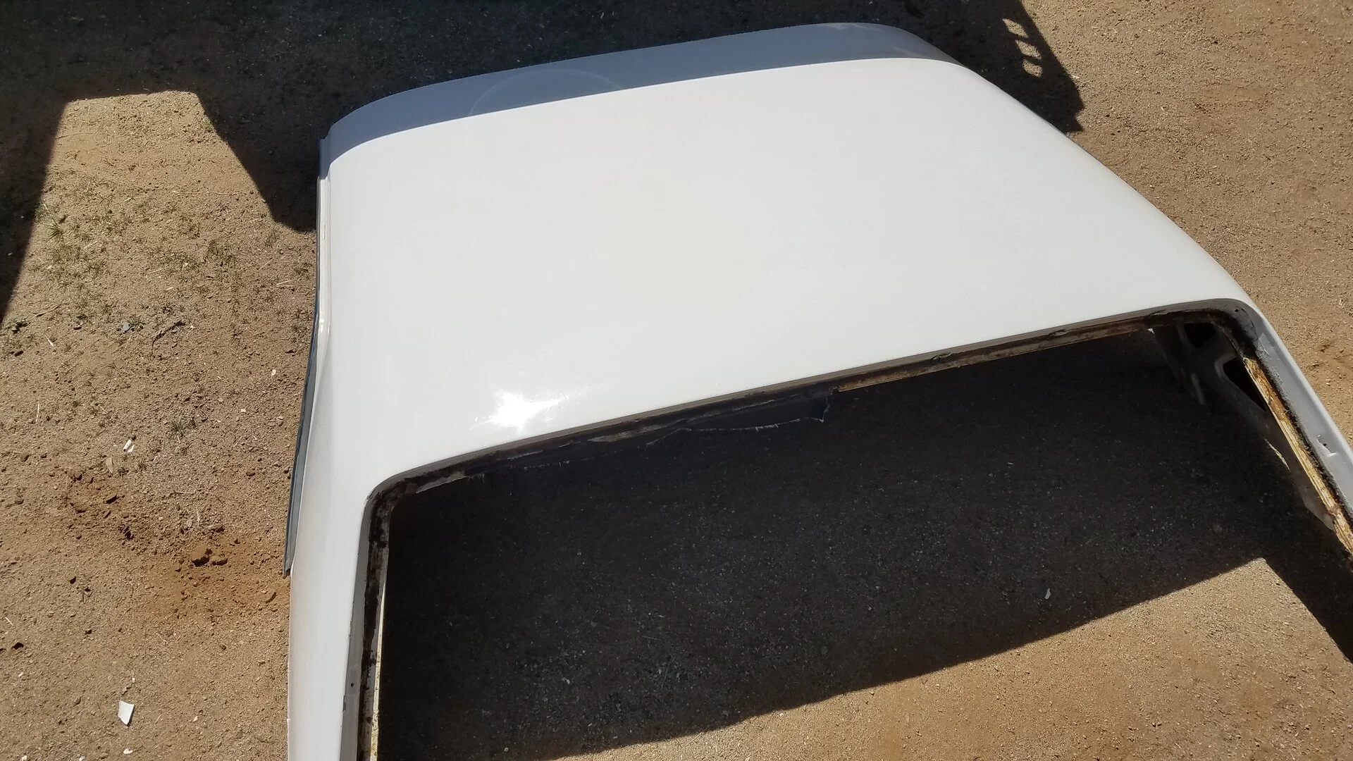

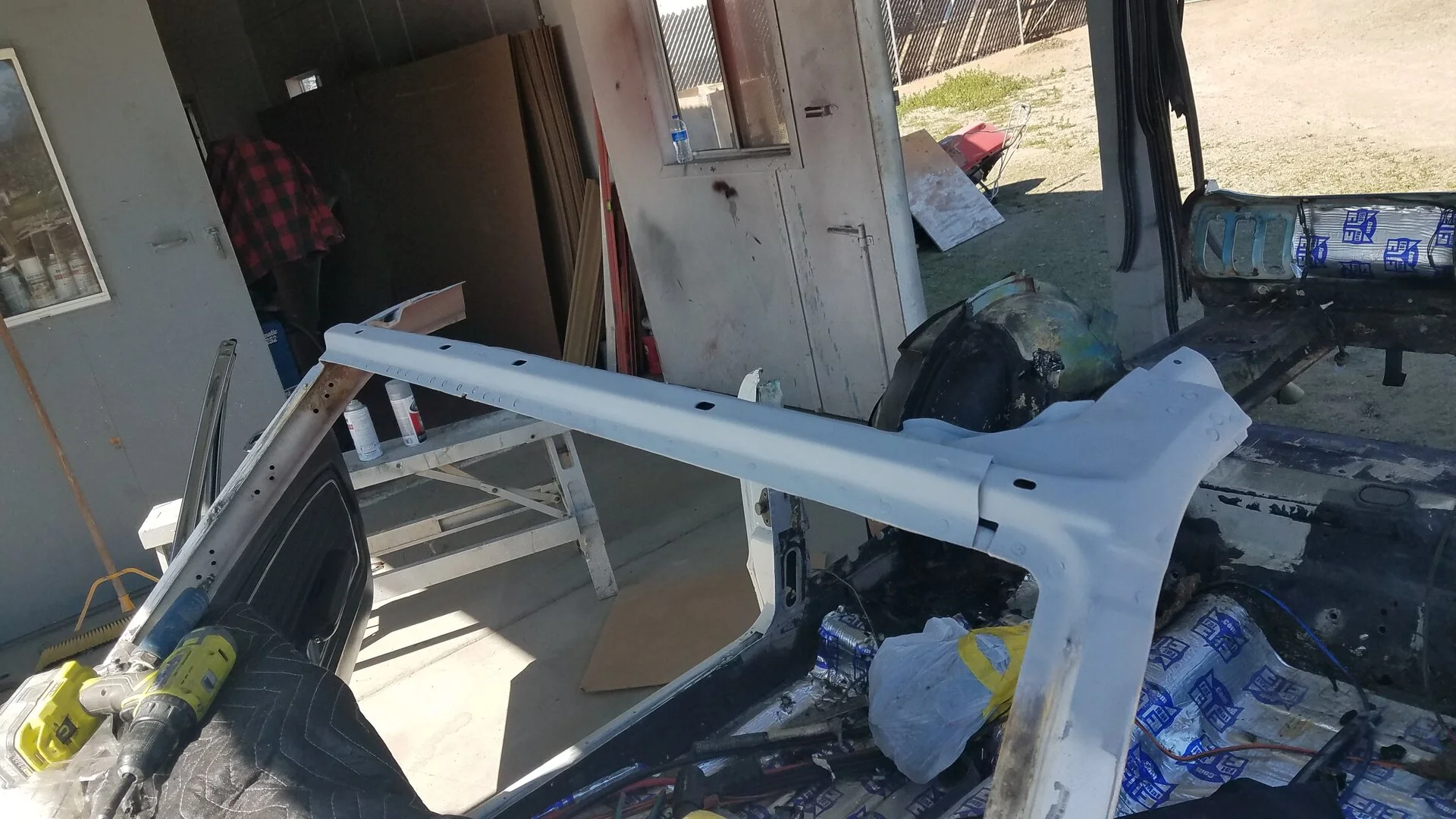

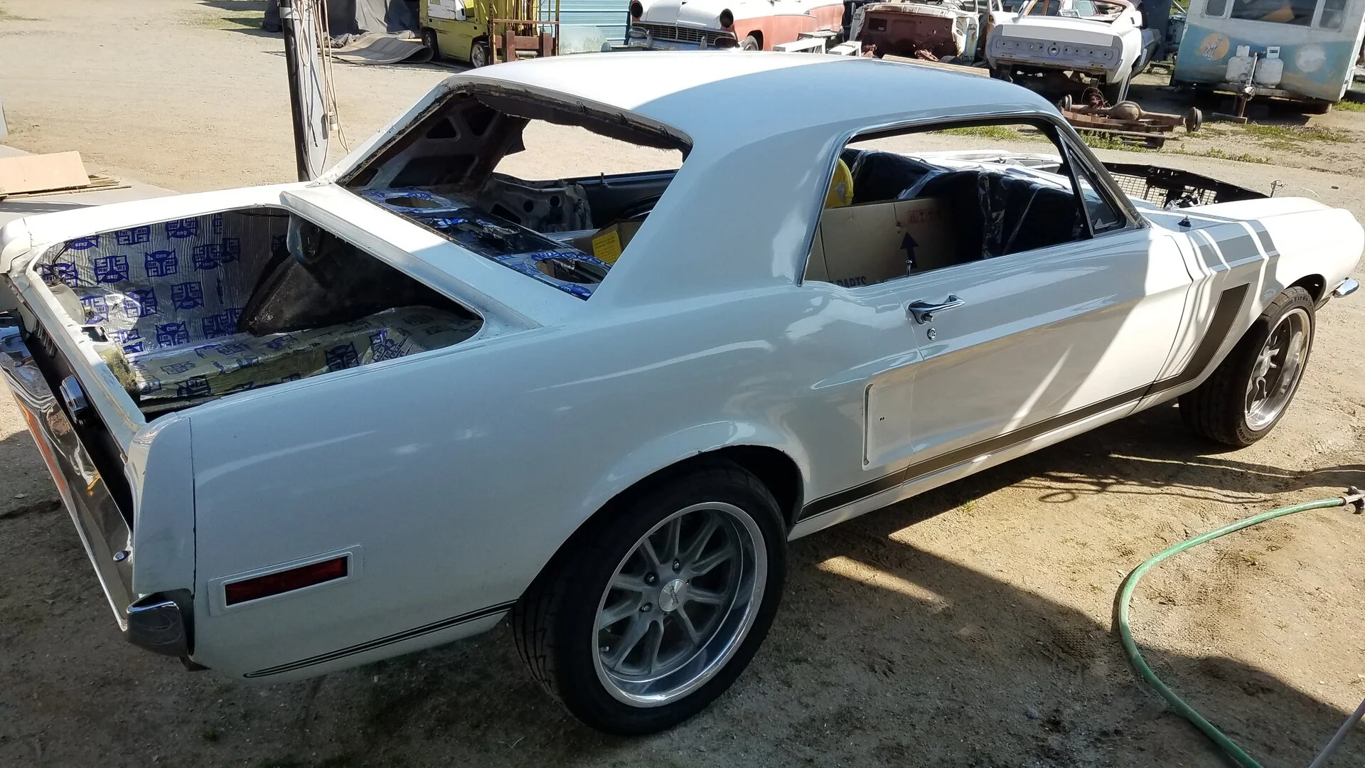

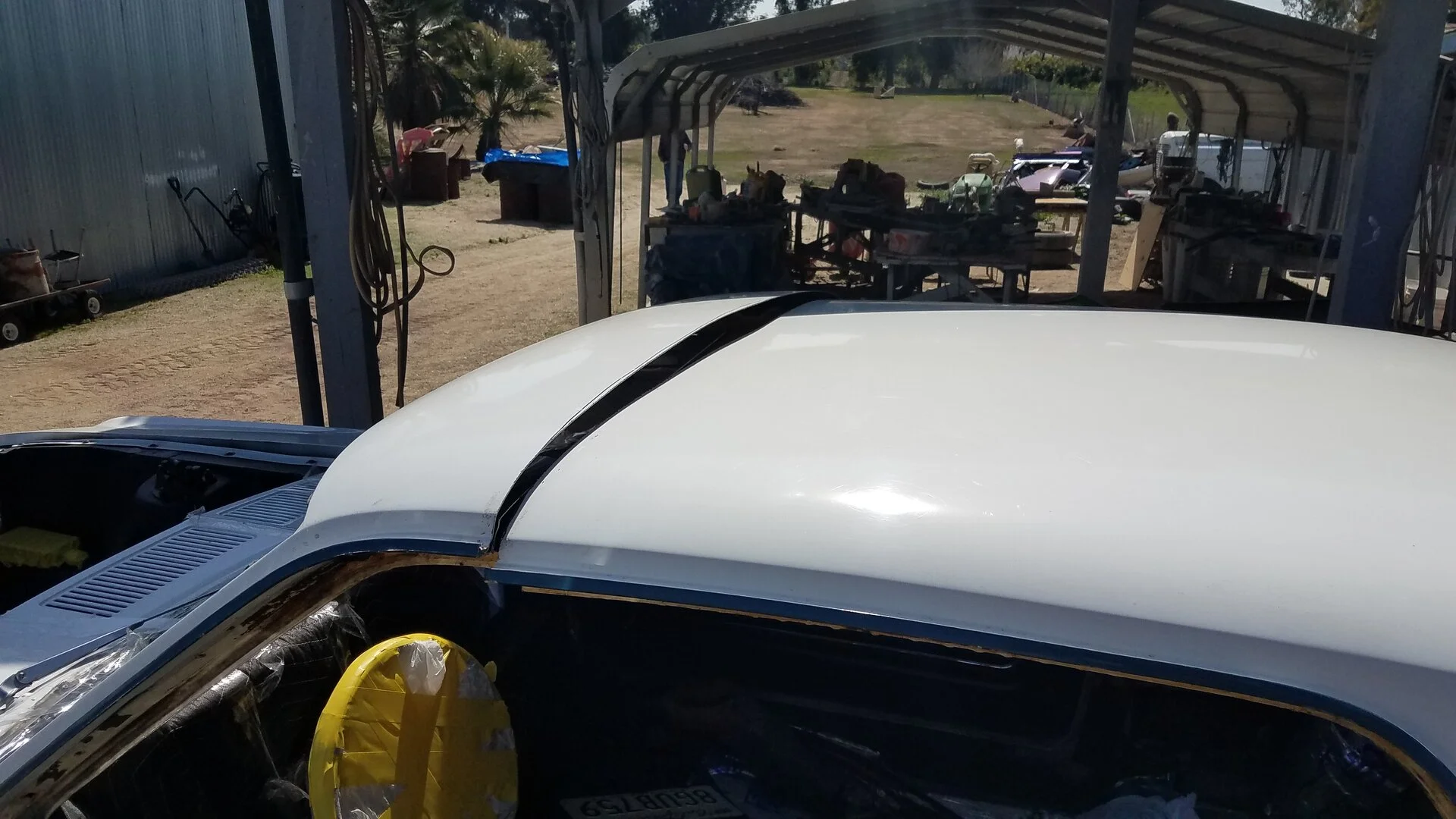

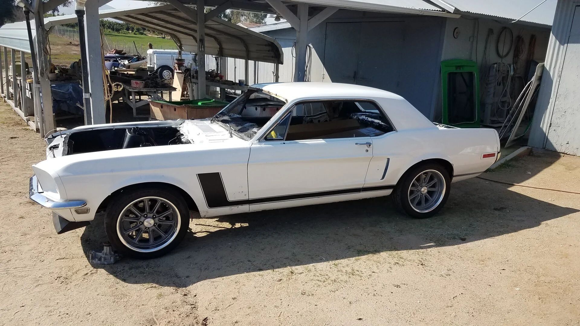

We have a nice 68 coupe belonging to one of our Stangnet members getting ready to convert to a fast back . Everything is here and ready to go . I should be lopping of the roof tomorrow

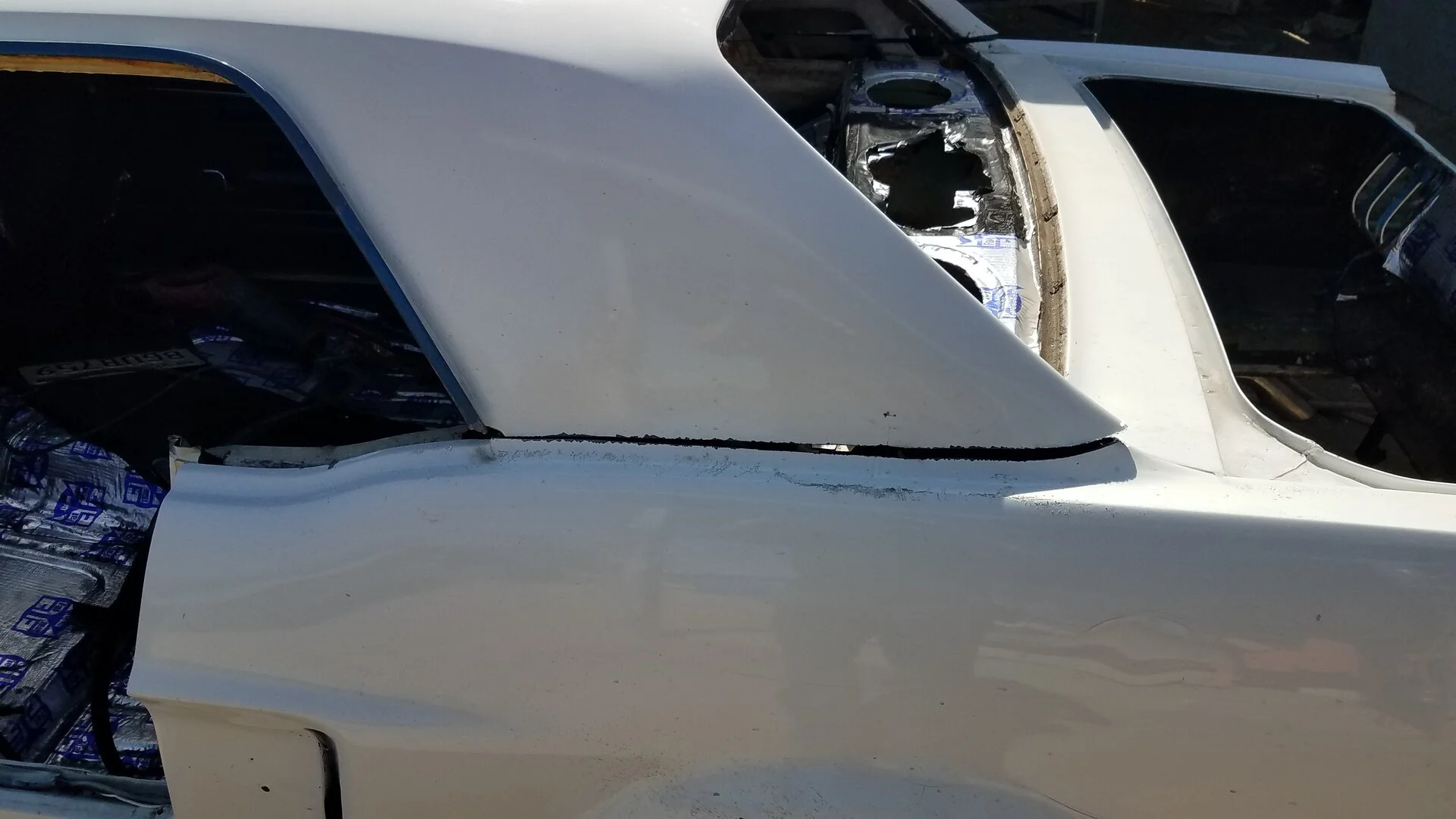

The only way i can get it off is cut it in one inch strips and pull each piece ,it is really stuck down

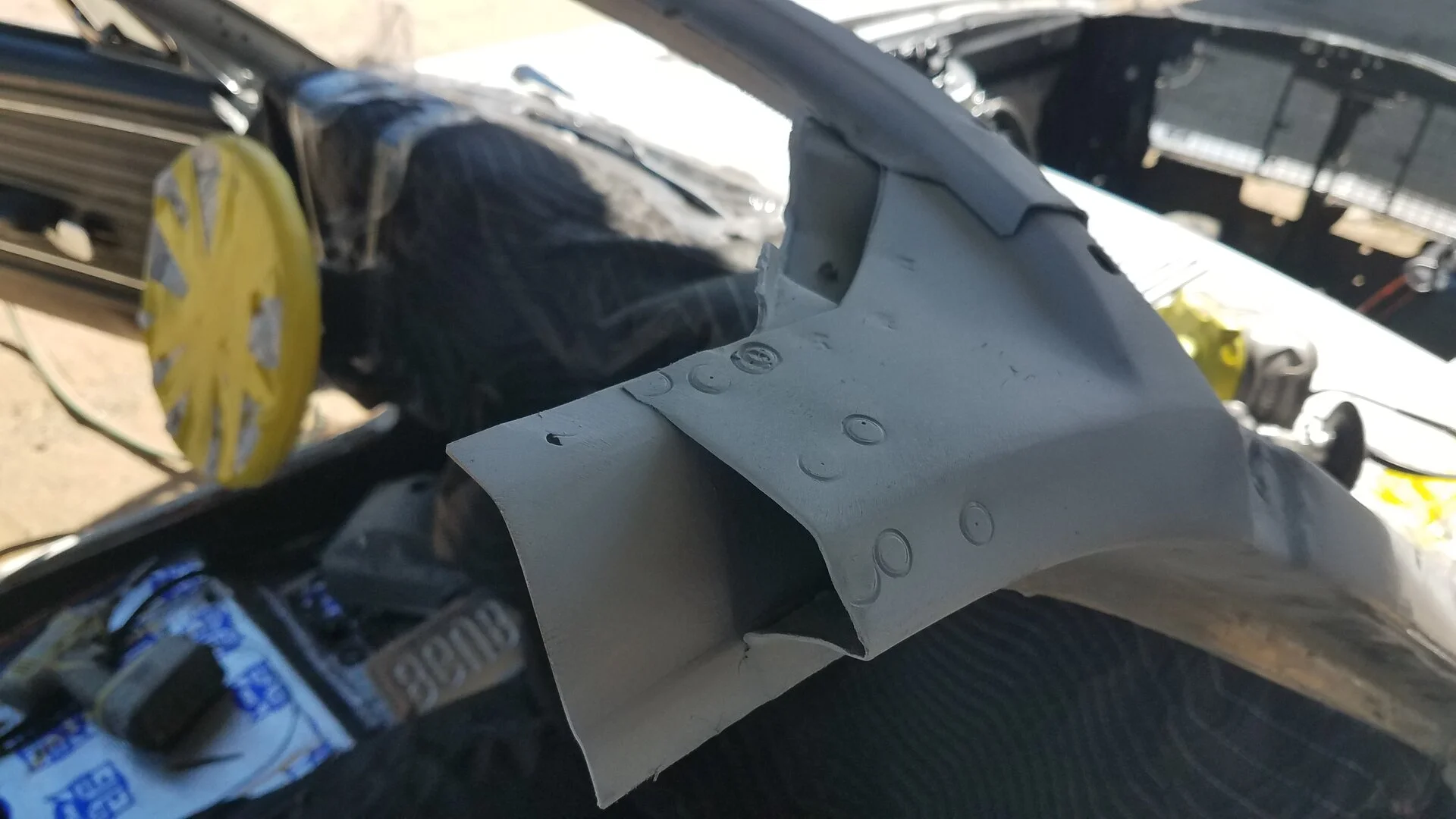

One trick you can use is dry ice(not sure if you can get it cold enough with regular ice, but dry ice leaves no moisture). If you freeze it, it often becomes somewhat brittle, making it easier to remove if its the sticky type(only worth doing if its the sticky type though, which is going to depend a lot on brand and age)
