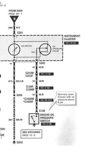

10W-30 all year round in DC is fine. The stock gauge isn't really a gauge; It's just an on/off switch that triggers at 8psi. If the gauge is moving around too much, it's your alternator, not your oil pressure.

I'm surprised by that. Ford did away with an actual gauge in the 80s. Customers were freaked out by the oil pressure gauge moving around on them when engine RPMs changed. After that they just put a sweep style gauge that went to a specific point on the scale when the sender hits 8psi. The ground is regulated off the sender, but the positive is obviously affected by voltage.

Beg to differ there, Kurt, though you're right about your SN95. Fox senders were better than switches, but still suck and not to be trusted:
Fox:
SN95:
Anyways, OP, your oil pressure is most definitely NOT too high. Probably a bad sender. They're cheap. Easy to replace.

Thanks fastdriver - the switch diagram was awesome explanation ! As was the W info . The reason I considered synthetic is many cold starts in winter - that stuff seems to flow great when very cold - I will look for a syn/syn blend for higher mileage vehicles ( has seal saver additive ) - one question , back to original title - all things equal , will a 40 weight yield higher oil psi than a 30 weight ? And which is better for 100 degree days - also based on stock Fox gauge , where do I want the needle at idle and where at harder throttle - thanks
#1 don't depend on the stock gauge, get a aftermarket gauge even if it's just temp to see where your stock gauge is reading.
the stock gauges will read different between different car and even changing the sending unit can change the gauge readings

Like Karthief said, stock gauges suck. They're not meant to be compared across the board. You should have pressure and it should act like it normally does. If something changes from what you normally see, then investigate. Otherwise, leave it be.
