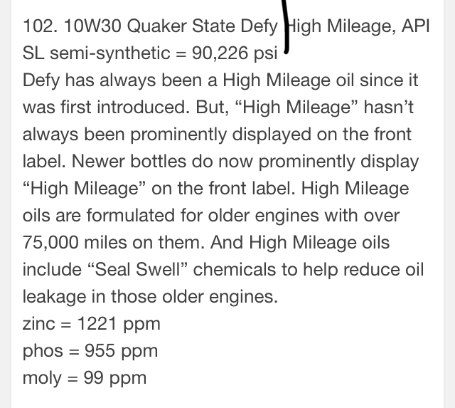

Oil pressure too high means oil is too thick ?
Btw if you look at my previous posts on “ oil comparison “ the 90k psi # is very good - 125k + is top of line - 50k is bottom of line - this guy does not give too much credit for zinc though , which apparently is an old school favorite for cutting friction

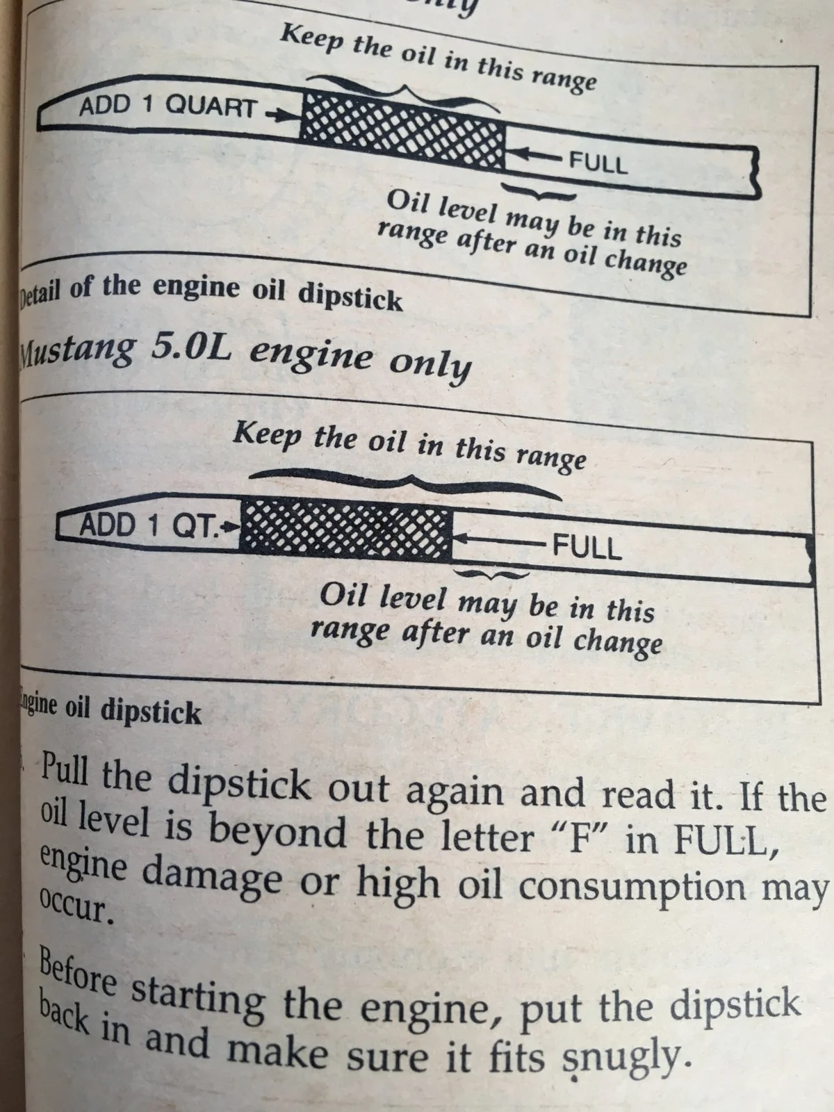

5 quarts is right. Dipsticks are wrong too. Basically anything that measures anything on a fox is wrong.... lol Why do I love these cars?!
If you overfill by a quart, it's probably not going to kill anything, but I would drain the quart back out if I were you. I've left 1/2 a quart extra in a car with no ill-effects. 1 quart makes me a little uncomfortable, though, but it's still probably ok. The crank will end up with too much windage. Hurts fuel economy, power, and could froth up the oil causing air pockets which is a no go.

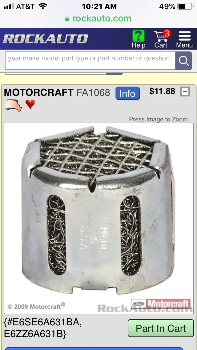

Question on the crankcase filter under the PCV - what holds it in the hole ? Looks like steel wool used - I would think the risk of metal threads deteriorating and getting lodged in valve train will be an issue .
Once you pull out the pcv and the pcv grommet it's pretty easy to get to. I screw a wood screw straigh in the center just enough to hold it and pull it out with pliers. The stuff in it is thicker than steel wool. Sometimes a little gunk will h
old it in there and you'll have to try to scrape the crud out with a screw driver to get it to pop out. It's in an area that's hard to see...and kinda hard to get to without almost laying on the engine.

Again, don't trust the dipstick at all. Next time, let it drain really really well, put 5 quarts in, make sure you run it to fill the filter up, then mark the dipstick yourself.
When I had a fox with the stock pan, I’d always put 5 quarts total, with about 2/3 of a quart poured into my oil filter. Always used 10w-30 and never had issues.
