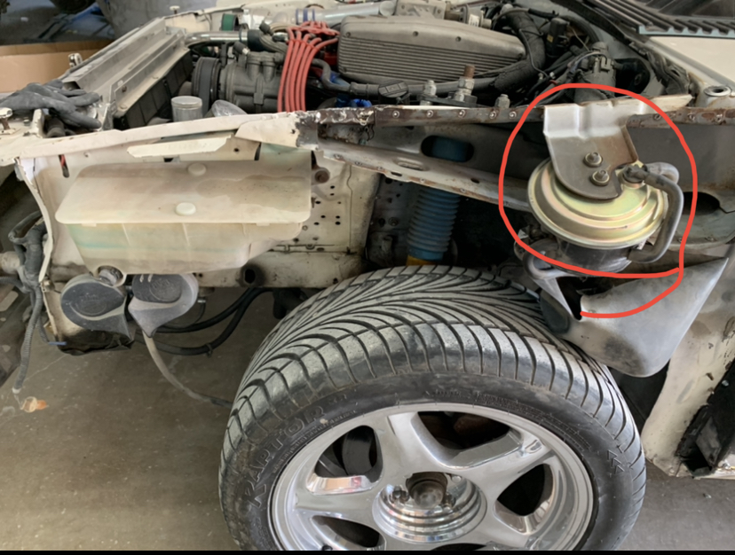

While the fenders are off I’m debating on if I should remove the water resivor since I don’t use it. What do you fellas think? Also what’s the item I have circled in red?

I don’t keep my wipers on the car.
Then pull the tank. But if this thing is ever being driven, I cannot see myself pulling the wipers, washer fluid or cruise control. My other main project came with single speed wipers and no bug juice. I finally found the NOS parts to change it to a two speed wiper and to add the juice.

Do what you want…….
Mine is a fair weather driver…… I pulled the washer tank when I did my my wire tuck and also pulled my cruise control, because I know I won’t ever use it.
I’m not concerned with resale because I plan on keeping it. The less crap under the hood the better!!

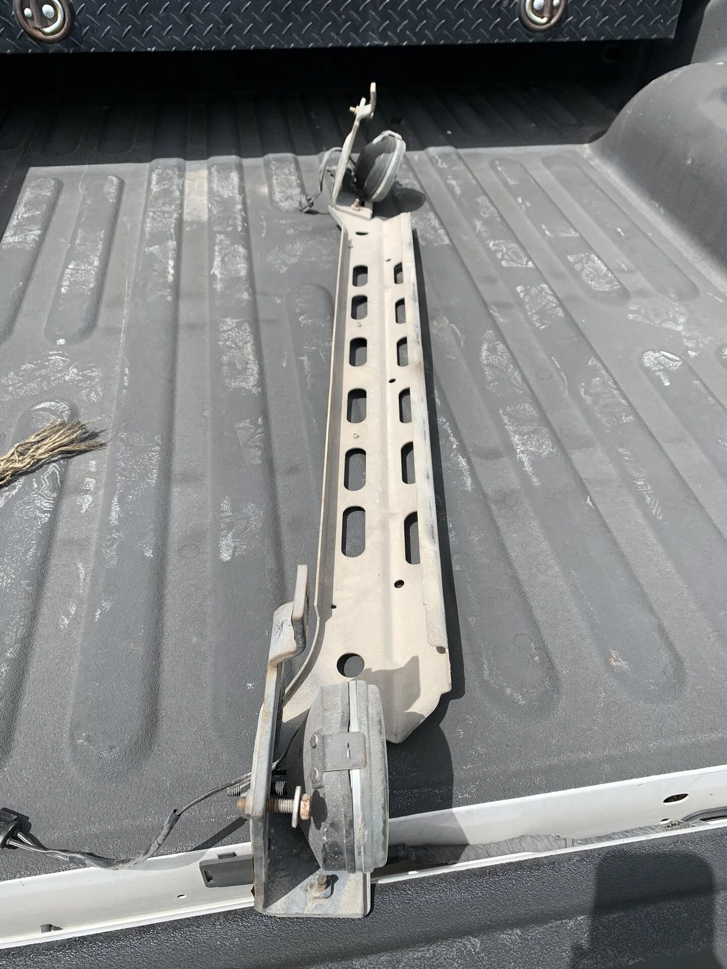

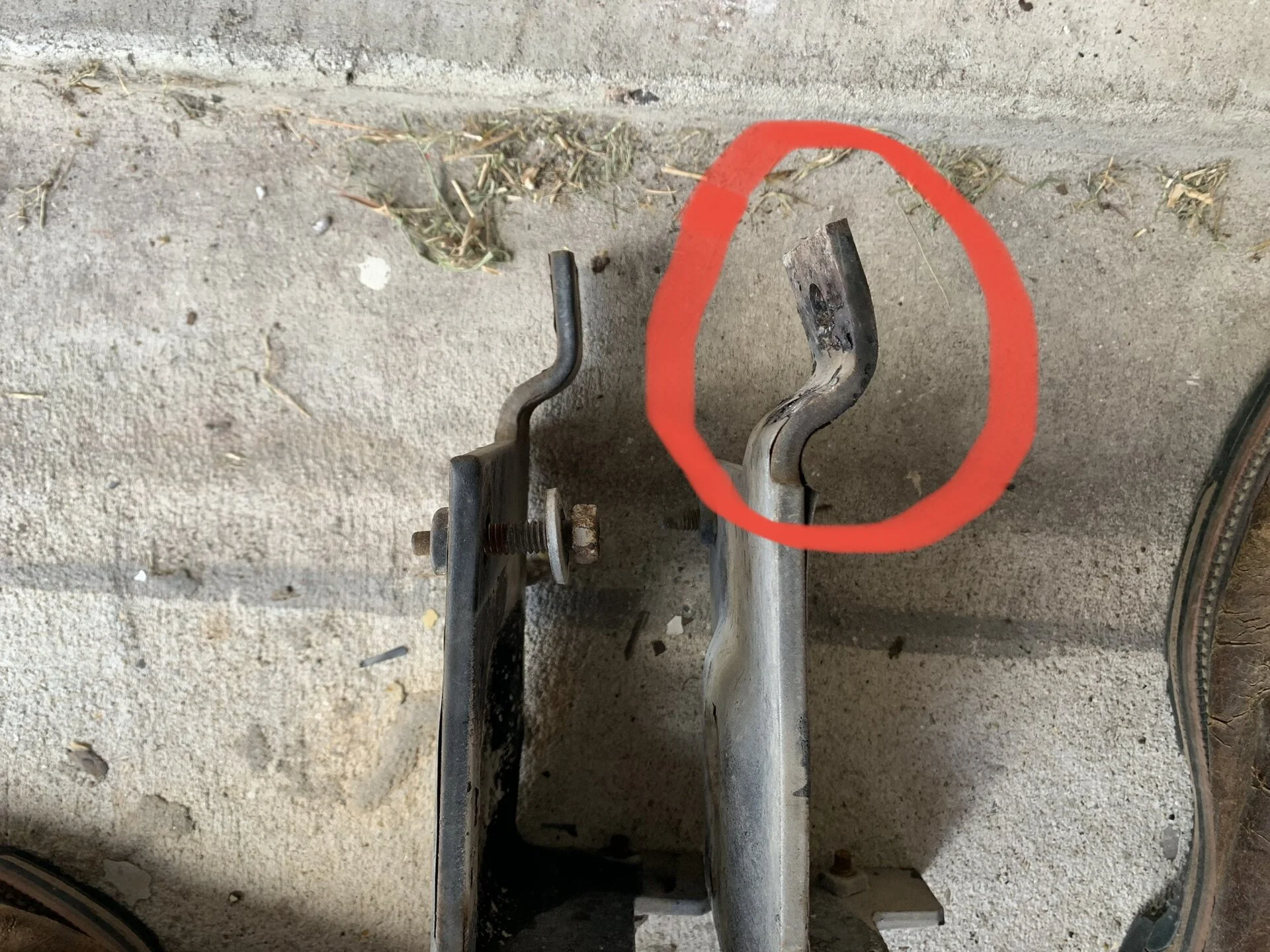

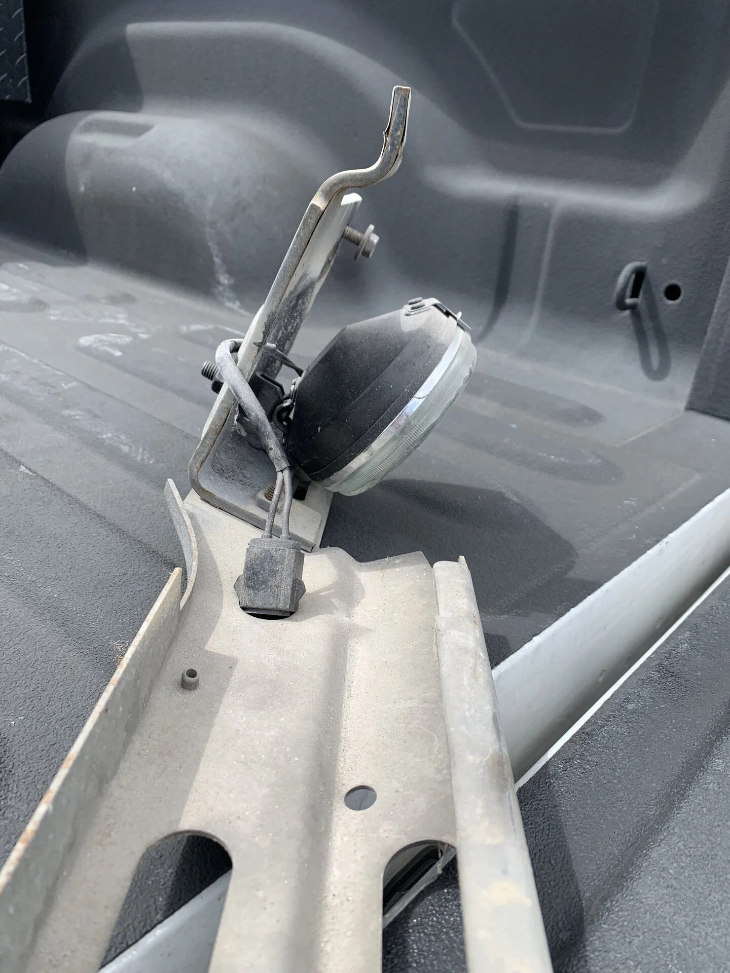

I plan on stopping by the body shop and removing the bracket to see what's going on with it. Will try and get it straight and installed correctly. I went to the shop Saturday morning to help a little, disassembled the hatch that I provided them while the owner was working on the doors and fenders. He also had a Jeep come in that belongs to his friend and needed to install some running boards so I helped him out with that as well. He was appreciative of me going to help. The good thing about having the car torn down is that I get to see things that I can fix easily. With the windshield out of the car I can easily replace the dash speakers, not that it is hard with the windshield on the car but just easier.

Hard to tell….. is the long support piece that’s bent, or just the “L” bracket?
Either way, I’d take the light off, take the “L” bracket off, and then a vice, some heat, and some large pliers to grab the piece and bend it back to where it needs to be.

It’s both pieces but already took it all apart and straightened the long piece. Now just have to straighten the L bracket. My vice broke so trying to figure a different way.
Stand on it on with the tab hanging over the edge oh the drive or a 2X six and use a long pipe wrench.
It sounds redneck, but after hitting a slush hidden pothole or something, my dad straightened out an old Keystone rim for me by hand, and it did not wobble or vibrate when he was done.
Or get a BFH (mini sledge or ball peen) and do it that way.
