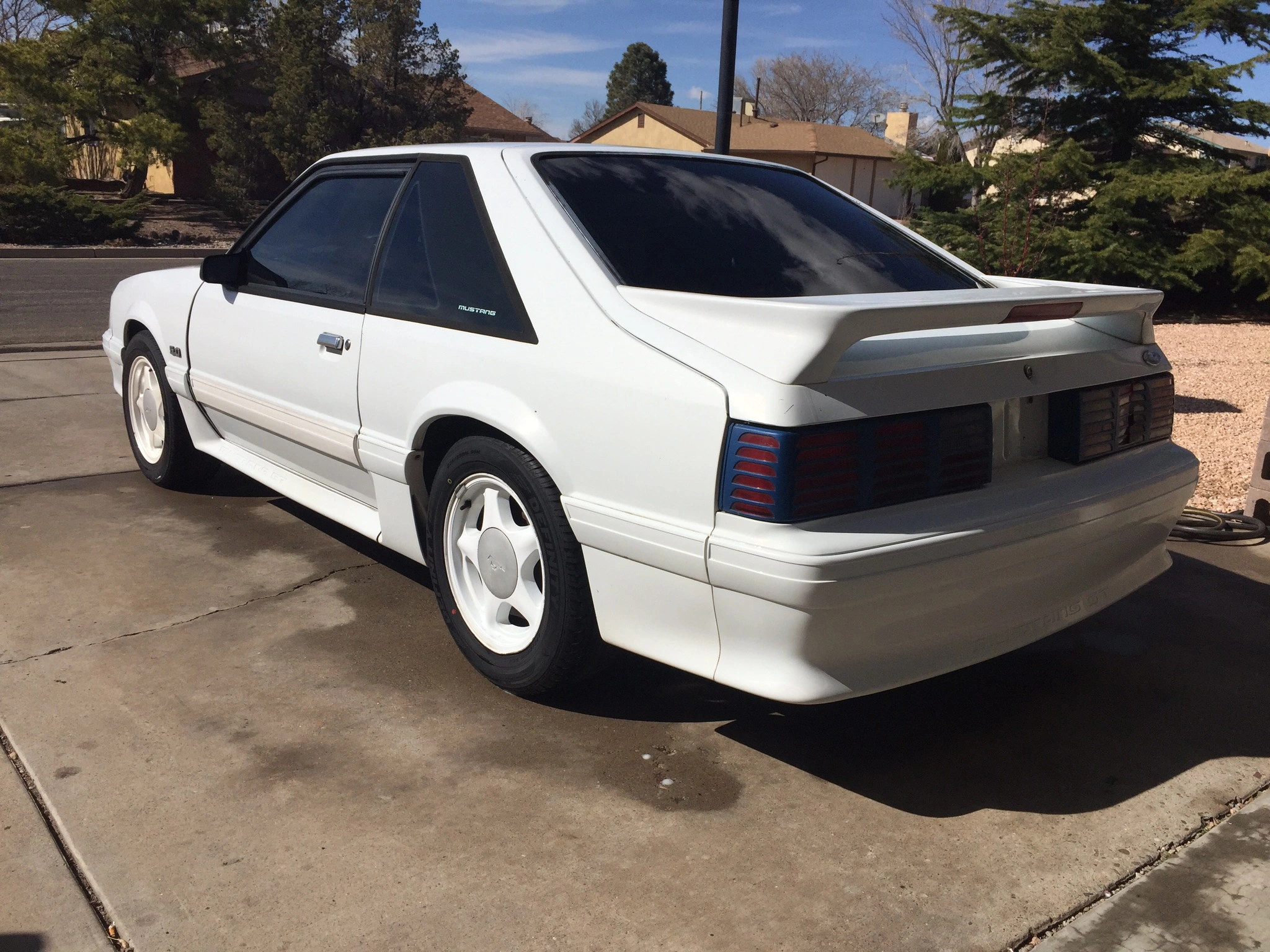

Damn…… between this car, and seeing your car @BlakeusMaximus getting done in this bright white a few years ago…… this is the way to go! So clean, so nice looking!
My ‘95 Trans Am was bright white and loved it in that color too! (But it wasn’t a Ford, so I sold it and moved on!) Everybody makes mistakes ! Lol
Thanks @Rdub6, funny thing is I almost went with red at the time. My interior is sand beige so it would have worked. But, I really didn’t feel like getting into jambs and the engine bay and I’m glad I stuck with the white though.
I have a white F150, white Tacoma, white Honda Pilot and white Stang. I didn’t plan that either.

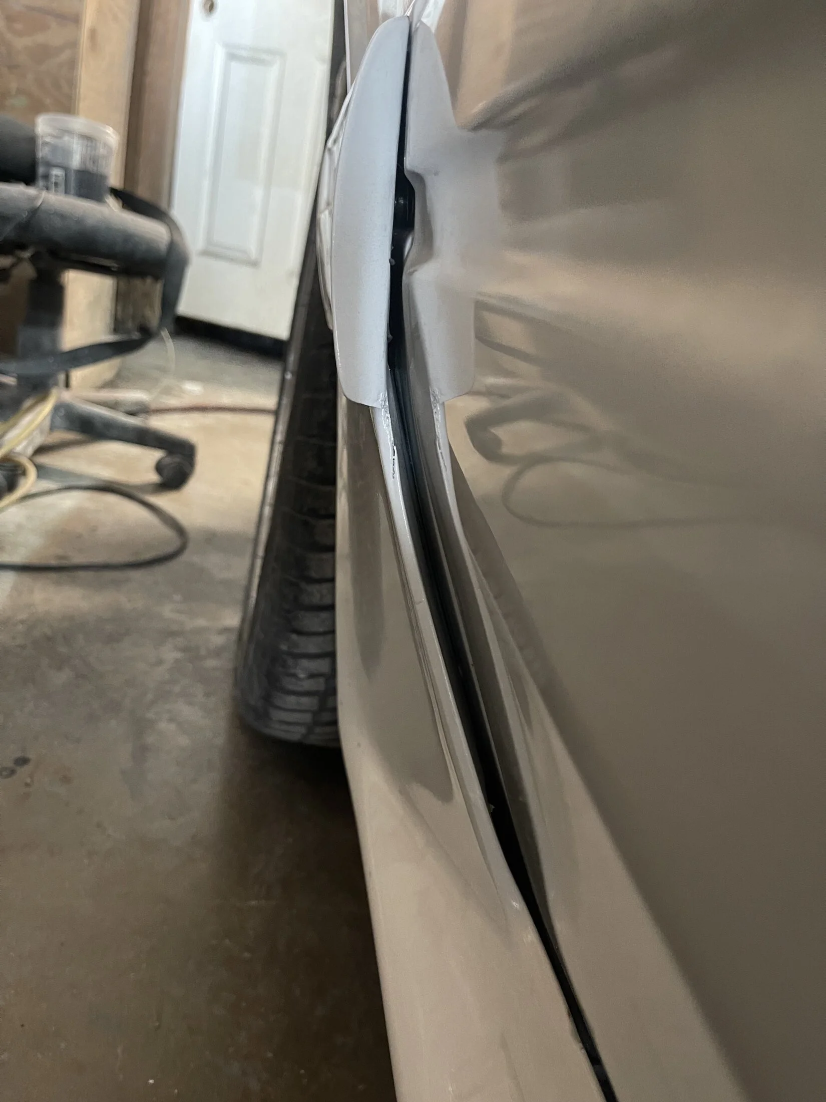

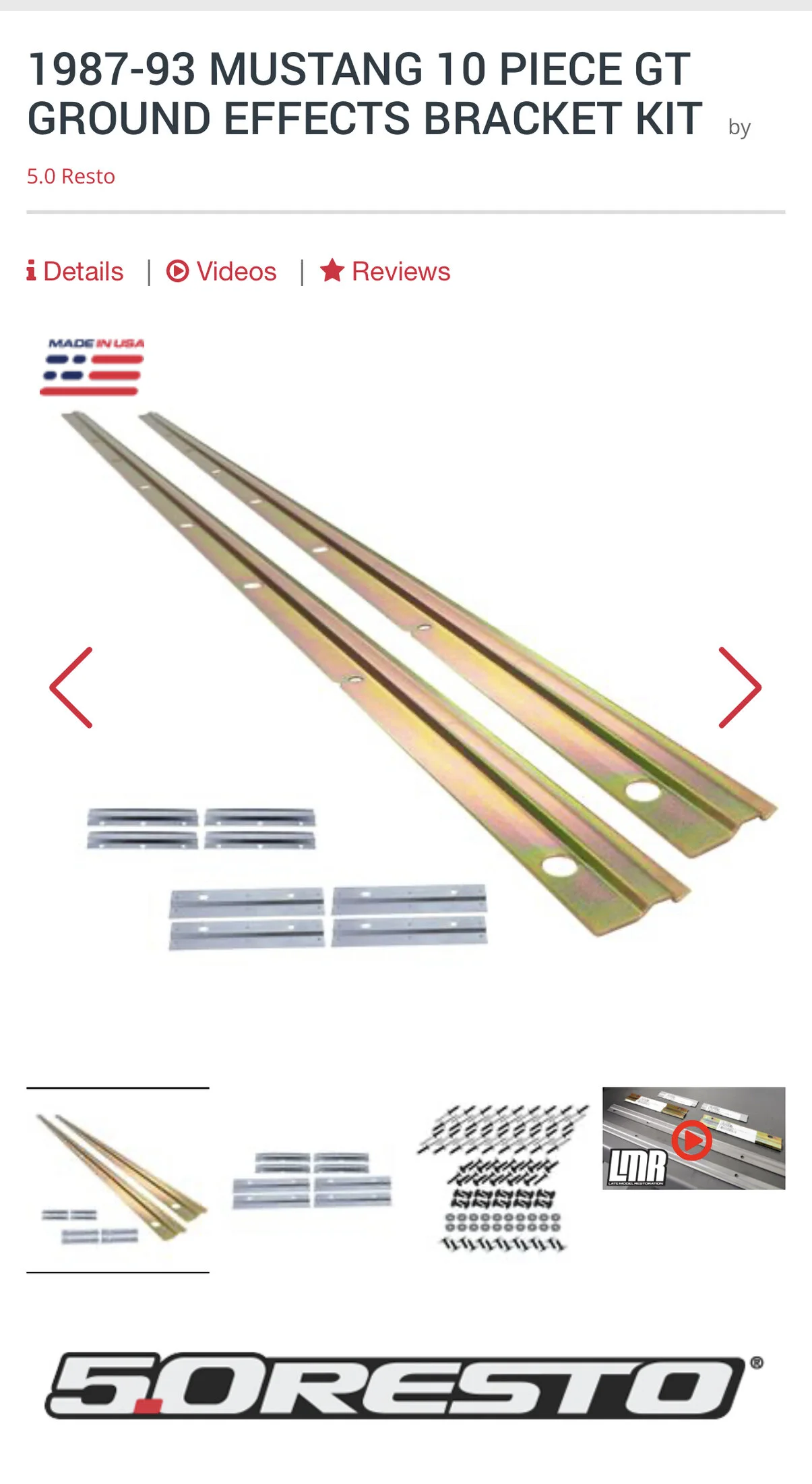

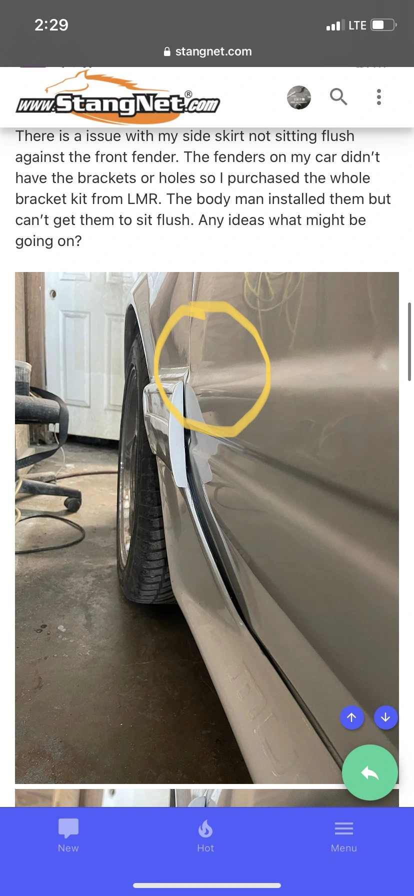

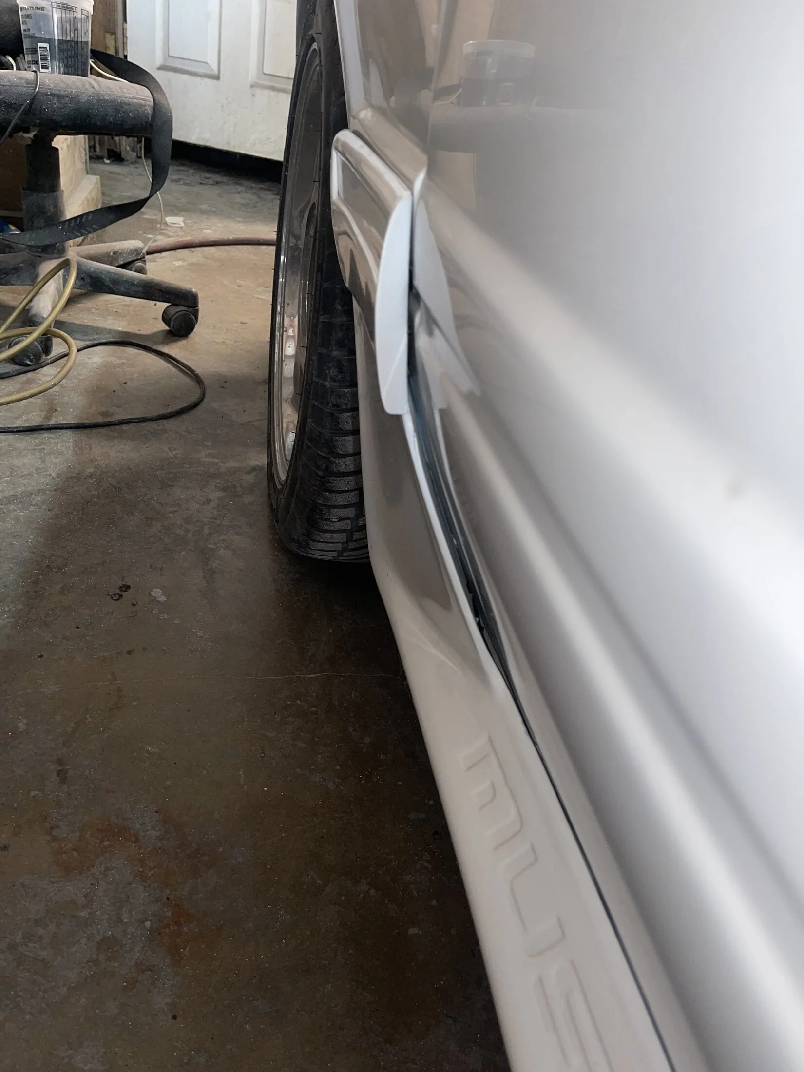

There is a issue with my side skirt not sitting flush against the front fender. The fenders on my car didn’t have the brackets or holes so I purchased the whole bracket kit from LMR. The body man installed them but can’t get them to sit flush. Any ideas what might be going on?
@Fri Guy, did he rivet on the brace that goes in towards the back of the fender? Kinda hard to tell in the pic if it’s there on yours. The rocker molding sandwiches in there.
I didn’t remove my brackets when I did my car.
If those have been off the car for a year or so, maybe they lost there memory and need a little heat.
He did rivet the bracket onto the car. Since it didn't have holes he had to measure the proper location, drill the holes and rivet them on. They have been off for almost a year and prior they weren't even installed correctly. That bracket was never in place. I'm going to swing by the shop today and ask about putting a little heat on them. Might even check the pinch welds to make sure they are not throwing them off somehow.
I’m sure others will chime in with ideas as well. My rocker moldings are pretty damn snug in that area. Might just have to mess around with it a little bit.

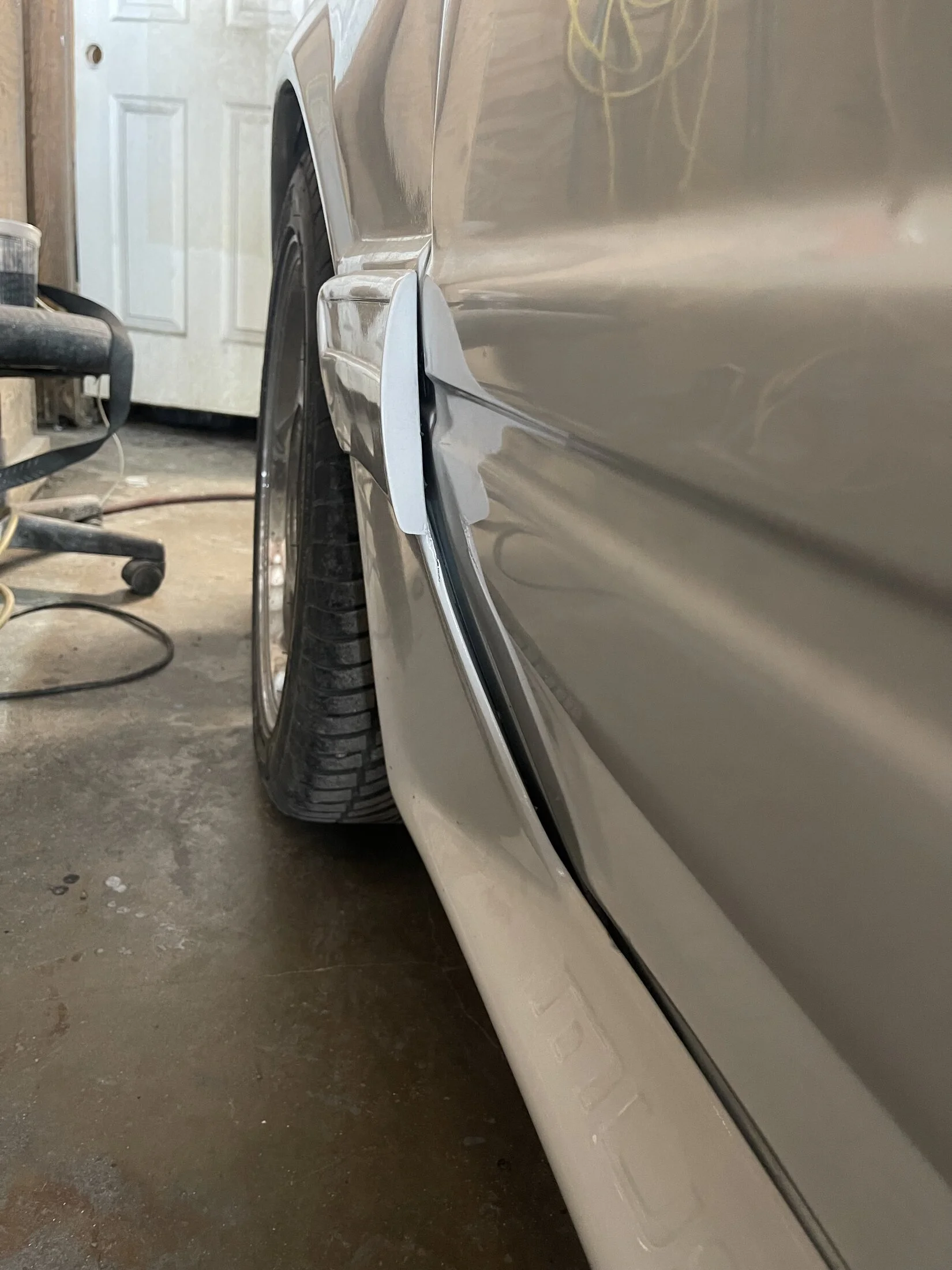

Just me or is the door not lined up with the rear quarter in the up/down? Body lines on the sheet metal at the molding area don't seem to line up.
The door and fender are both out of whack, pinch weld is probably hammered to :poo: pushing the fender up and out.. See that so often on these cars from people using them as jacking points since there so used to newer cars.

You can see it here the driver fender is up and out... Need to work the pinch weld mounting point to pull it back in and down.

Most tire shops/ average mechanic shops will do that to a fox body and not bat an eye... Bfh and a block off wood can suck it back in most of the time unless the pinch is totally crushed. Tape the doors though if they fitted it like that, probably going to need some more adjustment to clear the fender when opening them once its straight.
Thanks fellas for the responses. I stopped by to check the pinch welds and there was some damage on them but didn’t look bad to where it’s pushing the fender up and out. The doors are not completely aligned yet. They still have to install weatherstripping and the rest of the door moldings/trim.
I don’t think the car will completely line up that great due to being in a fender bender before. Just trying to get it as best as it can get. I might swing by there this weekend and see if they will let me try tweaking it. Just don’t want them getting a little upset that I’m going and trying to fix things.
