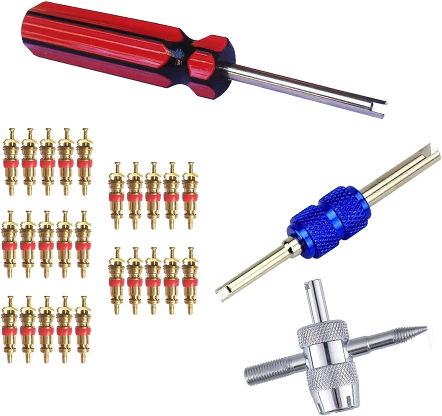

Remove the [valve stem core] from the valve on the fuel rail and then connect the fuel pressure gauge.
The tool used to remove the [valve stem core] is the same as the one that you use on valve stems on wheels and tires.
Any of those tools will work. So will a tiny flat-tip screw driver (in a pinch), if you're careful and don't booger up the threads.
