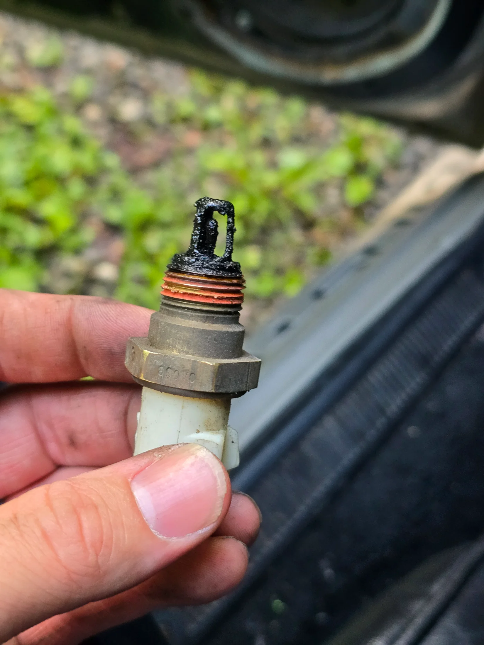

Looks like the Air Temp Sensor was toast. I've got it to idle on its own now.
