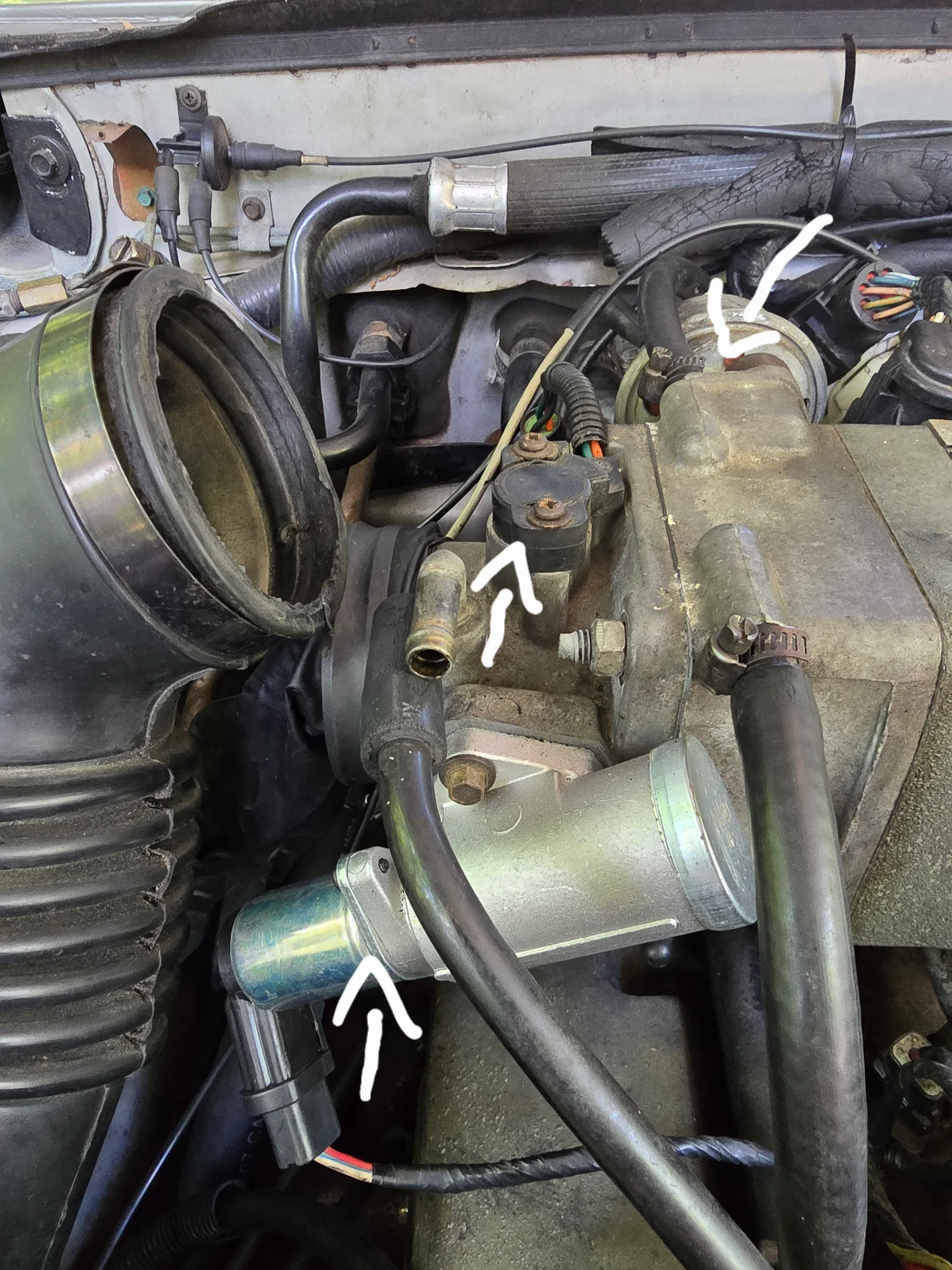

Did another smoke test, smoke is coming out of IAC Sensor side, TPS & EGR Body/Diaphragm. Is that normal?
