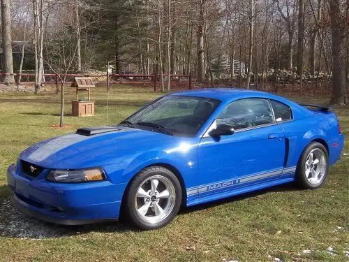

so what i found is an 03 with 22k miles 4.10 gears, magnaflow exhaust, udp, bullits with 10.5 315 on back, tinted windows, and that's bout it. Oh he also painted the stripes silver. The warranty just expired but i'm extending it till 2009 in aug. So i'm getting the warranty and car for 16.8k:shrug: i'd say from what i've been seeing it's a great deal.:nice:
