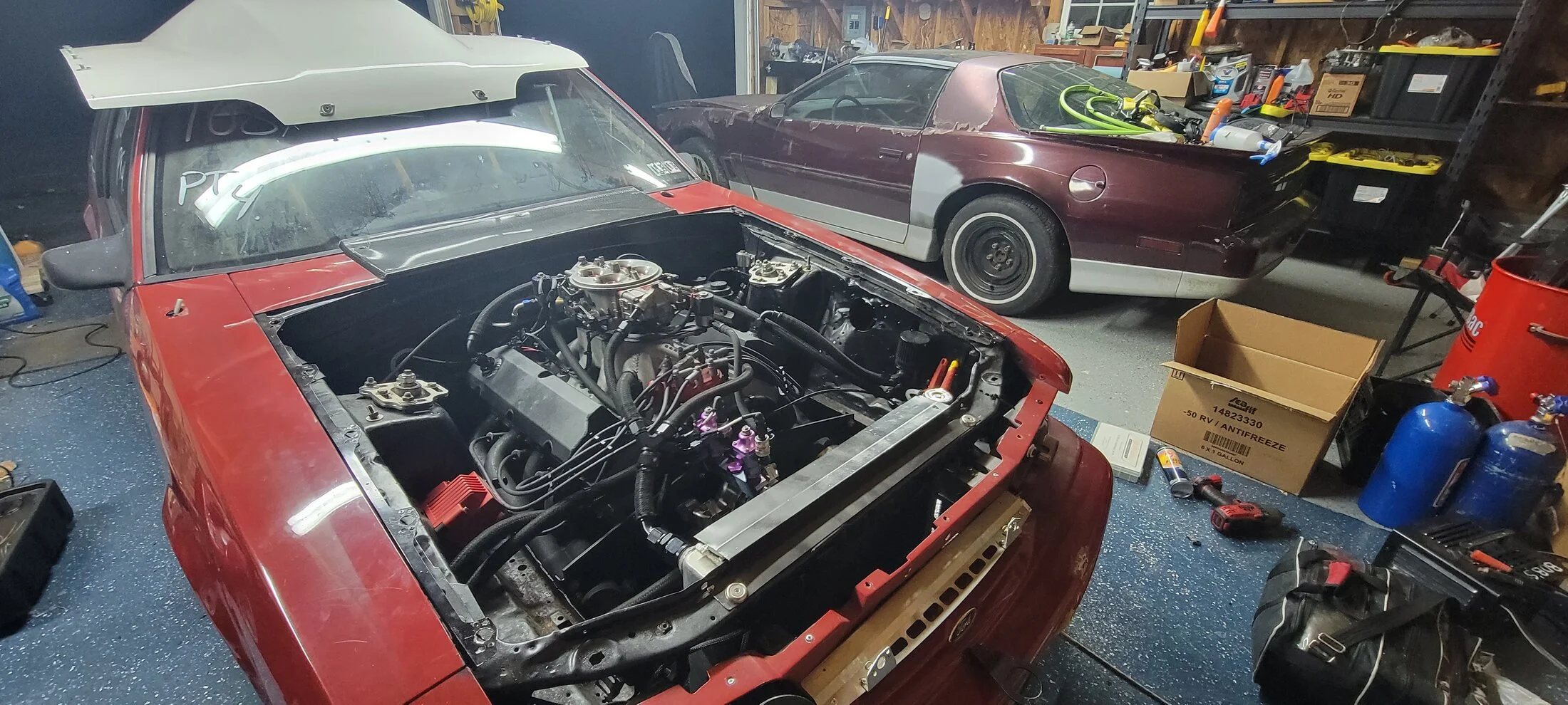

It's a Roche racing engines 408" highport nitrous motor 12.7:1 compression solid roller cam from Vincent/bullet nitrous proflow single entry plate system
Protorque U9 bolt together converter power glide with a 1.80 first gear
Narrowed 8.8 with 35 spline axles and 4.30 gears
7531 MSD ignition with racepak iq3 datalogger dash
UPR suspension all the way around, viking double adjustable front struts with custom front limiters afco single adjustable rears
Fiberglass hatch with lexan back window
Fiberglass hood

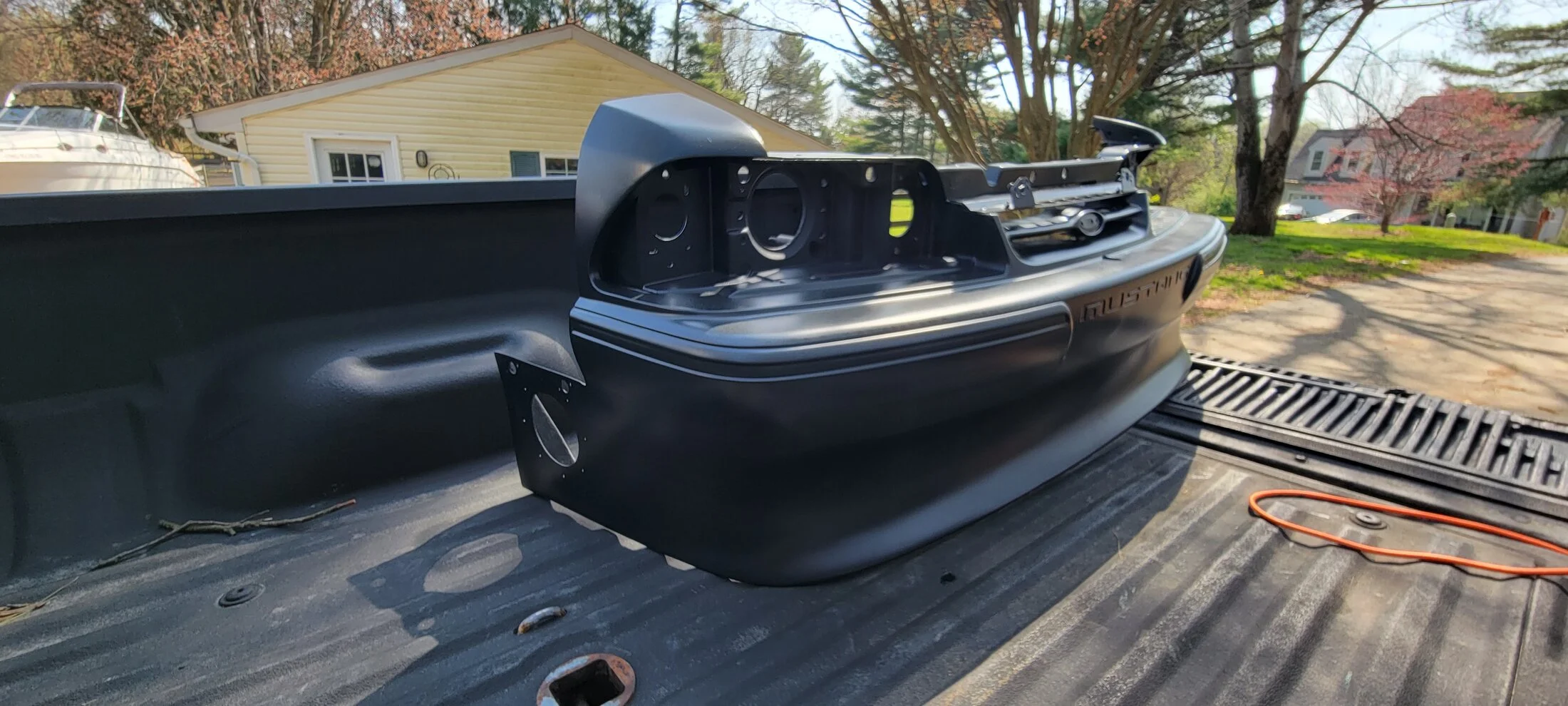

Hybrid composite 9" lower valance bonded to a factory bumper
Pony down 4" forward facing NA headers mated to 4" aluminum exhaust out the front bumper
2x3 thru the floor subframes
Custom 10pt moly cage

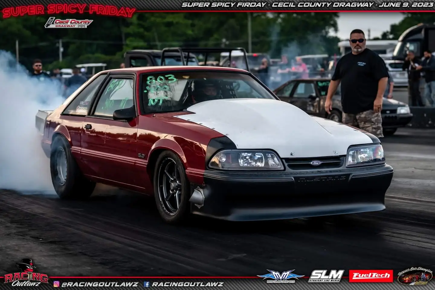

Welp... 10.04@138 on motor to make sure everything was good. Back in the lanes with fresh plugs to make the first nitrous pass and the sky opened up. First time we have had rain in a month. And it rained just long enough to shut it down for the night.
