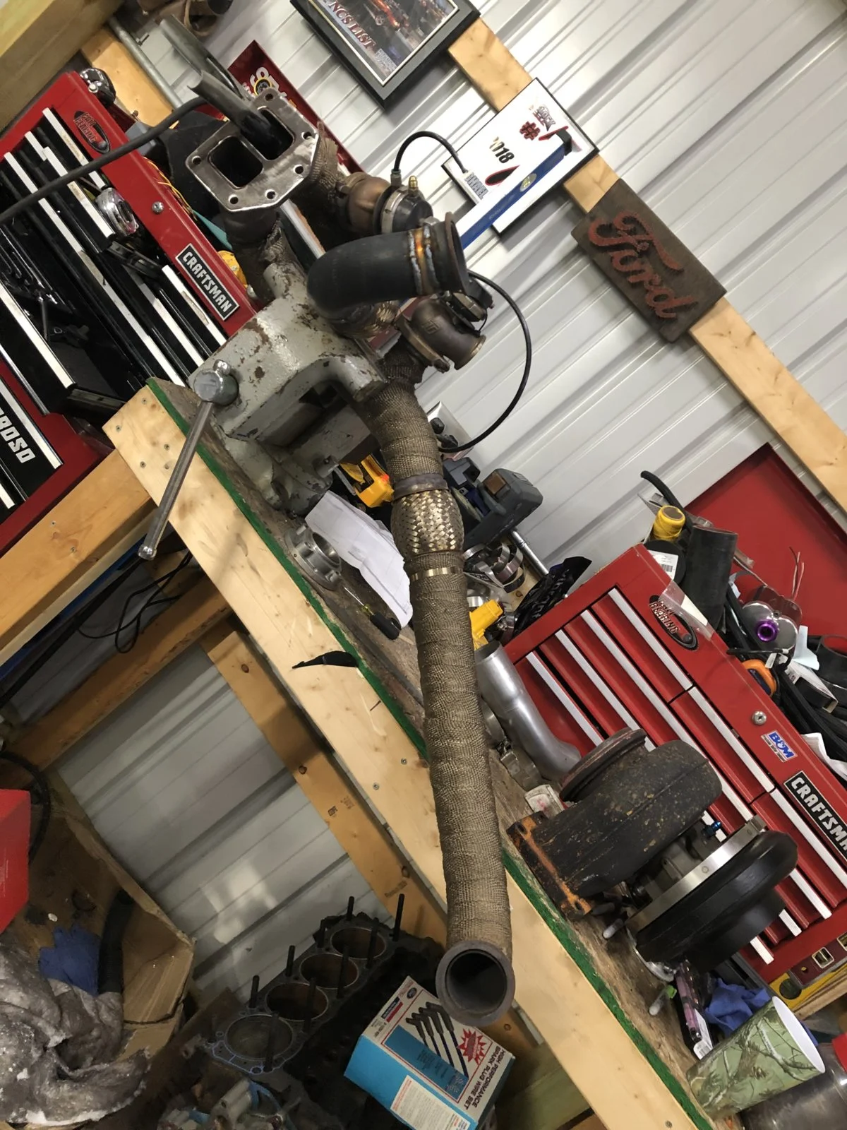

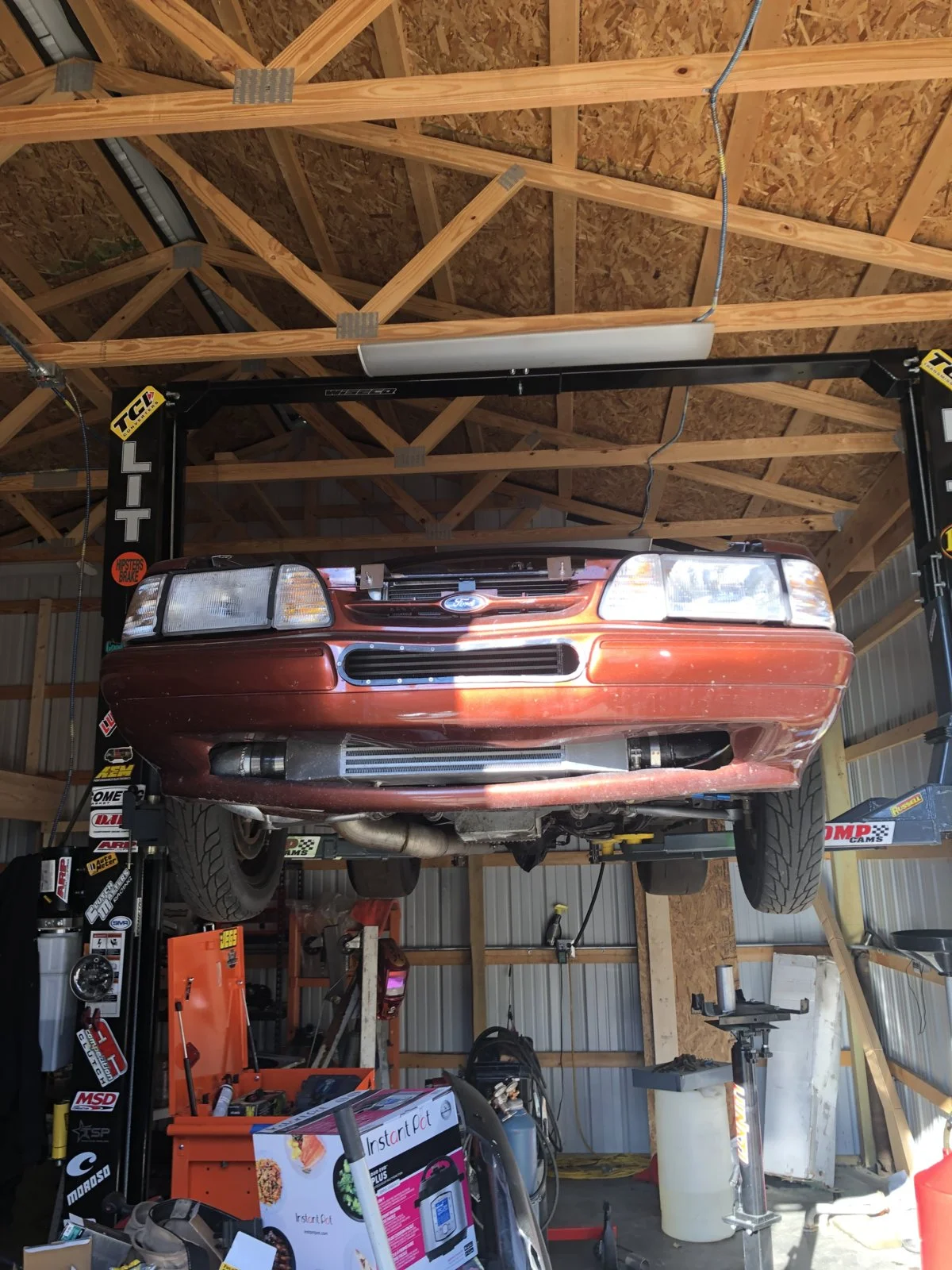

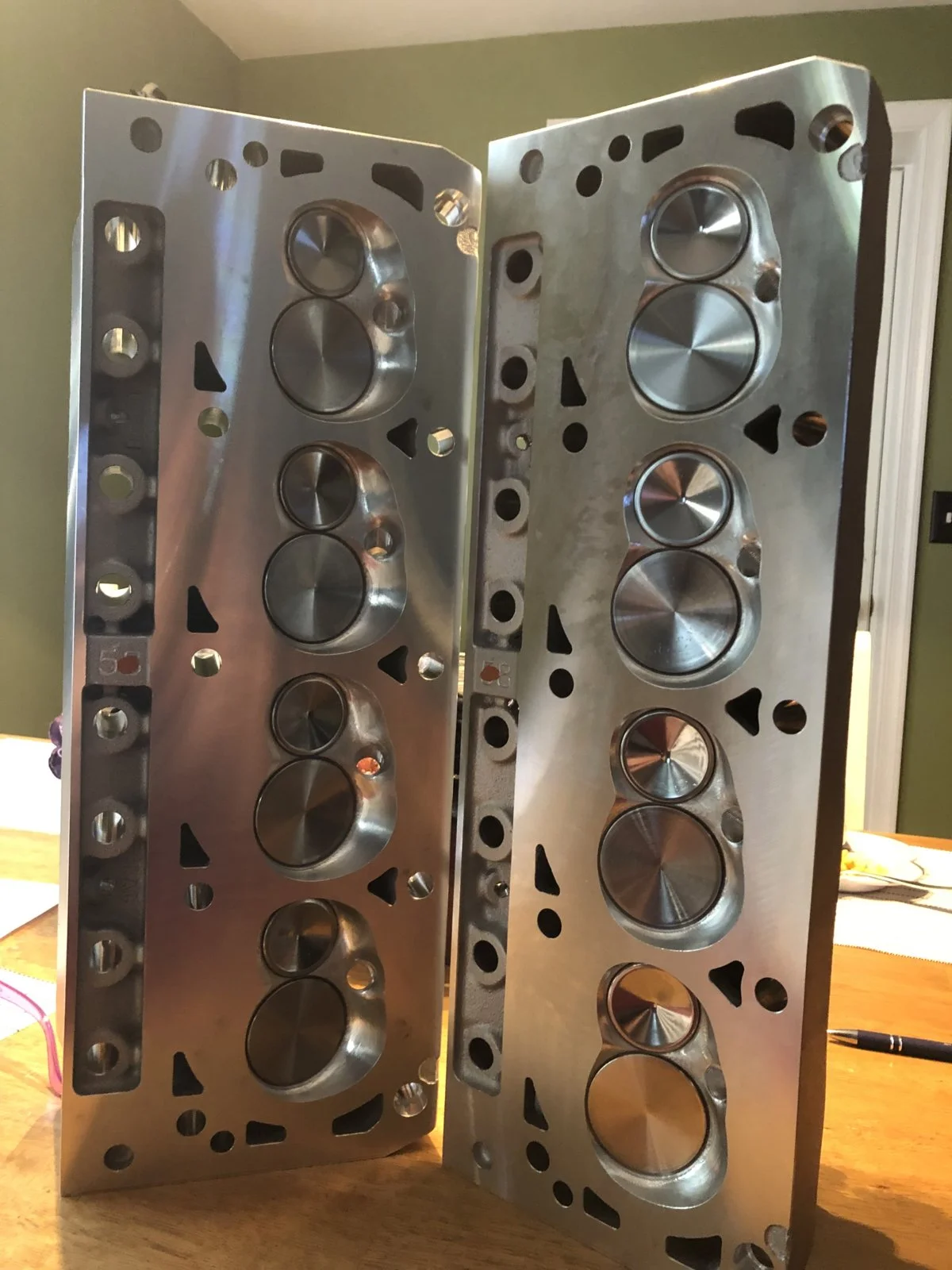

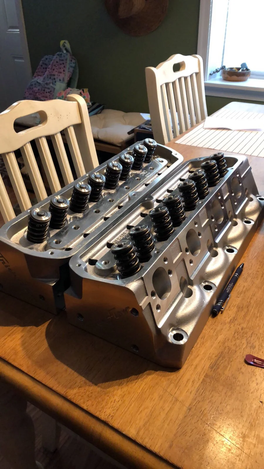

So after waiting a total of ten weeks for a set of RHS 215cc heads Bare I canceled the order because they couldn’t tell me when they were gonna come in. Made the call then to Total engine airflow and got a set of trickflow high port 225cc heads. With that being said now that I put high ports on the car I needed to redo the hot side on the car AGAIN!!. Anyways it’s coming back together hoping to get it done before the year is out so I can see what kind of power I’m making.

There’s just something about seeing car parts on the kitchen table that makes me smile!!
I sent the pic to the wife and she wasn’t even phased lol
I disassembled my P heads at our kitchen table years ago. My dad and brothers couldn’t believe the wife let me. She has her moments of letting me be me, but if I ever put any engine parts in the oven or dish washer, I’m sure she would have my ass.
I’ve used the oven and dishwasher and she’s just like if it breaks I’m the one fixing it so don’t do nothing stupid

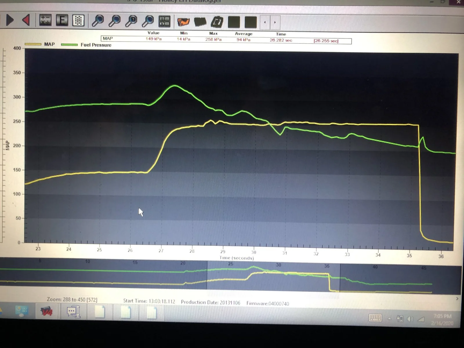

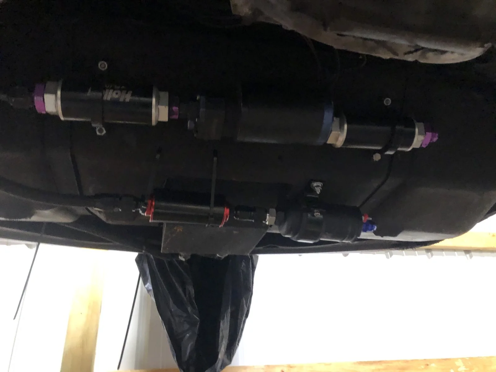

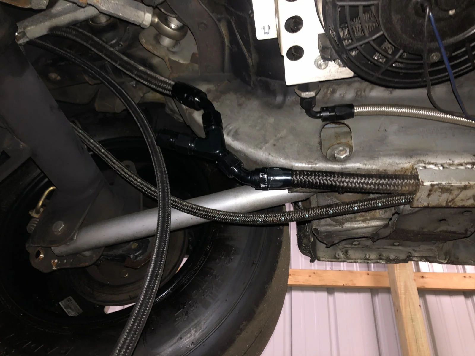

Just over here waiting for warmer weather and racing to start back up again. Added a second pump in finally to help with the new heads I put on. TEA225 will push a little more air in to the 363. Also going to redo my return line from a -6 to a -8 to help with the added pump coming on. Had a 4303 pump and added in a additional aem380.

Very nice, fuel pressure loss is a serious problem. What software do you prefer? I personally use Megalogviewerhd for all my data logging. Even obd2 stuff.
This is all through holley efi. So easy and user friendly to work with.
