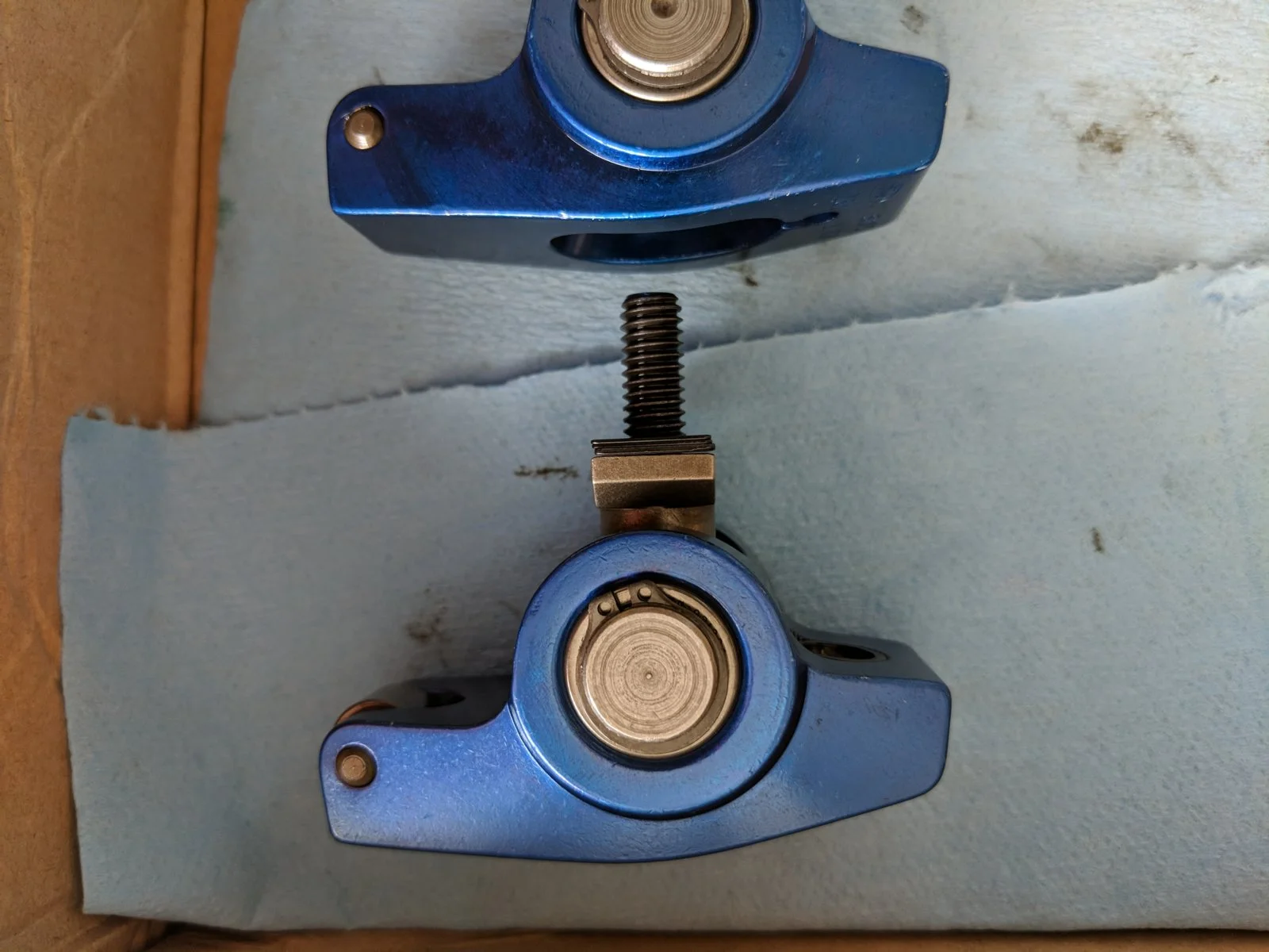

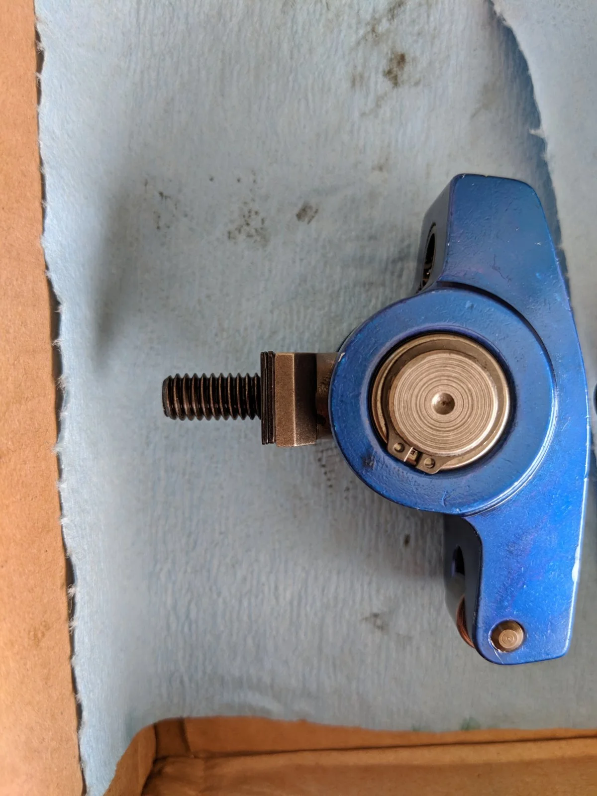

Couldn't fix rotation of image....so the first picture is intake cylinder 1, second is exhaust. I measured the silver pedestal thing and they are the same thing. I KNOW I have the bolt going through the rocker correctly on both. The intake has 3/4inch sticking out, the exhaust has 5/8inch.
I'm lost now lol I'm not sure shims can make up that much difference lol

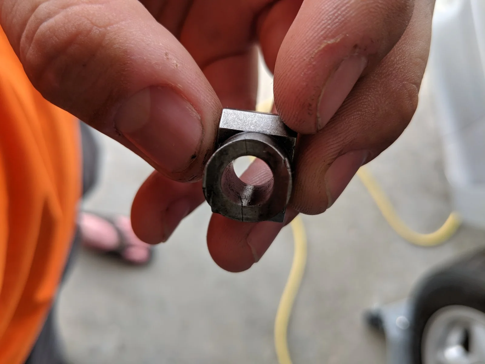

Soo I was taking off the rockers because I noticed some of them were put in upside down....and then I noticed the silver pedestal thing on cylinder 4 exhaust has one crack on each side....
So now what lol
Obviously check all parts for wear and damage and replace as necessary. I had assumed you had already done that. Did these parts go to the machine shop with the heads? If so I would think they would have at least gave them a quick visual for concerns.
