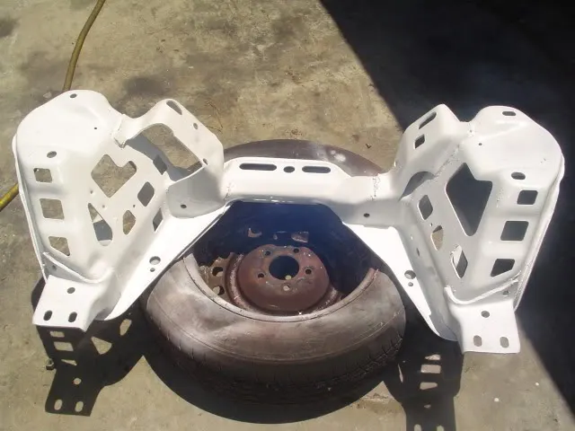

Upon removing the 94 K member I soaked it down with greased lightning and pressure washed it. Then I let it dry, primed it and painted it white to match the car. Tomorrow I will hit it with a few coats of clear to make it easier to keep clean. Tomorrow the fuel lines and tank will be installed/swapped and the front suspension will be put back together. I'm hoping to have the car ready for the motor by the end of the day tomorrow.

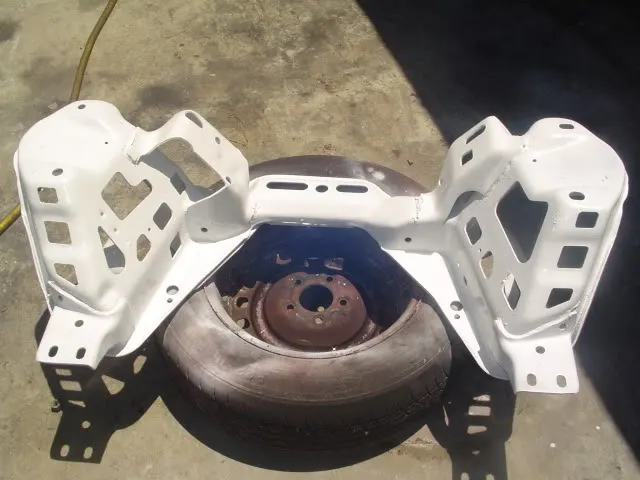

Here's a shot of the K member after I pressure washed it and painted it white:

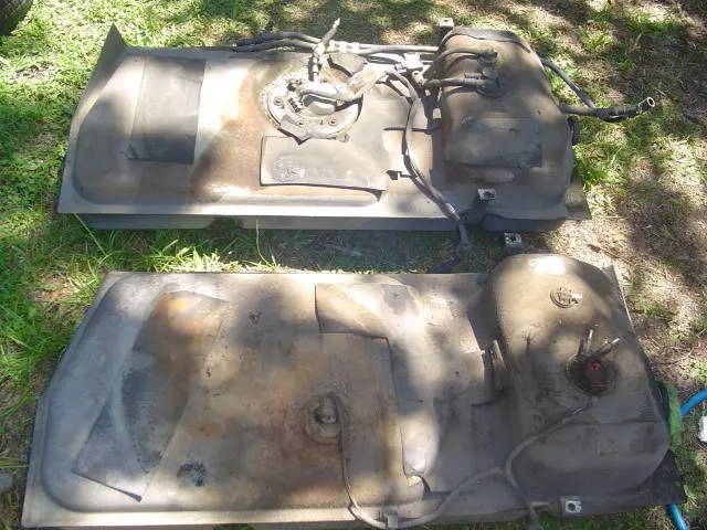

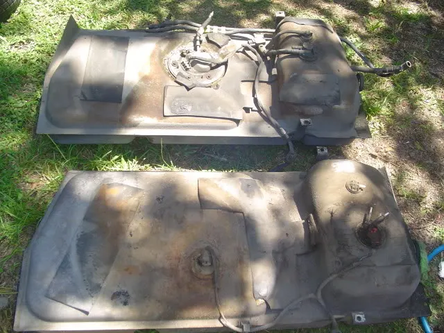

Here you can see the differences between the 2 fuel tanks. The one with all the crazy hoses all over the place is the 99. The 94/95 tanks are so much simpler.

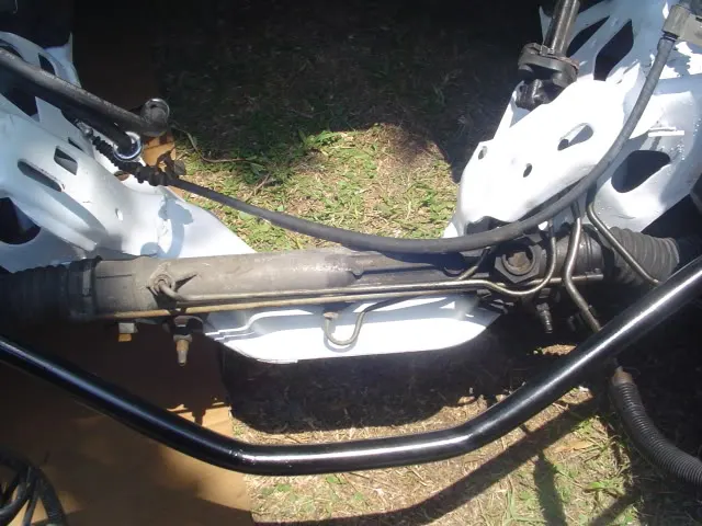

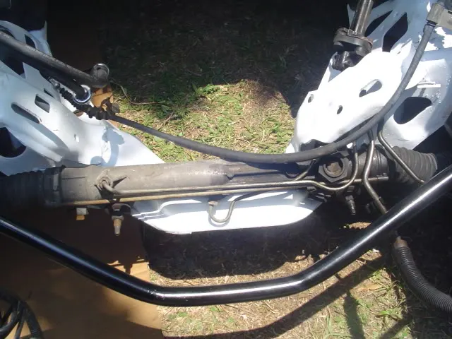

K member, steering rack and sway bar reinstalled.

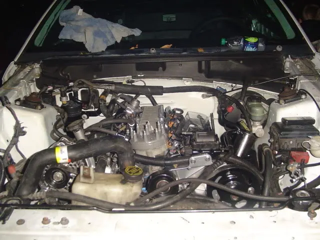

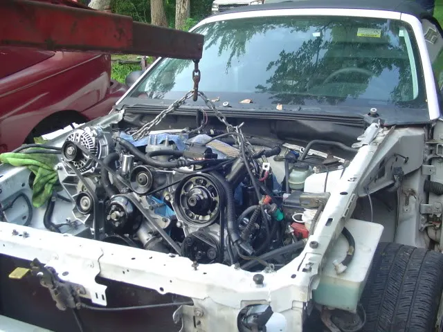

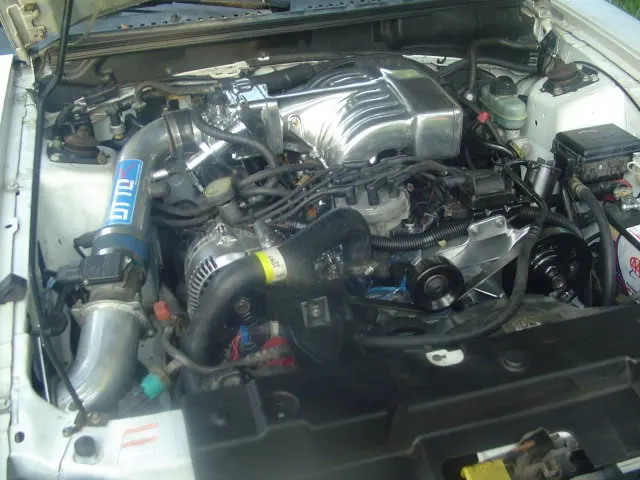

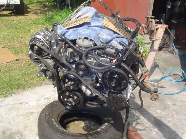

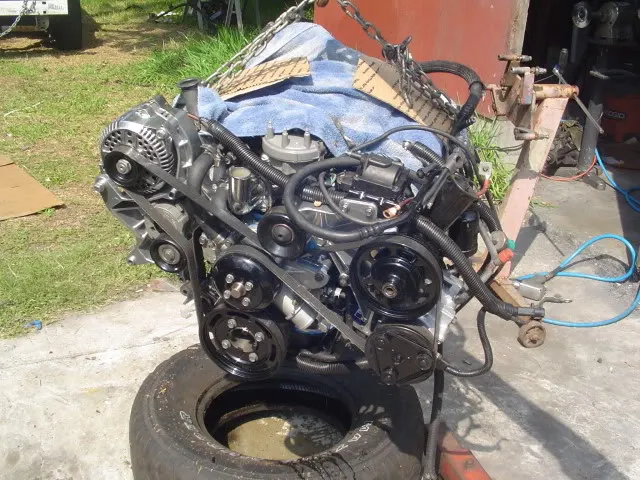

Here's a shot of the motor all put back together awaiting the transmission to be mated up:

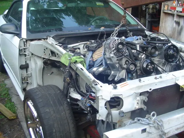

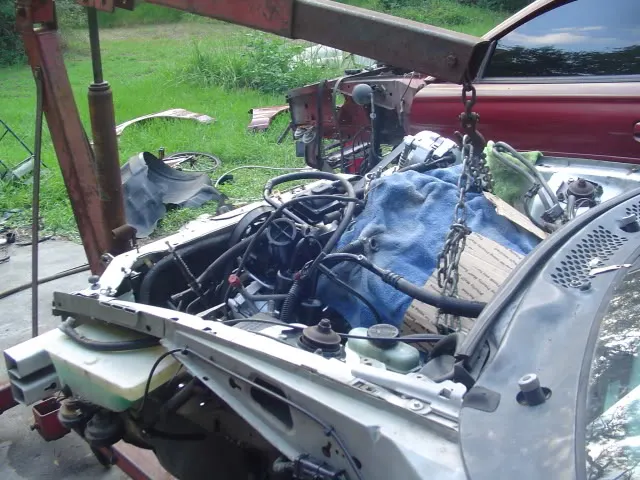

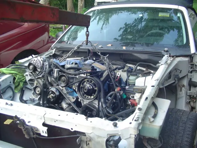

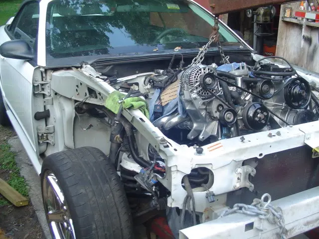

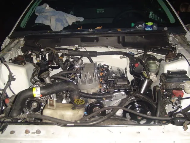

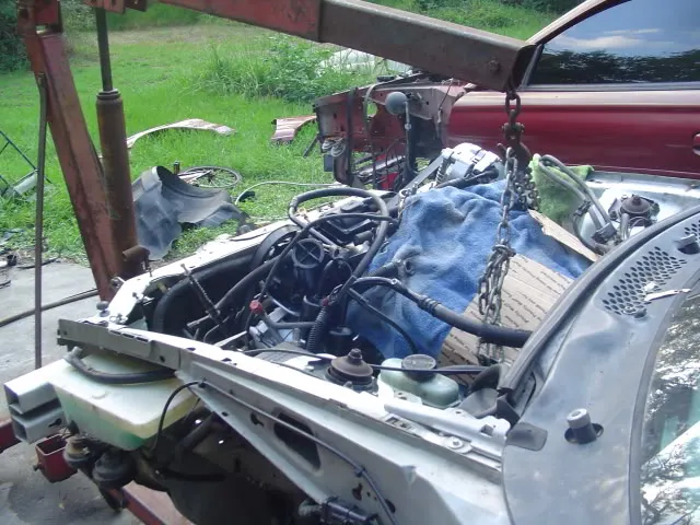

Some shots of the installation in progress:

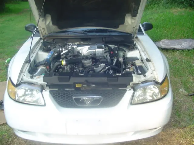

And here is the motor sitting in it's new home. It was getting hard to see, so we had to stop here.

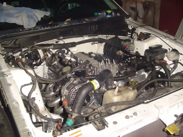

Ran into a problem when I tried to install the overflow. The ABS pump on this car is oriented in a different position so it interfered with the overflow. I can use the V6 overflow but it will require me to relocate the CCRM. I'm going to try and mount it behind where the CAI goes, that is where the V6 CCRM was mounted.
I also broke the damn VSS on the tranny while installing the motor, so I'll have to pick up another one of those tomorrow.
Amazingly, the transmission crossmember went right in with no issue.

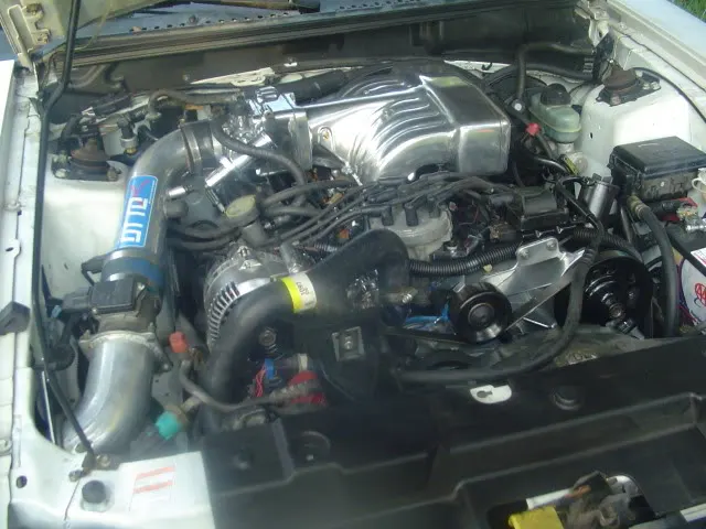

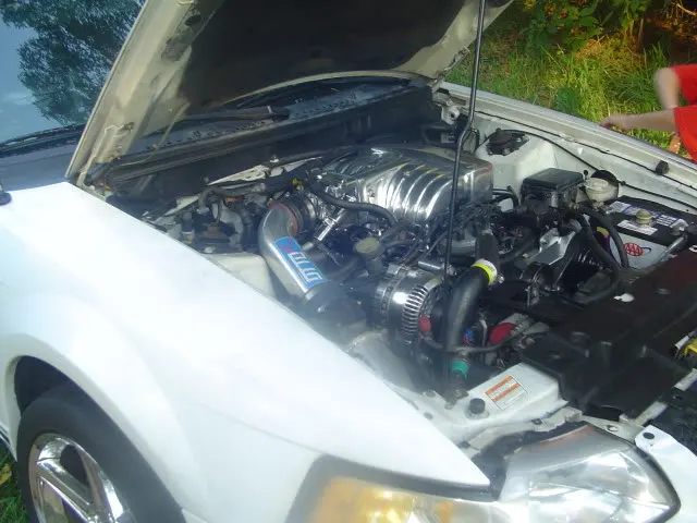

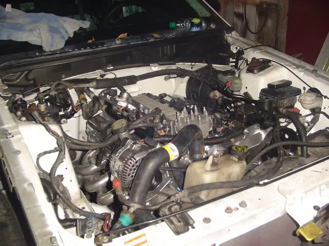

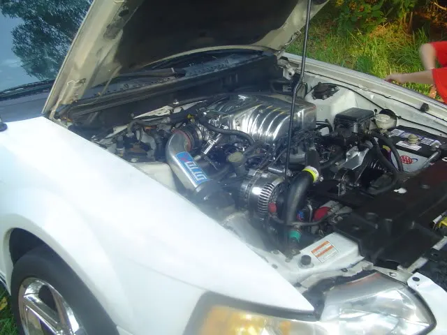

Here's the motor all complete:

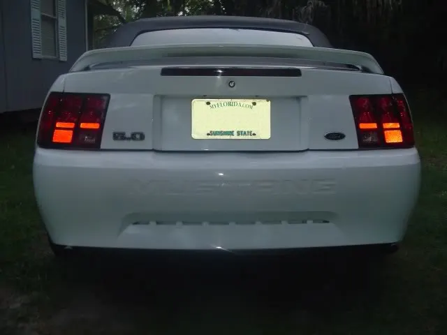

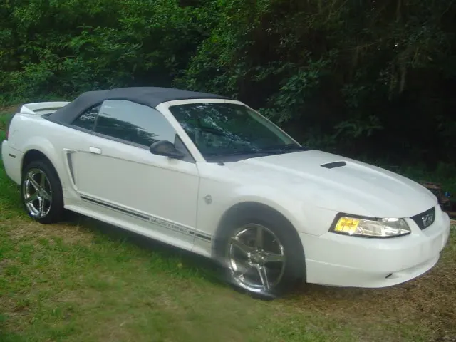

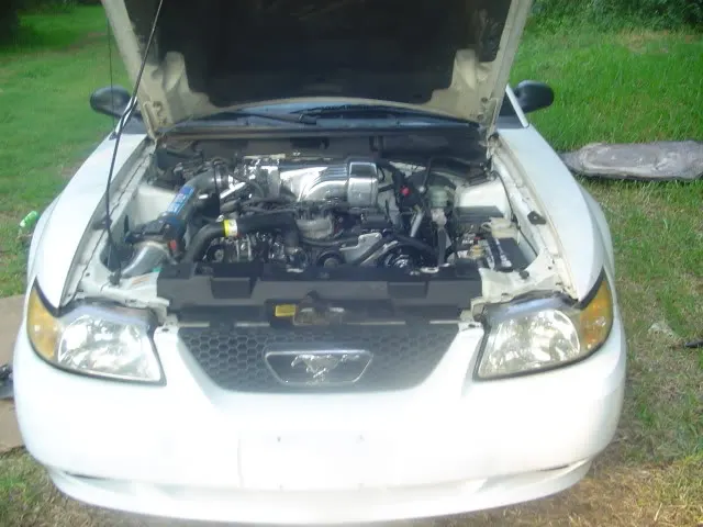

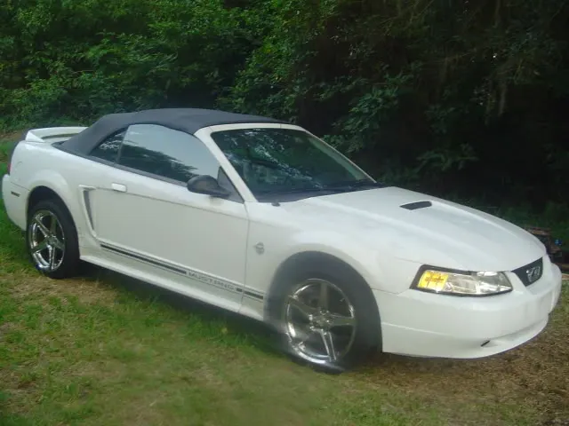

Car all put back together:
I'll get some better shots and some video after it's all washed and waxed up good. I still need to finish installing the rest of the interior and figure out the issue with the top motor.

Anyway, the car is finished.

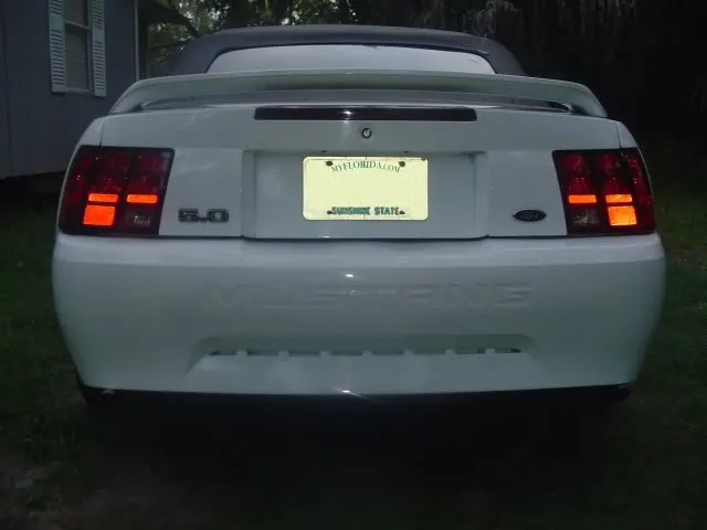

I will leave you with this one photo I took before it got dark.

we had a big mustang convoy today and we cruised all day long, that new edge ran great..... sounds very good, runs perfect had a fun day!! he is very brave to have that thing just put together and putting it on like a 100 mile trip today lol but it did great
Including my little trip to the westside this evening I'd say it's closer to 200 miles! And it drove so nice.
And as a bonus, the lights in my rear view mirror work now! I was adjusting my instrument lights and I turned the knob all the way and the lights came on. What's weird is when I first got the car, we couldn't get those damn lights to work for anything. They had power and ground so we figured it was the mirror. I almost ordered a new mirror too, but it's working nicely now!
