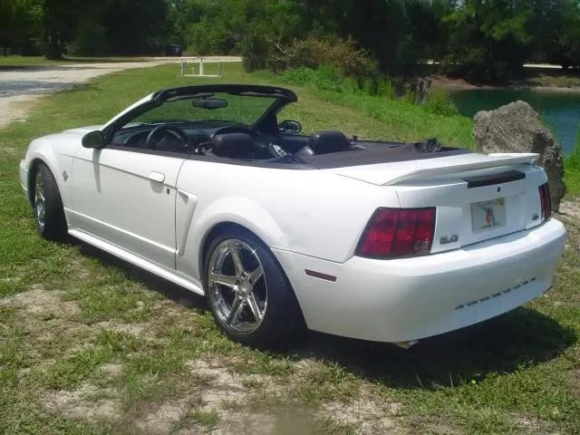

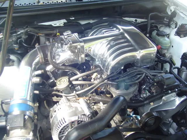

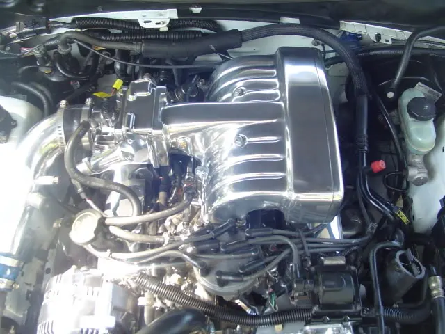

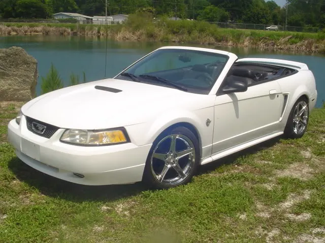

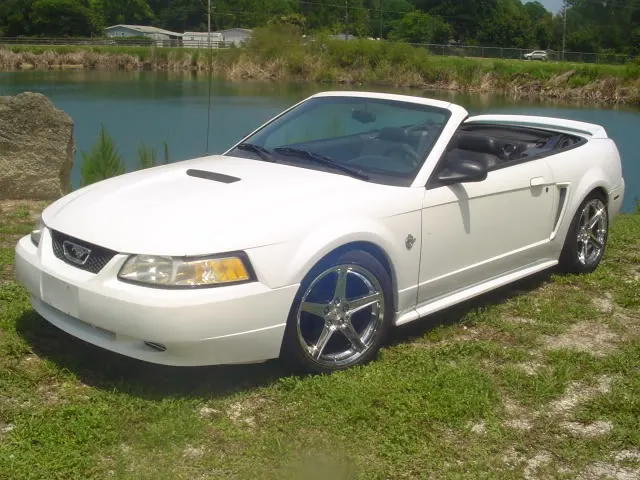

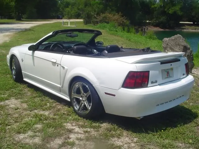

I figured I'd update this thread with the final pics of the car and vids (even though I posted them in another spot, this will be easier for people who find this thread through searches and such)
Here's a couple vids. They would have been better if I had kept my yap shut! lol
1999 Mustang converted to 302 5.0 drivetrain - YouTube
Short run through the gear 1999 Mustang 5.0 302 - YouTube

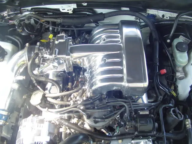

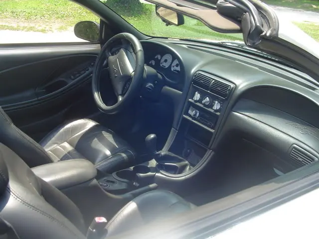

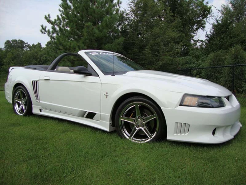

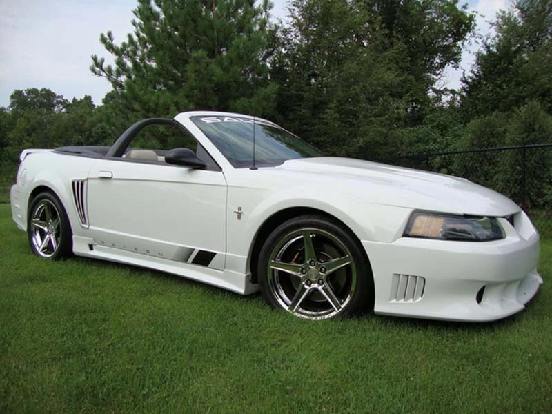

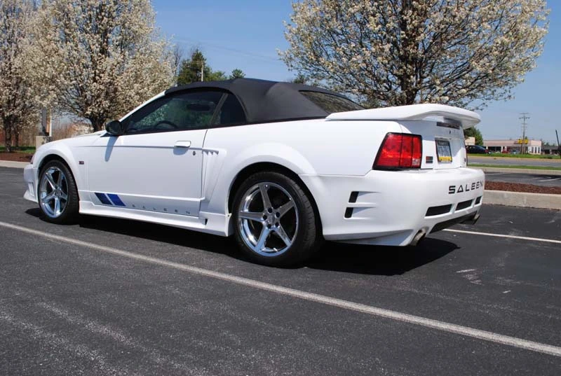

That car would look amazing with a Saleen body kit. I can't wait to see when you do get it, once the funds allow for it. Here's some pics for inspiration:

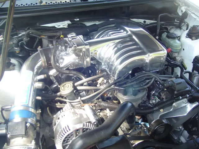

I must say, very inspiring. I own a 94 GT but have swapped in a 351w. I have owned it since 98. My wife would like a convertible and I have contemplated doing this swap. I know I can do it. My wife had a 93 SHO that she rolled and I just couldnt let it go so I found a 94 Taurus (same color) for $400. I did the swap so I know EXACTLY what you went through. Hindsight being 20/20, I should have just bought another SHO. However, you cant get a pushrod 99-04. So this is very cool. I noticed you said you had to buy a passenger door harness to mate with the 94 wiring. I thought you said that you were going to get door harnesses for a 94-95 vert. Also, what is the difference from that harness in passenger door and driver? What I mean is did you use factory 94-95 driver side harness? Sorry, I was a little confused there. I love your polish job on intake and valve covers. I tried to do valve covers once and they looked good but not as good as what you have. What made you want to reuse factory K-member other than the fact that you already had it to use? My thoughts in my project would be to use an aftermarket k-member for a 94-95. I have also thought about going with megasquirt instead of factory eec. This may change by the time I get around to do this though. Great write up! Thanks for the insight :nice:
Thanks for the kind words!
On the door harnesses: I knew both harnesses would need to be replaced. I knew a coupe driver door harness would not work for a vert because it lacked the wiring for the rear quarter windows so indeed I did get a 94/95 Vert driver door harness. But I was surprised when my 94's passenger harness wouldn't fit, so I had to buy a passenger side harness from a vert car as well. The difference was dictated by the body harness. I had to get door harnesses that mated to the body harness or it would have created a wiring mess.
As for the K member, I used the stock 94 K member because I didn't have the spare cash to buy a tubular K member. And most K members require you to buy their A arms, which also require new coil over setups which would have quickly added to the cost of this swap. Eventually I plan to swap it out but it's doing it's job at the moment.
I don't see any need to change out the factory EEC until I have enough power to justify it. For a stock 5.0 it would be WAY overkill and would have added a completely new variable in the swap. I wanted the least amount of things that could go wrong as possible. My goal was a reliable, almost stock 99 5.0 Mustang. I've now put almost 2k miles on it and it's running great!

Another update:
I recently took the car on a long road trip and it did well. I think the trip was roughly 700 miles round trip. The cut factory springs really beat you up while on less than perfect road surfaces. I will be getting a set of the Ford Racing C springs as soon as I can.

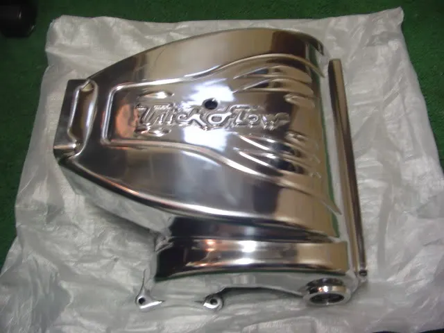

I also got around to swapping the RPM upper for a Performer upper and it made a huge difference. I now have that "put you in your seat" feeling when I mat the pedal! Very nice indeed.
All in all, this conversion was a success! The A/C will truly freeze you out even in 100 degree weather, which is very nice. I have a couple blemishes on the body I will focus on now. I want to do a color change but the sensible adult in me (funny how that happens when you eclipse age 30 lol) says to be economical about this and settle on the white. The pics posted in this thread of the white Saleen looked awesome anyway.
That's it for now. A turbo and a 351 are planned for the distant future.
