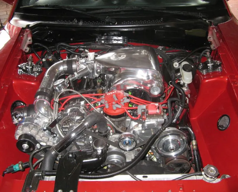

Here is a pic of the engine...we still have to straighten up the wires, install the hood, and put on the polished UPR radiator cover, but you get the general idea:

Looks phenomenal RC.
It’s kind of interesting driving around without a hood. Especially when the engine bay looks like that. You’ll get people hanging out the car window to get a look at it.
I have one nieghbor from down the street that was in his boat looking "DOWN" into the car as I drove by...he gave me the :nice::nice:
