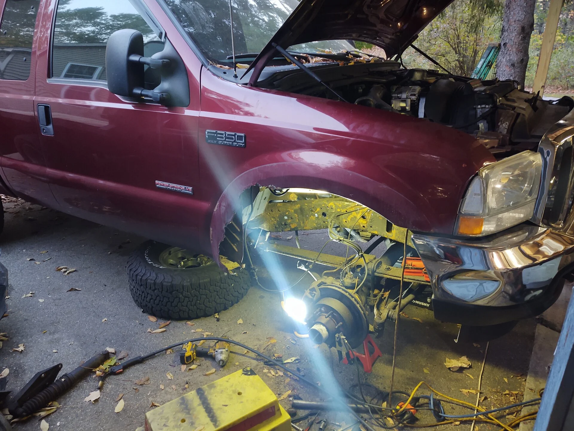

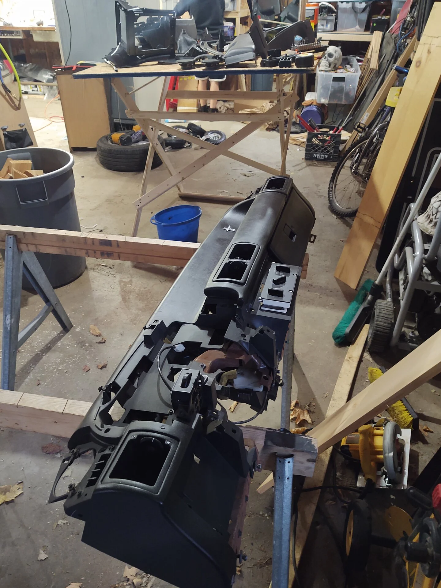

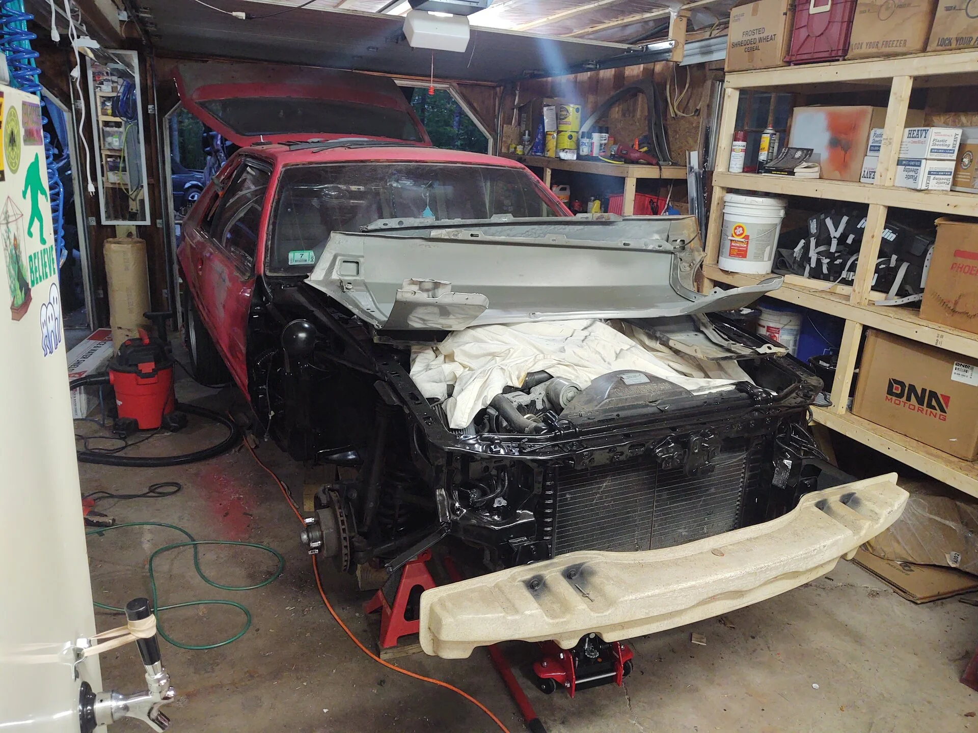

So the woman came out to garage to sit in the visiting chair. Showed her picture of the reef blue or teal cobra picture. Not a fan, prefers black, we will see. Finally got the rear quarters in black. Found a pristine black dashboard from a 93. Cleaning all the other black interior parts. All I need are seats, looking for oem black cloth. I will use LMRs headliner and floor carpet, everything I've seen is just nasty and full of cigabutt burns. I definitely have something wrong with me. I saw a super duty on the side of the road up in Lebanon Maine, just quick look as I went by. Next day I saw it was a powerstroke, but an 04. Looked in great condition at first. Sold as is, 215k. Cab corners, rockers, bed, wheel arches, door pillars, exhaust manifolds, all gone, rusted pos. Frame is perfect. Just like the GT convertible in the same condition, I should have walked away, but muttered I'll take it. I'm a sucker for rusted cars sold at a discount. Just got the right side manifold off, getting dark. Will get back to the mustang later. Going to actually paint the truck as practice for the clone. Every single vehicle is or was a rusted turd. When I say on a quiet night in New Hampshire you can hear Ford's rusting, I'm not kidding.

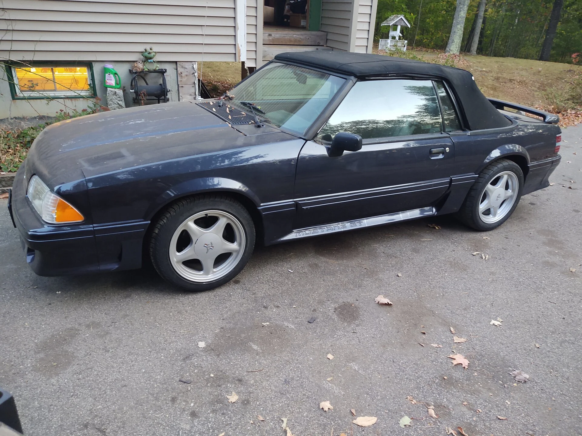

I initially sanded my notch with 320 then blocked it out with 400 grit. Took it to maaco. It looks pretty good!
My foxbody is my second toy. I have a challenger scat pack that is my nice toy. My foxbody has a DIY paint job right now, at night and far away looks ok lol. I really just dont like the color and kind of want to improve it on the cheap for now until I decide what I want with the car. Thought about doing it myself, a wrap etc.
But with MAACO you bring up a good idea. I know they are always kind of a joke.
second pics, single or two stage. Maaco has always kind of been a running joke. But for me my fox has a DIY paint job and its mehhh. I have no rust or damage to worry about. For me the fox is my second sports car my main is much nicer and dont really want to sink a ton of money into it. But if I can somewhat improve the paint job i would be happy. Bust maaco jobs i have seen have been maybe a step up from rattle canning it. But have heard a few good luck stories
My dad had two cars done by Maaco for like $350 back in the day. Did they paint the jambs, no, did they sand it, no. Did the car end up looking absolutely fine afterwards, yes. I remember they used a one step epoxy paint or something that didn't shine as much, but the car still looked fine.
