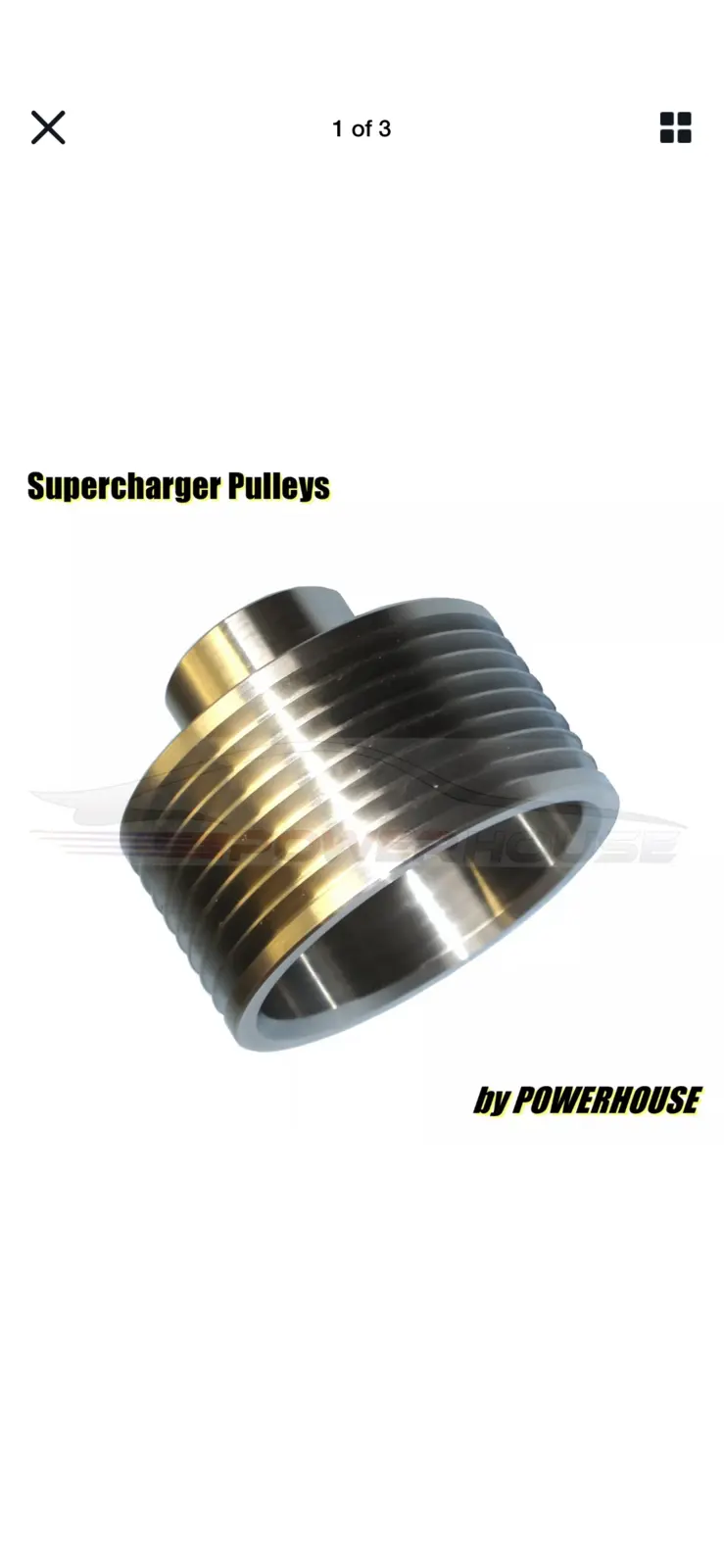

@a91what thoughts on these? They’re made in the uk for jaguars. They claim 1.5lb add to stock jag. These will fit without machining the snout. Also supposedly machined to grip belt better.

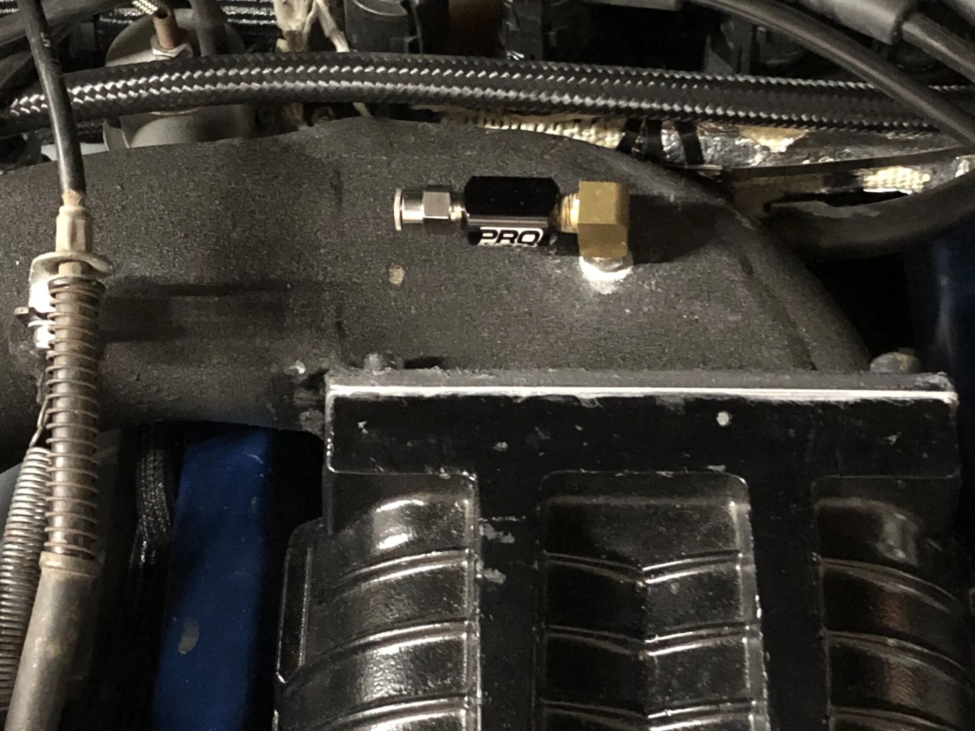

Some ideas on this ever evolving project. for starters I'm going to add an additional meth nozzle before the blower to cool the blower itself and hopefully increase boost by helping seal the rotors a bit. I ordered a 1.5gph nozzle for this. I'm also thinking about a bigger intake tube, oval 5"x2.5" that'll go over the top of the blower and angle over to the area where the A/c would be on cars equiped. Then use an oval TB. Gotta check hood clearances etc this would probably be a project for next winter but i can get started mocking things up and gathering parts. Who knows maybe I'll get it done sooner...

Went for quick ride. Looks like about 1psi increase but intake temp came down to 124° and it comes down way quicker! Might just be me but seat of the pants it seems to have more power. Slightly richer. I’ll study the log later and maybe pull a little fuel
Are you only spraying before the blower now or both?
The pressure increase was expected, you may try swapping the nozzles and spraying the majority ahead of the blower.
Before and after. Small 1.5 nozzle before. I suppose I could block off the nozzle under the blower and order a 10gph and swap out the 1.5 and see what happens. Not sure I have the motivation to pull the blower to swap out that nozzle though.
