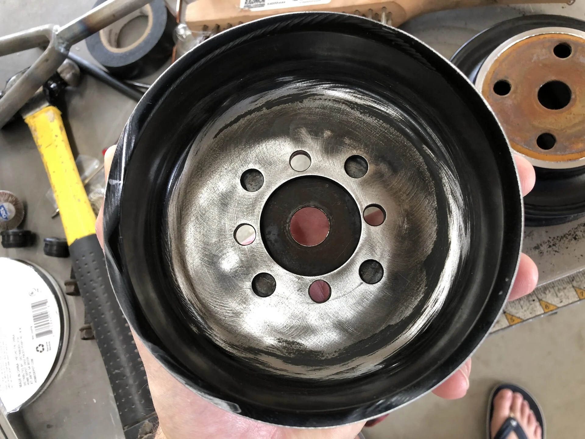

I’m not noticing slippage in the datalog but I am noticing belt dust. I have used dressing and it helped but didn’t seem to help long term. I also may get a machined snout and smaller pulley and might as well take advantage of that custom crank pulley

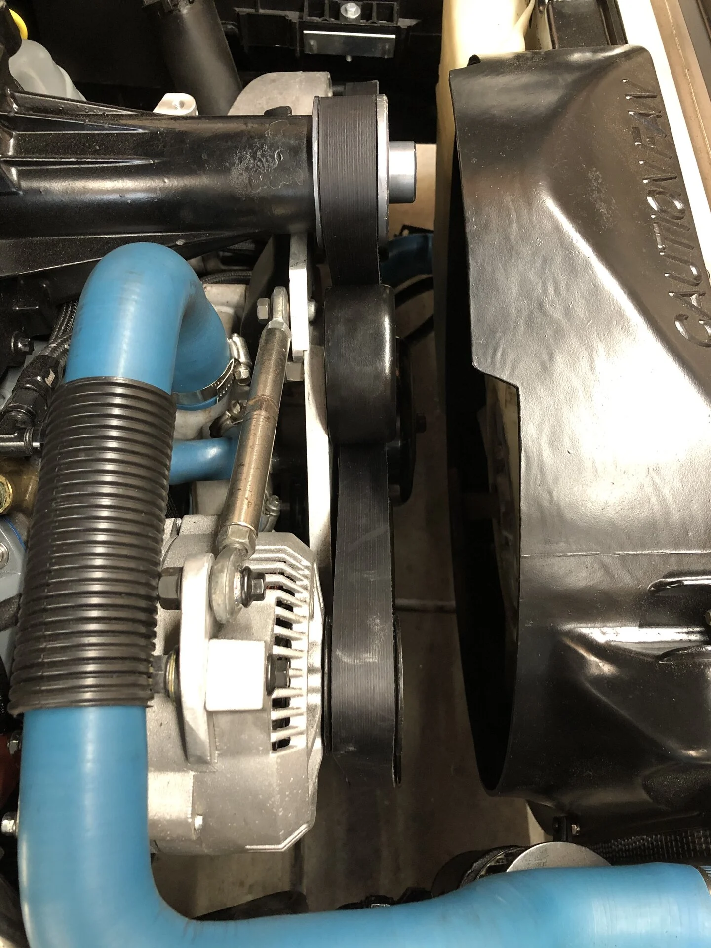

I looked back a bunch of pages to find pics, that looks like a lot of belt wrap.
I'd be kinda surprised if it was slipping.
you may be right, there is a lot of belt dust though. I didnt post a pic but i'm actually using a bigger idler to the left of the blower and it wraps even more. The blower pulley and crank are for an 8 rib belt so i might as well get the rest of the pulleys and run an 8 rib. If anything it wont look like I'm running the wrong belt and it certainly wont hurt.
I did this and I did get less belt dusting.

Well , can't get much better wrap then that.

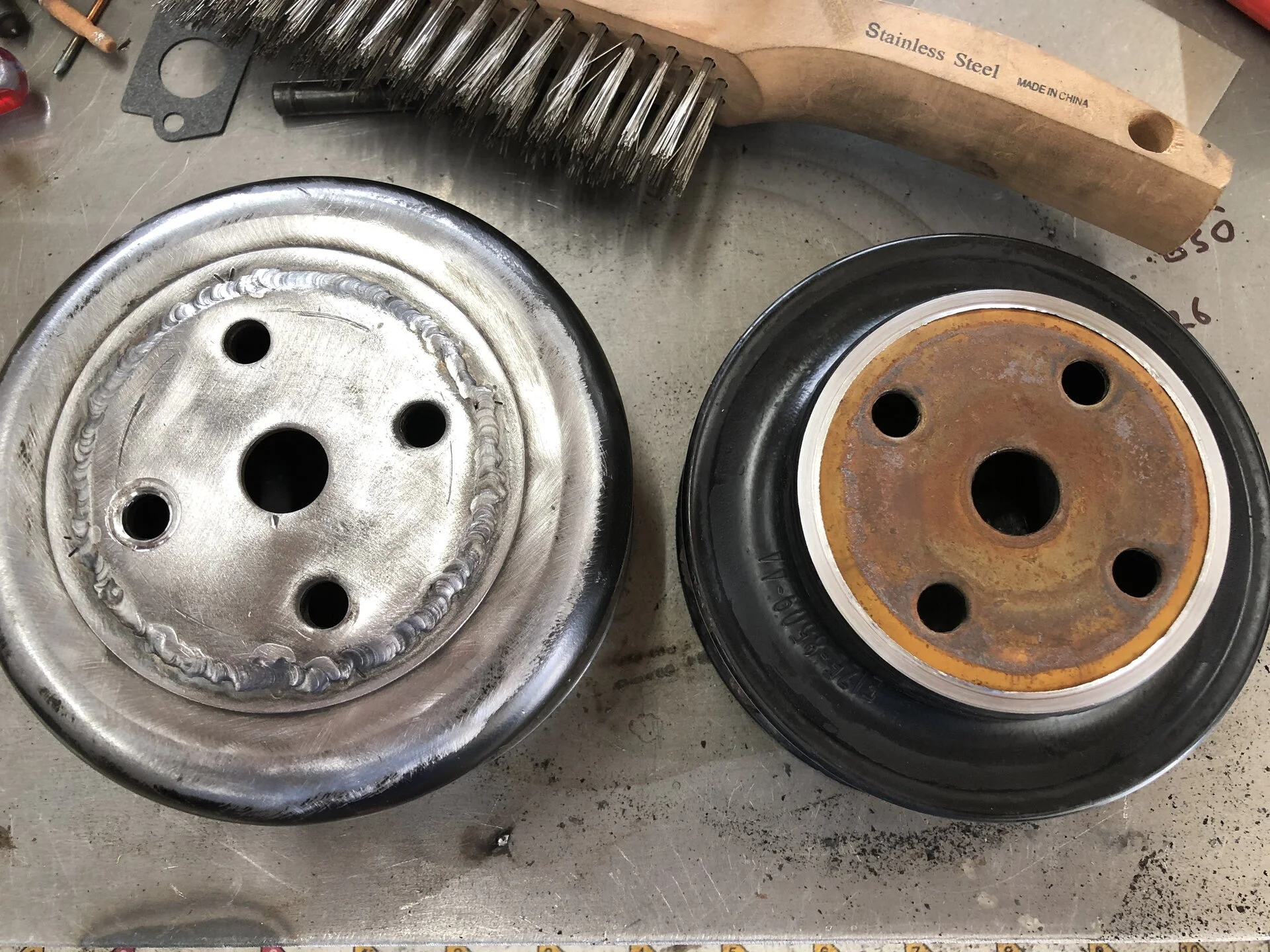

Water pump pulley was a bit of work. It’s a 1/2” bigger, water pump pilot hole was way big and bolt pattern different. Some lathe work and welding required. There was a huge lip on the back side I had to turn off. It’s about .032 from the crank pulley which means I need to remove to put belt on.

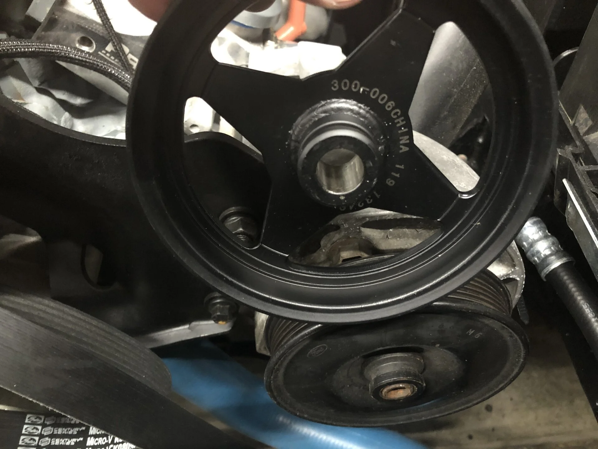

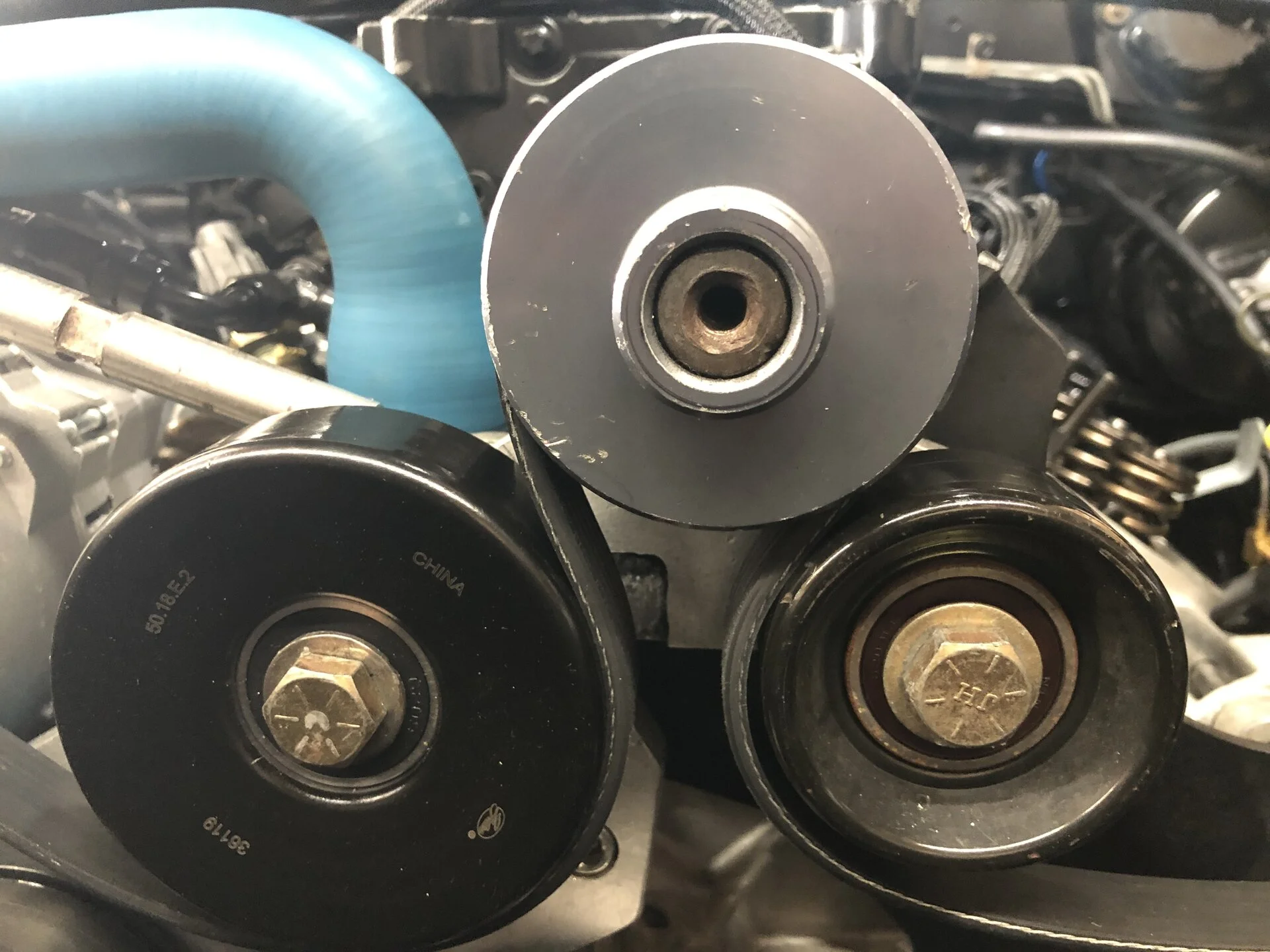

Just waiting on one more idler and p/s pulley puller my brother borrowed but I did get things mocked up. Had to move the alt. back a bit.
