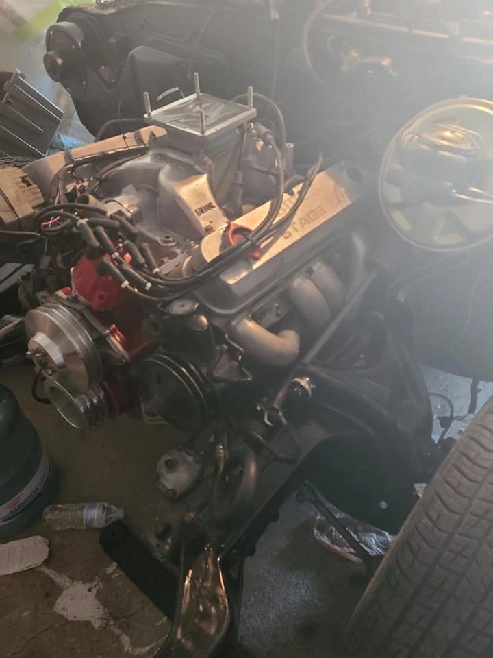

I also helped my neighbor get the headers on his Buick GS it’s a beast 670hp 441ci I think

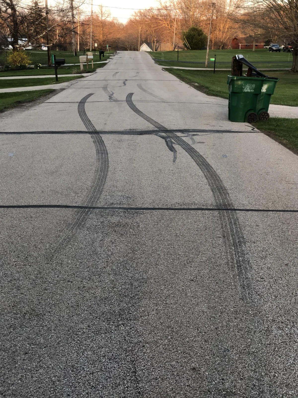

I see that traction may be an issue. Sounds good, makes me miss it. If you had to guess what's the ass-o-meter say for power?
Hard to say. I’m not good at guessing HP but I will say you can’t lean forward in your seat when you really get into it lol. I need to pick up some belt dressing, it’s definitely slipping. I can’t wait to get it on the dyno
