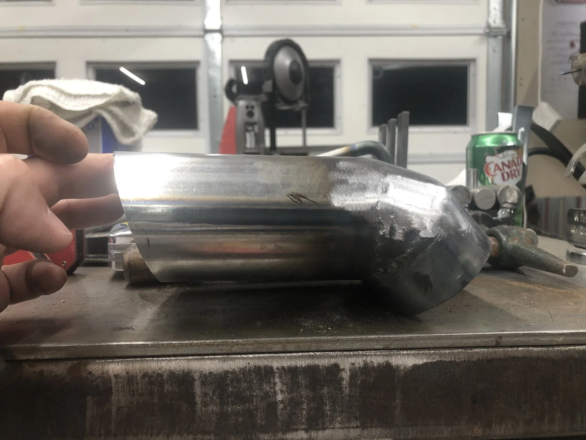

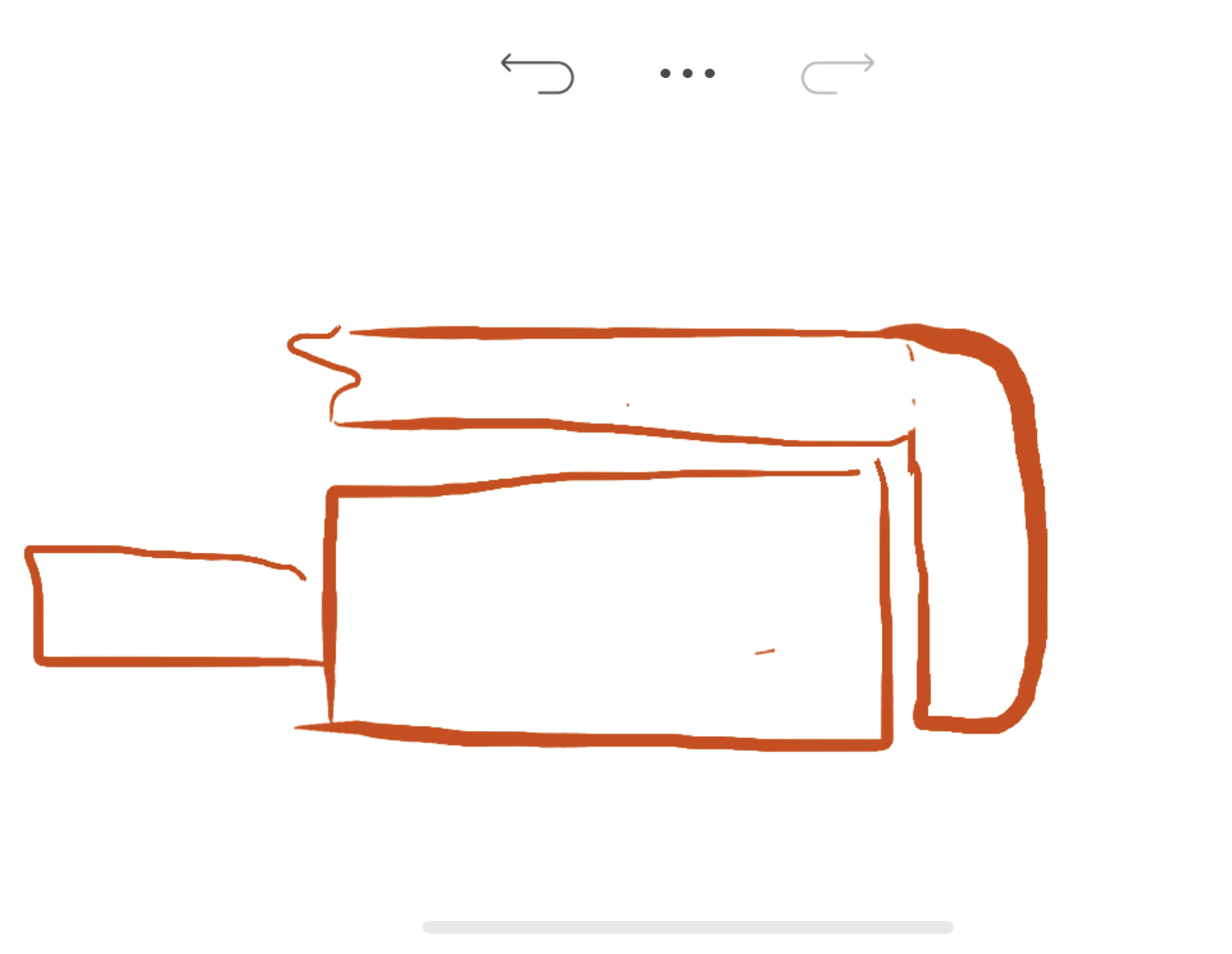

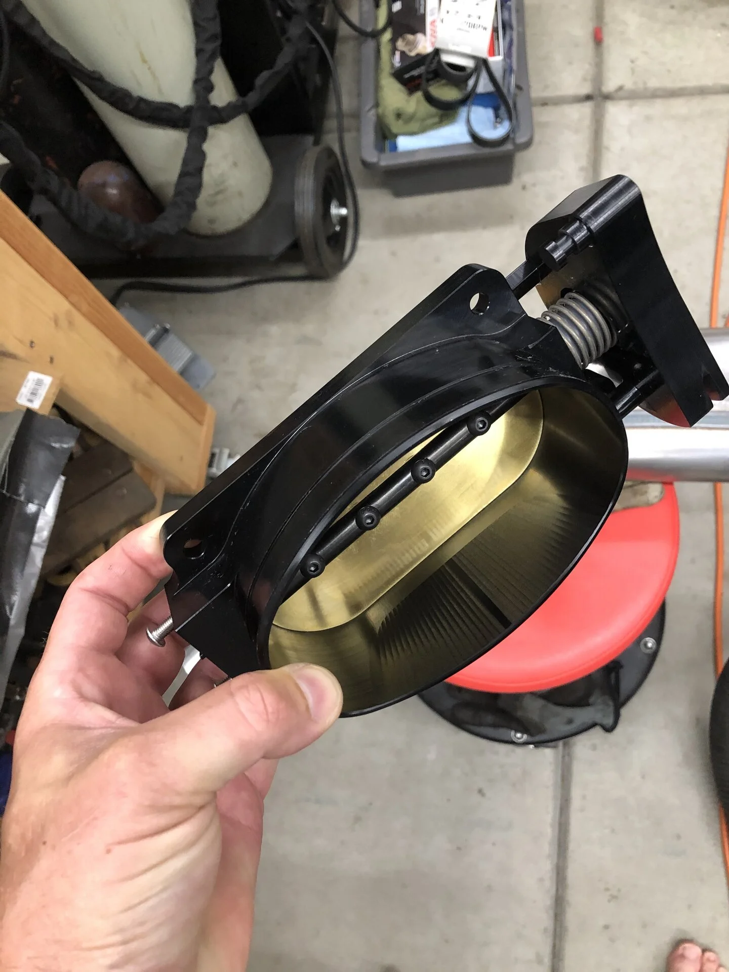

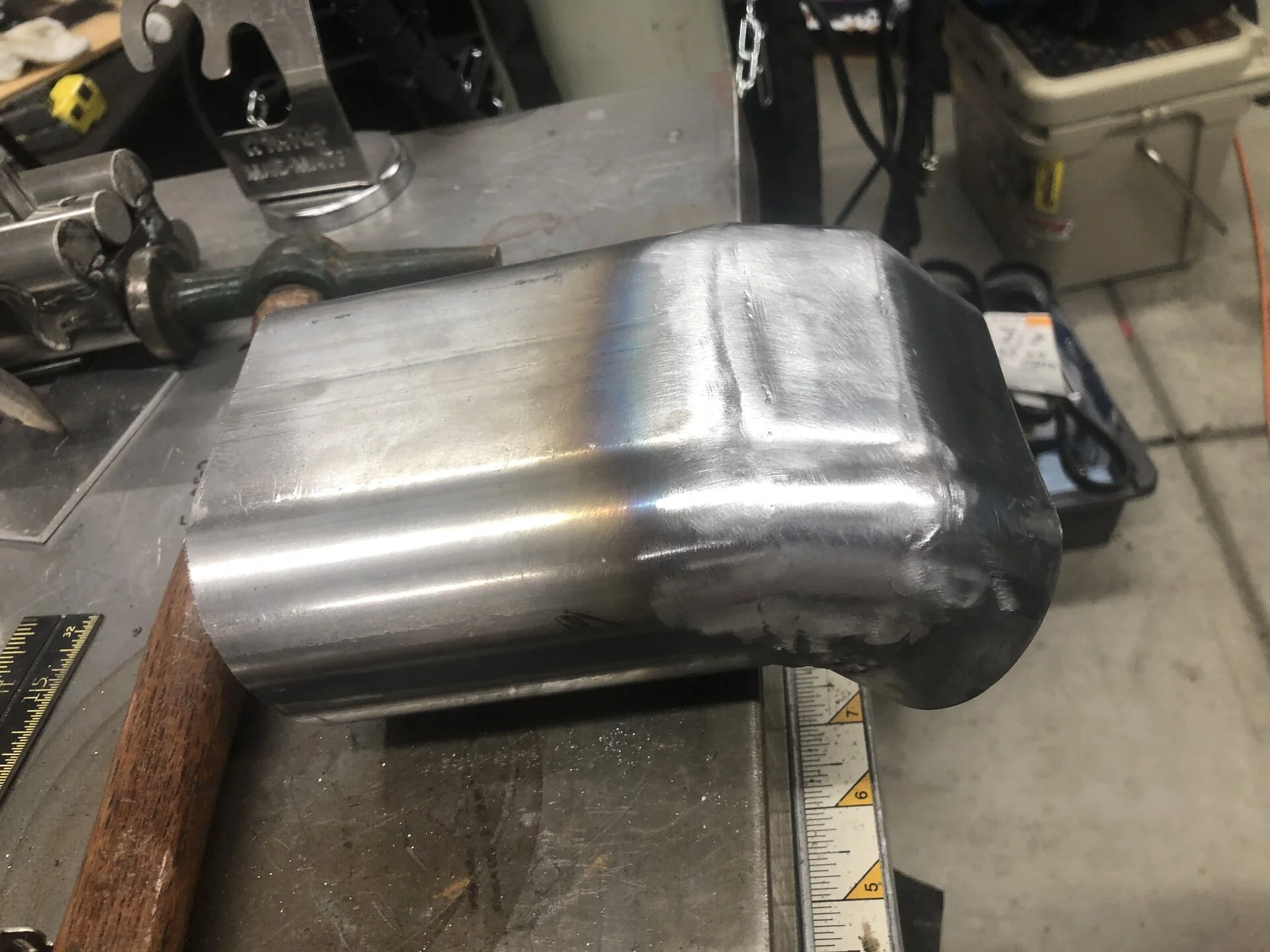

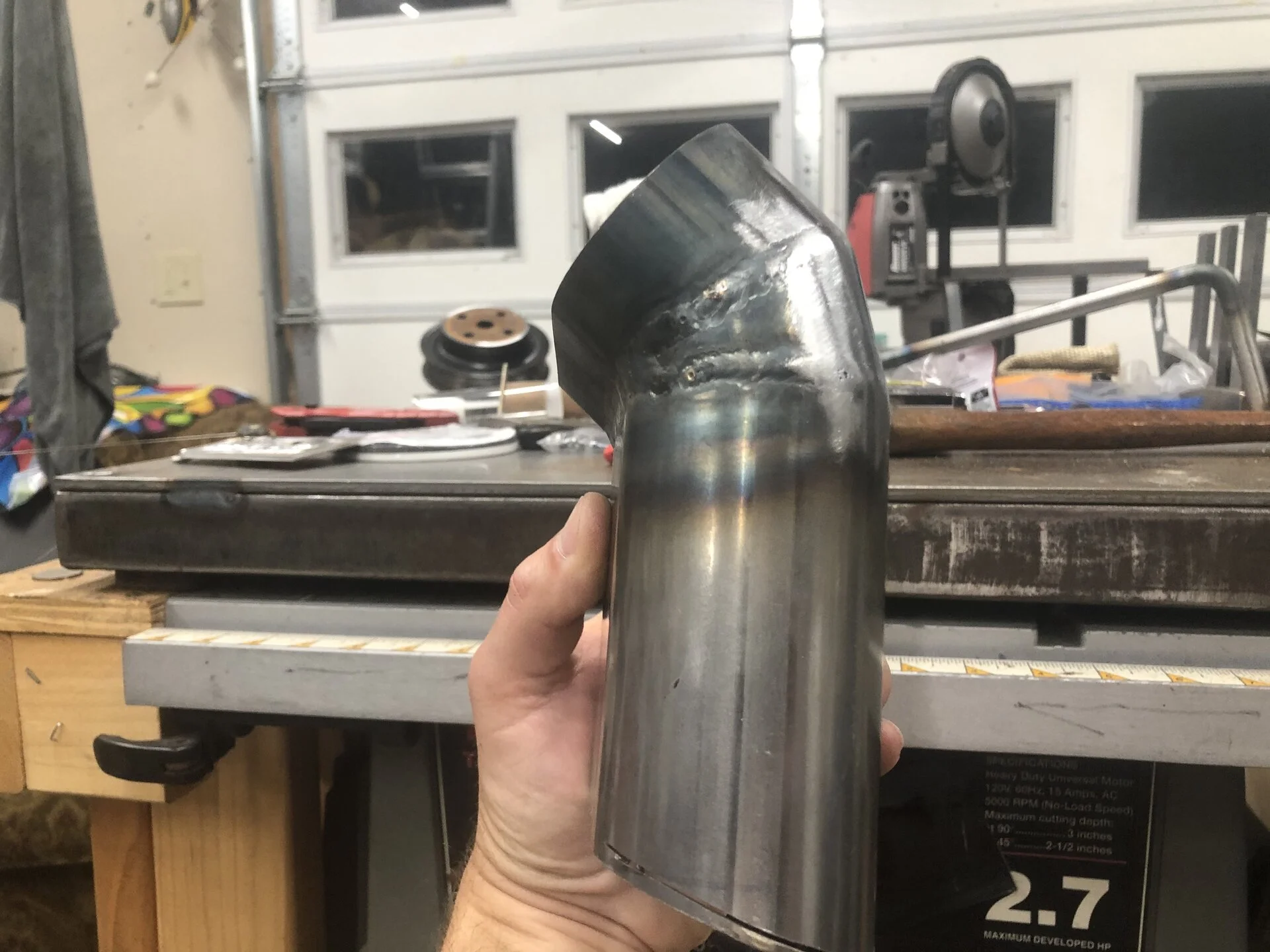

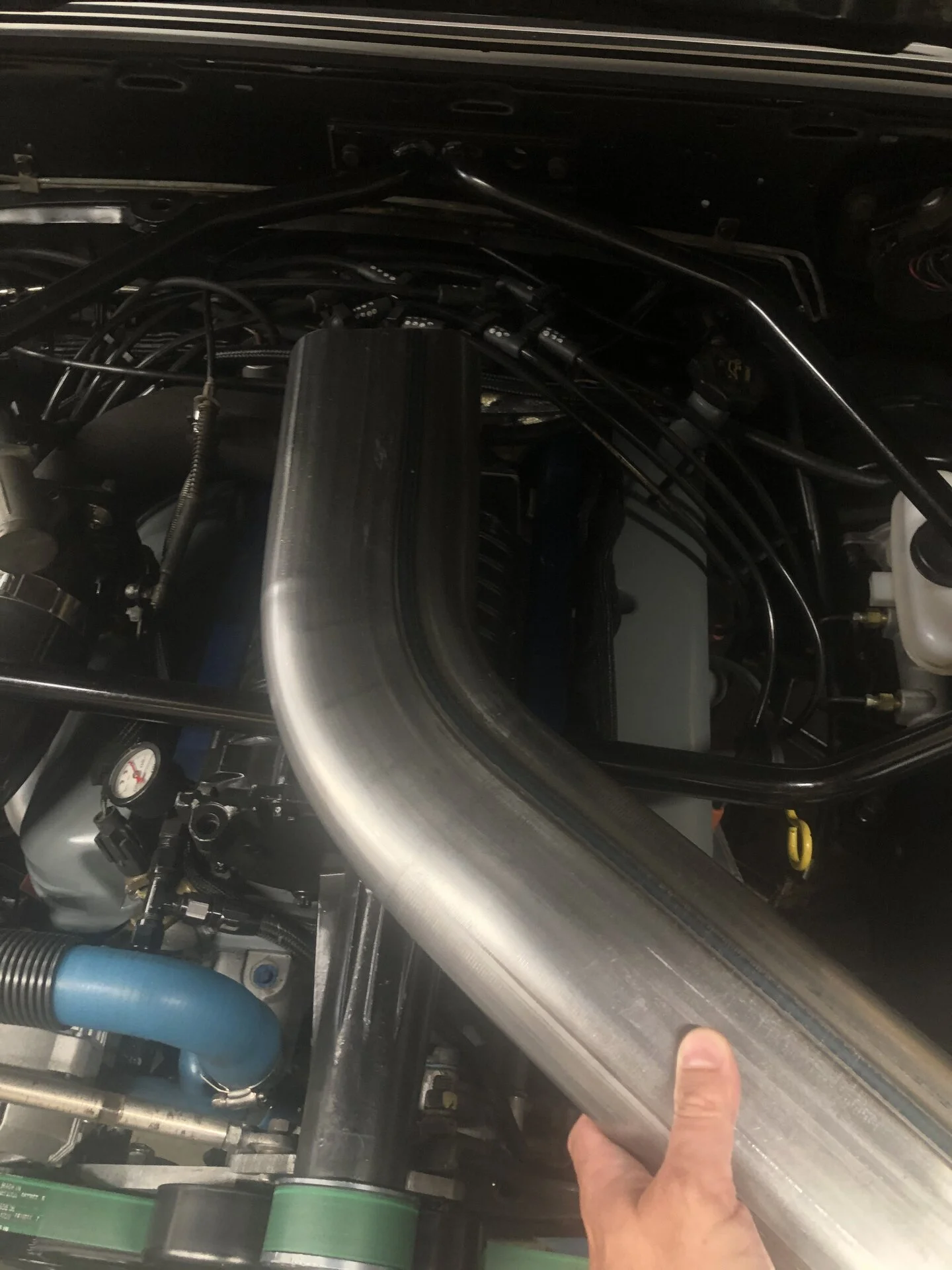

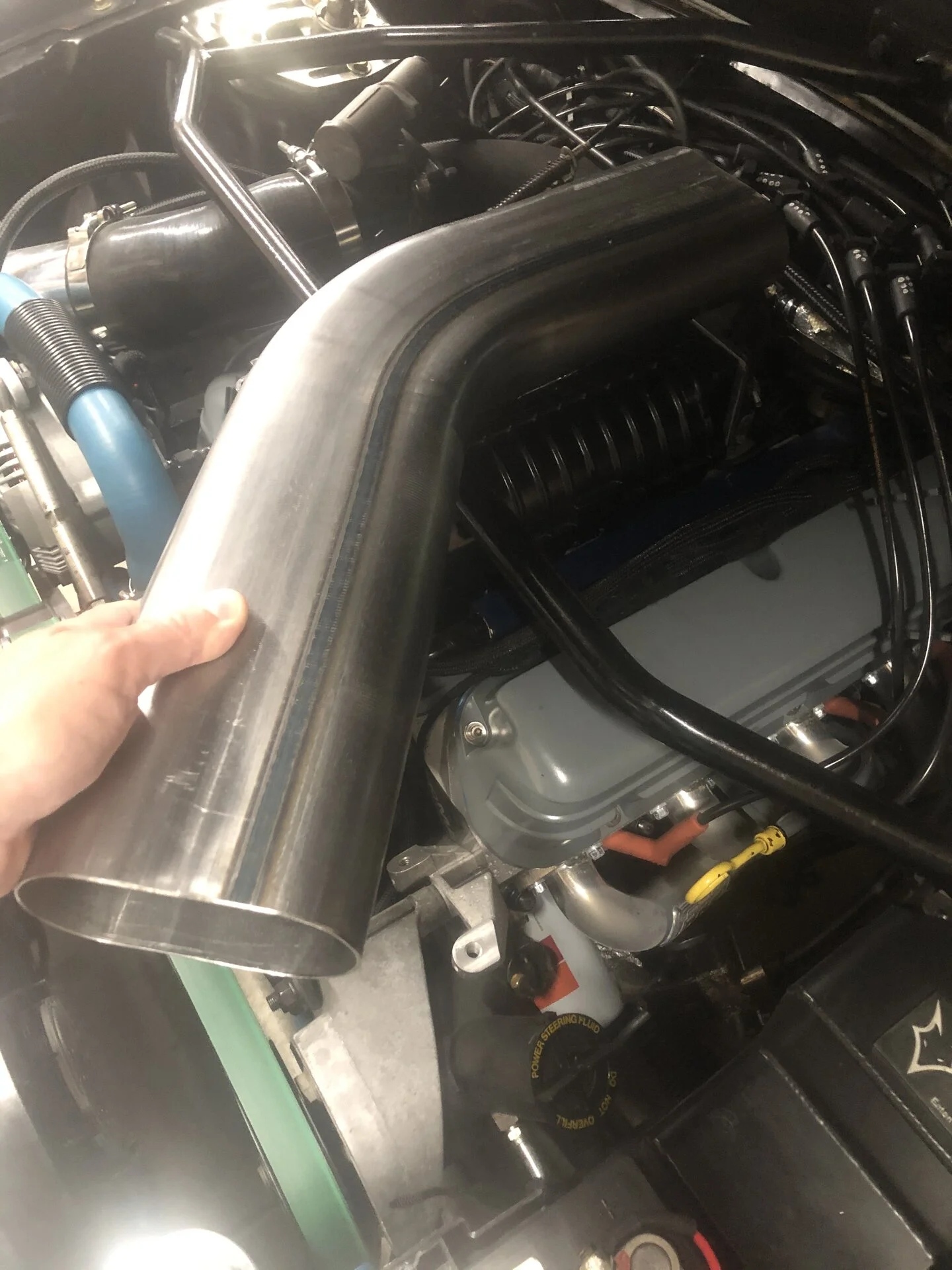

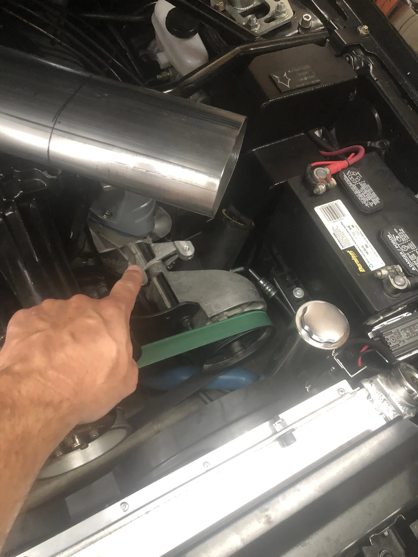

Well I got the tubing to redo the intake track. This oval tubing is equivalent to 4” round. I also wanted to see how I’ll make the downward transition to the area where the a/c compressor would be. Turned out pretty good, I may clean it up some more and use it.
