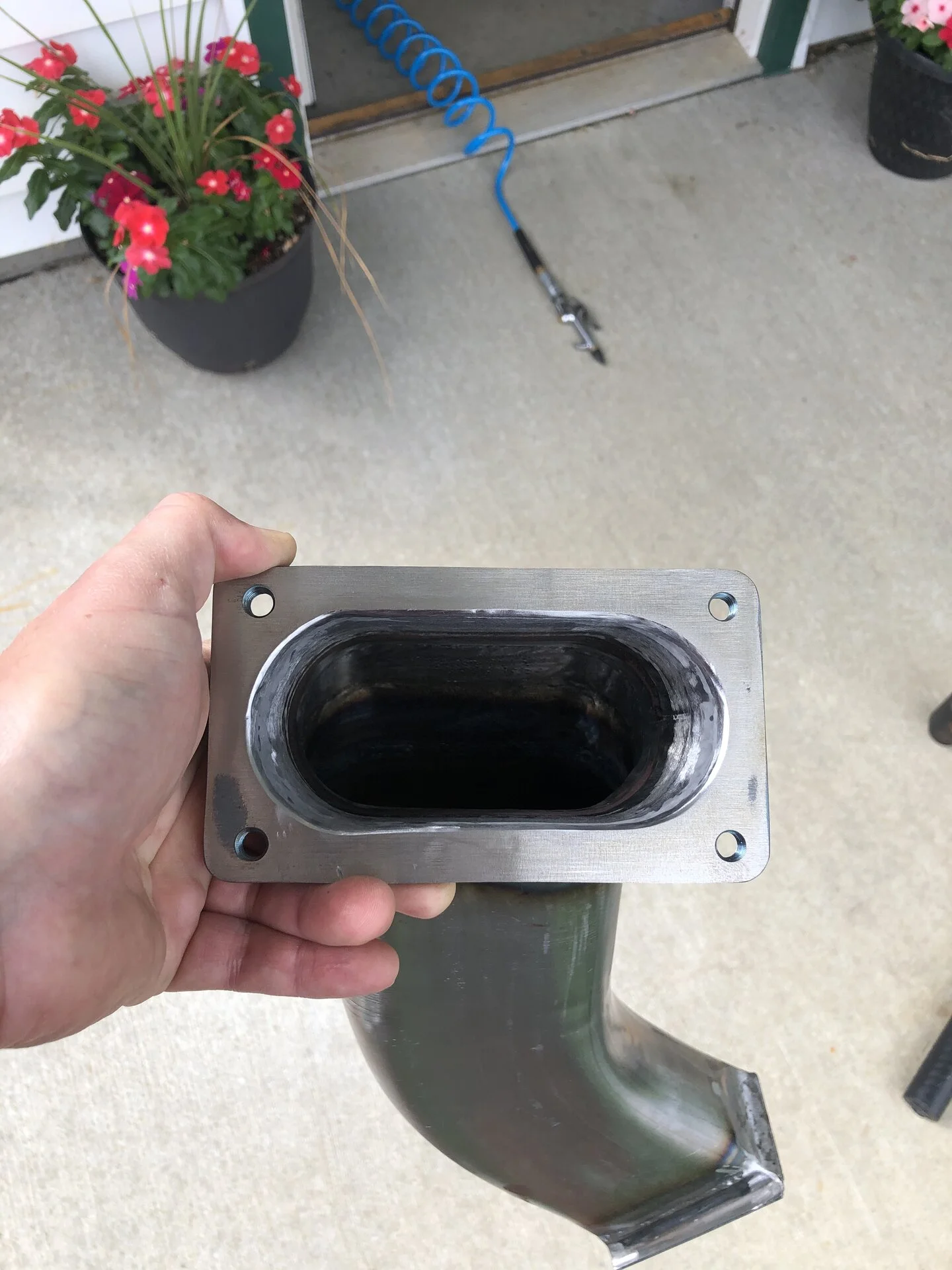

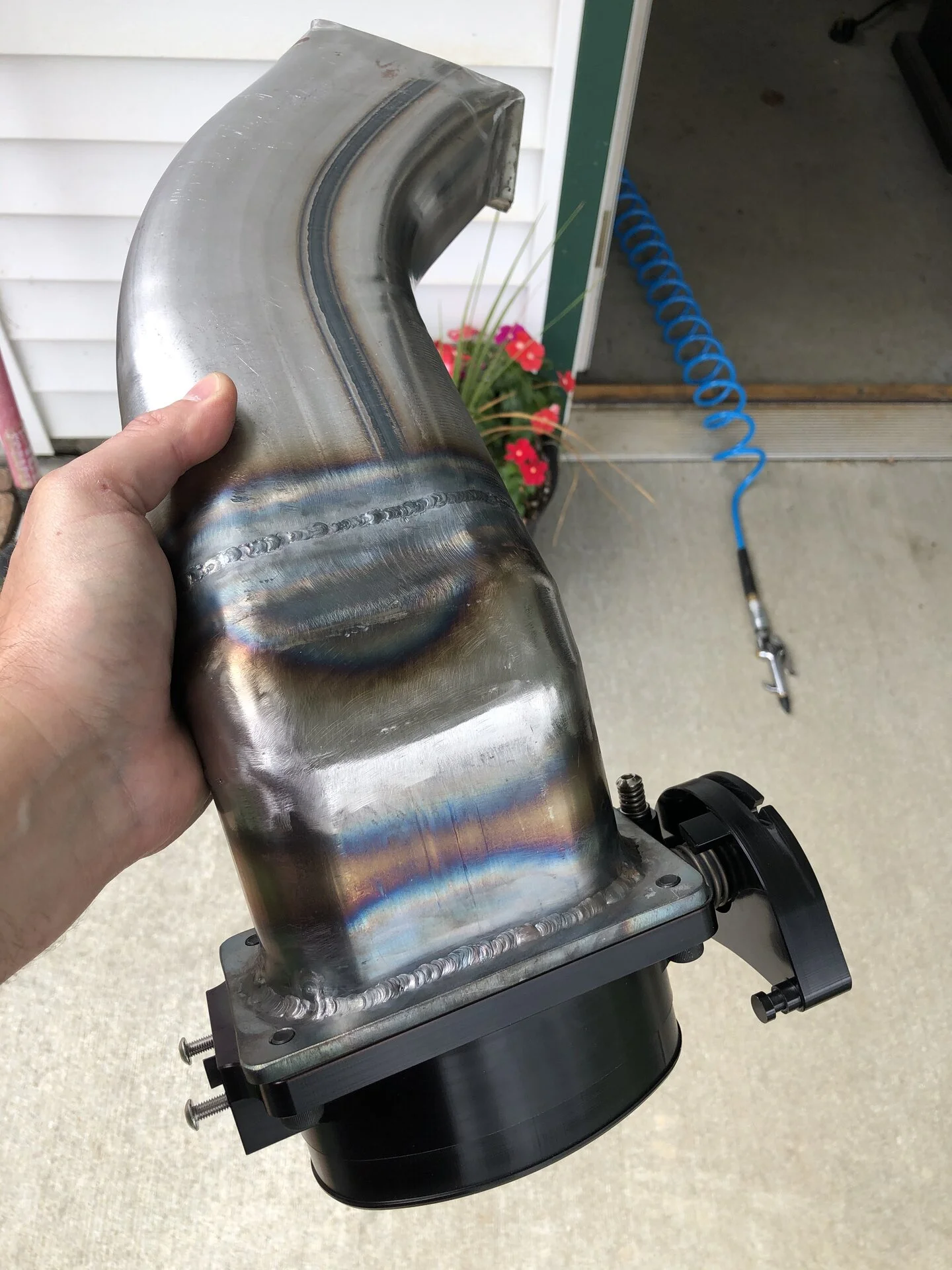

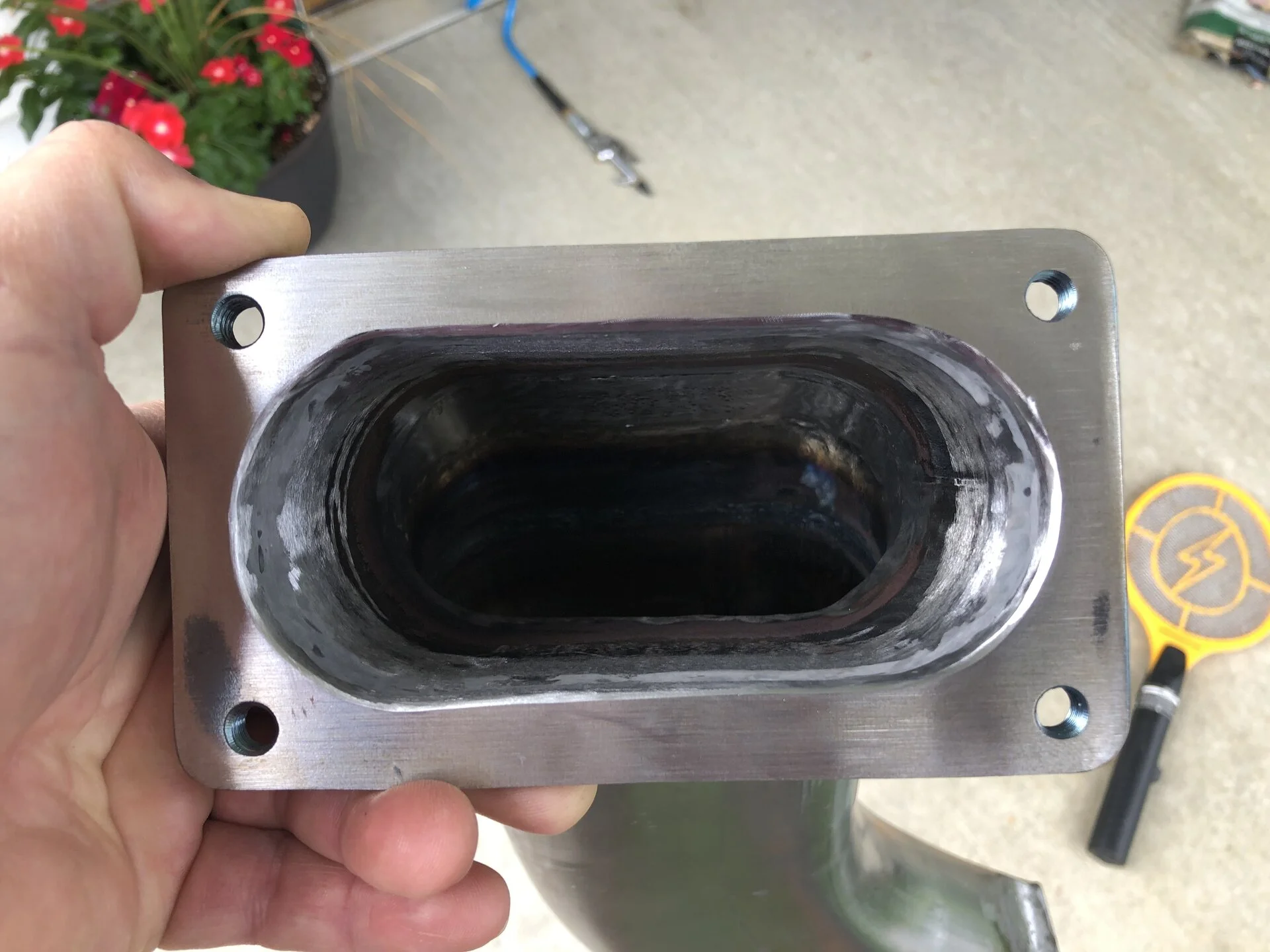

Did some more work on this.

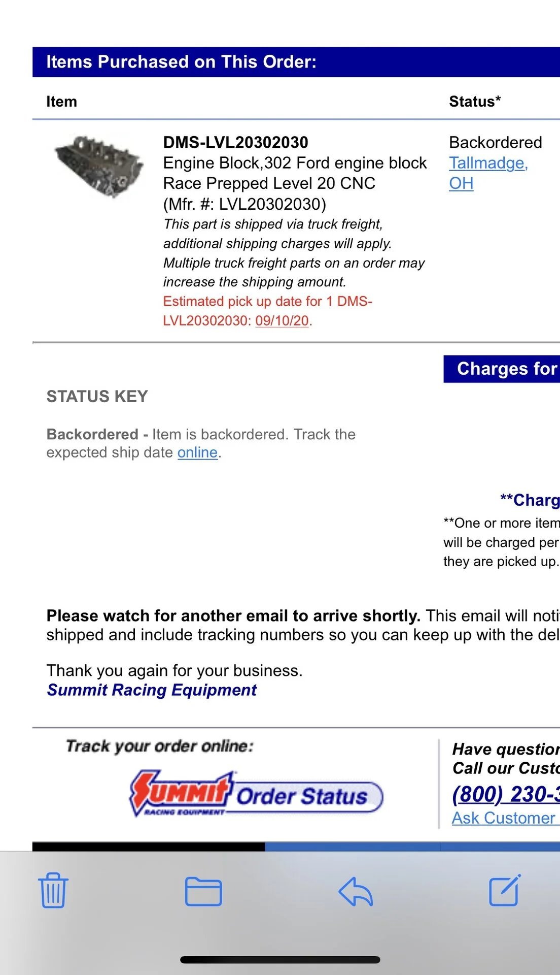

Well I decided to buy a DSS block. I figured with all that’s done to these blocks it’s not a bad deal and I’ll have a spare block or rather a nearly complete block with the old e7 heads for a roller project if I come across something I like. Wouldn’t mind an old falcon for my wife.
