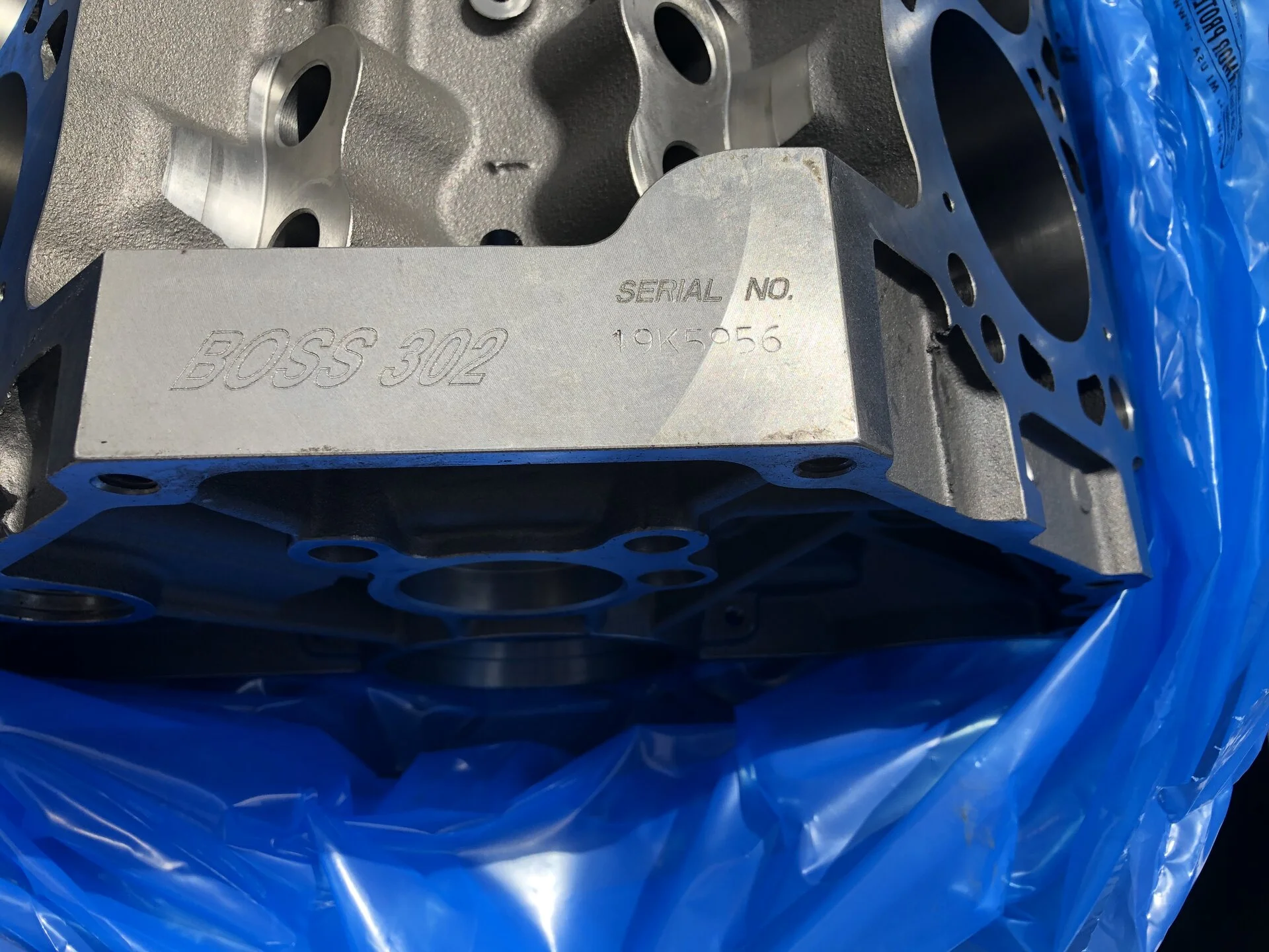

Progress Thread She’s a runner

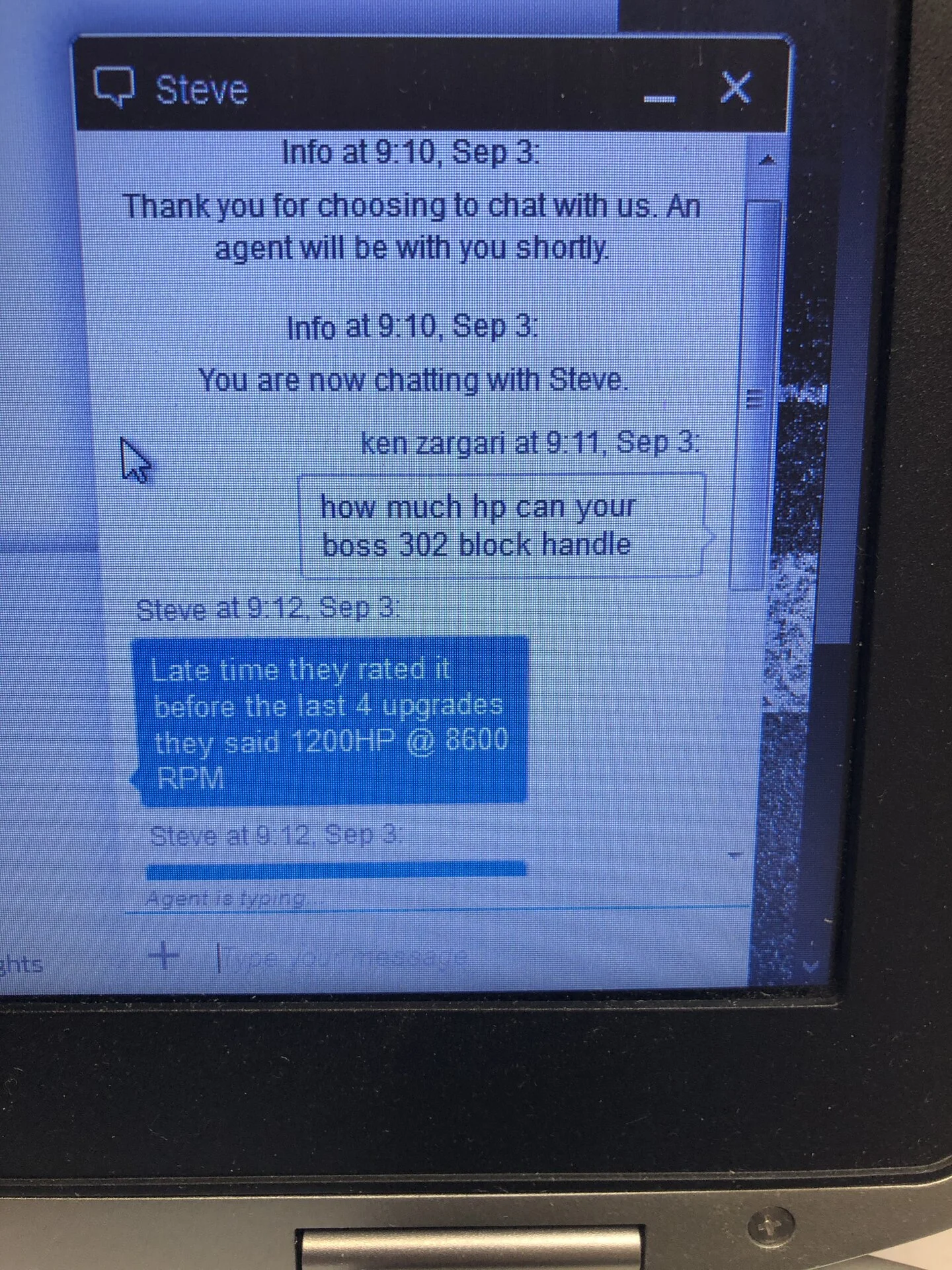

Chat I had with ford performance...
He also said there isn’t a stronger block... I’ll take that with a grain of salt.

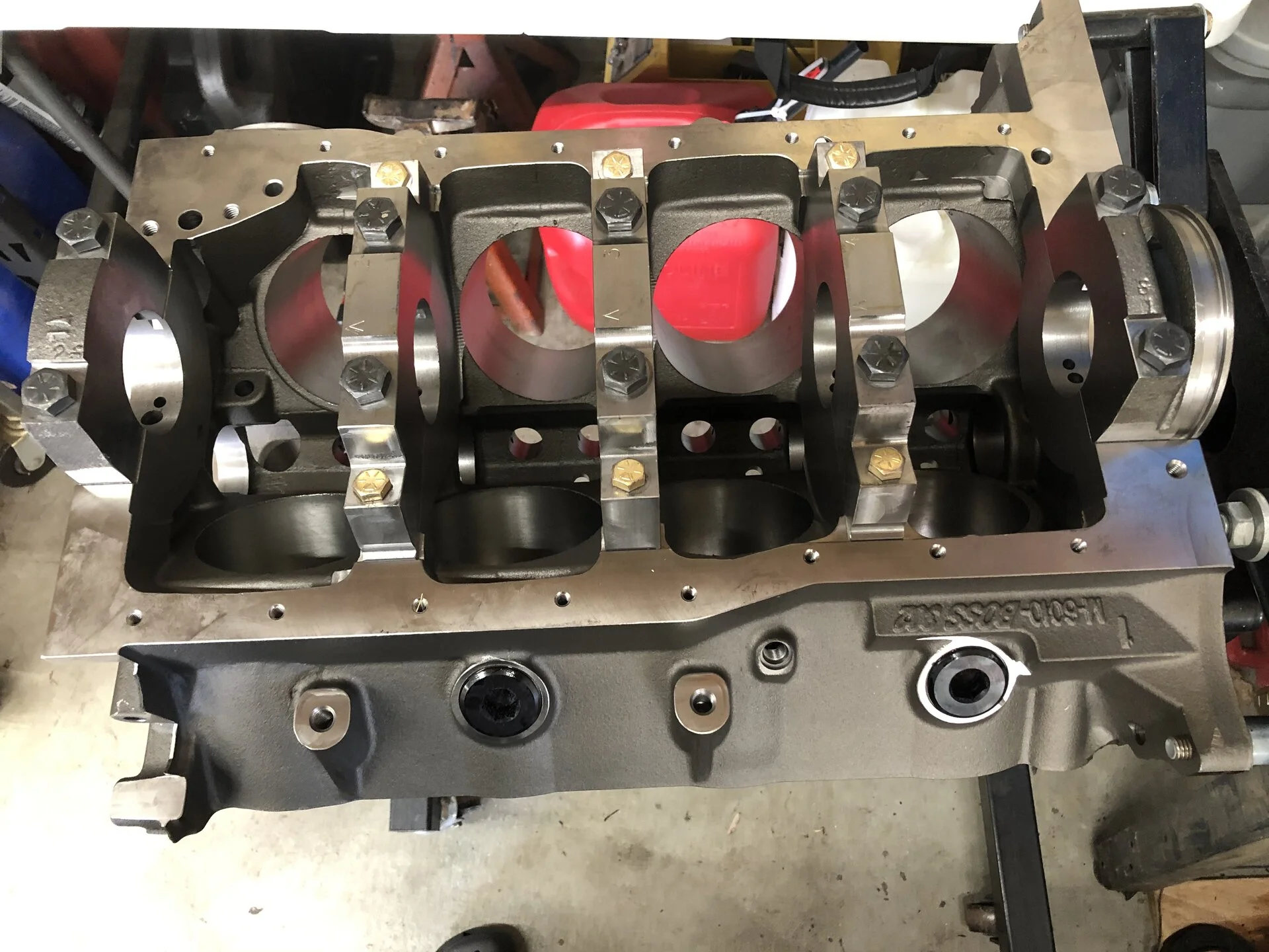

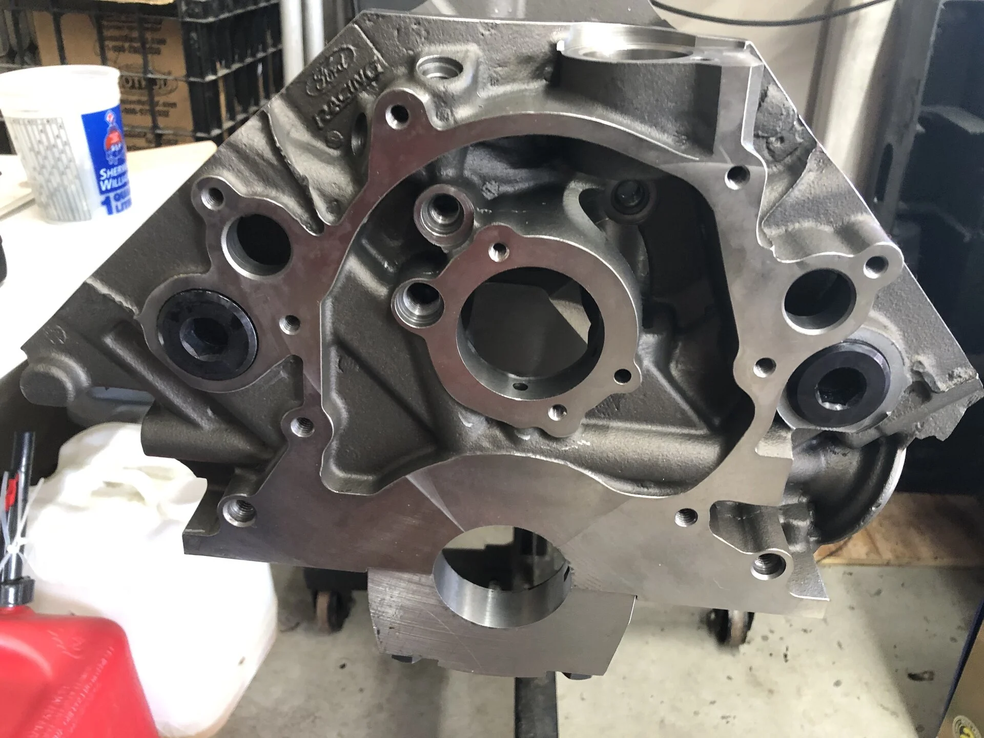

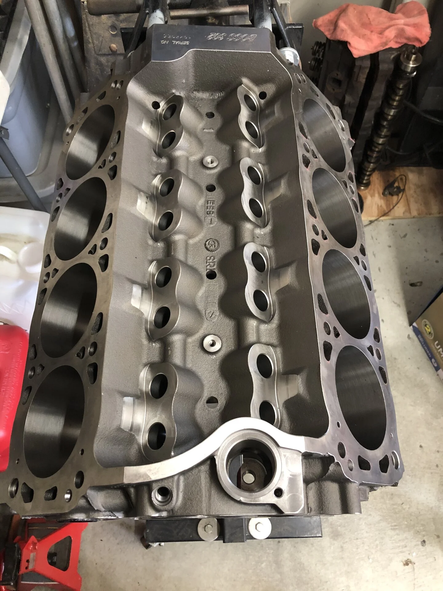

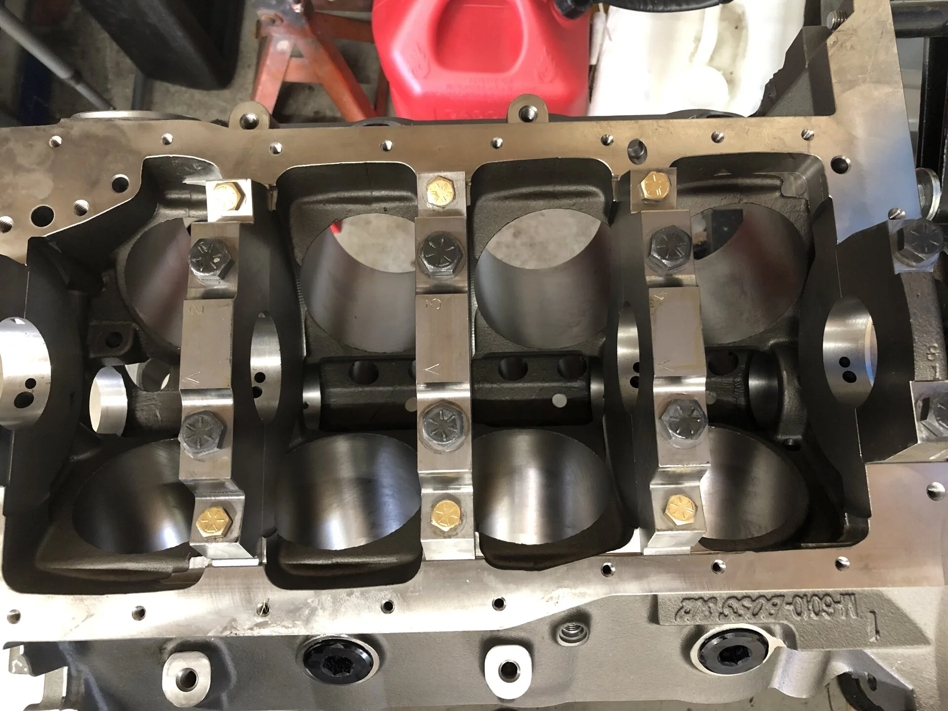

It’s a beast! Look at the lifter valley
Internal or external balance. So here’s why the question. This block comes with unfinished bores. They are ~3.998 so it seems almost like a waste to go .30 over. Eagle makes one (342) forged rotating assembly that’s standard bore but internally balanced. I’m not worried about getting a flywheel and balancer but back many years ago (20) ish I remember some crazy looking cranks after balancing, think Swiss cheese. Anyone see this issue nowadays?
You never said that you bought one,..is this “ yours” or is it a pic of “ theirs”
It’s all mine! I’m really glad I chose this block. Gonna work on deburring it today ford did all the easy stuff but still some sharp flash here and there.
I wonder if the few cranks I saw back in the day were due to a bad job balancing. For some reason that stuck in my head.

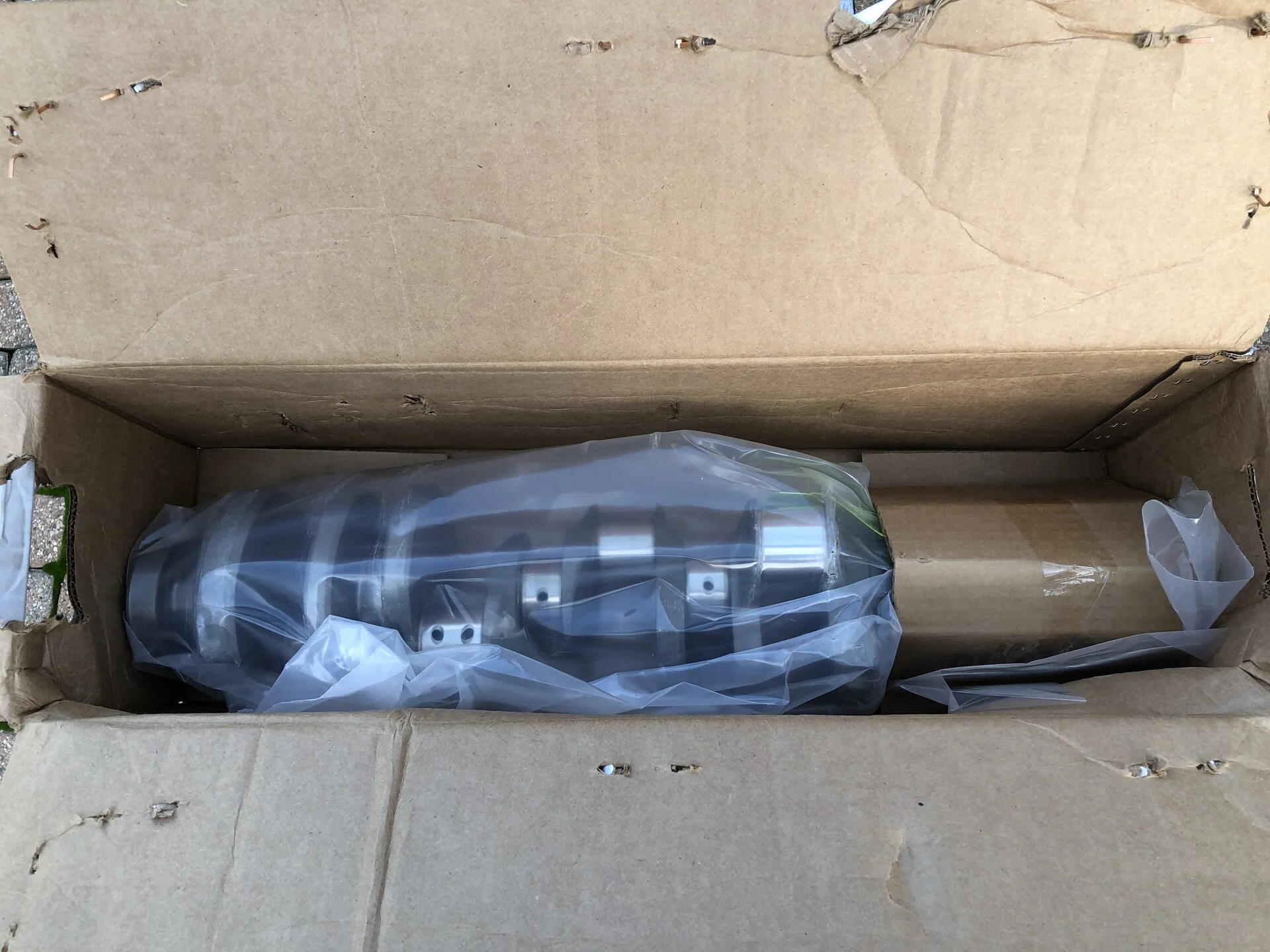

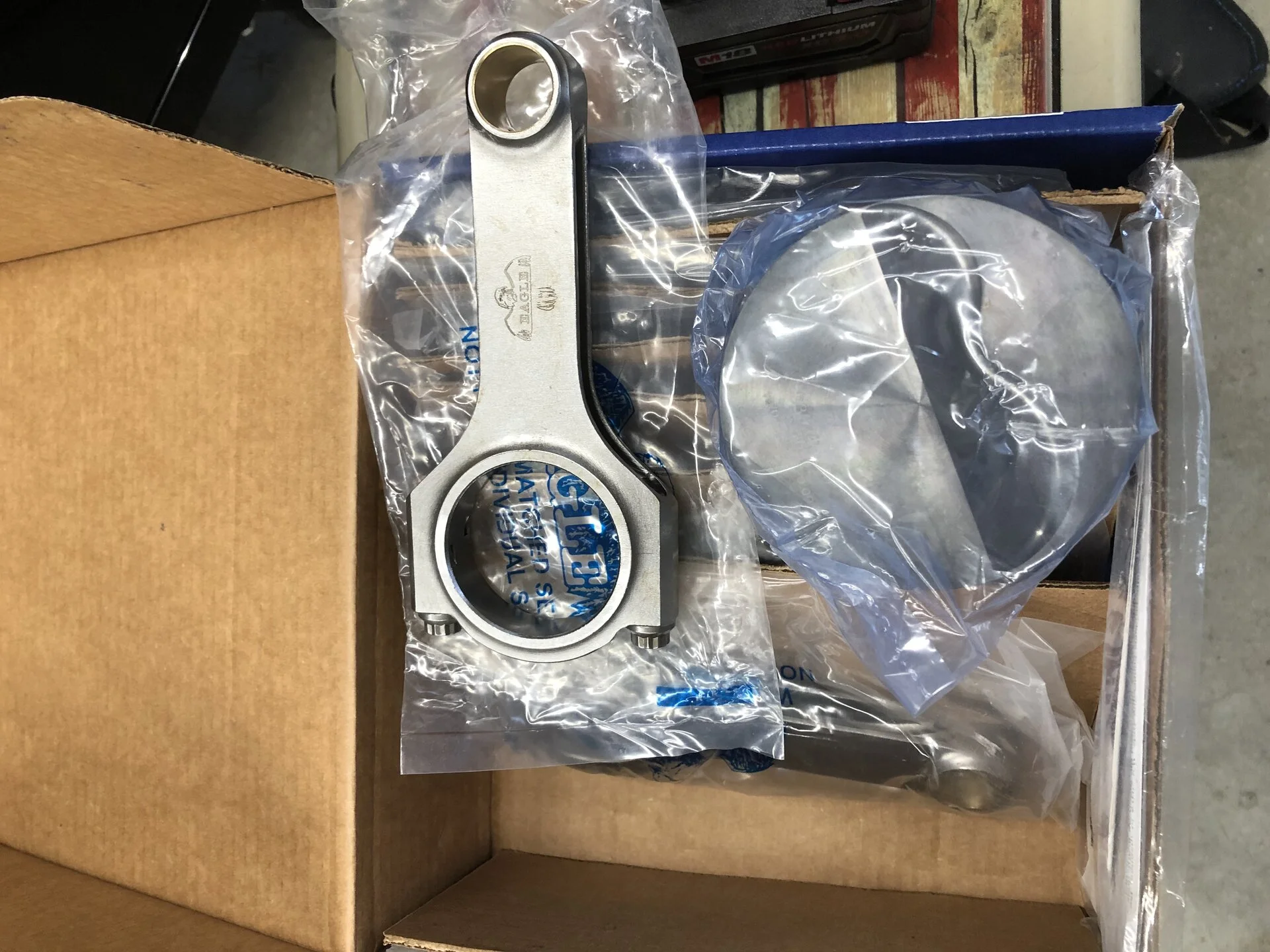

rotating assembly showed up today! I gotta say, eagle needs some help in the packaging department. Just loose in a box for something this heavy and expensive. Hopefully it’s straight lol
