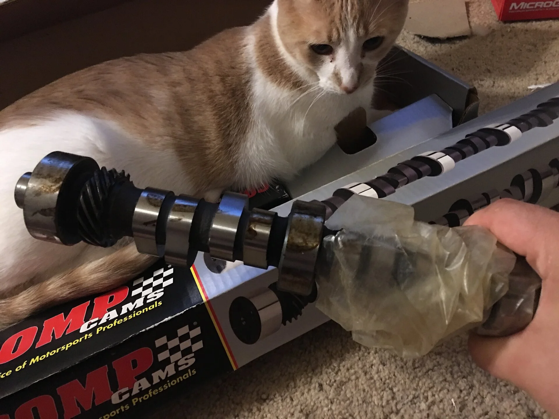

I use xe282hr Comp Cam. Low vacuum at idle below 1k. Had to use a vacuum pump for power brake booster. Turbo 331...TW heads. I will be getting in touch with Freezy when its time for the Dart block.
Speaking of camshafts...what the heck is a 1/2, 3/4 or full cam ? Older guys ( over 60 ) keep asking me if I have a 3/4 ( thre qwarta ) cam.
lol ya thats from the 50's cams were limited and mostly higher lift was the only difference from stock. think stage 1, 2, 3 which is also not a helpful description... :shrug:
Reactions: 90sickfox

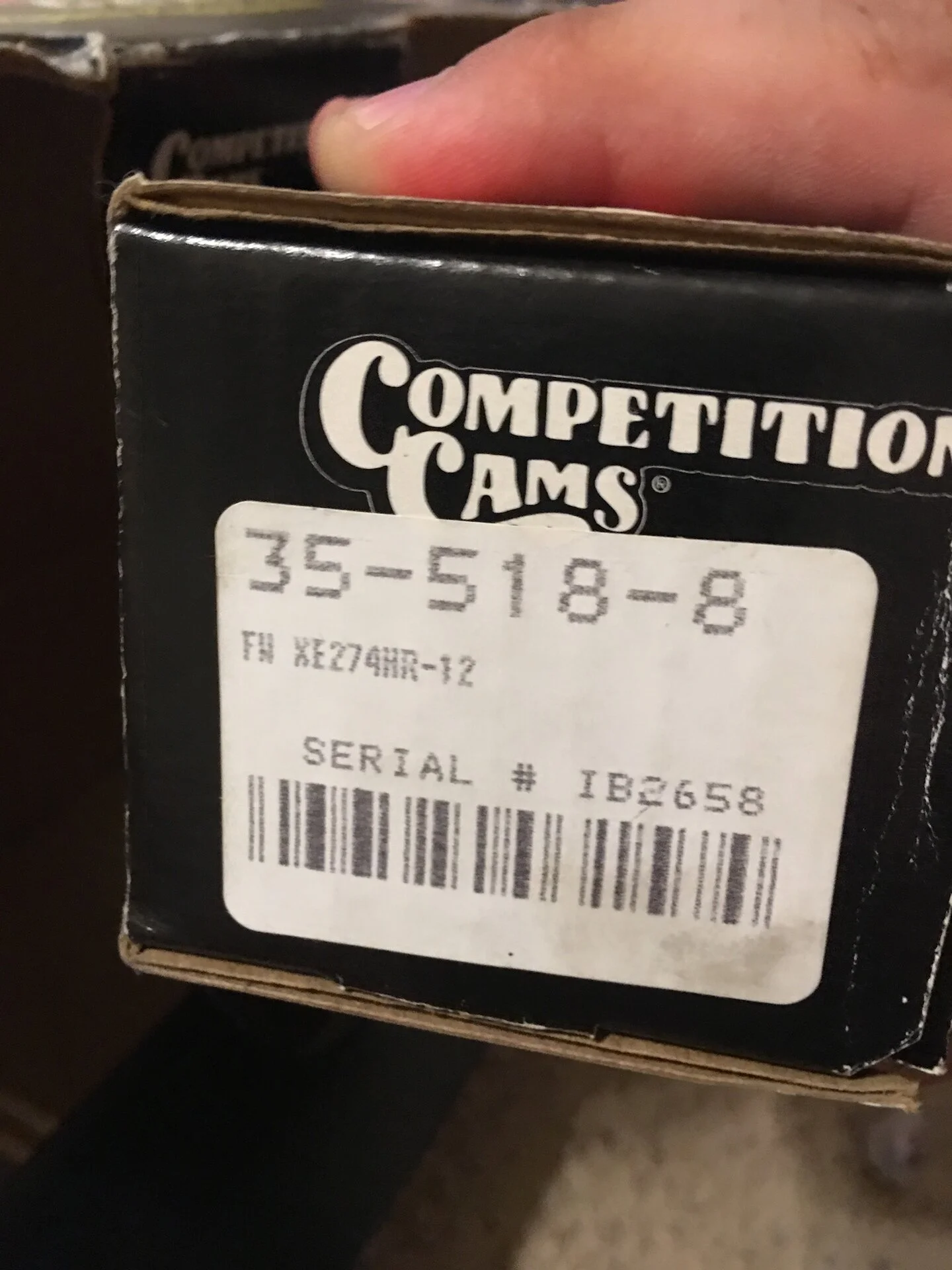

I have XE cam version of that cam on my shelf
Will that work for you??

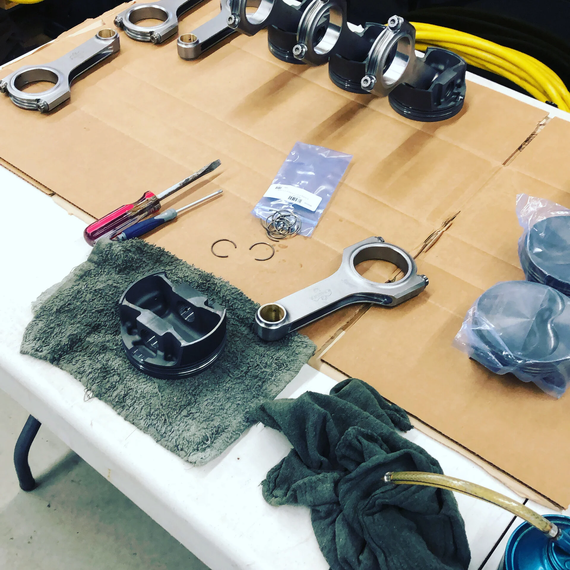

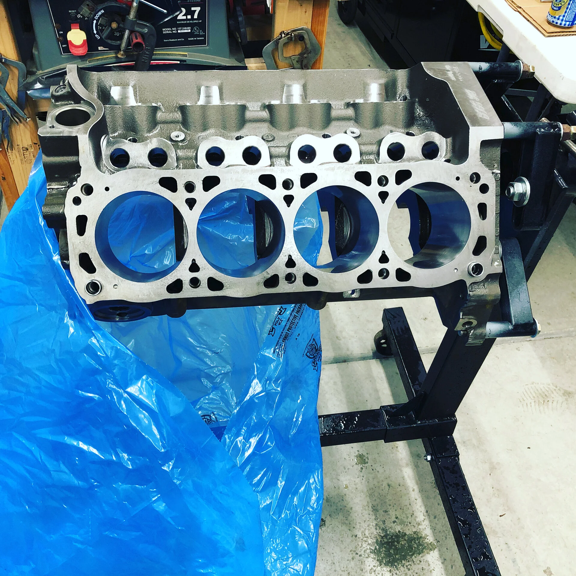

Quick update. Cam should be here in a week or so. Block and crank should be done this week. Started putting the rods/pistons together. Definitely going with a tko 600. Not sure I’ll get all the upgrades but we’ll see, that’ll be the last thing I order. Clutch Ram HD or McLeod twin disc street. Huge price difference between the two...
