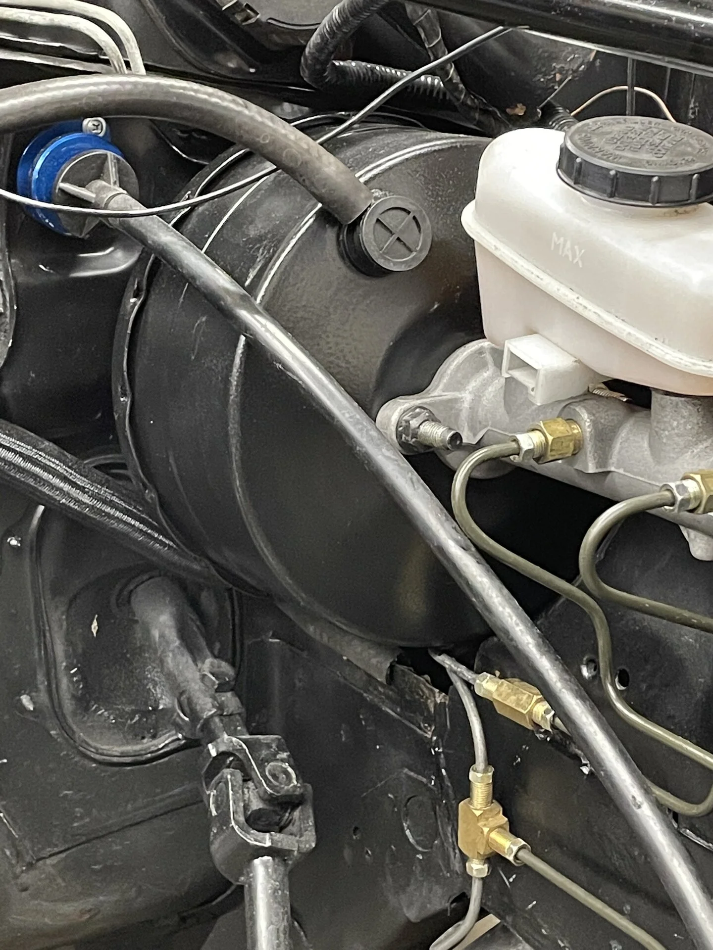

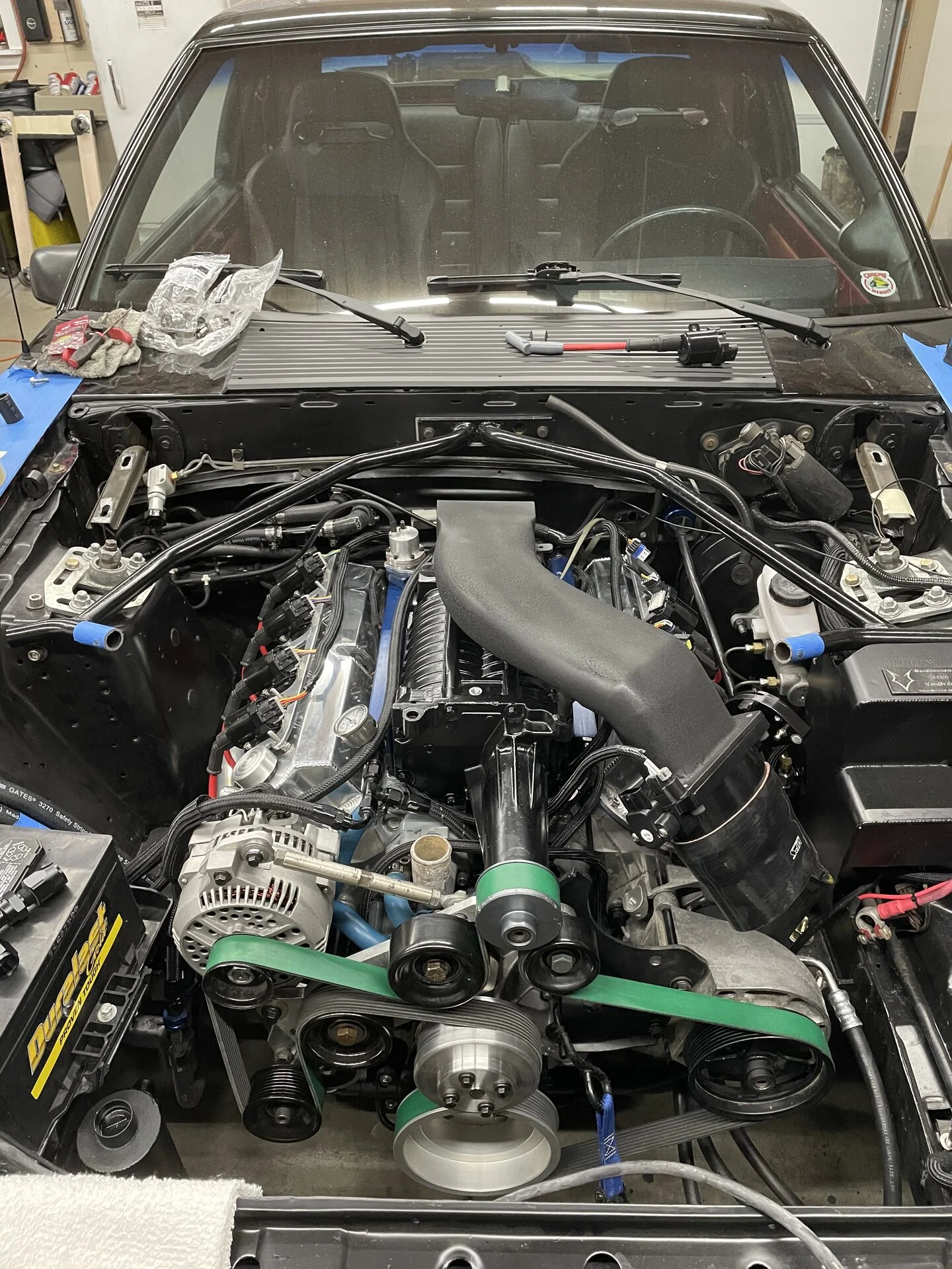

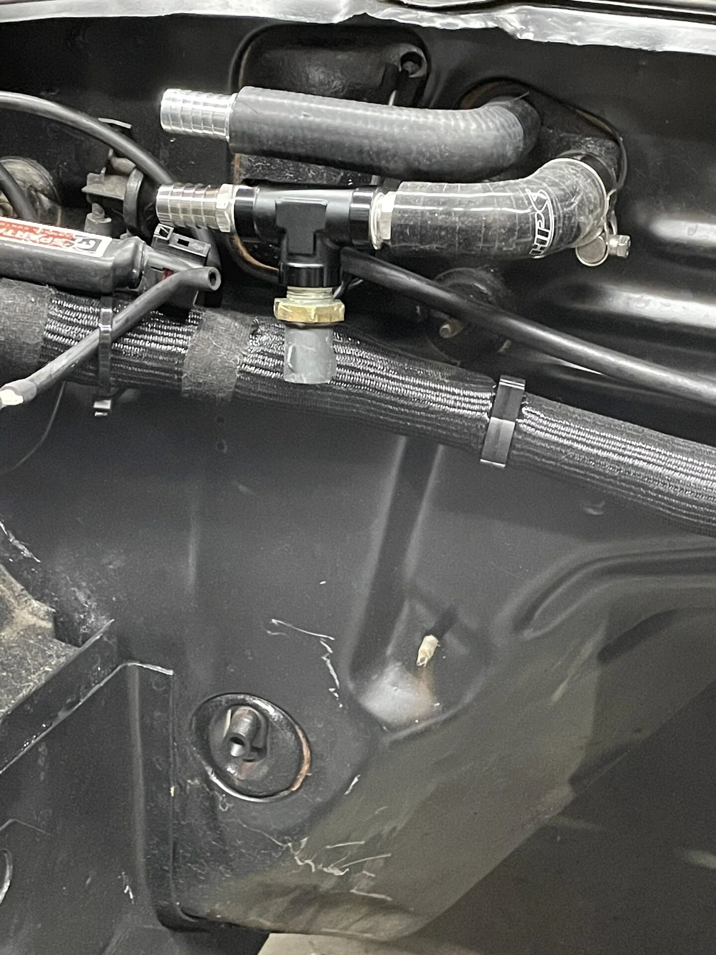

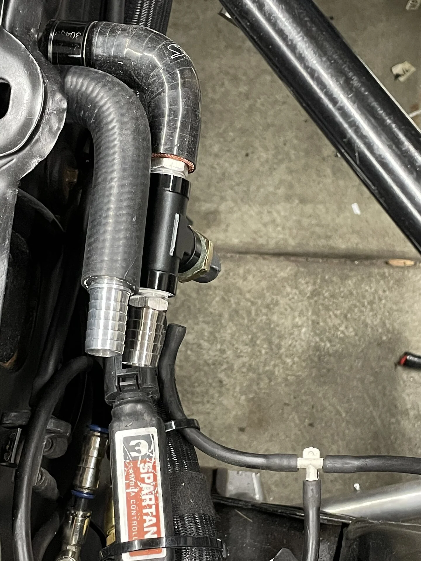

I think I’m gonna try to route the heater hoses through the fender. Also something just dawned on me, does the body of the ect sensor need to be grounded?

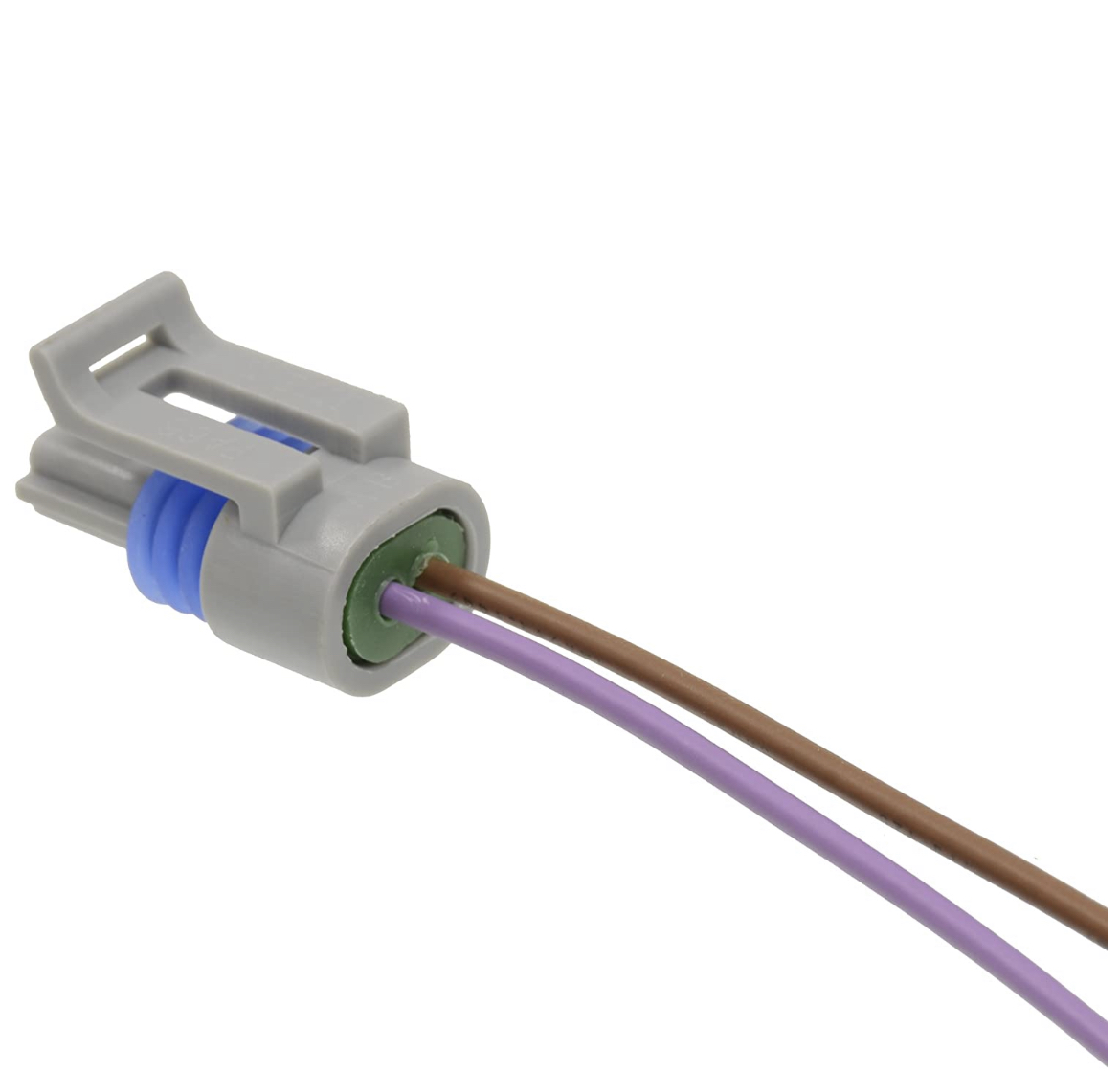

I’m seeing they don’t recamend mounting the GM sensor in the intake due to heat soak. Doesn’t that defeat the purpose if you aren’t reading intake temps? Or is there a setting in ms to compensate this?
Lol. Basically yes, the mat air density curve and blend curve. They are already tuned for that application however and should not need to be touched. I monitor intake temps and ambient temps fwiw
Ok. I’ll pick up the GM sensor and swap out the Ford one. I do recall thinking the current sensor was a bit slow. I felt the change in temp especially when I know water/meth is being injected was delayed by a few seconds!

@a91what which wire is which? Signal return etc...
sensor threaded right in with no issues, actually it fits better than the Ford one since it physically smaller.

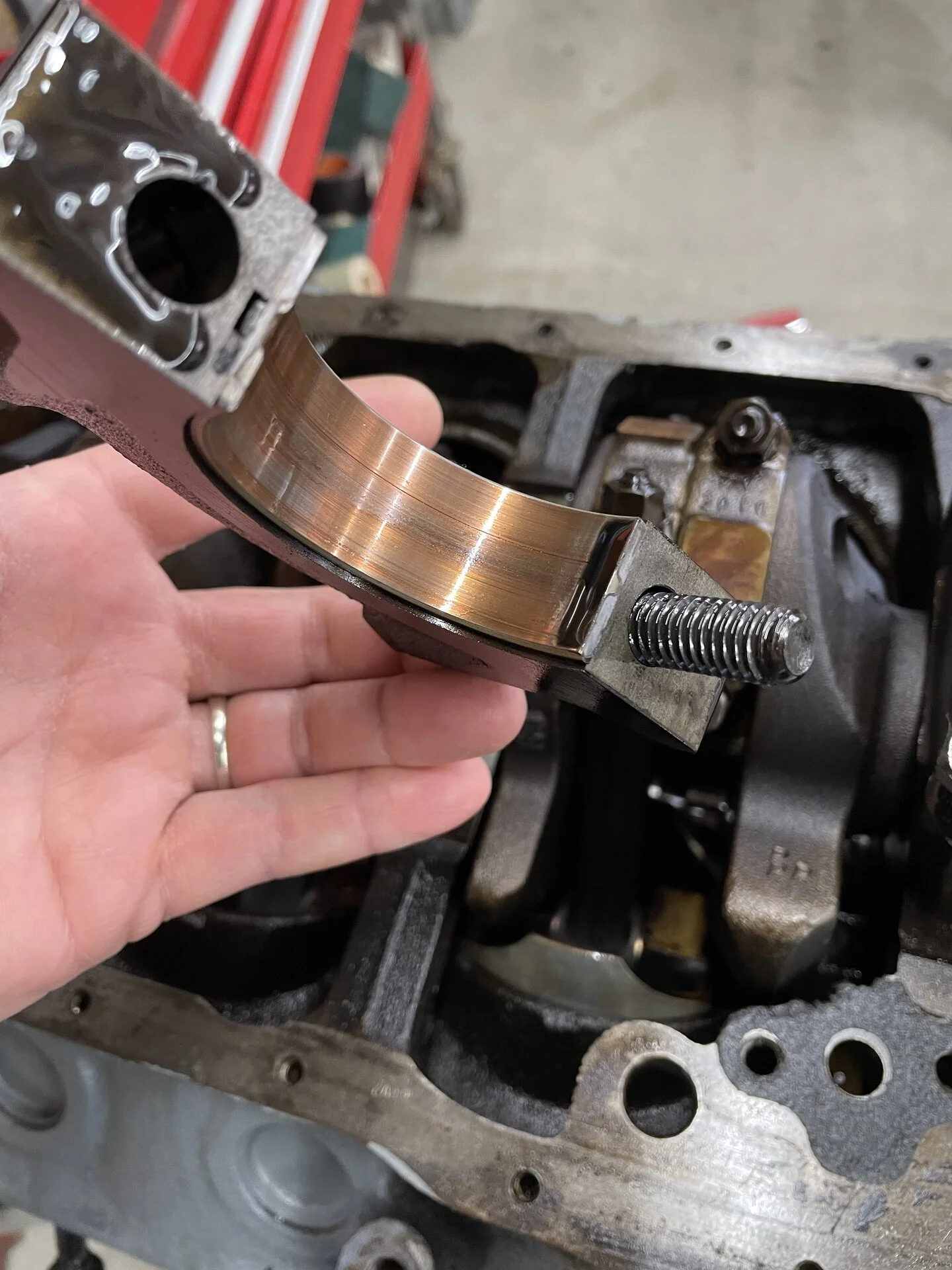

Got my old engine on the stand and am planning to do a quick cheap refresh. Bearings and rings and a hone. I’ll keep it for something down he road. Check out #2 main. The rest look like normal wear but this one was about to tell me it was done.
