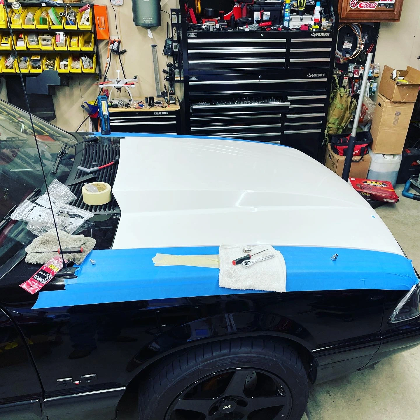

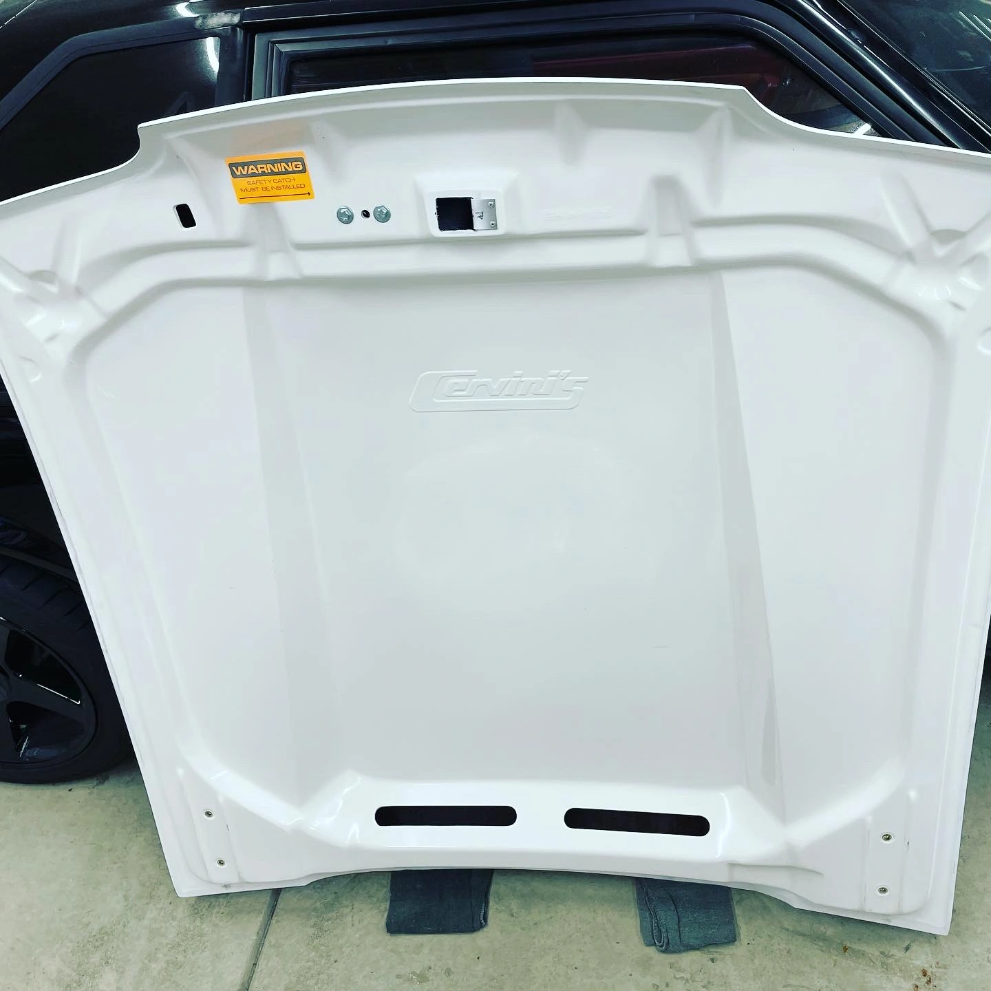

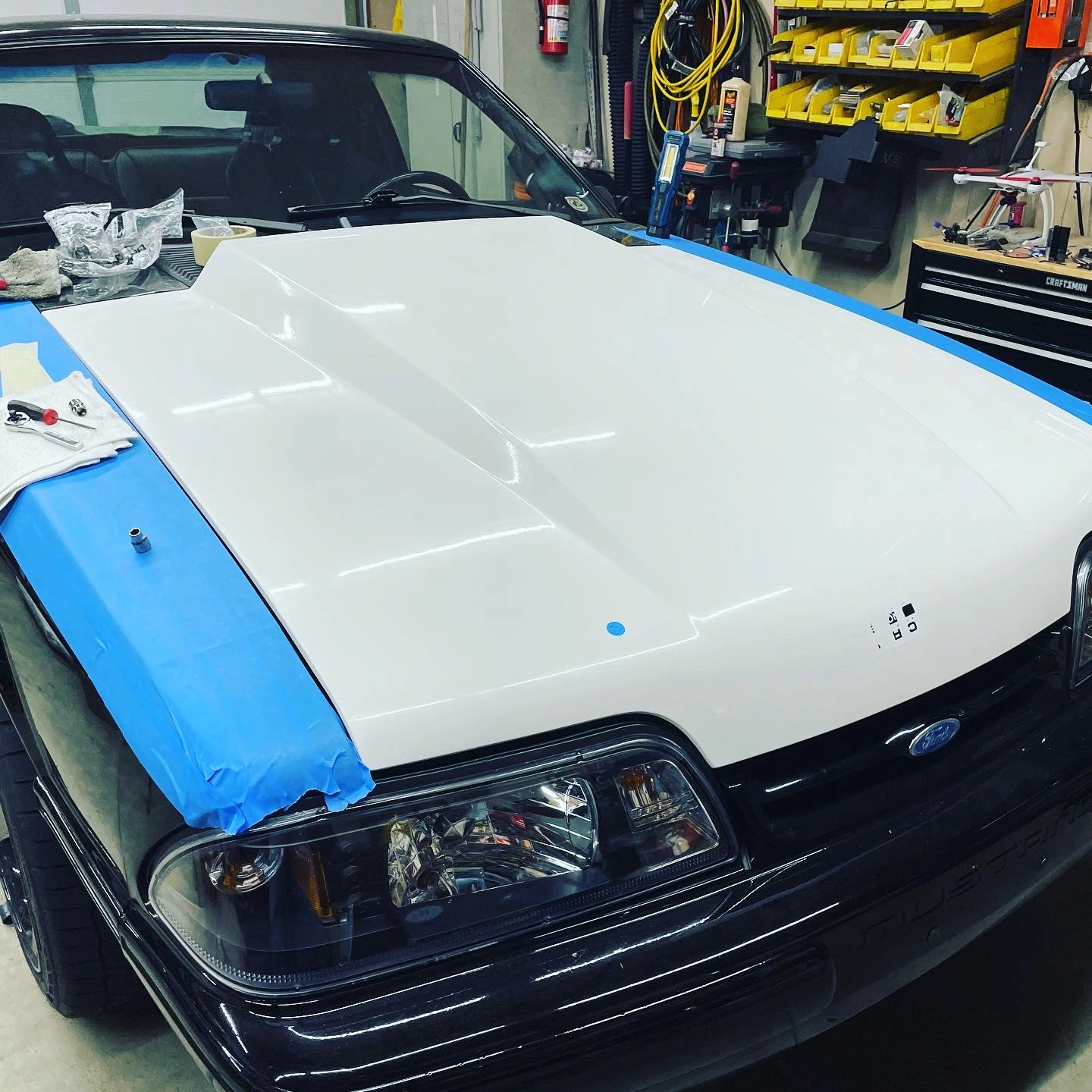

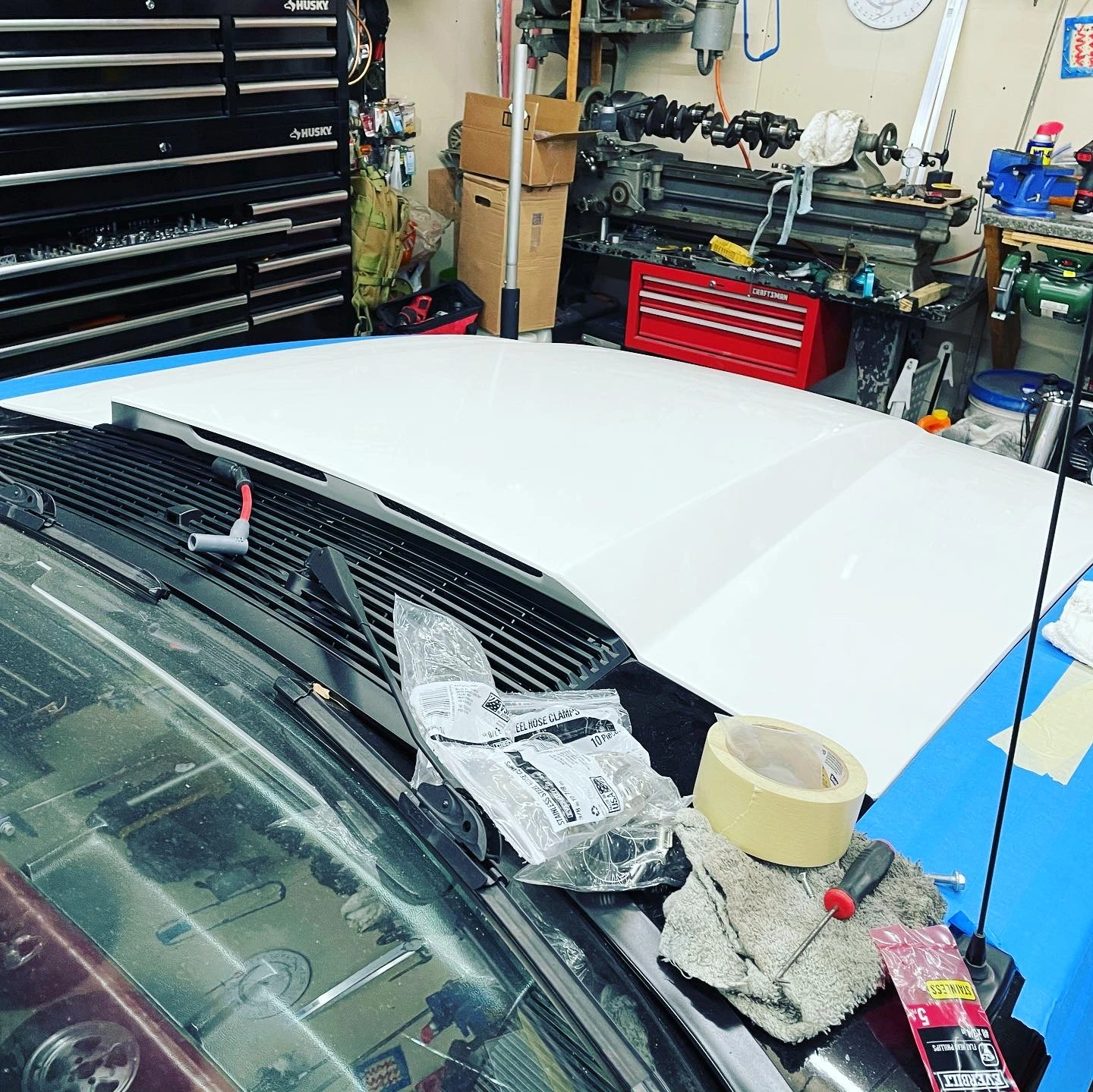

Hood came in yesterday. Had to set it on the car and see how it looked. I ordered aero catch hood pins so I guess I’ll install those once I get everything aligned
I also have the original headlights so I’m gonna polish the lenses and put those in.

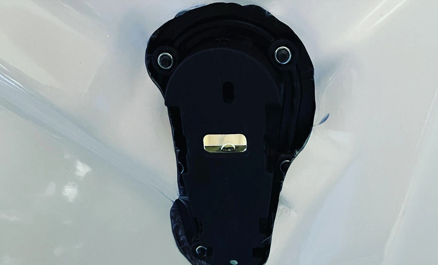

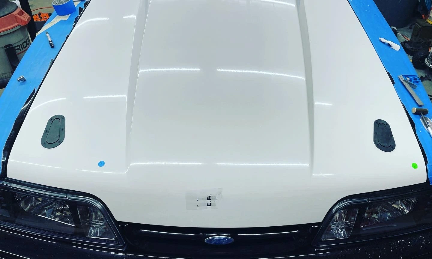

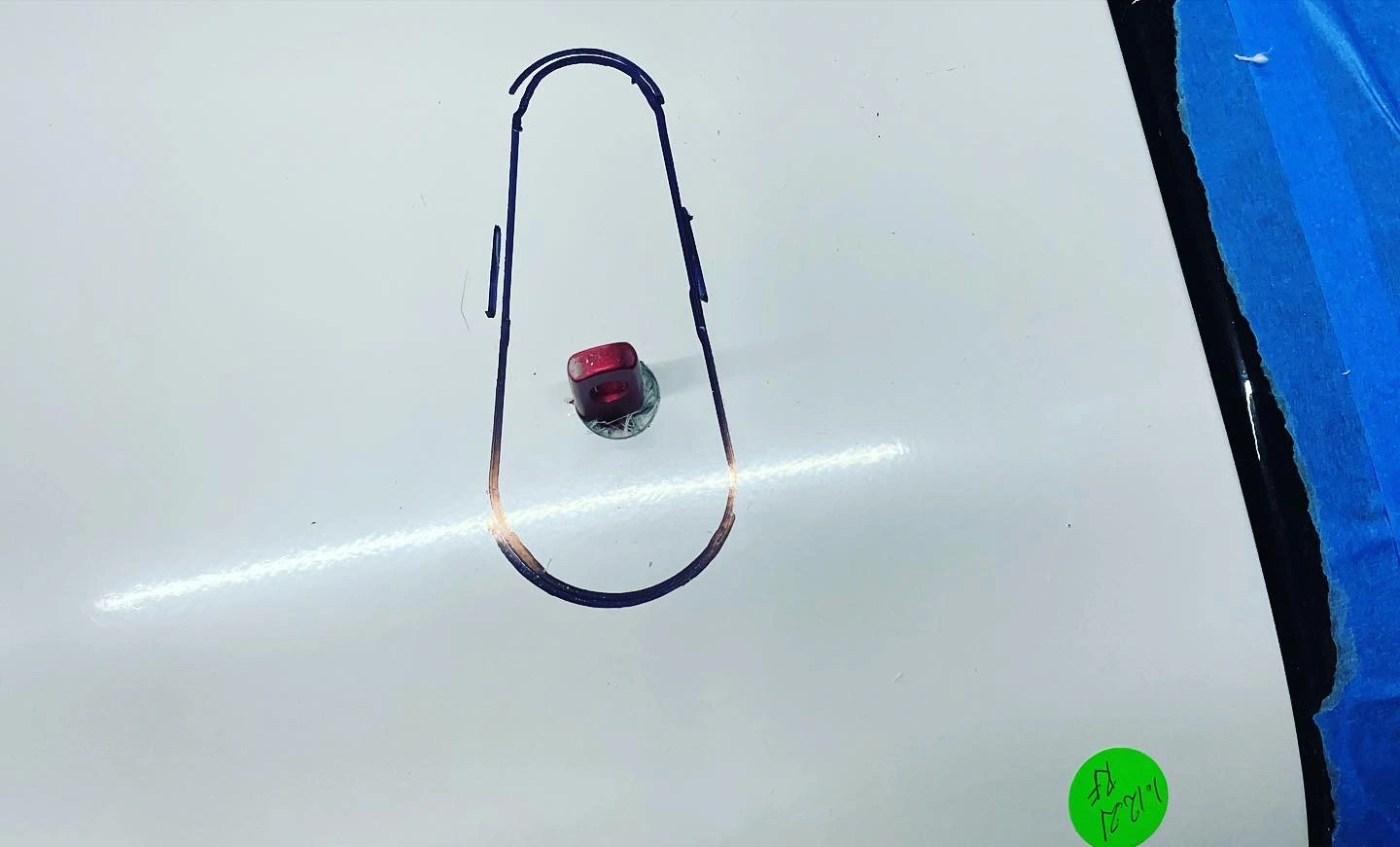

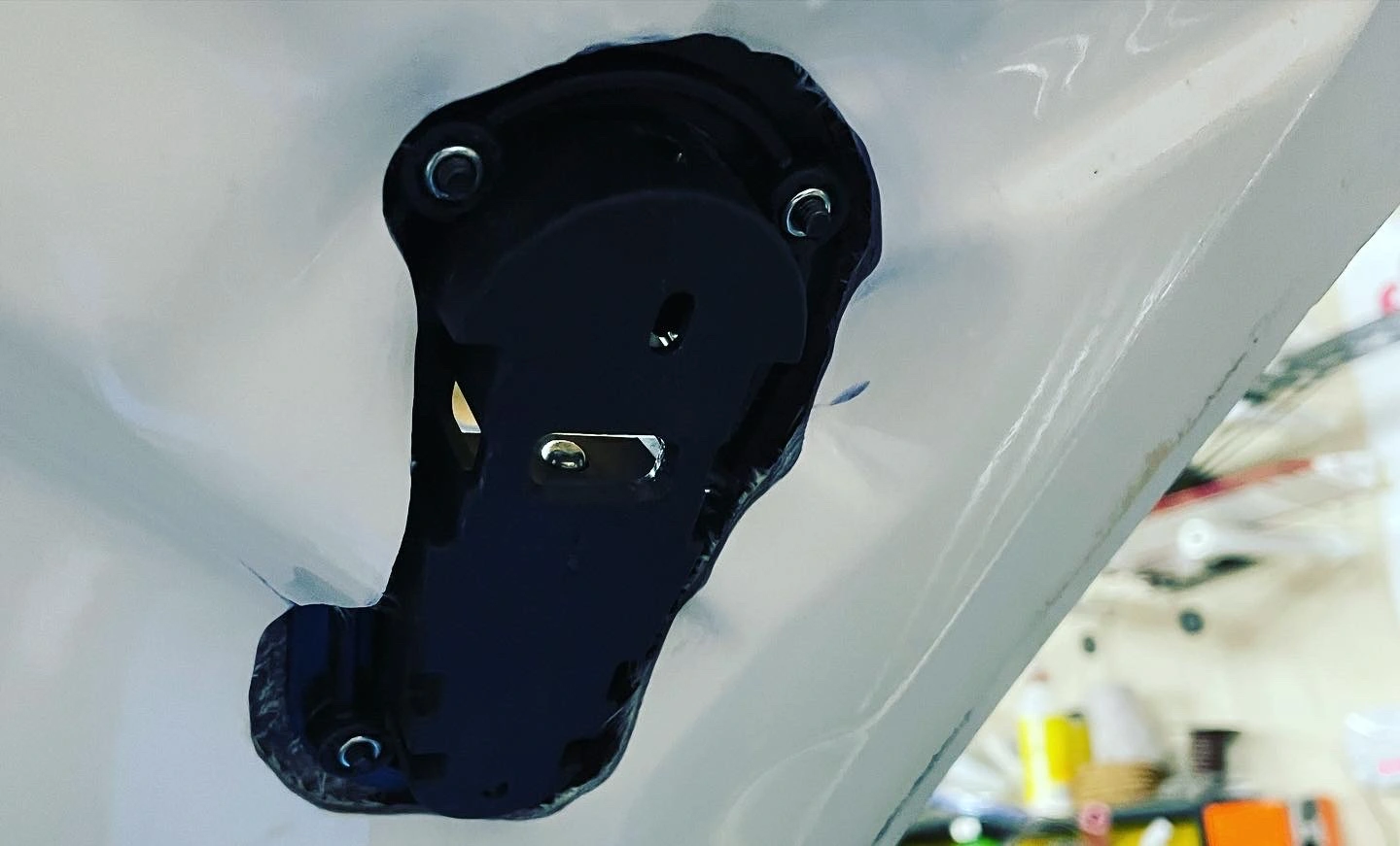

Got the aerocatch pins installed. Wasn’t nearly as bad as I thought it would be. On the backside I clearances only what was needed so if there was room to slide the retaining ring between the two panels I did.

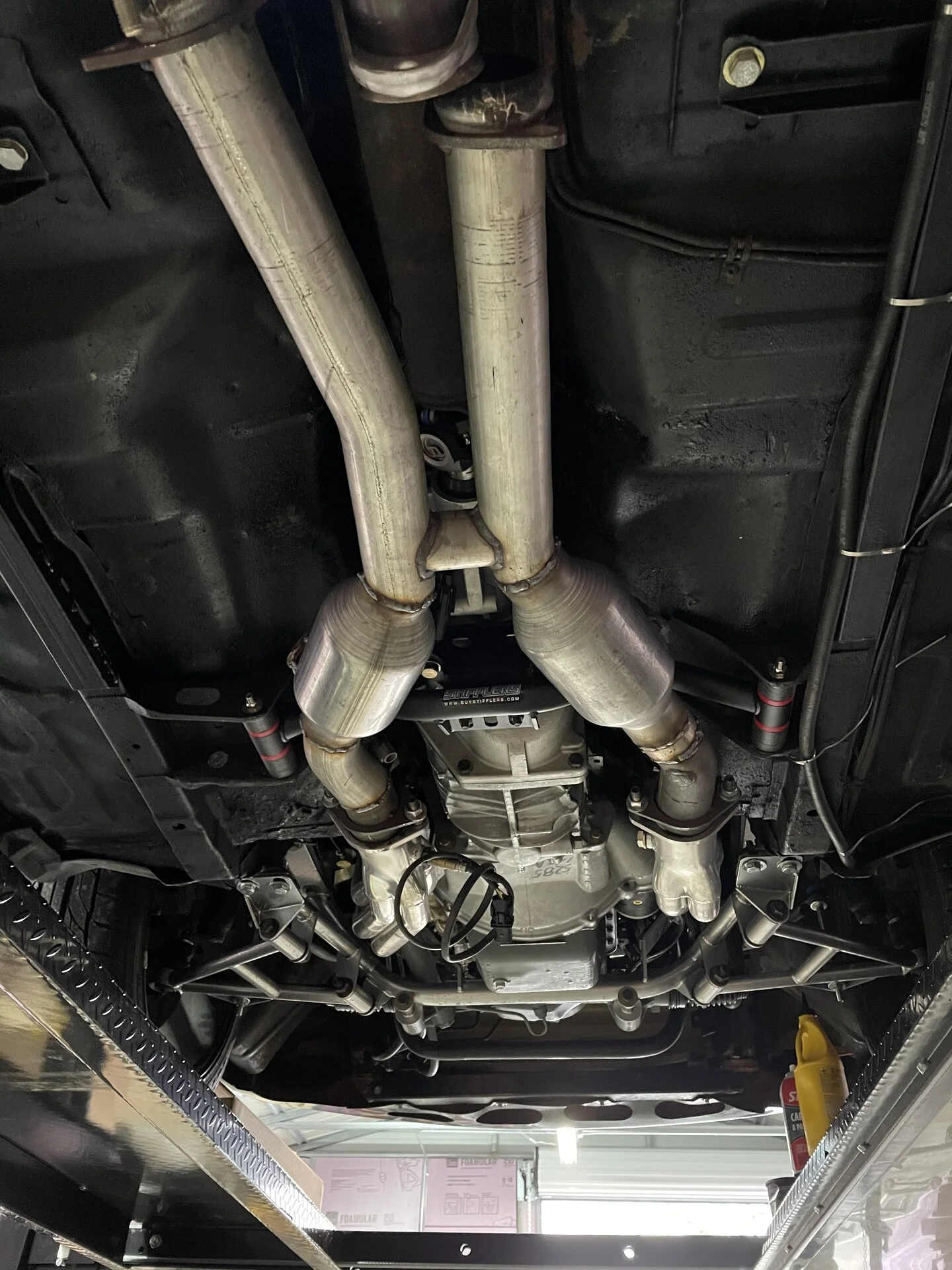

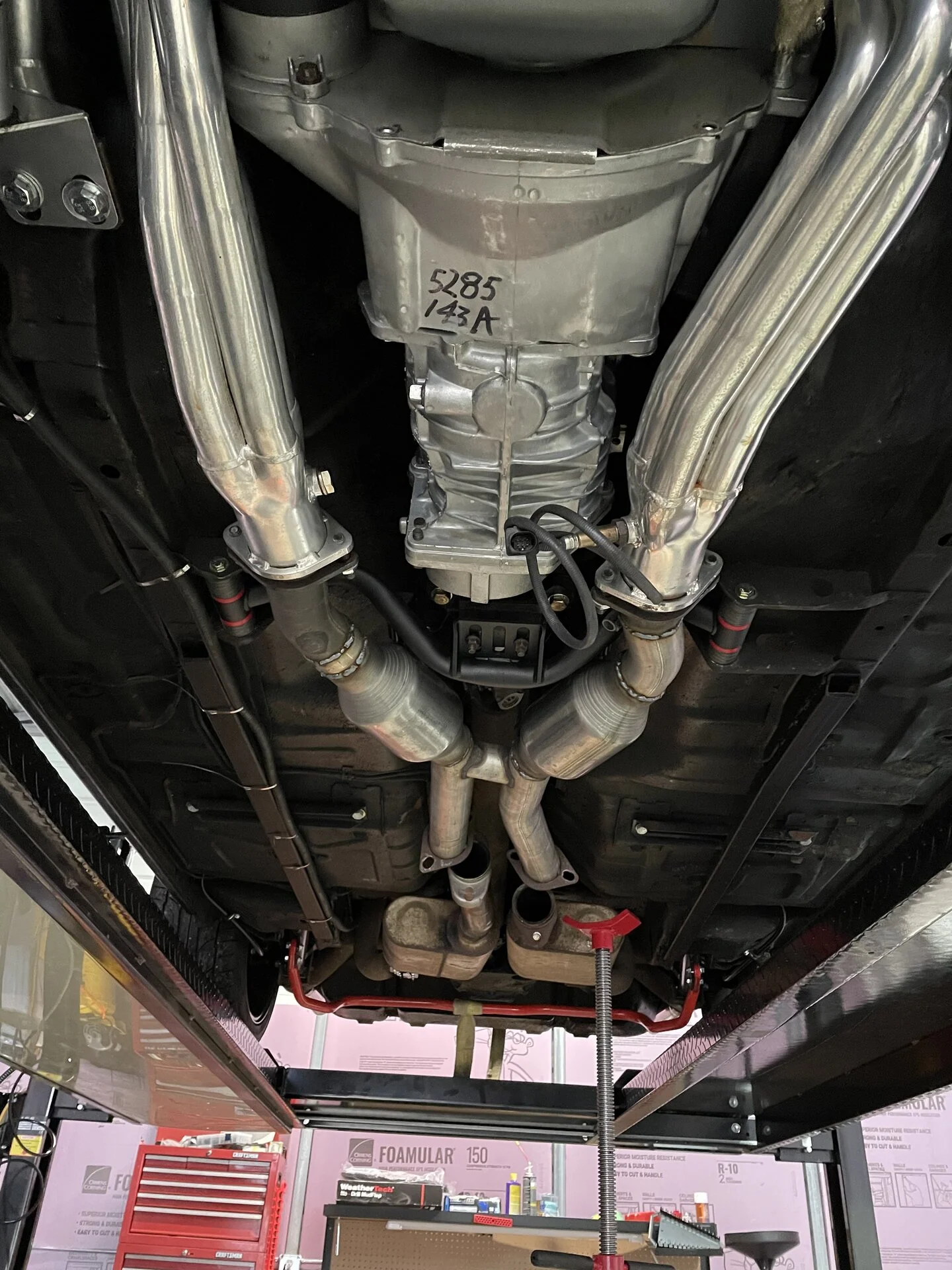

Question for tko users. So stifflers crossmember with their tko install kit give you spacers to raise the back of the trans like an inch. Well that pushes the trans into the tunnel. I’m considering turning those spacers down an 1/8-1/4” how did you guys handle this? @90sickfox did you have this issue
I ended up just turning .100 off the spacers and it’s now not touching the tunnel. It was touching the rib right behind the shifter cutout. I reworked the H pipe and added cats. Don’t mind the crappy looking welds my neighbors breaker kept tripping. I’m ordering new tail pipes to clean up the previous owners work... once I get those I can roll it back home and finish up the cooling system etc.
