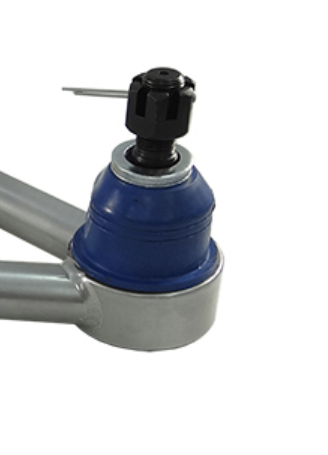

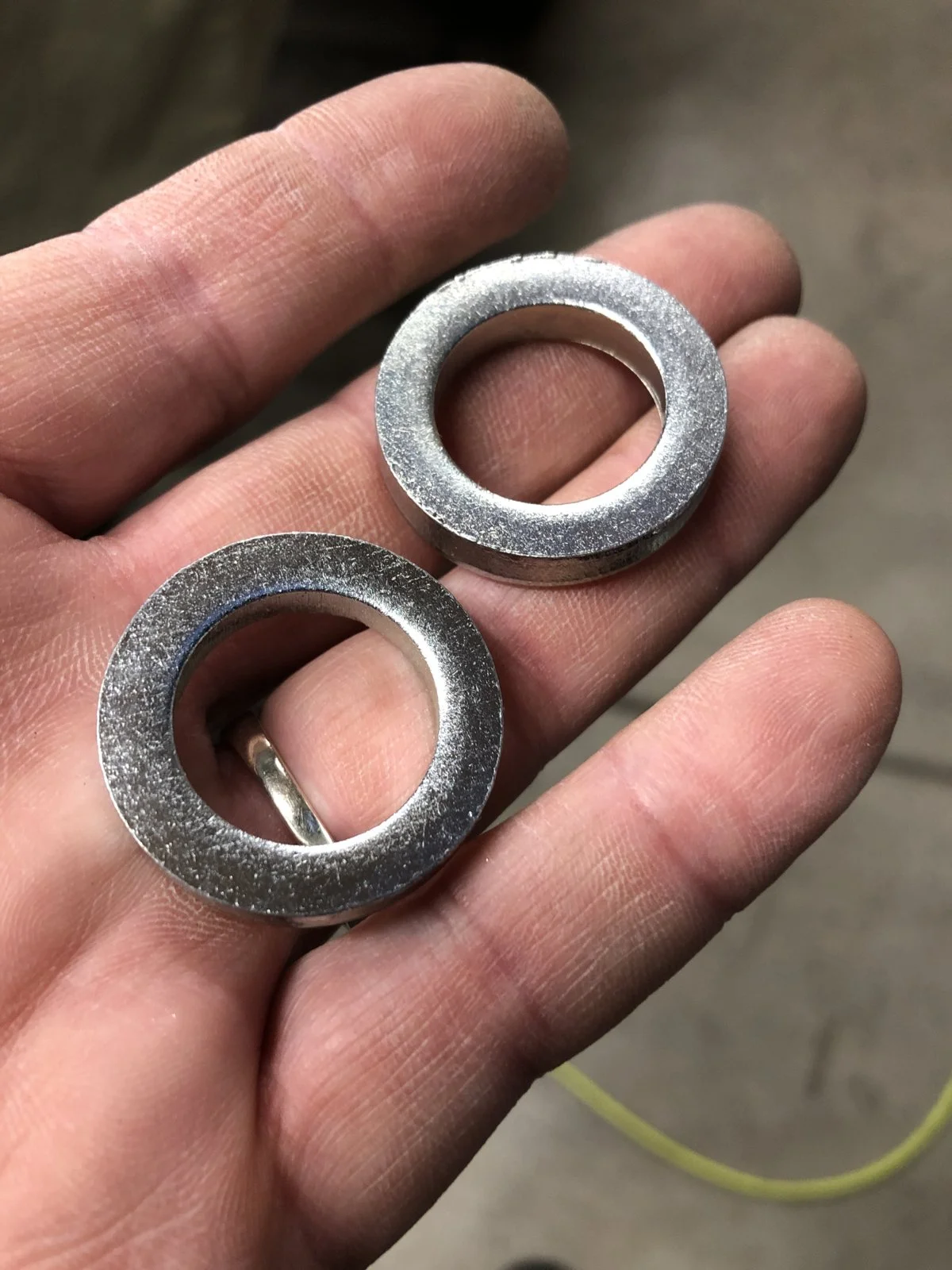

What are these washers for that came with my k member and A-arms. They were in the A-arm box with the zero fittings and cotter pins.
Found this picture on upr website. Looks like they go on the balljoints. There’s no mention of it anywhere that I could find just spotted on this zoomed in pic.
Reactions: General karthief
Those washers are if you have sn95 spindles to correct the issue of the taper on the ball jOint . If you still have fox spindles don’t use them

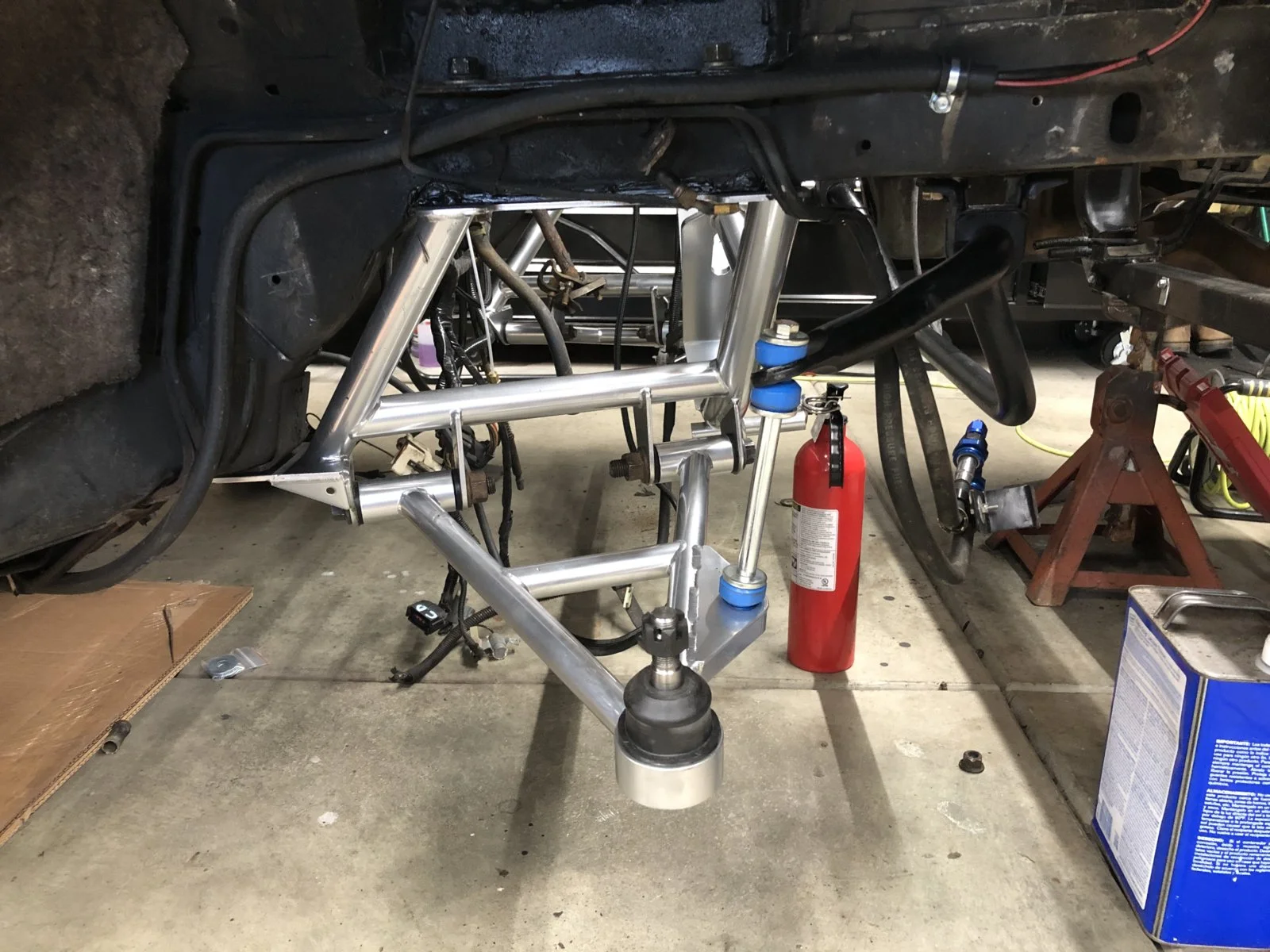

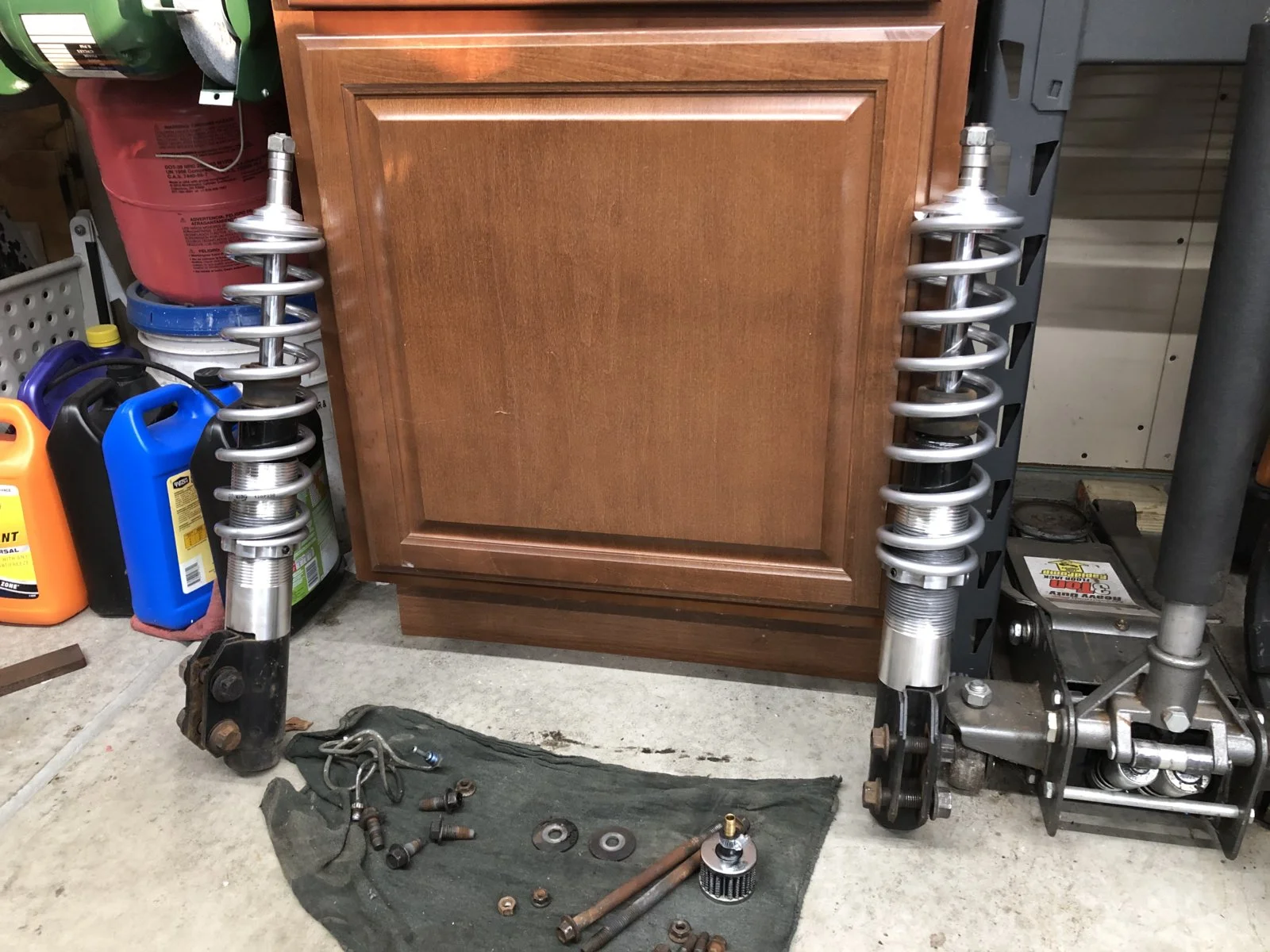

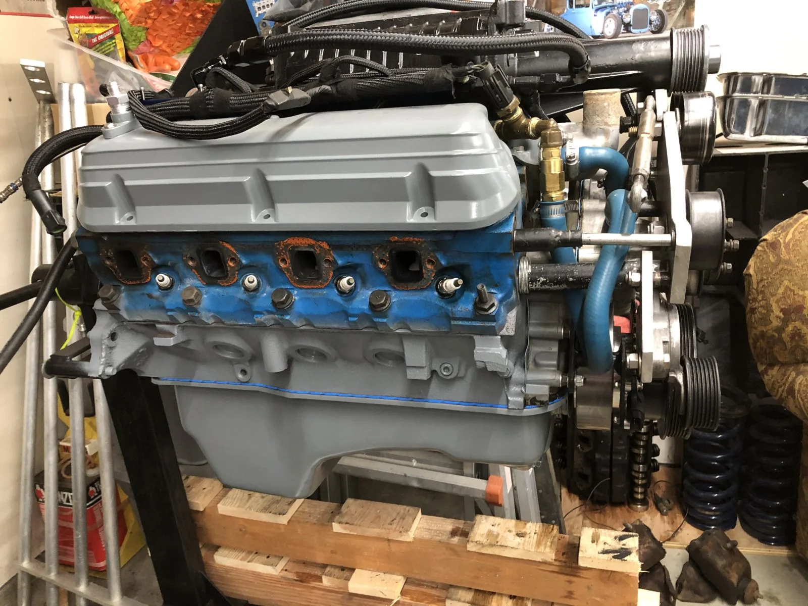

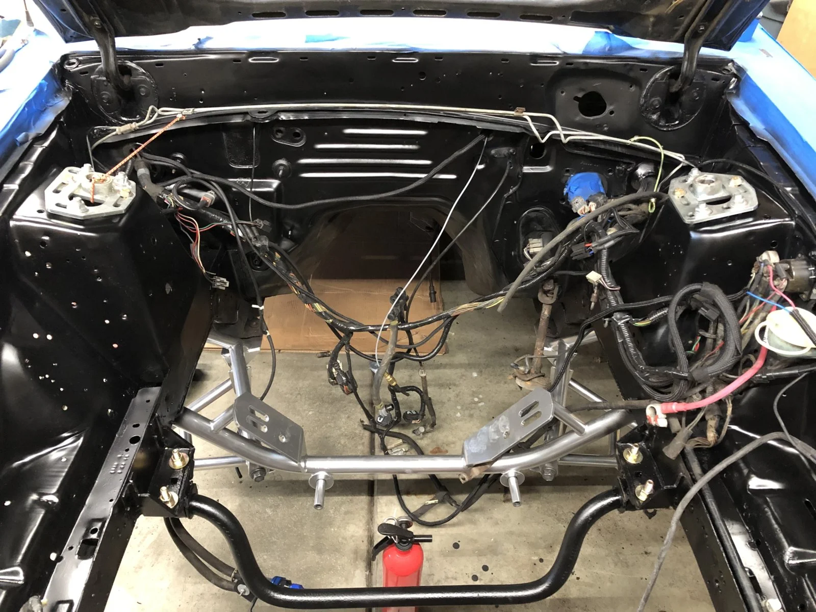

Slow progress but I’m taking my time. It’s a long winter. Here’s some pictures. Coil overs, k-member, engine bay and the engine. Cleaned it up, replaced oil pump and resealed pan and got a coat of paint on the block and pan. Still need to finish sorting out wiring but I’m about half way through then I’ll reloom and secure to firewall just above tunnel.

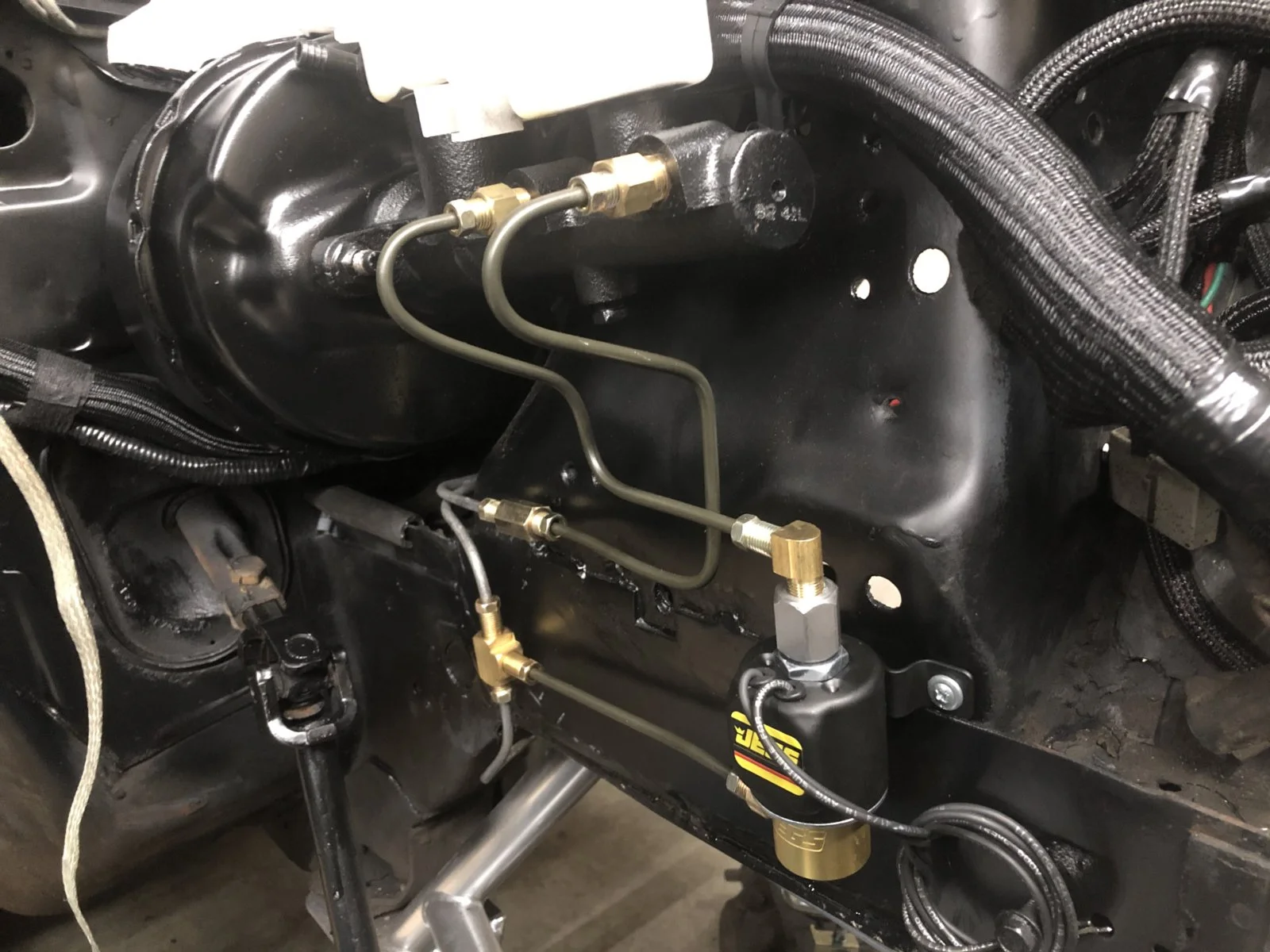

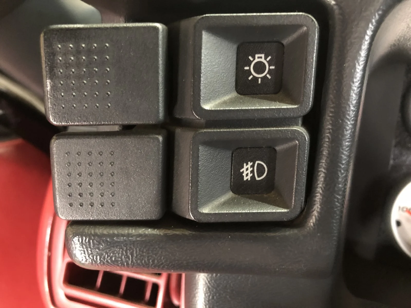

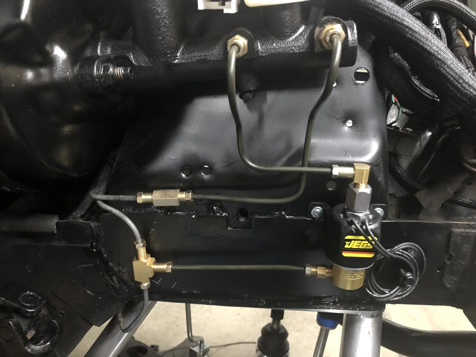

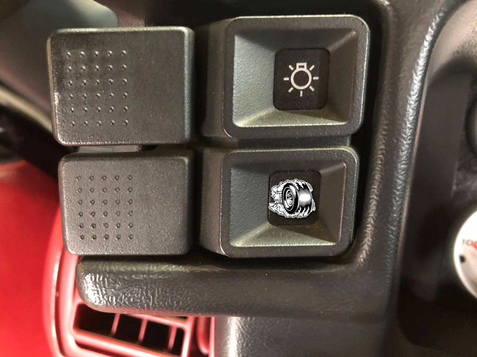

Got the new booster and master cylinder installed as well as line loc and proportioning valve. Gonna try to get this thing on wheels so I can turn it around and get going on torque boxes. Gonna use the fog lamp switch for the line loc and a buddy is making a decal like I have in the picture.
