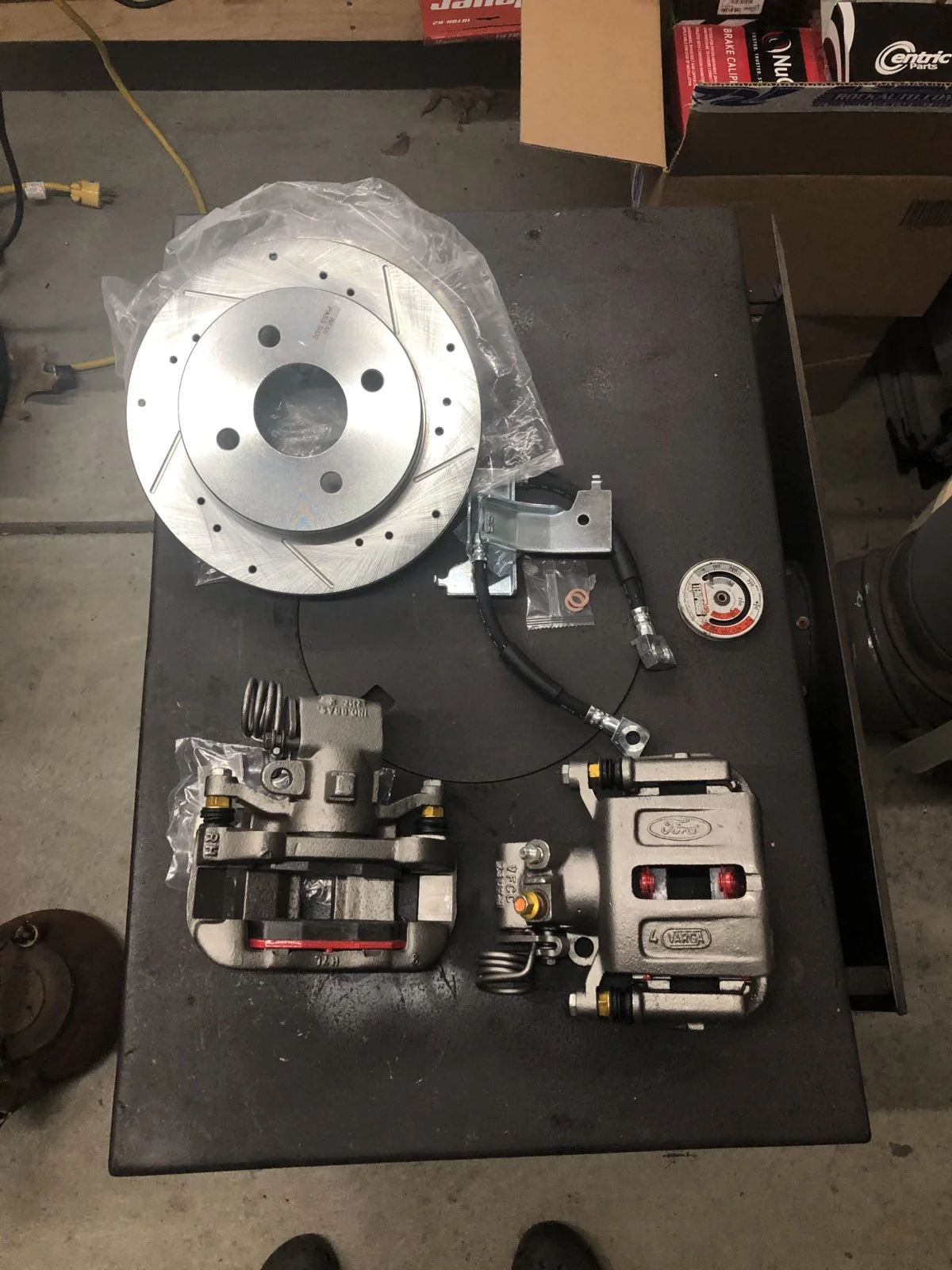

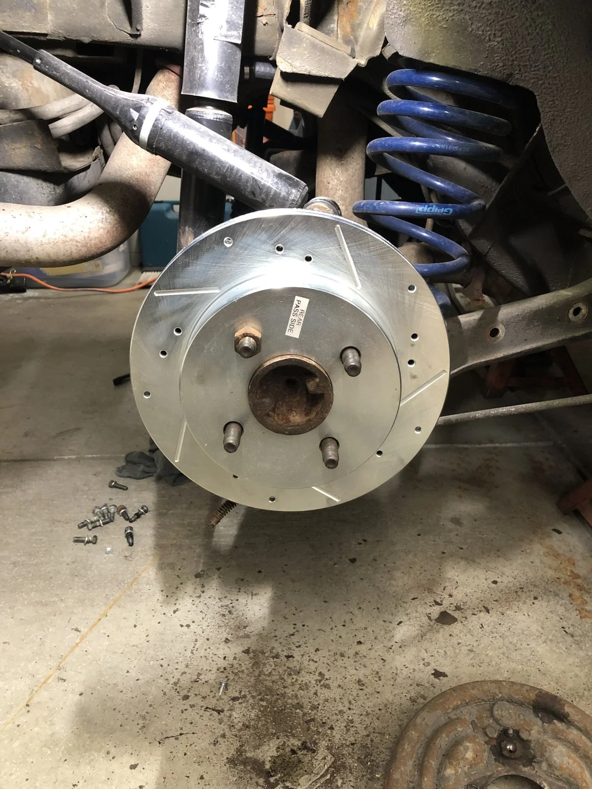

Time to move my attention to the rear of the car. Upper and lower torque box reinforcements and brakes, turbocoupe brakes to be exact. I’m gonna fab up the caliper mounts and see if I can save $200. I’ll mock everything up in MDF board and go from there.
Got most parts from rock auto and the rotors from eBay

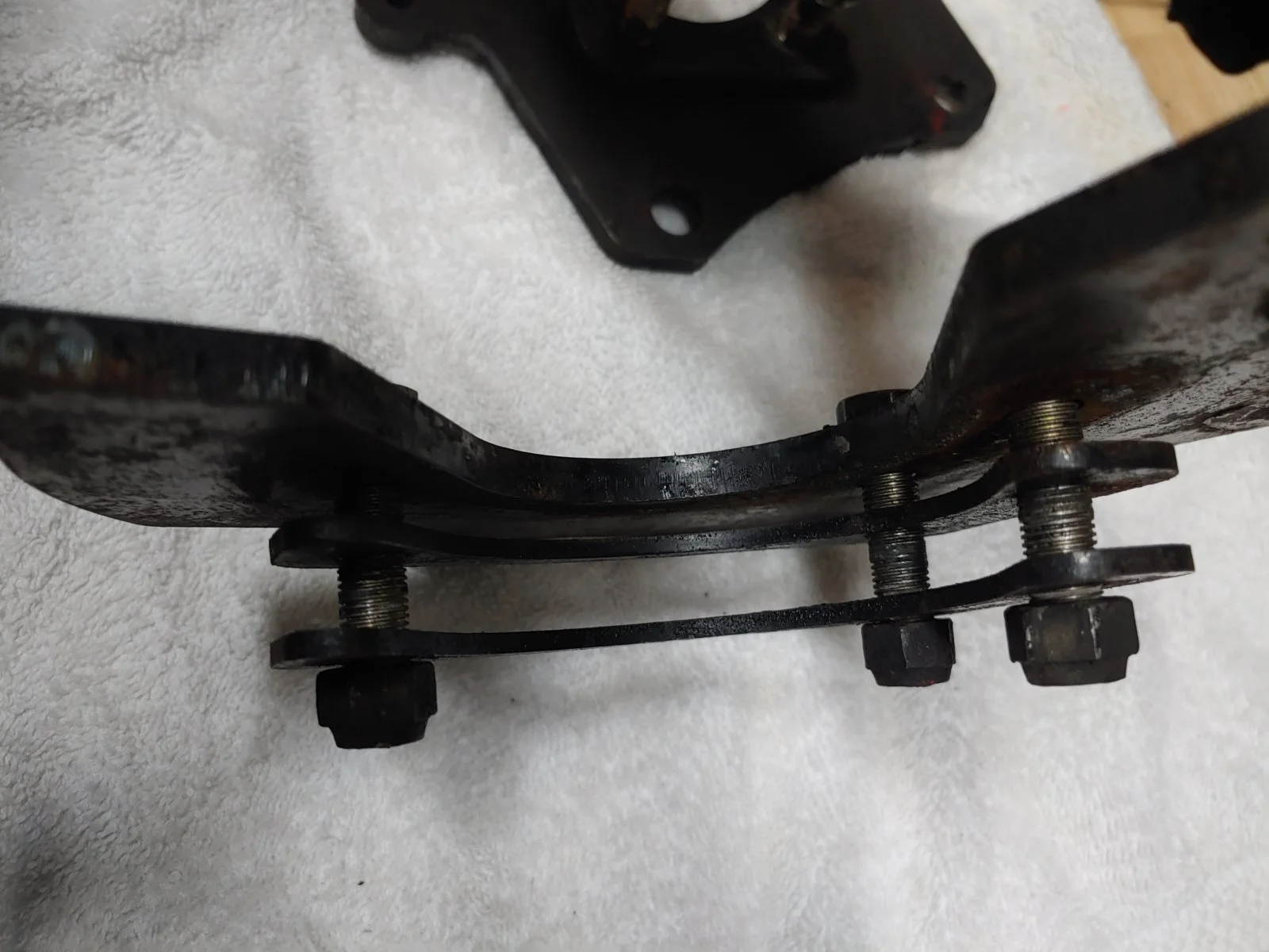

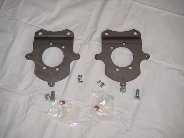

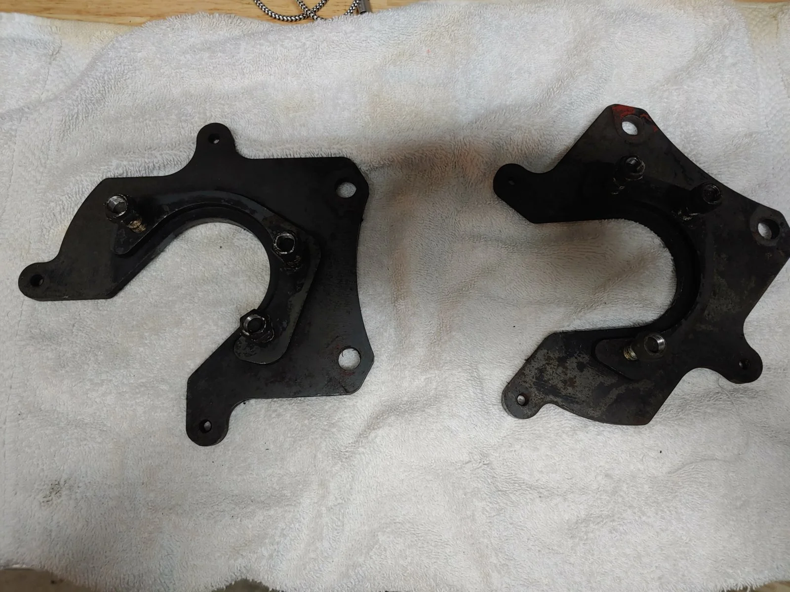

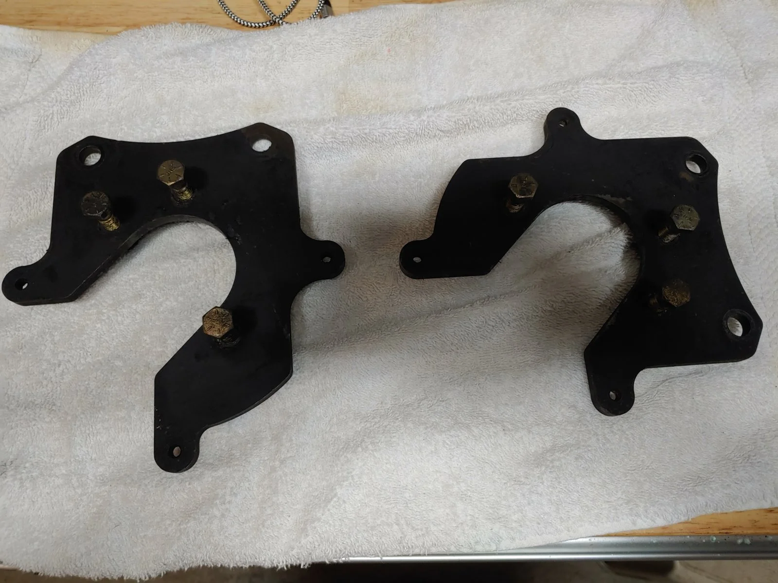

I did the same , been collecting parts for a while now and just about have them all.
I just got a set of brackets from a member on Corral for $45, they are modified turbo coupe brackets
with a spacer.
Thanks for the offer on the template , I could send you pics of the brackets I have for reference if you want.
Reactions: KZGUNS
with a spacer.
post them up here, I'm following.
Reactions: KZGUNS
with a spacer.
That’s a good deal. I’ve looked off and on for some and then I looked at the north racecar mounts and was thinking I could easily make those.
When I saw these I couldn’t help but see how simple they are. The offset will be tough but I think I can just double up the material in that area and use longer caliper bolts. I can also mill off some material to center the caliper if needed

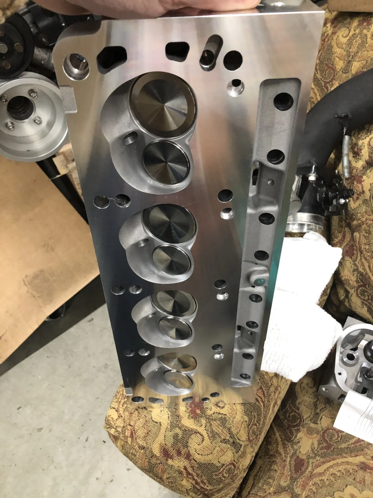

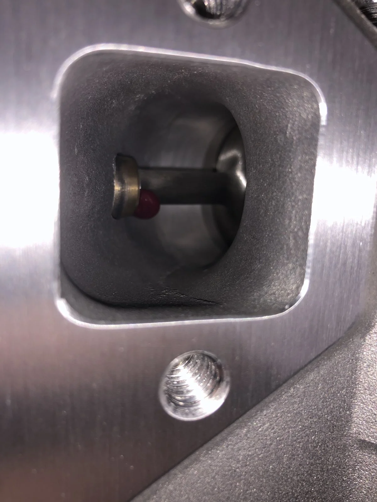

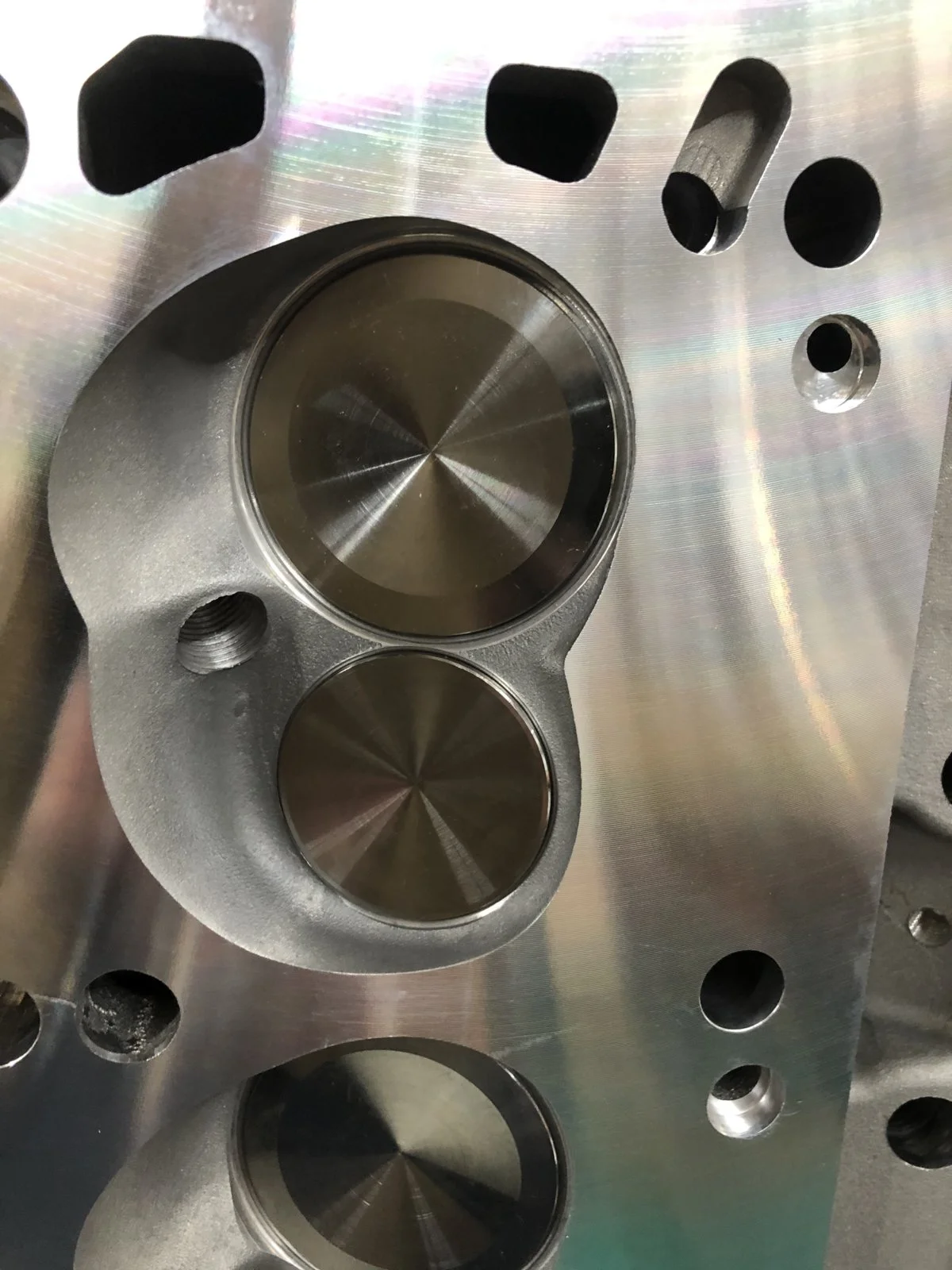

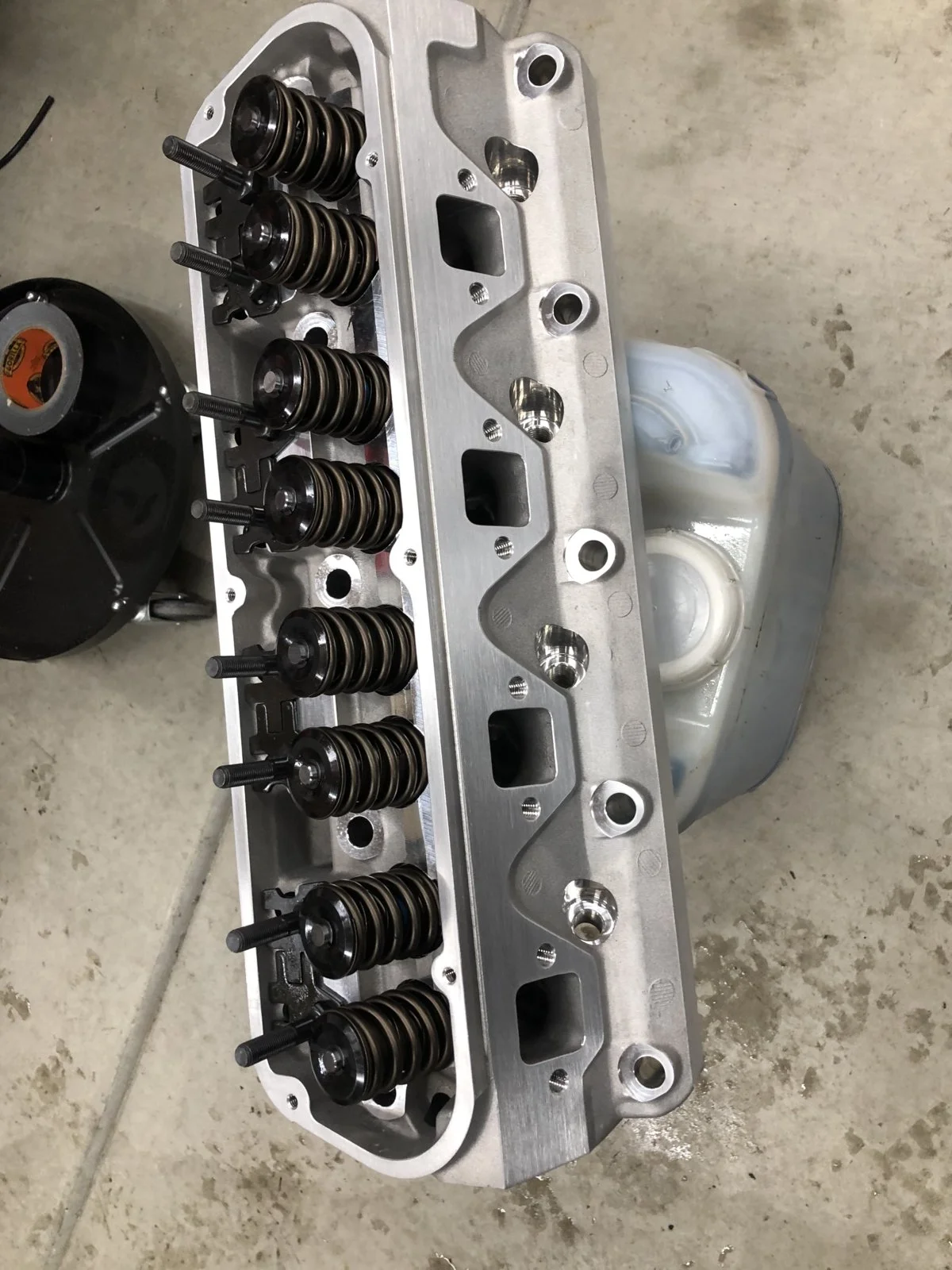

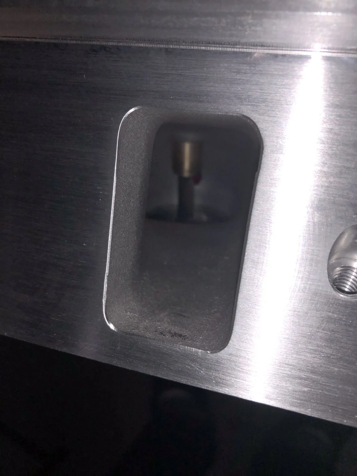

Heads will be here Wednesday! Wasn’t expecting them till mid February. Guess I better get moving, although we got 18” of snow over the weekend so it’s not like I can do any driving lol
Heads showed up today. They look way better than I thought. Very nice quality as far as I can tell.
  • Hell Yeah!
Reactions: Olivethefet

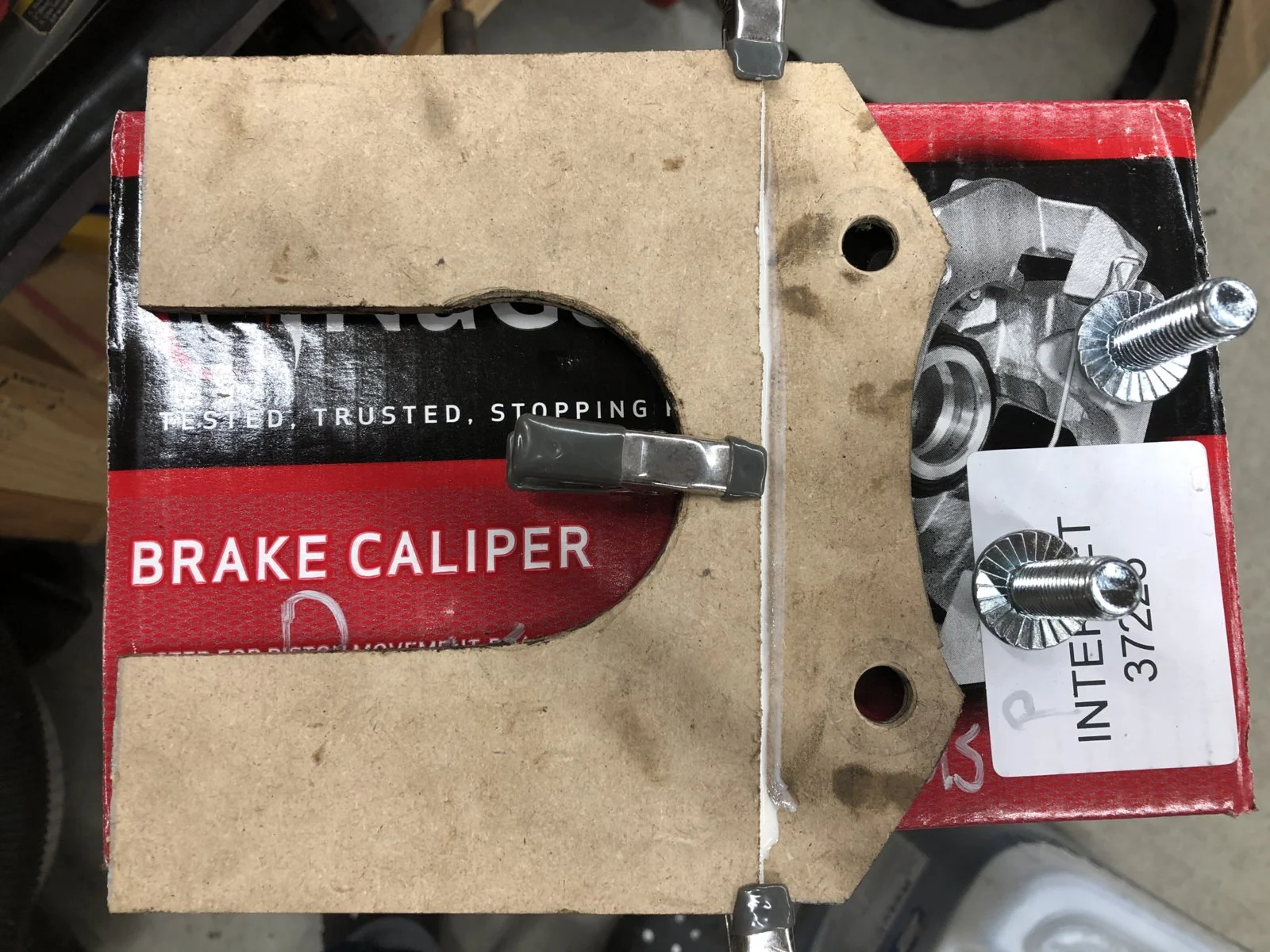

Also got started on the brakes. Very rough mock up using Masonite. I will trim and fine tune it as I know where it’s gonna sit on the flange and then transfer to 1/4” plate

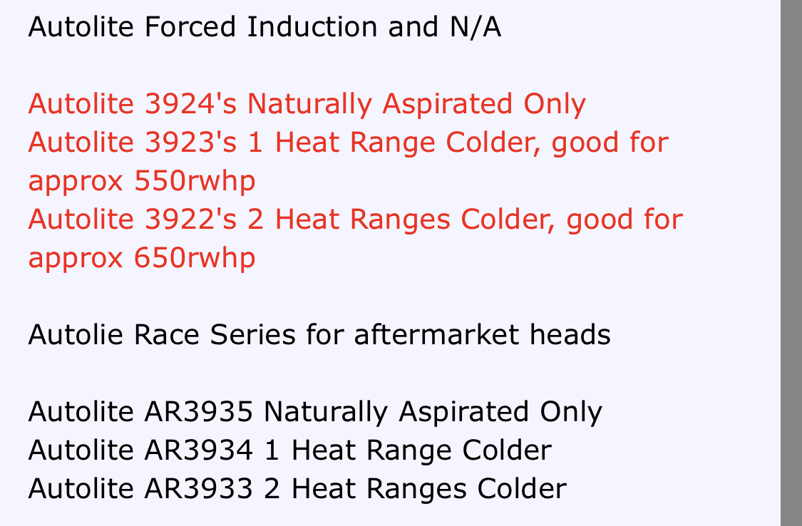

Let me walk out to the shed and take a look.... man its cold out tonight... like 45* :D

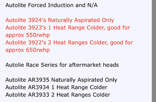

Autolite 3924 is what i am running.. keep in mind its NA.. I think thats the equivalent to a 104.
Thanks! 45°! That’s t-shirt weather up here. Lol
So I found this on the all reliable internet...
Would you go 1 or 2 steps colder?
