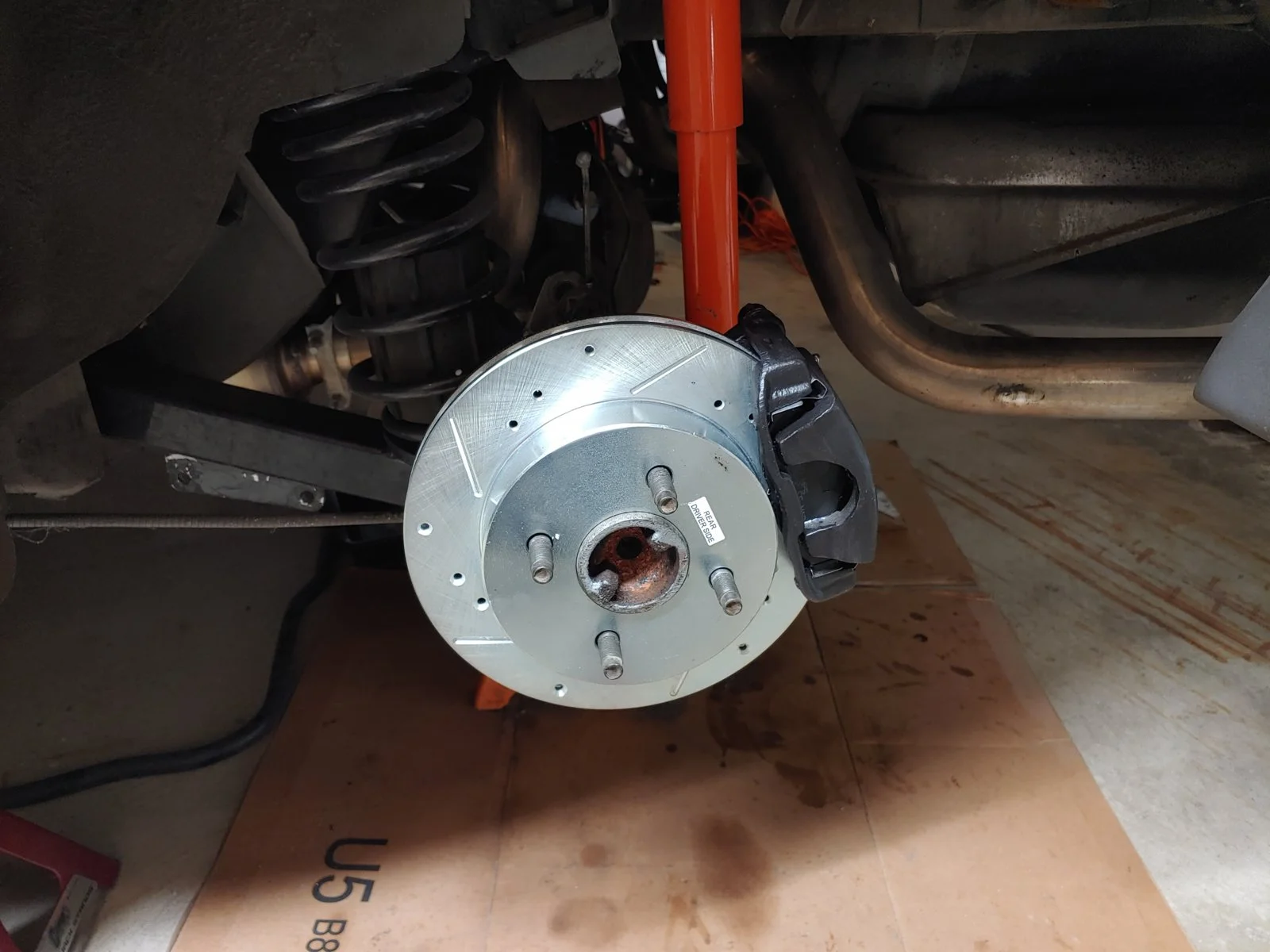

Brakes! Still have to do the brake lines and parking brake so sorta brakes lol

Looks great, I may start tackling my conversion this weekend.
Any tips or pretty straight forward ? I plan on following the LMR video instructions.
Ya pretty straight forward. Just make sure the caliper support is centered as best you can, shim if needed. Then brake lines. You’ll need different fittings to connect to the flex line. Just go to autozone etc with you line and find one that threads in.

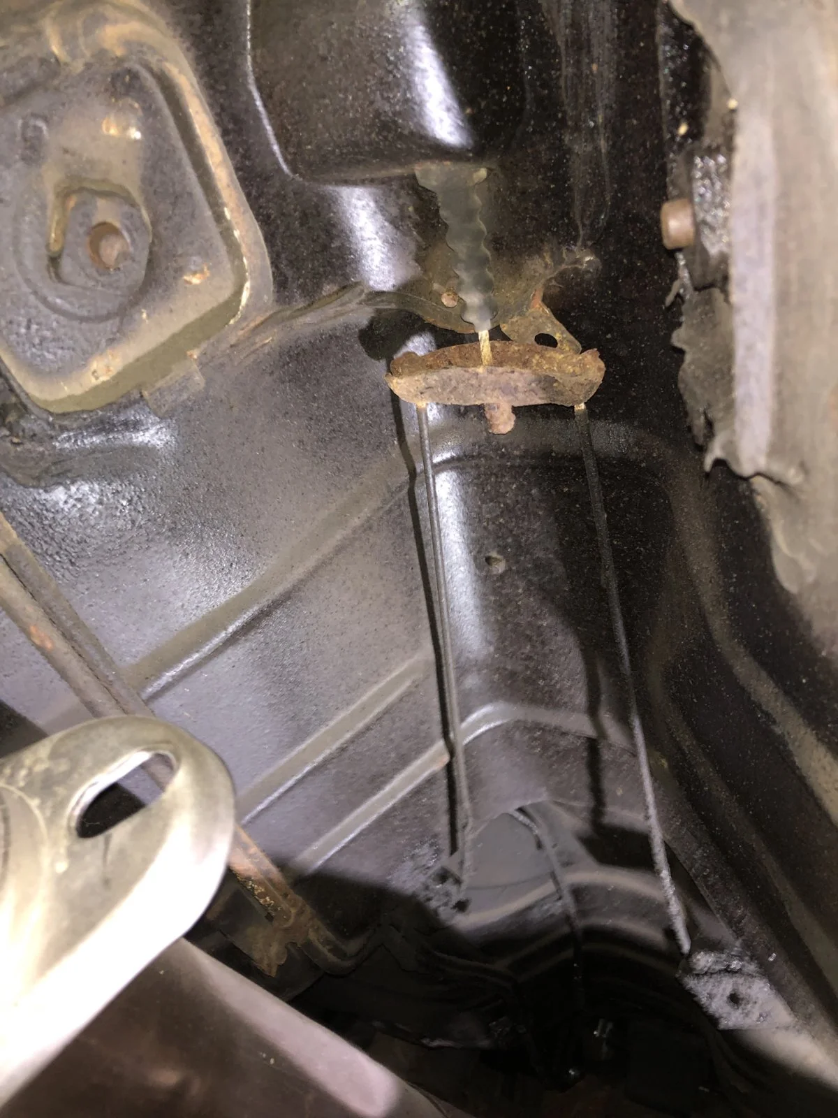

Did you install e-brake cables yet ?
I've been working on my rear discs this weekend and realized that the 93 specific cables don't fit my 93.
Looks like 93 should have a cable bracket in the trans tunnel just after the equalizer to lock the cables in.
My car looks to have been built like the 87-92 with no cable bracket, the cables lock in pointing toward
the center of the car then around two little pulley type things , then head toward the front to the equalizer.
Is this how your cables are routed ?

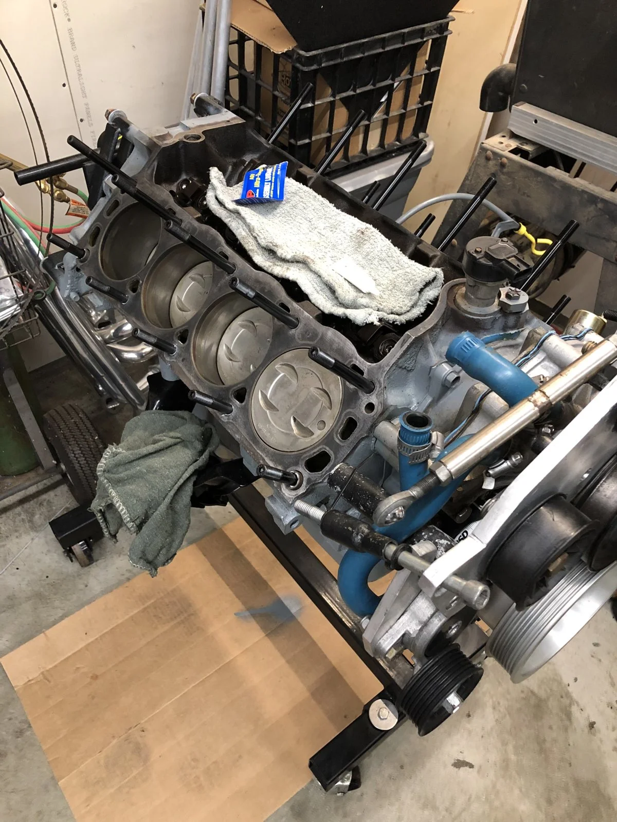

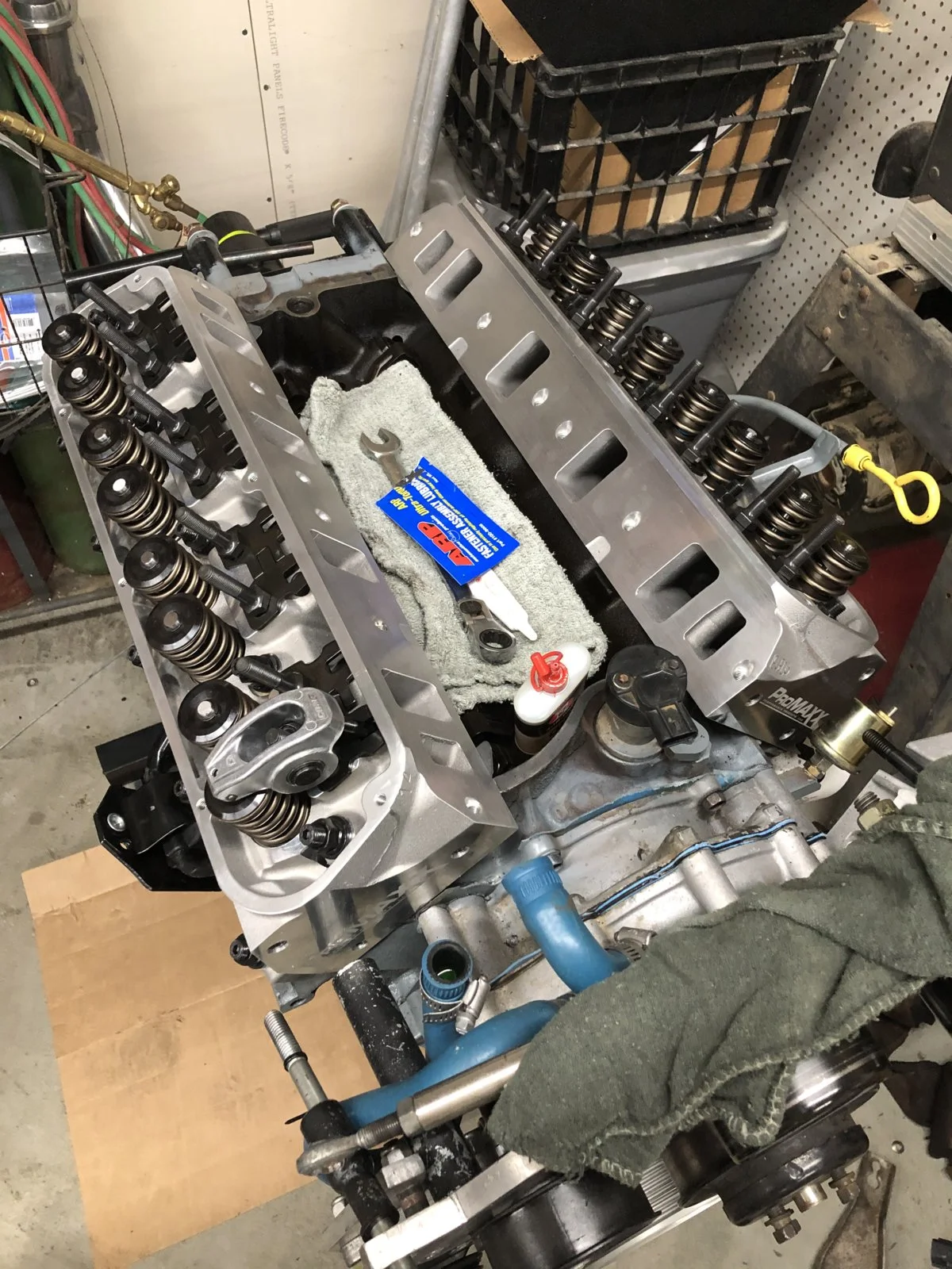

Wish I had head gaskets. Didn’t think I'd be at this point today. Hmmm maybe I’ll run out to summit in the morning.
Reactions: a91what

I have not tackled that yet. Still need the cables. I’ll look under there and see what it’s like.
Reactions: Steel1
Yeah looks like the same set-up, i need to order the cables for 87-92.

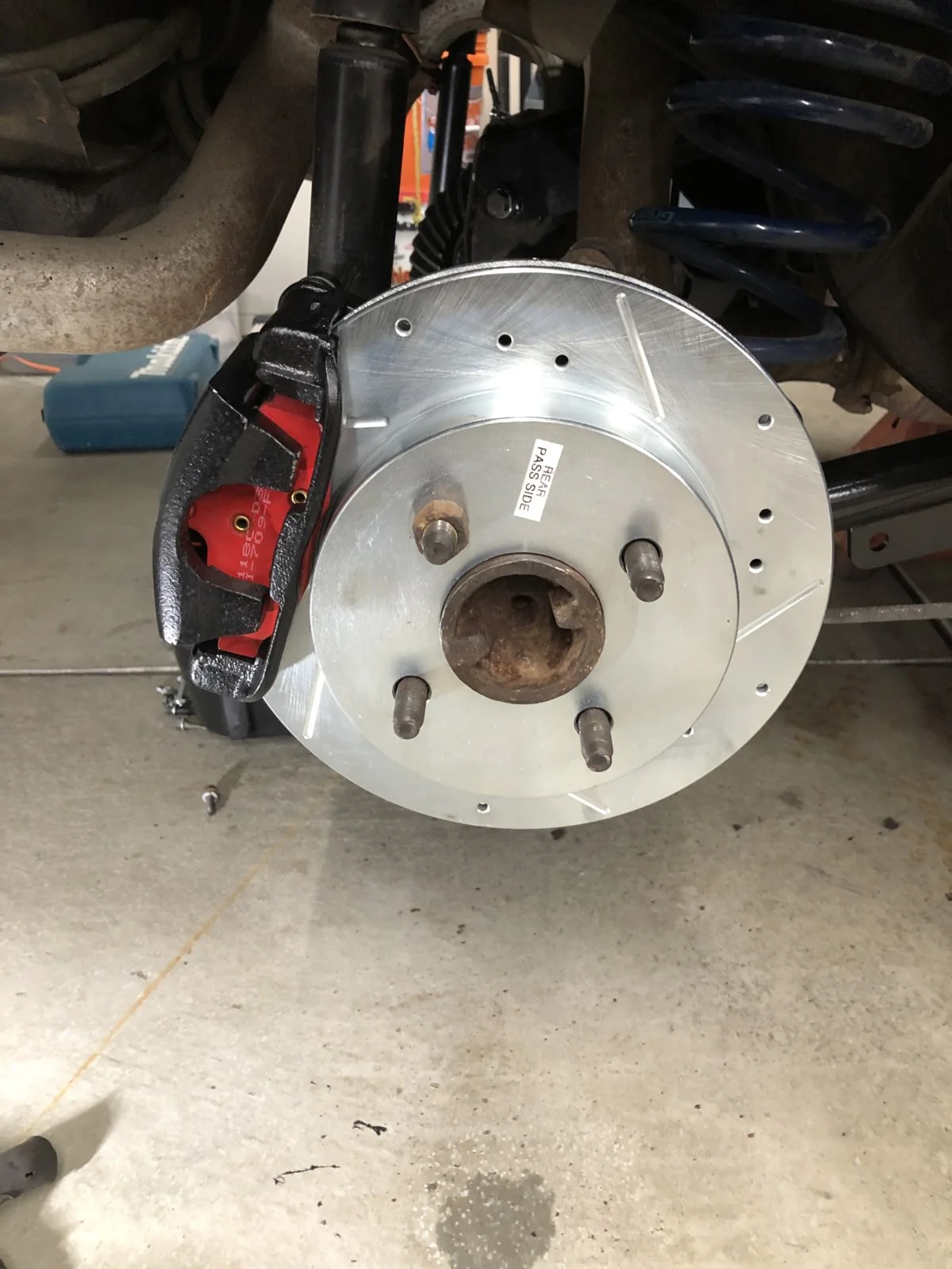

The upgrade went pretty smooth, I don't know about you but I found the caliper rattle clips to be a pia.
They just kind of sit there and then you have to try to hold them while installing the pads, kind of fiddly.
I actually had to grind a bit off the the top and bottom tabs on the pads to get it all to fit, installed Hawk HPS pads.

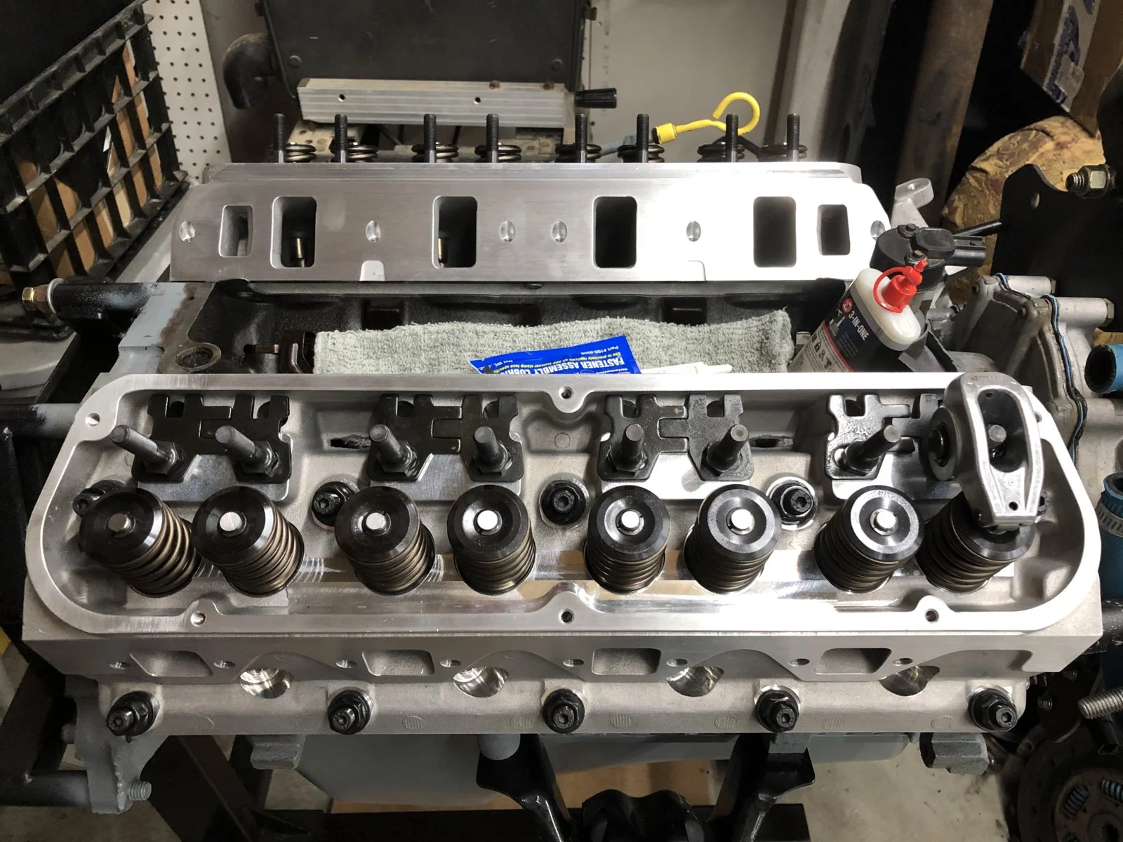

So I wanted to see how everything lined up with the pushrods I have and on initial check the roller has good contact patch but I think at full lift the pushrod hits the part of the guide closet to the stud. Maybe I don’t have it back far enough, I’ll check next time I go out to mess with it. Anyone else have to file a little off the guide in that area? Maybe I’ll see if a slightly shorter pushrod will work better, I’ll use my checker to see.
