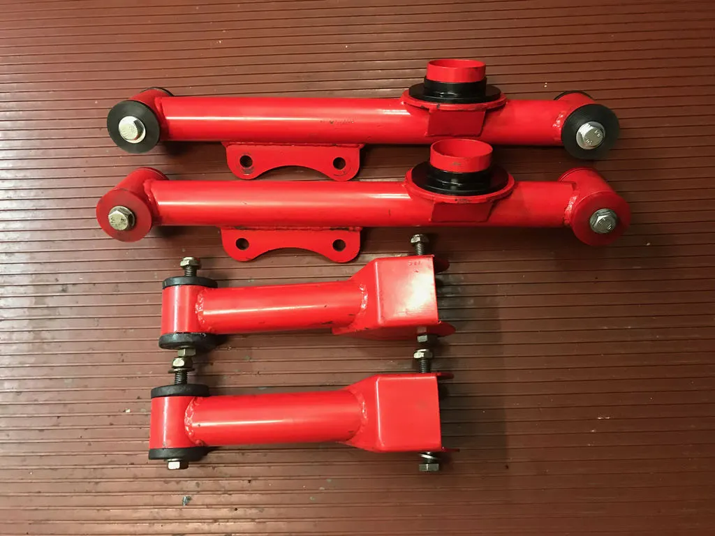

I make polyurethane bushings for the crapola Summit upper / lower control arm set.

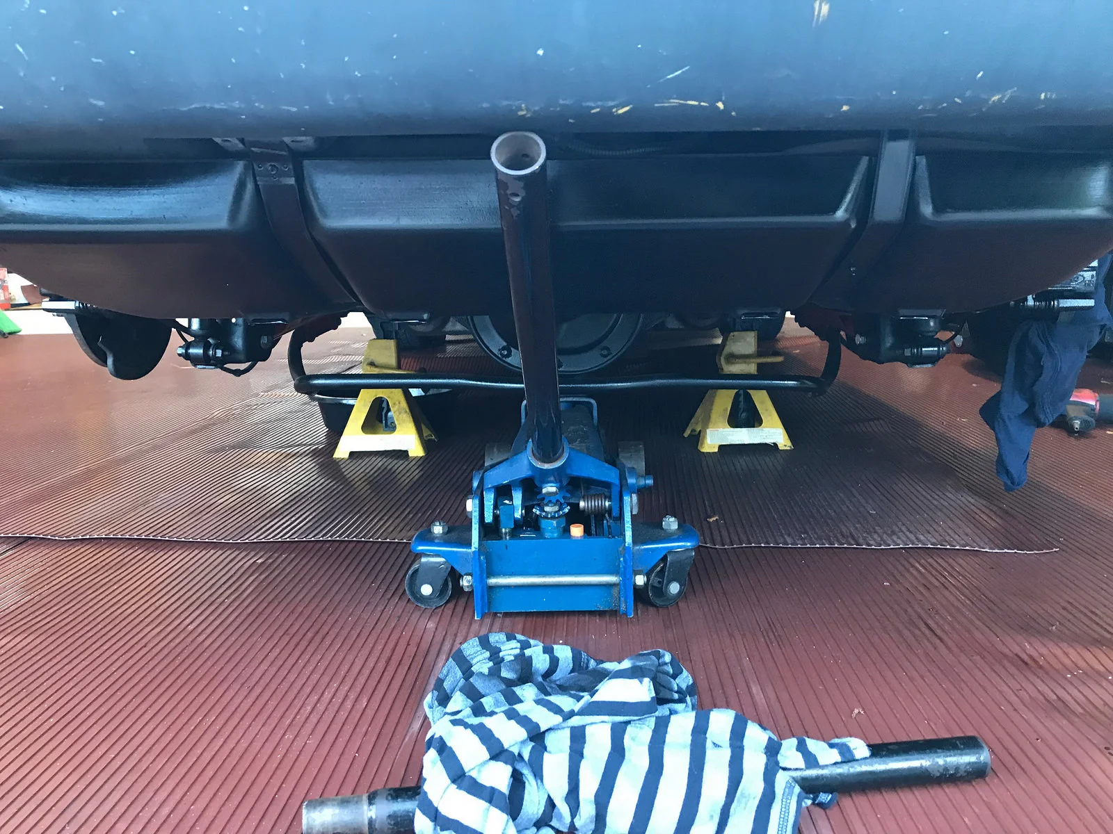

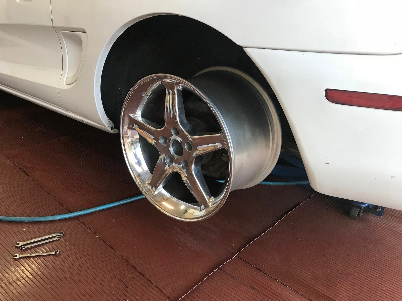

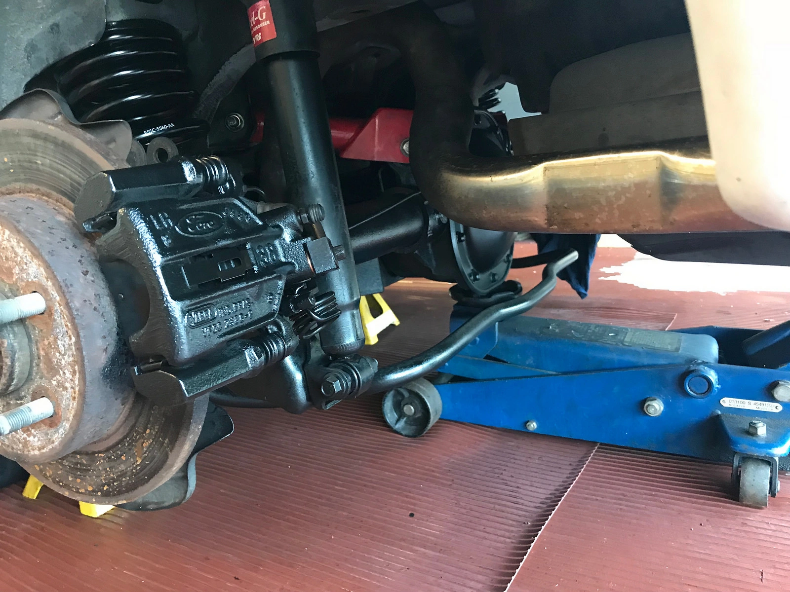

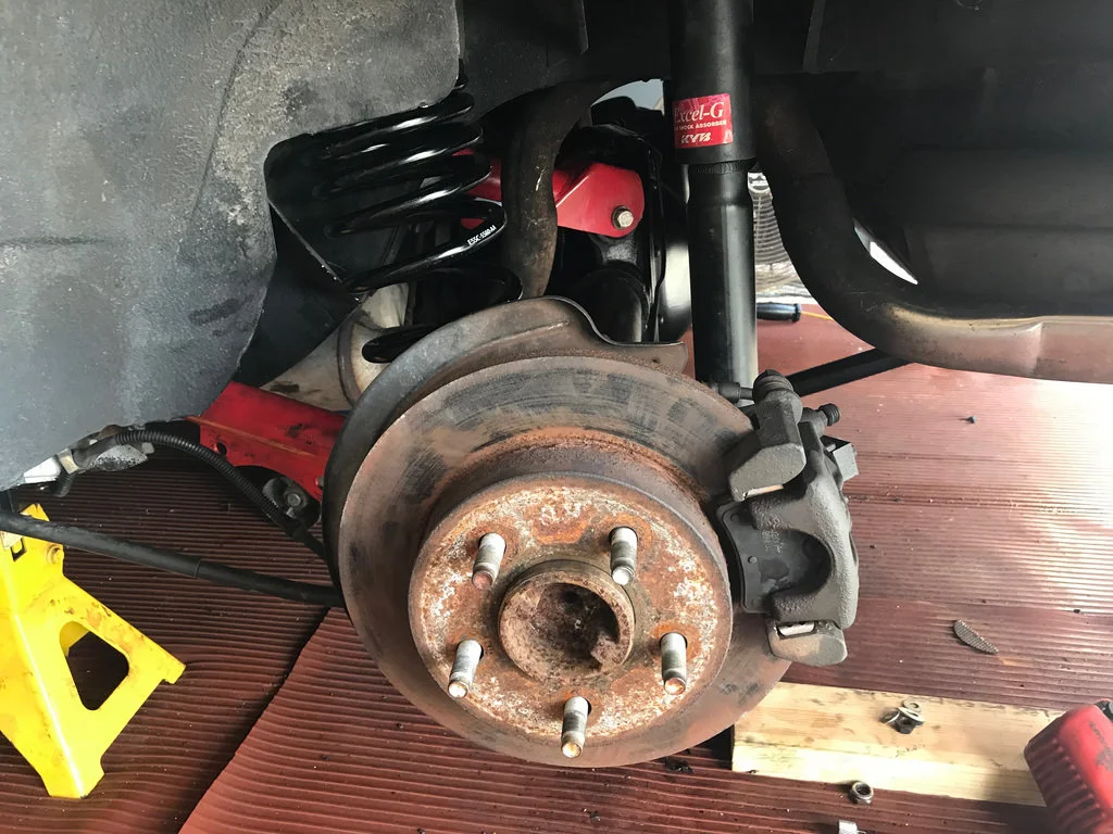

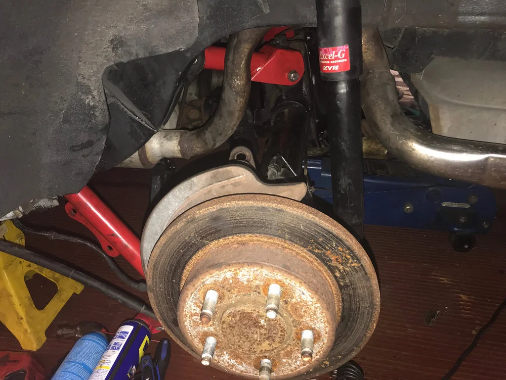

We drop the rear end and install the Flowmaster Cat Back that was already fully welded. We wound up not hacking it up to install it. We were doing control arms anyway so it was just easier to lower the rear further and install the entire cat back assembled.

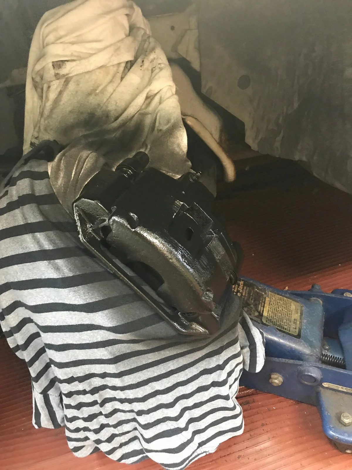

I removed the torn rubber bushings.

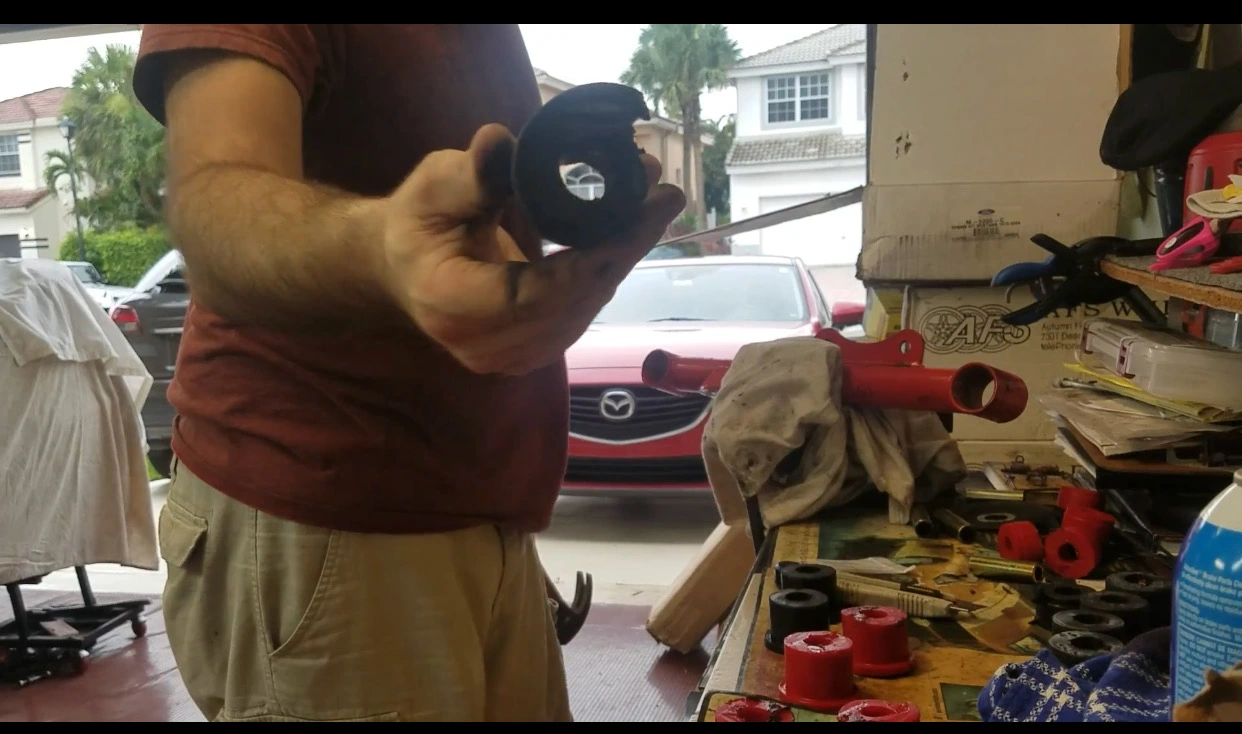

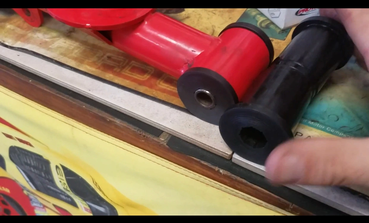

The Polyurethane bushings by Prothane..

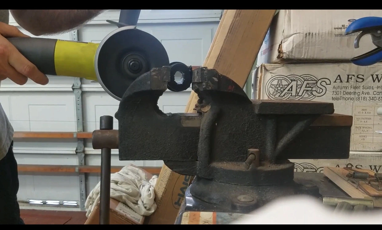

Two pieces were cut to fit inside the control arm.
Untitled by https://www.flickr.com/photos/143276860@N04/, on Flickr

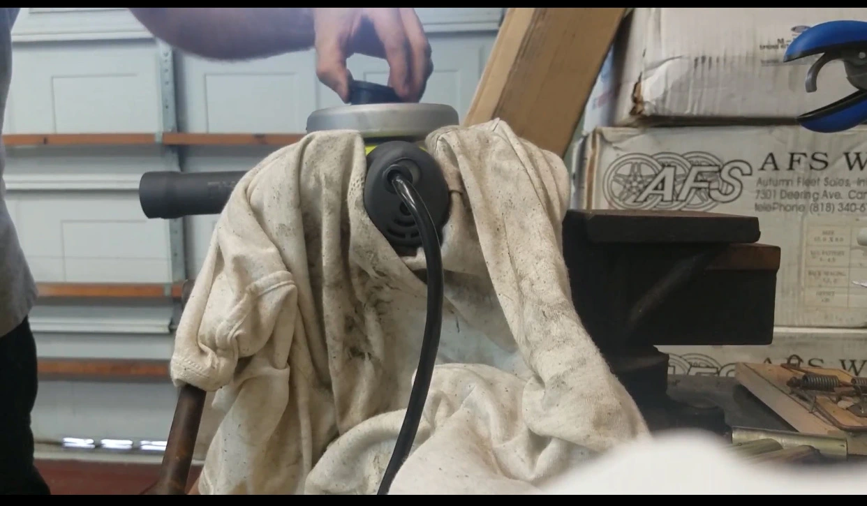

I shaped them with the grinder.

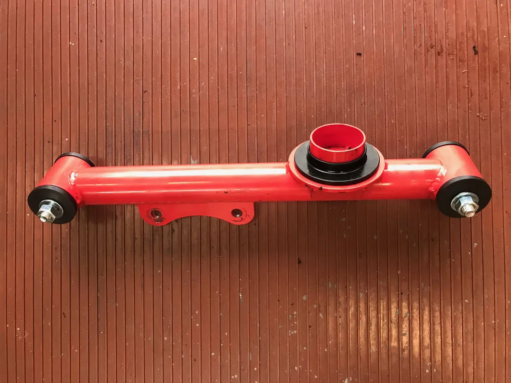

In the next episode they will get installed.
