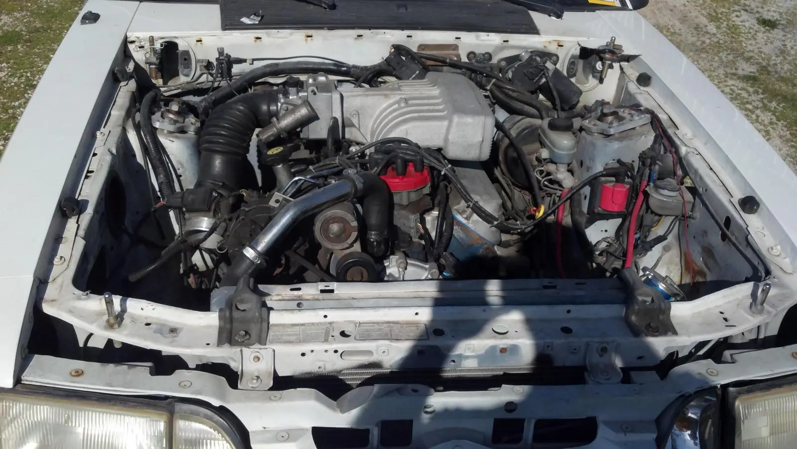

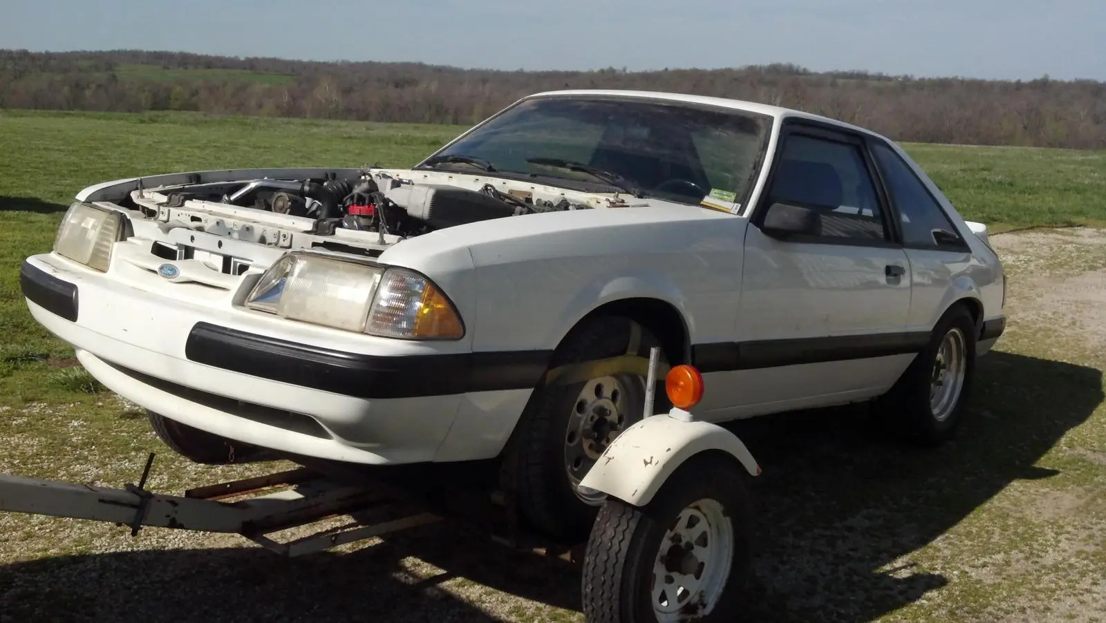

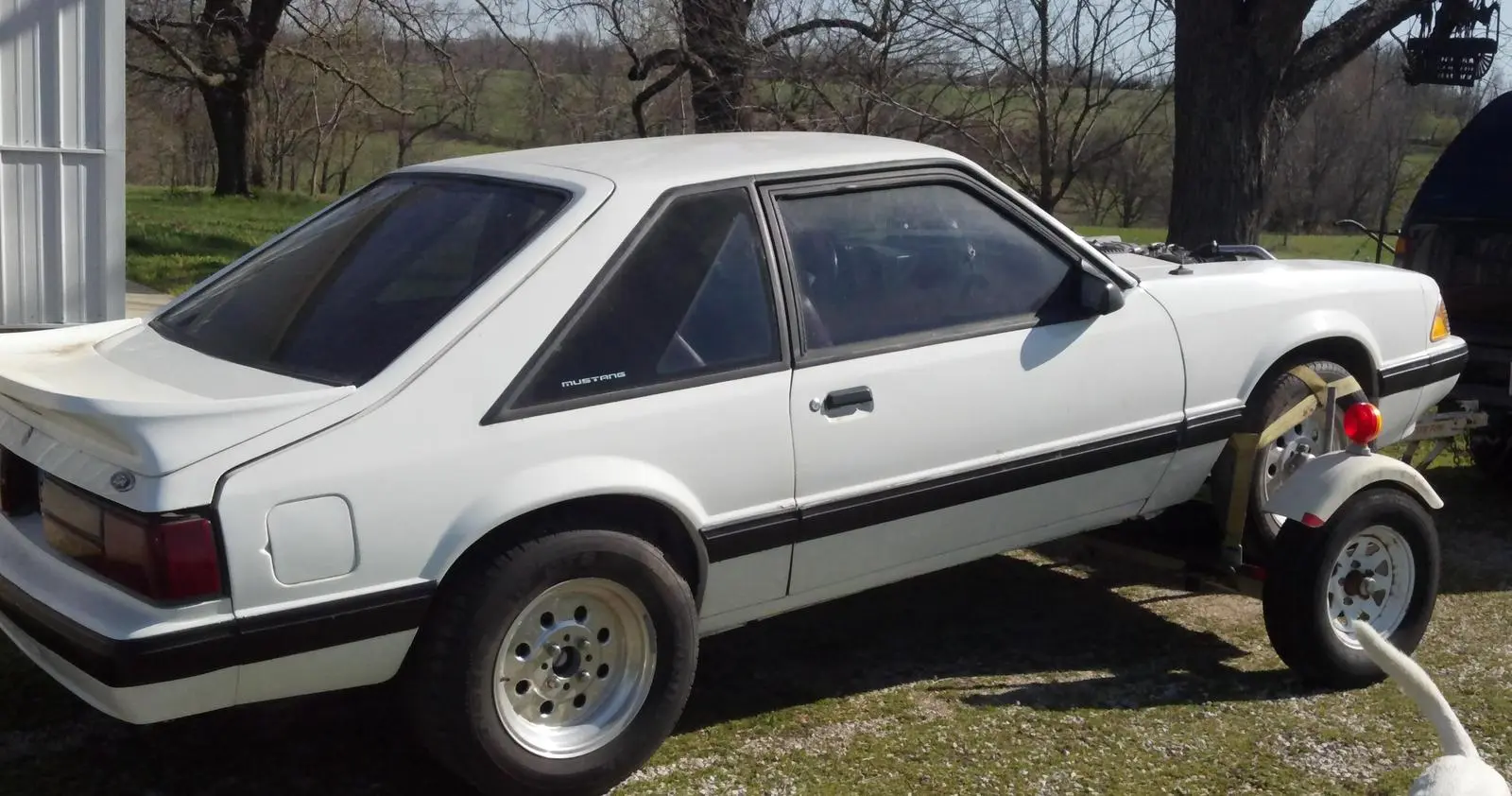

Ok... some quick shots:
02 281 GT

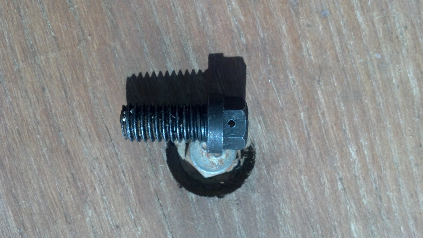

This one is for you. They're ARP, 6-sided that I used a drill press to put holes in. This one ended up being too short but the ones I used are just like it (only longer).
02 281 GT
So you really took the time to drill a grade 5/8 header bolt so you could safety wire them?

I'm tellin ya... It didn't hardly take any time at all. I spent maybe 2 minutes doing the first one and getting it lined up. Once the vise was set, it took maybe 30 seconds per bolt. So I've got maybe 15 minutes total into bolt drilling. Add another 15 minutes for the trial and error with the first bolt that ended up being too short. My step dad (that's where the car is at in the pictures) has a pretty nice press.
