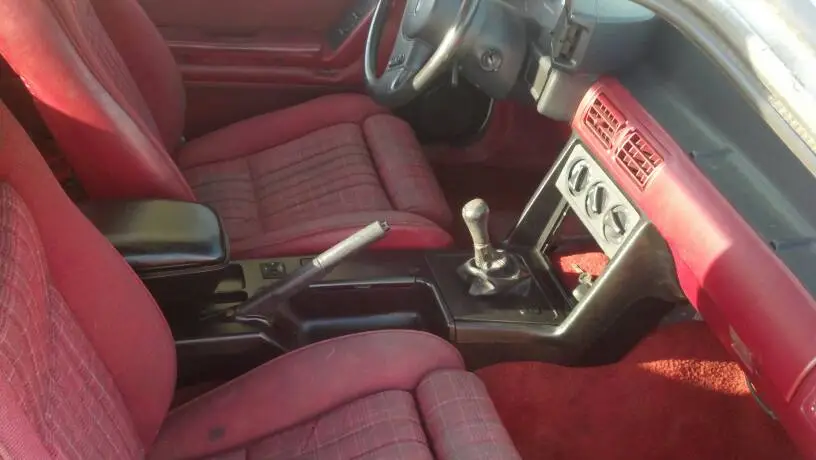

Cool....been throwing around the idea for a while now. Picked up a set of seats at a flea market. They look like they may have been black at one point, but there's evidence for me to believe they might just be a dark, charcoal grey. I was thinking of giving them a once or twice over just to darken them up a little to match the rest of my interior?

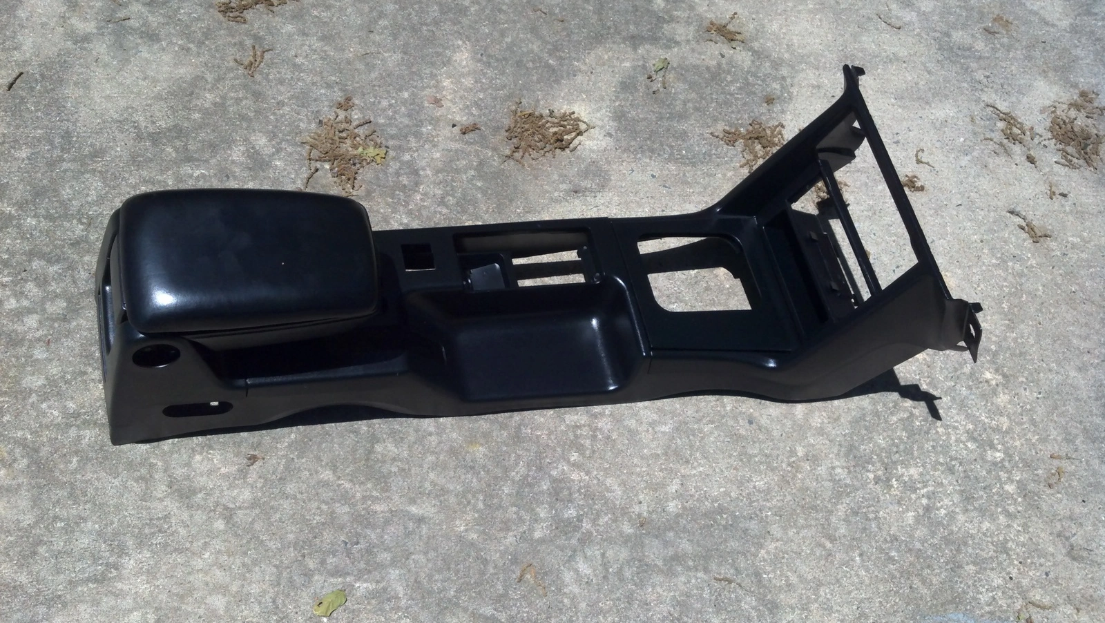

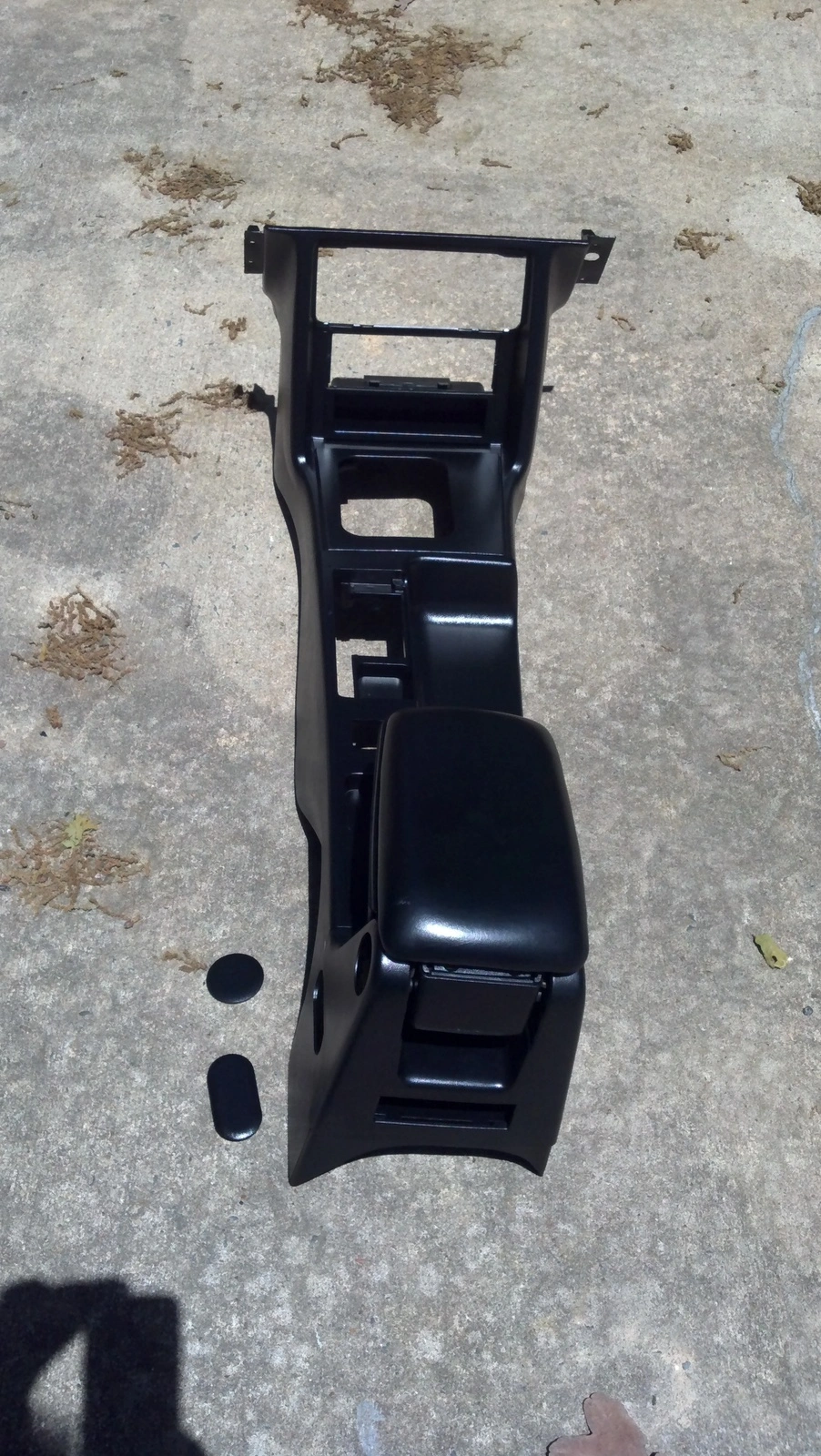

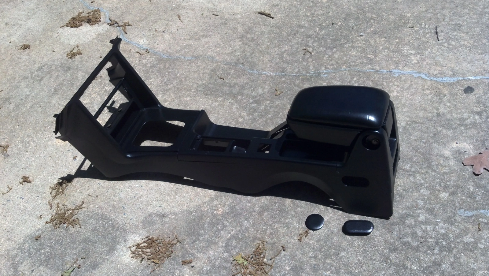

Fully painted center console... I'll tell ya. The armrest was kind of PITA to get back together.
Still need to reinstall the cig lighter and I'm working on a sheet metal fix for the armrest latch. Other than that, it's done and just needs to be put into the car and all the plugs and ash trays etc, popped into place.
I think I'm going to fab up a block plate where the radio sits. Don't think I want to put a radio in.
