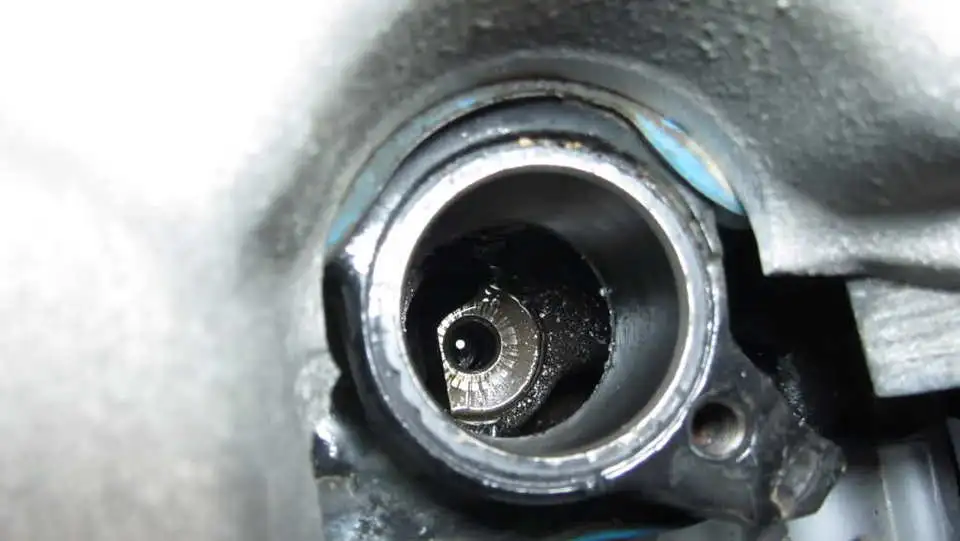

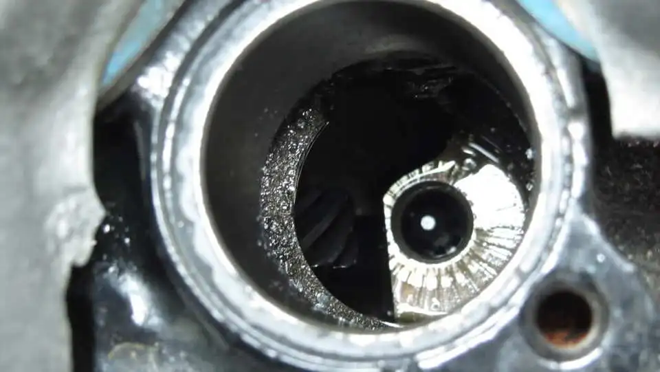

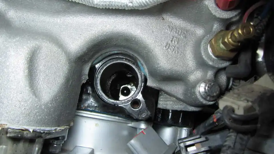

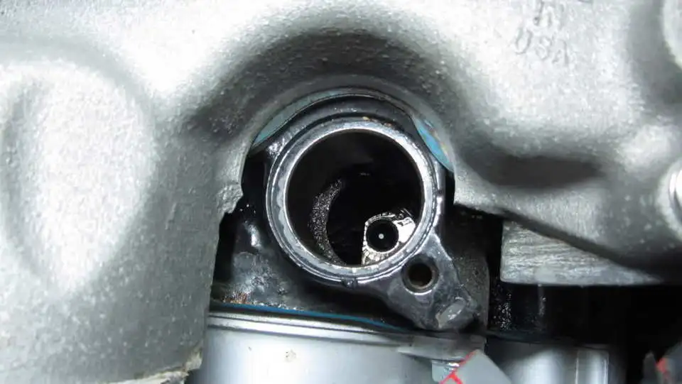

I put a new distributor in my 347 about an hour ago. I started it up and set the timing, it was running and then died all of a sudden. To make a long story short, after some investigation, I found that it seems something was made wrong on the distributor and it was grinding the hell out of the dist. housing sending aluminum shavings everywhere.

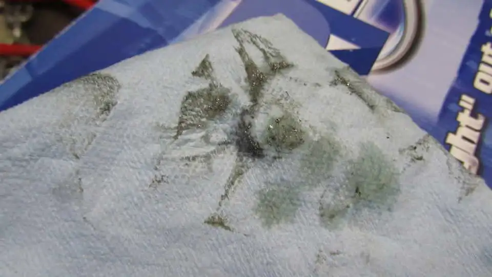

This is some I wiped out.

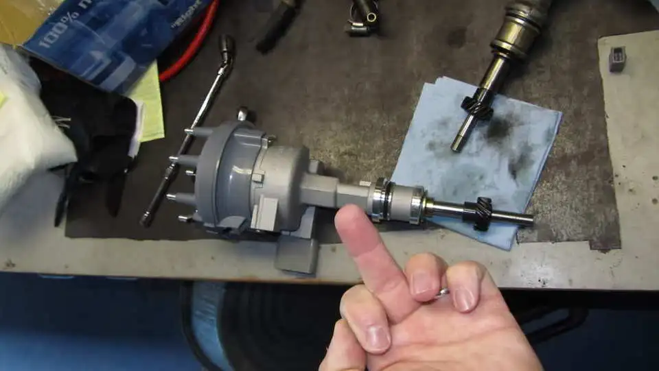

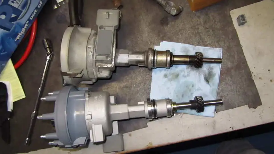

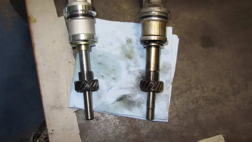

I know it may be hard to see, but it is a mess in there. The dist. shaft on the new one is covered in this garbage, where as my old 150K+ mile dist. is clean. The car literately ran for less then five minutes. You can spin the shaft by hand and feel the grittiness.

Really my first step would be to drain the oil and see just how much crap is actually in the oil.....It looks like the damage was kept in the upper part of the dizzy and most of the debris you see may have stayed in that location. I dont see much down inside on the pump shaft and lower areas. The cam splines look clean....

Yeah I think it is all pretty concentrated in that area alone. I'm going to roll the dice. The distributor was made by a company called Richporter. It is new and they had decent reviews on their products from what I could find. However it is just typical Taiwanese garbage.
I was planning on doing this. I talked to a local Ford guy and he said to just drain the oil and hose it out with brake cleaner. Before I do that though I'm going to wipe out as much as I can with shop towels.

I took the distributor back and got my money back. While I was there one of the parts store guys was checking it out and I noticed the shaft had a ton of side to side play in it. I had checked that out before I installed it and it was tight. It is almost like they didn't even install the bronze bushing in the housing that the shaft is supposed to ride on.
