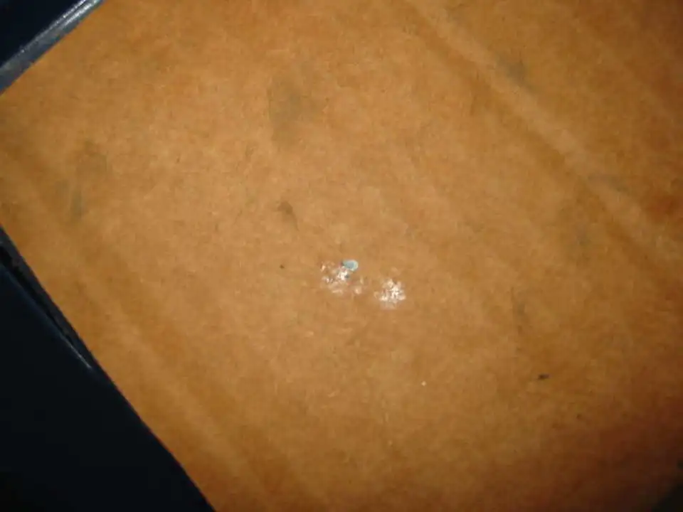

Hard to get pics of the metal flakes, but there were some pretty big ones in it.

Seriously, do you think its fine now? You got everything out?
Hope so. There wasn't much in the drain pan. I won't be driving the car a whole bunch now that I got my new car. So it will likely just get a few miles a week on it. I'll like still change the oil every three months any how.
