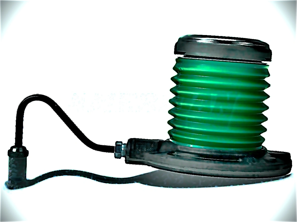

Actuation method’s utilized from 05’+ Ford Mustangs vs. Honda/Acura’s in 98’, pic below..
(Type R-series “B” Trans can adopt the same type).
05’s+ Ford’s use the upgraded hydraulic TOB, solid design, yields a light pedal effort, hard to feel what’s occurring.

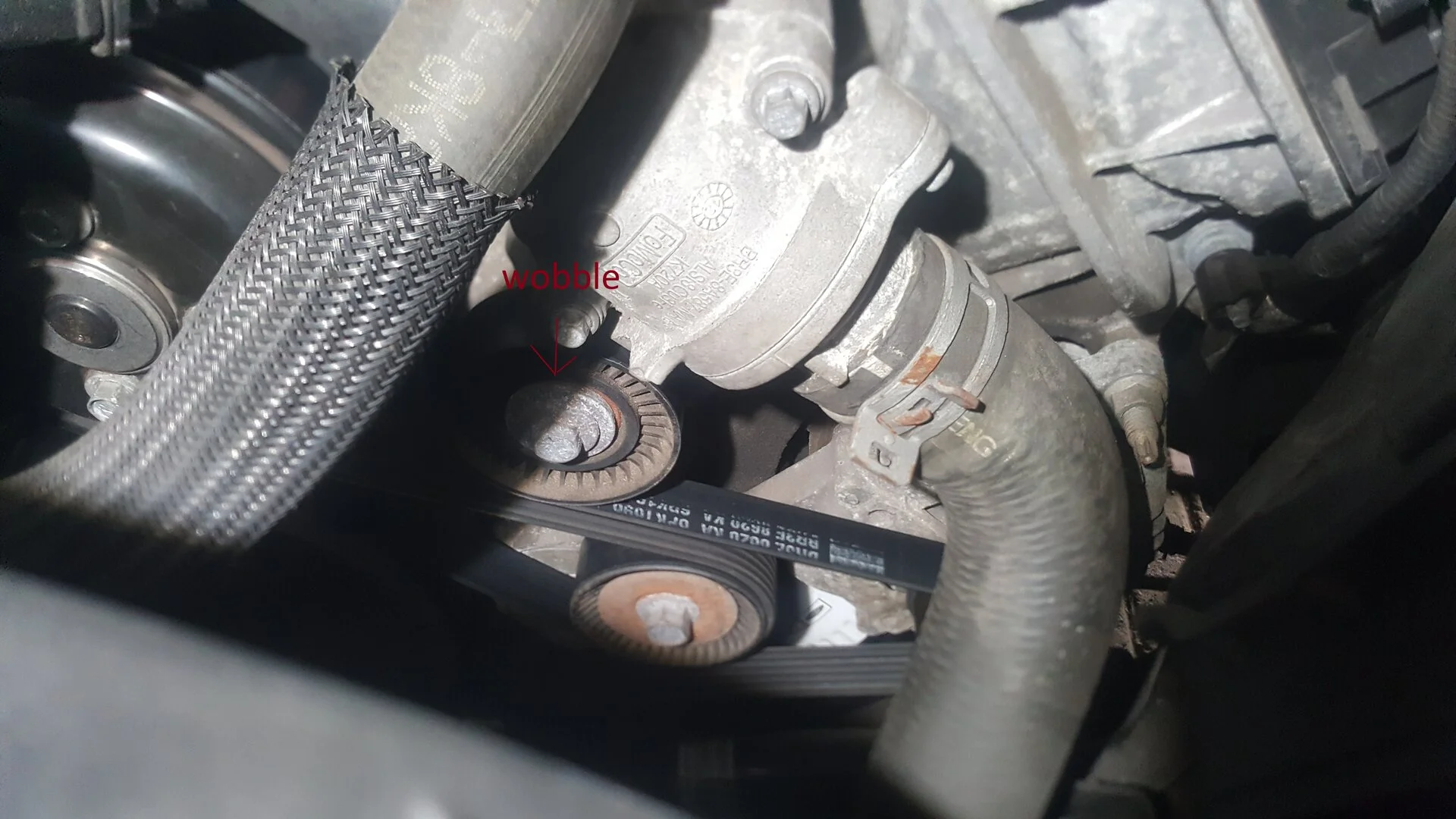

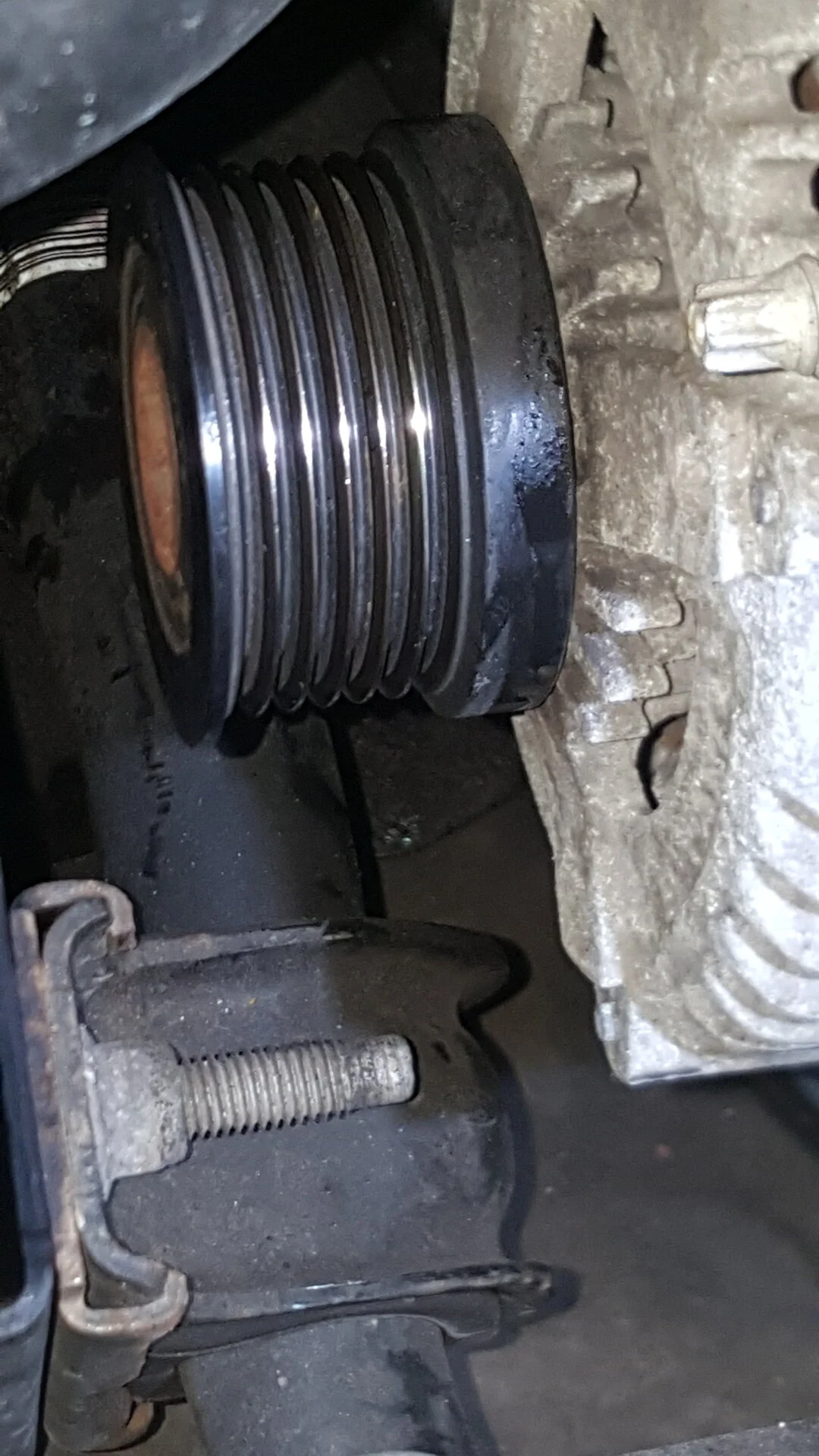

I wanted to change the belts today and found out that the Idler Pulley is a little bit wobbely while running also the belt didn´t look "ok" for me.
A Picture of that:
Hi,
Troubleshooting belt driven accessories & tensioner while the belts on...
1) The belt itself is glazed over., worn, etc.
2) A pulley for an accessory is creating an excessively heavy resistance or load.

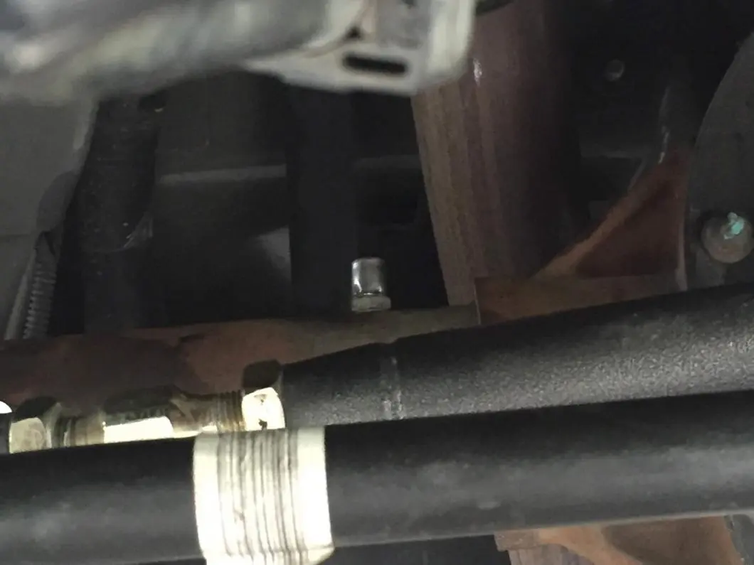

This is a long shot. Rarely amounts to more than a differential or axle seal oil leak...
The Differential vent (vent bolt) prevents pressure buildup from displacing lubrication & can cause oil starvation in certain areas, air from exerts force on seals, causing the most vulnerable to leak.
Pressure is caused mainly by tiny bubbles formed by the Ring gear at high speeds, picking up and slinging the high viscosity gear oil in the differential, creates a vacuum, pulls air in by seals, then escalates air pressure inside.
See Pic’s below..
I’m leaning towards a belt driven accessory issue. Good to rule it out & move on if that’s not the case, or not the only issue.
Happy Wrenchin’!
-John

Edit:
A Picture of that:
Hi,
Hope all is good!
That sound file coupled with that pic certainly reinforces a belt driven issue.
A squeaking belt noise usually goes away within a few seconds to a few minutes as yours does, applying some belt anti slip to improve its Stiction (Yup, real term, lol), to the grooved or outside belt surface(s) depending on the issue usually changes the intensity, squeal may go away, temporarily. Even light oil may help as the belt slips slightly, ceasing noise.
Inside your tensioner is the permanently greased & sealed inline roller bearing(s). Once the seal goes, your grease dries up, only a matter of time before failure under that heavy load.
That’s probably the grinding noise that’s heard along with the squealing. Rust in/around the center of the pulley is another indicator.
I’m not sure why your Mechanic did not replace it when he did the WaterPump, but the more seasoned Honda Tech. you mentioned would likely catch that quick.
Releasing the belt tensioner’s super easy using a Ratchet/Breaker bar’s 1/2” square drive inserted directly into the 1/2” Female square on the tensioner arm. Or use the idler bolt.
Rotate and hold just long enough to pop out the Serpentine belt & reinstall.
The rust/Corrision can be cleaned up during this, use a wire brush & a Scotchbrite pad.
Use Never-Seize on the Bolts & Torque to spec’s.
Check & clean everything while you’re doing this including the Tensioner itself, likely needs a good cleaning & lube. Probably only need to replace the idler itself. Not expensive, 25-30$ including Never Seize.

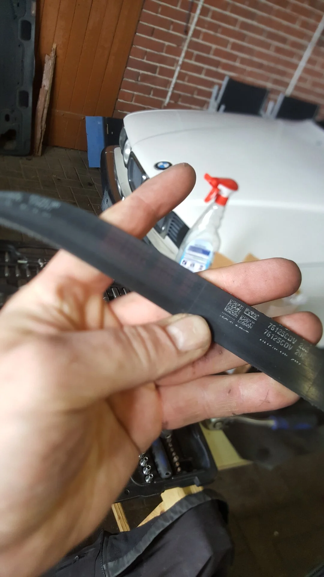

Small edit:
Damn Car don´t let me sleep so i took pictures from the Belt and from the Alternator pulley because it is shiny like polished by the Belt. Is that normal or an indikator for a draging Belt? Does the Belt from a s550 5.0 fits on the s197 5.0 ? It would be the quickest option.
Reactions: 08GT500

Hi,
I think differently. You did precisely the right thing so far.
You located a real problem & repaired it by replacing a component. Whether that’s primary or secondary to noise, there’s no shame in that, that idler would‘ve caused even bigger headaches when it decided to seize/fall apart, fail completely, whether a day or months later.
It’s important to mention, if a Serpentine belt has been screeching on/off as result of being loaded heavily or misaligned slightly, a bad tensioner, it’s quite likely glazed and once repairs are made, it often tends to continue squeaking. Also important you use new hardware, Pulley come with a new shouldered bolt?
Is the old belt riding in the center of the new tensioner and idlers?
..wait until you put the new belt on before you become certain it’s not the only issue. Once the new belt’s mounted on clean pulleys that are running true, your driven accessories are good to go. And then, whether the same or not, move on.
If the belt doesn’t cure this, I’ll help you nail it down. Know you’ve been at it for a while before, and it’s frustrating, but have faith. It’ll be found.
Doesn’t sound internal to me, I’ve limited info, but I still believe that sound file was at least some of, if not mostly a belt accessory slipping. Either way, you repaired a valid issue.
If the noise persists, very important next step to Locate it’s origin....
1) Isolate it. Otherwise, you’re Chasing your tail. A sound recorder, affixed in different areas underneath when doing some drive cycles will perform this.
Have an old Cell phone? Cost 0$, pick/run a Sound App., intensity/Volume are visible in sound graph app’s.

Hi,
It’s hard to tell for certain by a pic, but if the belt had a pulley that caused unequal force on the belt as you had, it starts to walk & not remain centered, surface area being less across the pulleys.. squeak.
Once it starts to squeal, the belt may not stop even once the issues repaired. There’s evidence such as power steering may be a little difficult if it was/is slipping over the power steering pump pulley, or over the AC compressor (running it may make it squeal louder, or quieter), but not every time.
Good rule of thumb, if there was a bad idler or other issue that wasn’t right & you replaced it, replace the belt. Still haven’t received the belt-huh?
I’d recommend a Goodyear Gatorback replacement, they work exceptionally. You can clean up the pulleys with solvent & if there’s rust- anywhere on a pulley, light sandpaper, then a medium 3M abrasive pad (Red colored) will do the trick.
Once running, be sure to watch the belt passing over the idler & that it’s centered up, not tracking from one direction to the other.
You’ll catch it, no worries, realize it’s a PITA, but it will get better my friend!
Best!
-John
