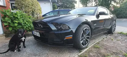

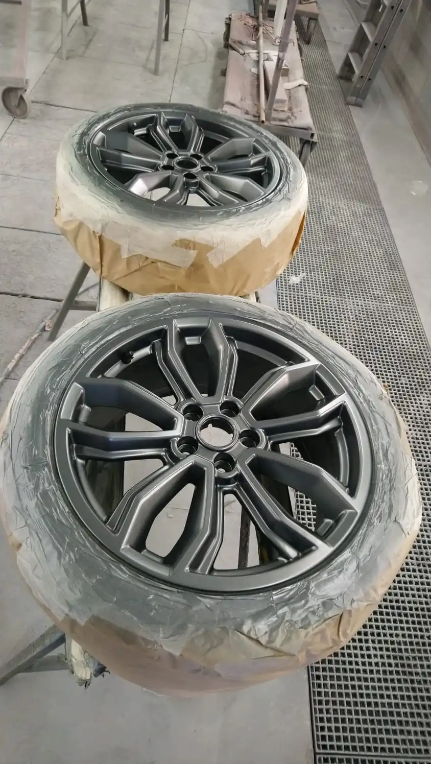

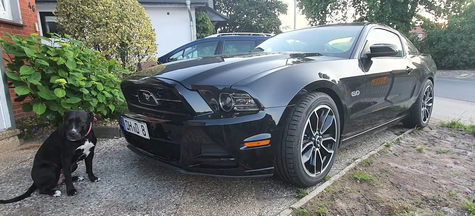

Ps. Some pics of my dream car after the fix and i painted the rims yesterday.

:nice: Hi,
So this happened because you were doing ripping the EBrake at 100MPH and doing those 720 Degree spins on the Autobahn-right? lol!
Seriously, happy you’re rolling again! That must have been rough...
“Occam’s Razor”.. "the simplest solution is most likely the right one" ...
Its unfortunate that the tests run by who you’d sent it to didn’t provide clear results. Confusing.
Then the “They also cancel Wheelbaring and stuck Brake parts out” comment.
they were WRONG!lol!
Your Pony Car looks great, you’ve got the best security system on the planet sitting in front of it, too. Pit Bull? (Staffordshire Terrier)..
Should rub this in the Shop’s face, BUT...they don’t deserve your time...Send your Dog in...he’ll get the message across!lol
